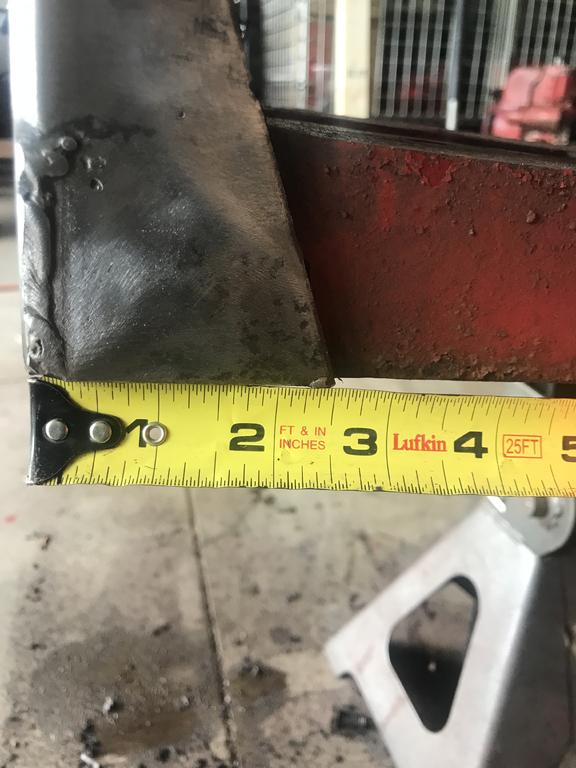

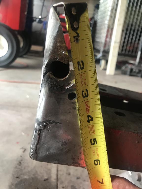

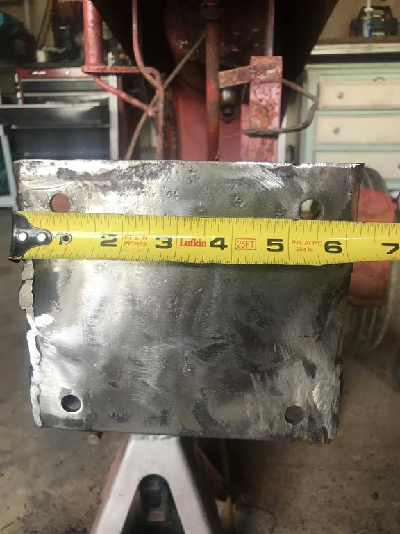

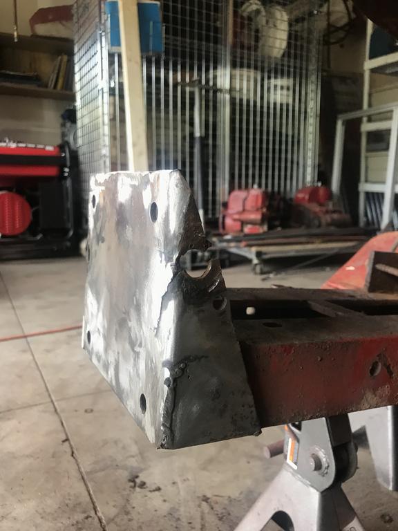

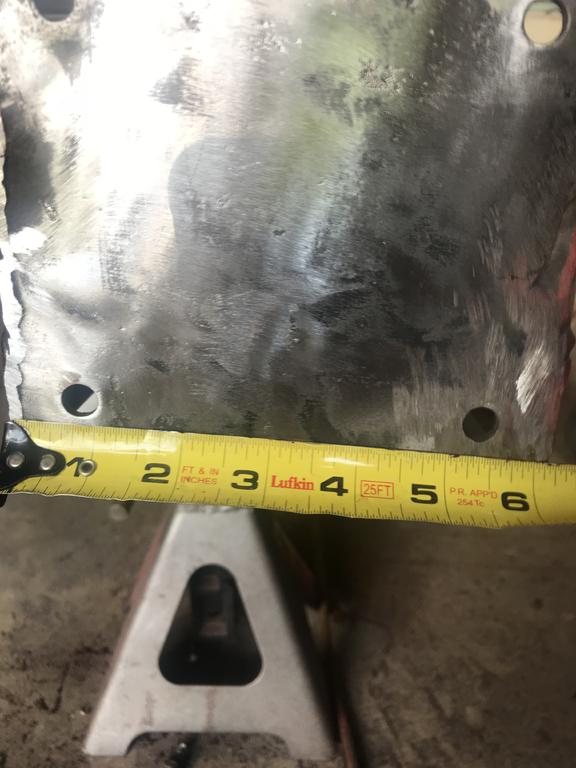

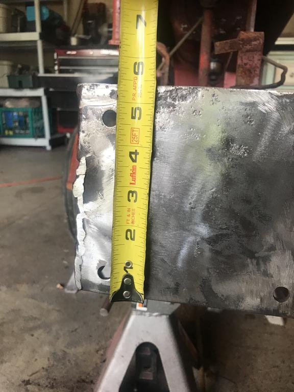

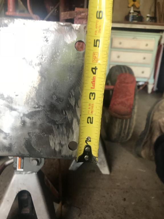

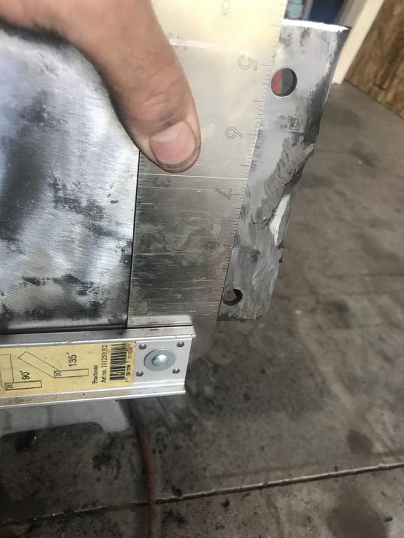

Aldon 4,834 #1 Posted July 5, 2018 @gwest_ca , @953 nut , here are are some pics with measurements to get Garry pointed in right direction. As side note, the awefuld prior owner repairs I cut out seemed to be done for a failure mechanism that did not occur. The real issue is that the thin metal for the half inch clutch rod the run through had given way. Anyway, here are some measurement pics as requested. 4 Share this post Link to post Share on other sites

gwest_ca-(File Mod) 12,535 #7 Posted July 6, 2018 Thanks for the details. I should be good to go at it now as soon as I find my time. Garry Share this post Link to post Share on other sites

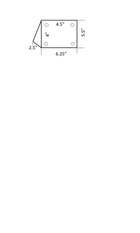

953 nut 70,343 #8 Posted July 6, 2018 @gwest_ca here are the dimensions for the plate. 1 Share this post Link to post Share on other sites
