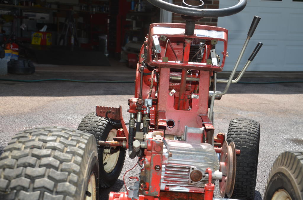

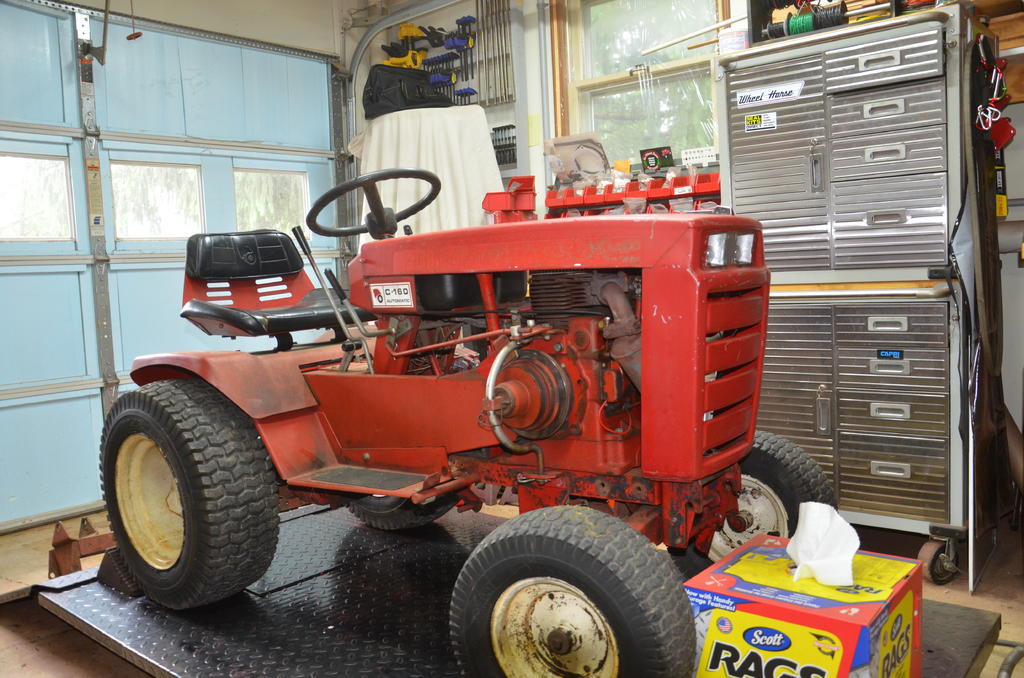

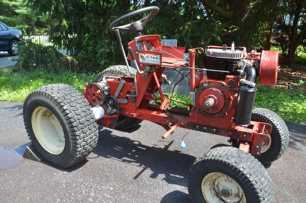

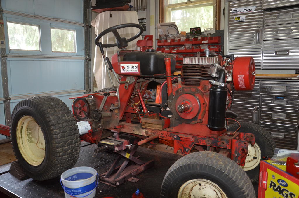

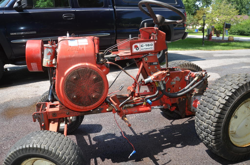

Pulled the battery and was able to get the wiring harness out (after I labeled all the connections) in one piece.
Should be able to make a brand new one when the time comes.
Hood, fenders, running boards, PTO, belt guards all pulled.
Today was TOO hot to mow (96 deg) and the finish on the moulding for the room downstairs needed to cure for another day so.....
Today was bath day.  Soaked everything down with Oil Eater (great stuff).  Let it soak for a while then attacked it with the power washer.
Forty years of grim gone in 30 minutes.:D
  • Like 1
  • Excellent 6

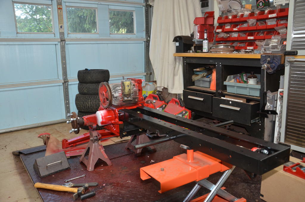

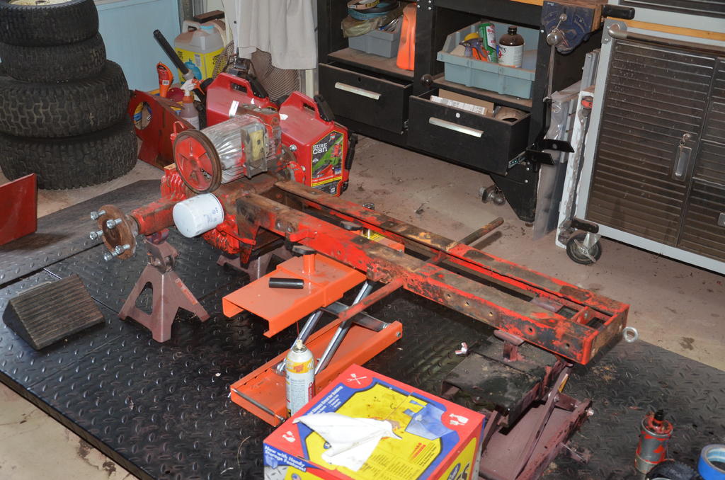

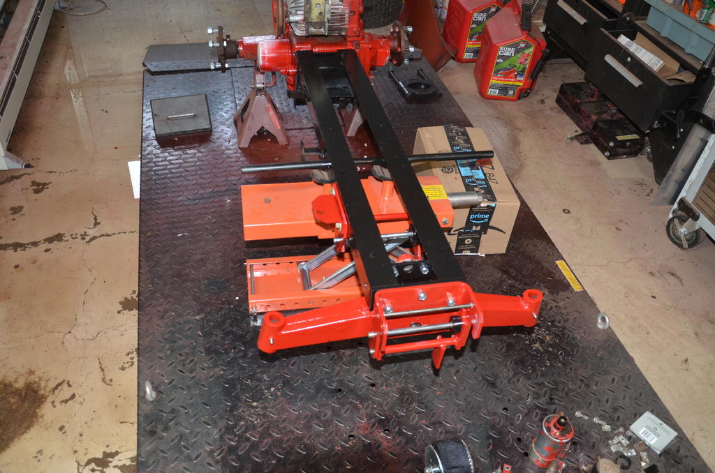

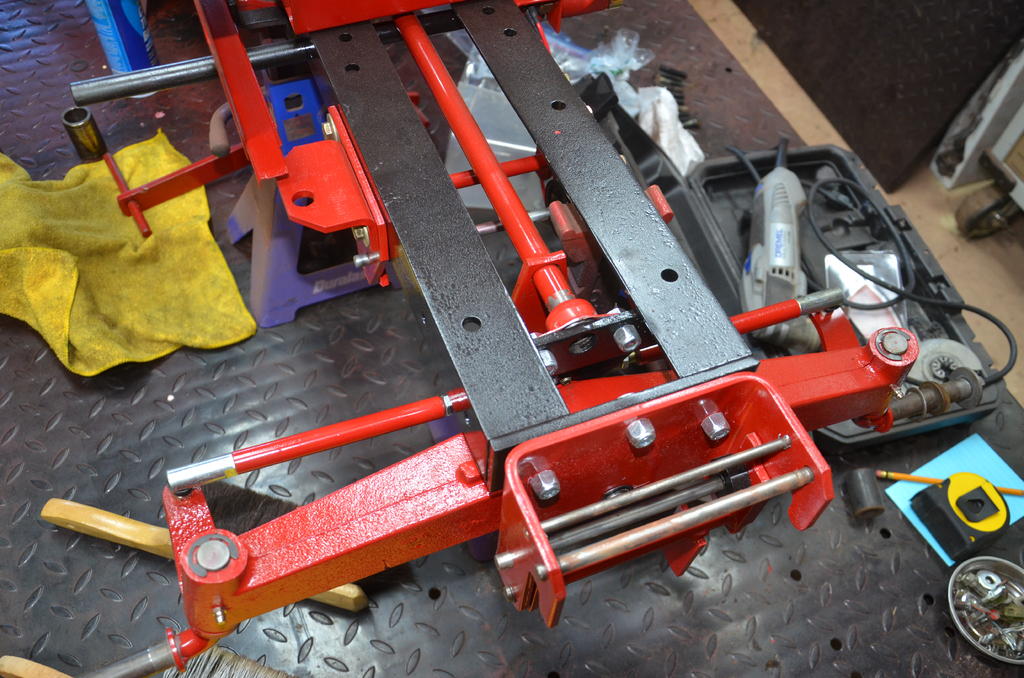

Got it all stripped down to the frame.
Removed the frame from the tranny/hydro.
Stripped the frame down to bare metal with the sidewheel grinder with 80 grit flap sander and a needle gun.
Couple of coats or itching primer and decided to do something different and went with gloss black.
Thought it came out pretty good
  • Like 6
  • Excellent 2

Hey a little mix or black with the red is good in my book!
  • Like 4
Tractor boy
It’s looking good!
Chris G
The black frame and transaxle looks good to me as well.
  • Like 3
  • Excellent 2
RandyLittrell
Next Horse on my list to do is gonna have a black tranny, frame and front axle!

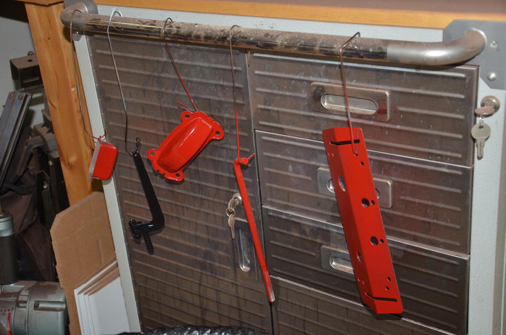

While I was waiting on the axle seals got busy with the blast cabinet and sander.
  • Like 7

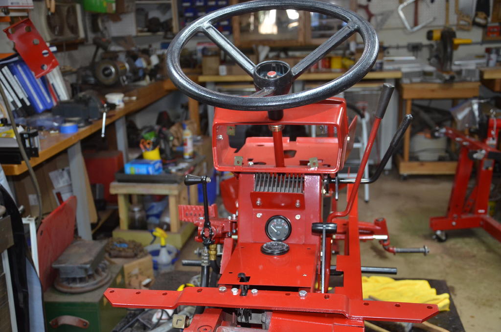

Found some time to get a little work done. This tractor had the soft spongy steering wheel. I had a 74 C-120 that had the same steering wheel couldn't get either one off even with a press.  One gave its life so I could get the shaft. The other made me really mad. I think it's going to be a "yard ornament"  I really like the hard plastic type anyway so guess I will have to find one.  A-Z maybe?
  • Like 3
  • Excellent 4
ebinmaine
Absolutely. Lincoln can probably help you out. If not, post an ad in the wanted section.
Your 160 is looking wonderful.
Keep up the good work.

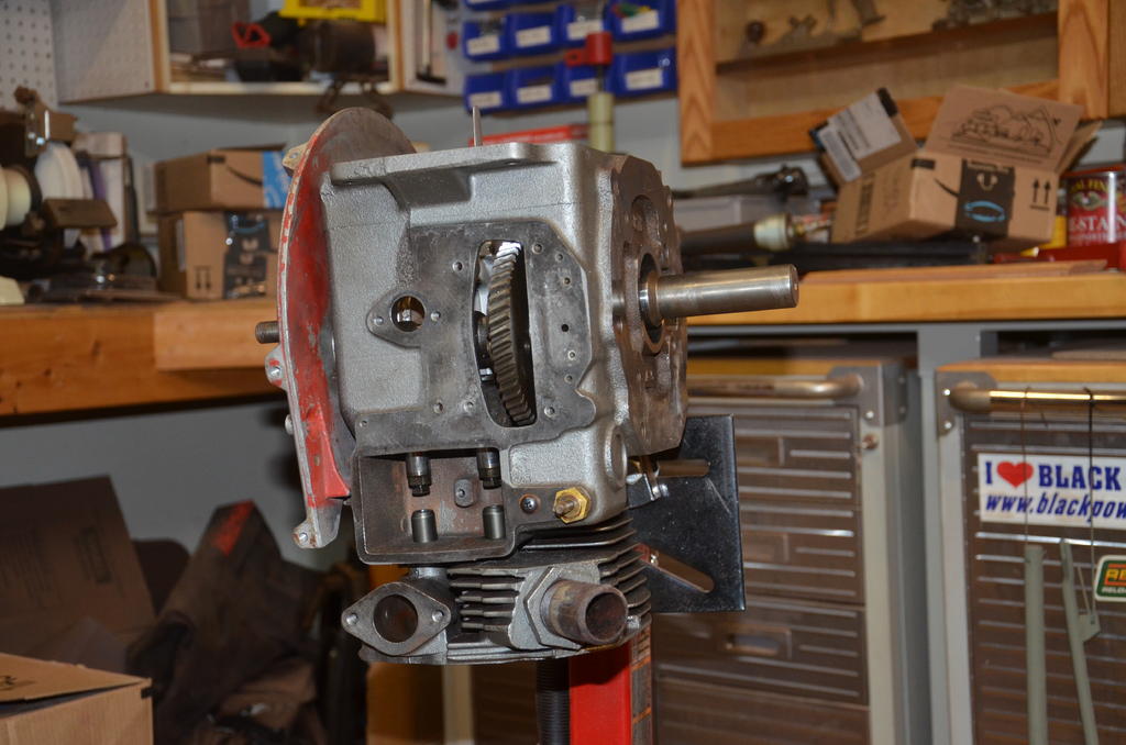

Broke down the engine so I could send it out to the machine shop.
The hobbs meter on it said 1823.7 but I found out it was broken so not sure how much time it has on the engine.
It had a STD piston and like I said earlier it ran real nice without any smoke!?!
The blast cabinet has been getting a workout.  Lots of little parts and a couple of bigger ones.
And a new set of drag links:rolleyes:

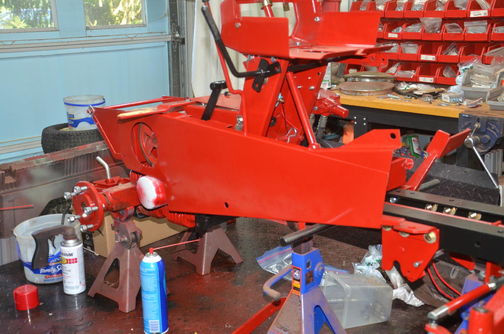

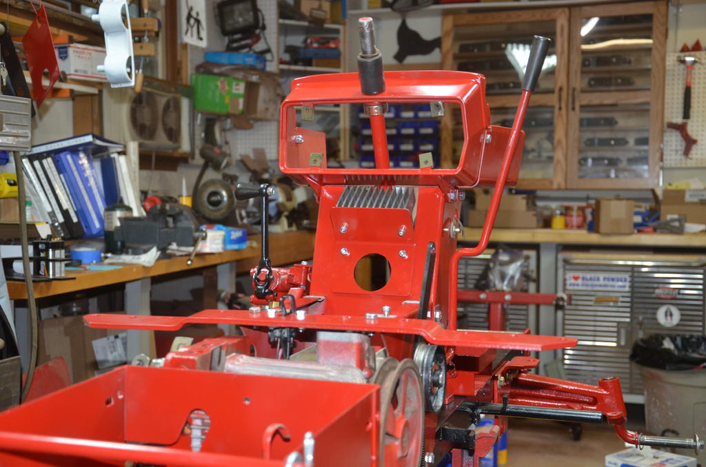

RJ Hamner
Sent the engine to the machine shop and had some free time.

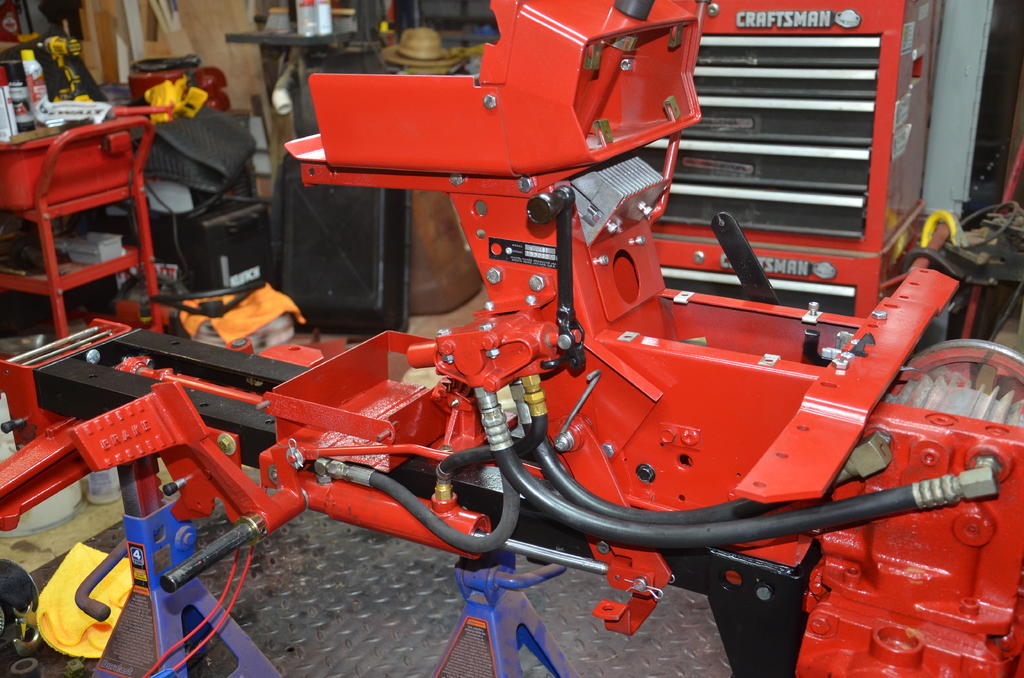

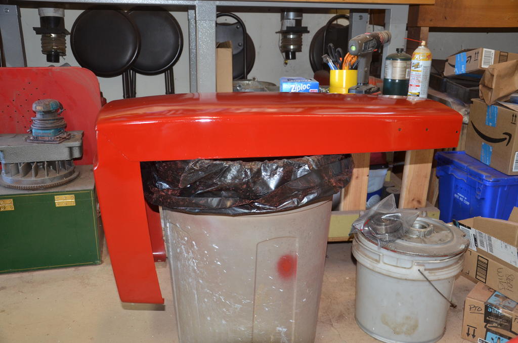

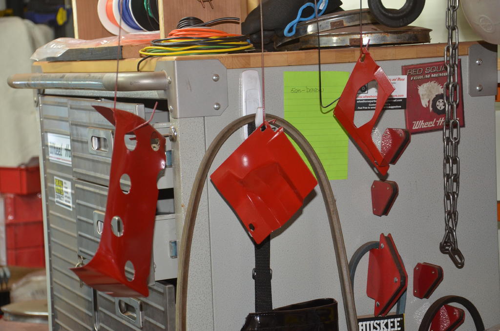

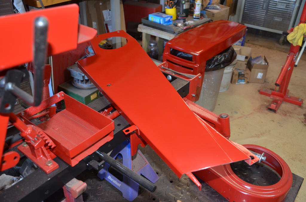

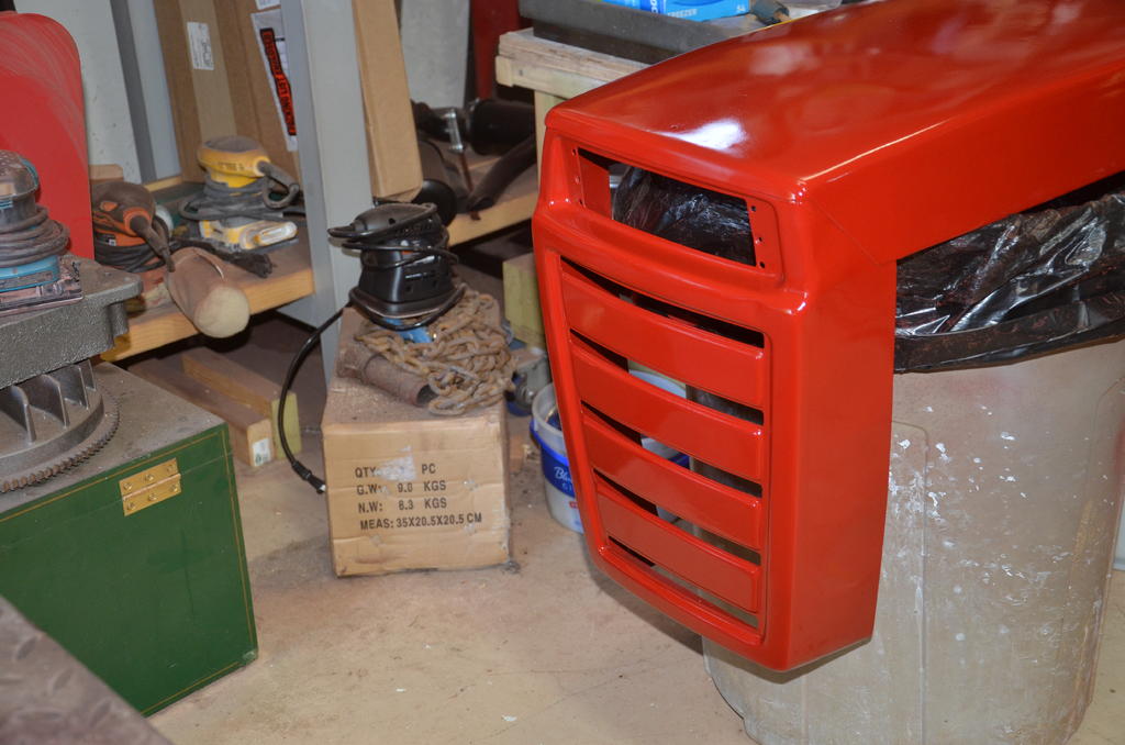

Started on the hood and running boards..

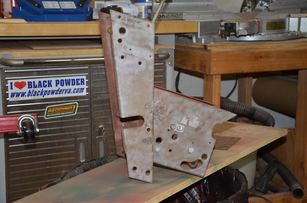

Took then down to bare metal, self etching primer and Regal Red.
They were looking real good and then I was looking at the panel on the right side that hides the belt (aaarggg)
Took it back down and put a skim coat of some 3M body putty and repainted
Looks real good now

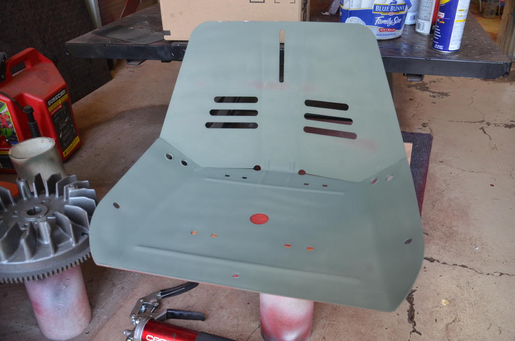

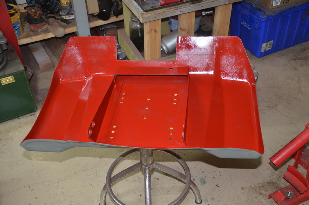

Started on the seat pan.

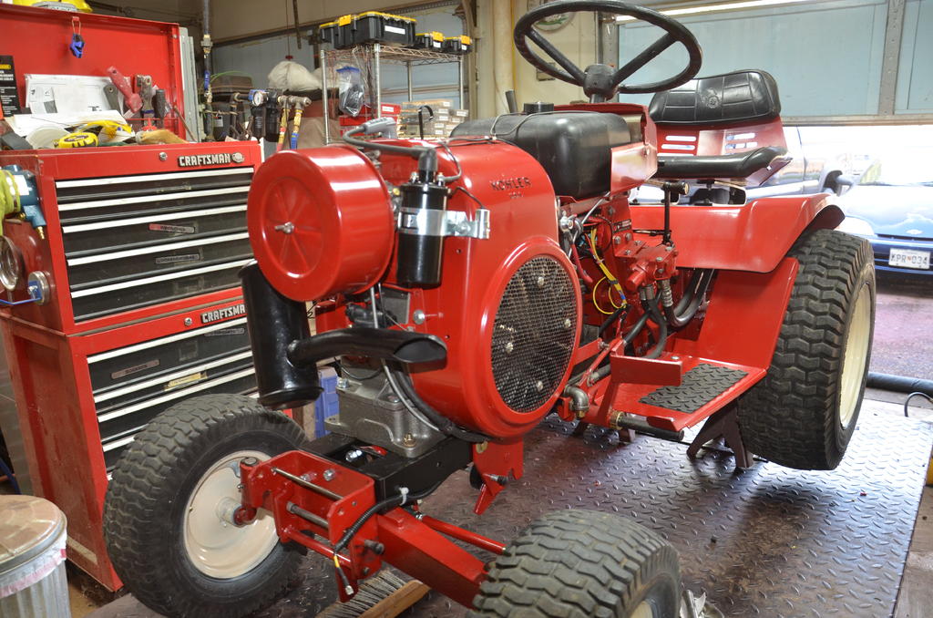

RJ Hamner

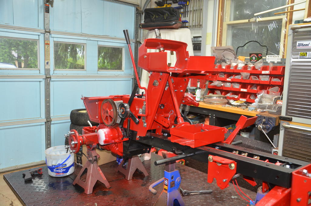

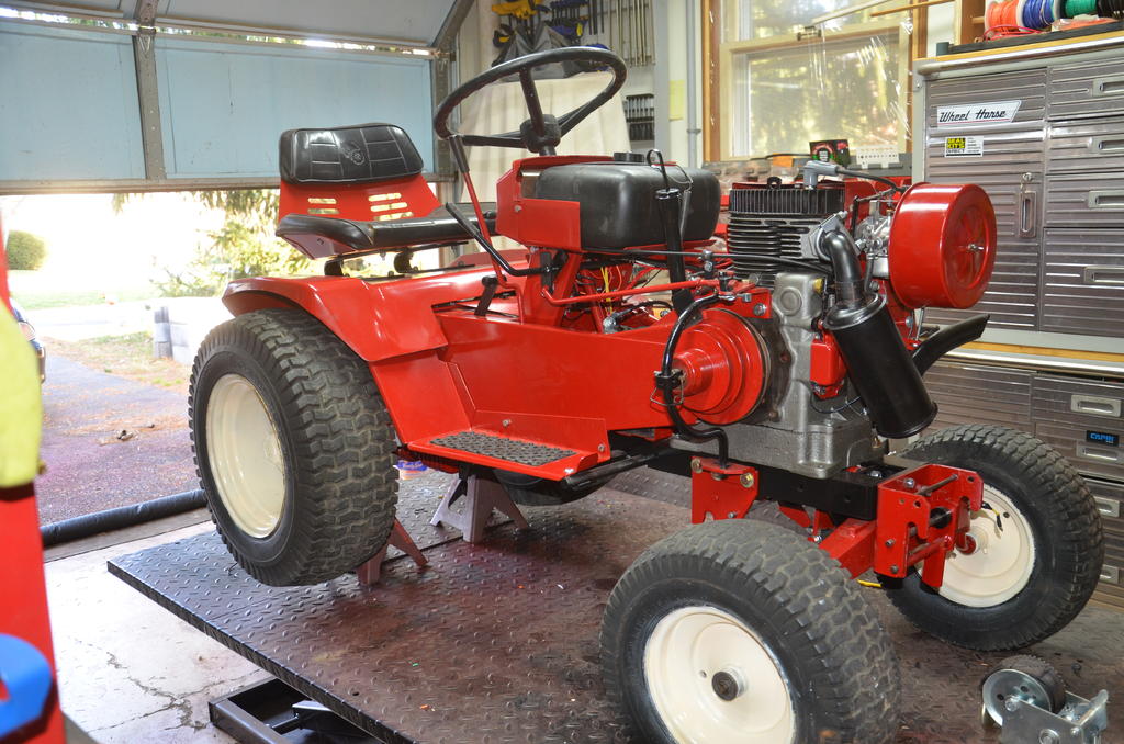

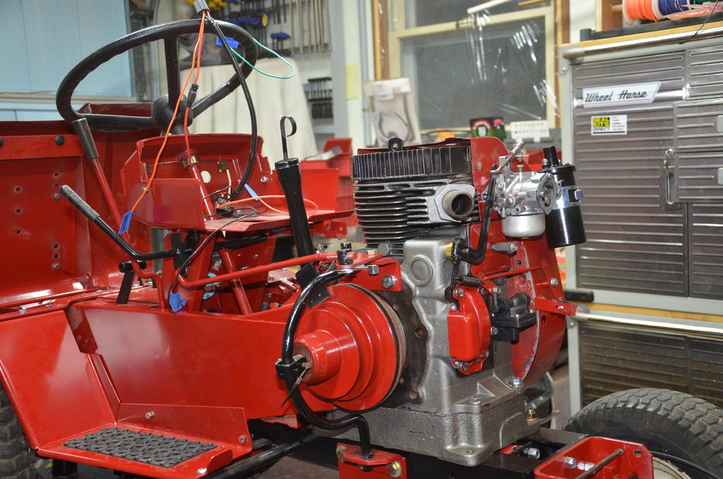

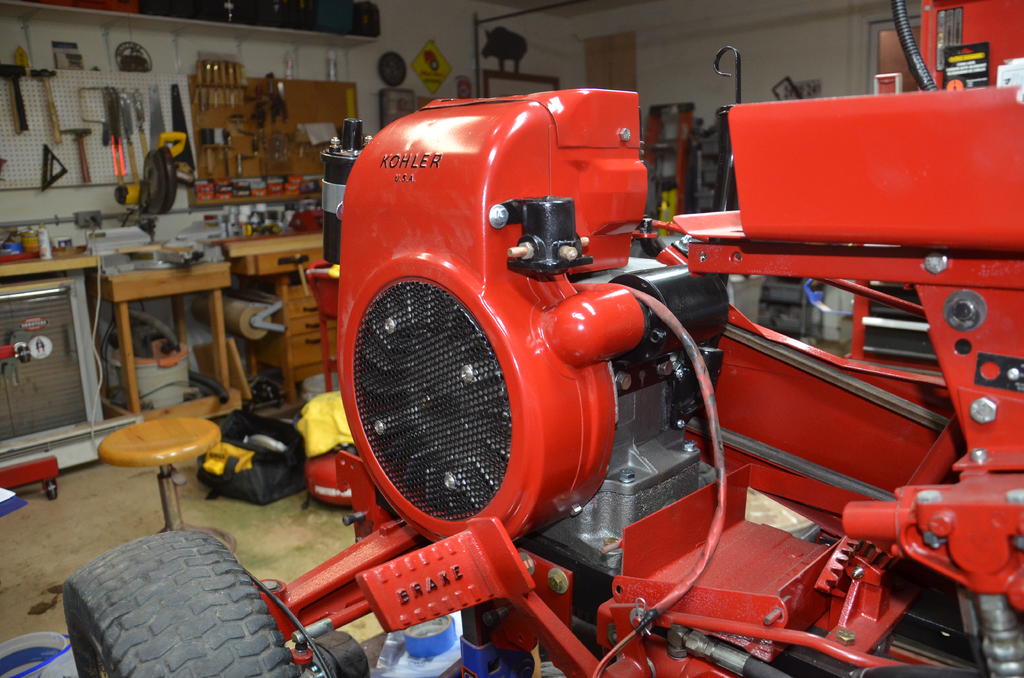

After spending a month in St. Louis working on our "other" house then coming back and playing "catch-up" with all the "get ready for winter" stuff I got to spend some time in the shop.
Got the engine back from the machine shop (they do great work but expensive) and I started putting it back together.
  • Like 2
  • Excellent 4

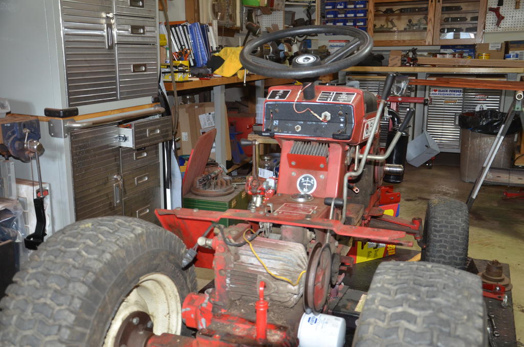

RJ Hamner
Got a couple more days without any "honey-do's" so I got to spend some time working on the tractor.:D
I've always said the trying to get all the parts together for a rebuild was like a "scavenger hunt" which at times can be a challenge.:)
But trying to remember where I put those parts can be an even more frustrating challenge because they have to be somewhere within the 24' x 24' space that is my workshop.:eusa-think:
Then again I am the kind of guy that can lay a tool down, take two steps away from it and spend 20 minutes trying to find where I put it.  AAAAARRRRGGGG!!!!:laughing-rofl:

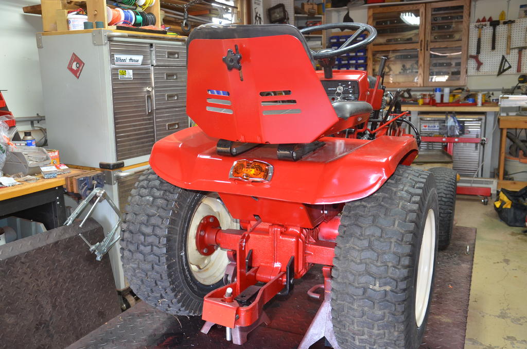

ebinmaine
Me too......
The C looks excellent !!!

Razorback
Beee-u-T-fullll!!!!!
