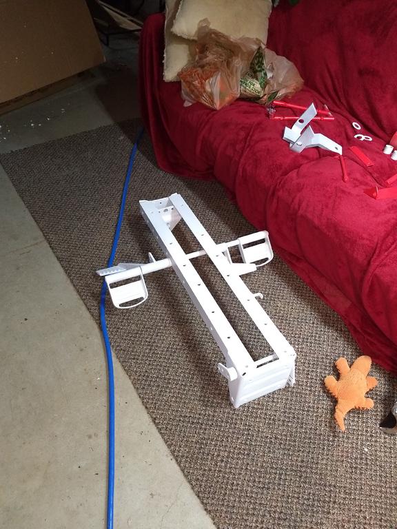

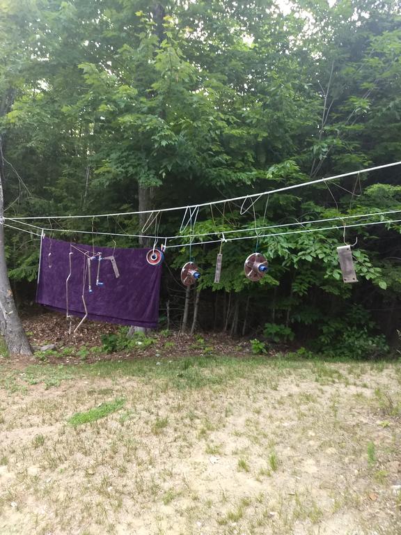

Wheelhorse wind chimes.
Priming tonight.....
And working on getting the well known hitch pin out so I can put a regular hitch on.
  • Excellent 2
19richie66
Love Wheelhorse wind chimes. They make the sound of “progress”

:text-coolphotos:            Glad to see you had your safety saddles on while almost knocking the transmission off the table.           :ychain:
  • Haha 2
ebinmaine
Specialty high grade invisible composite toe protection

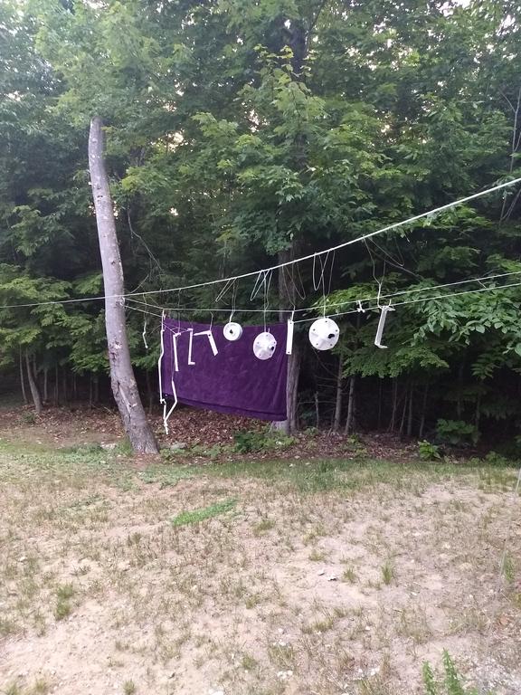

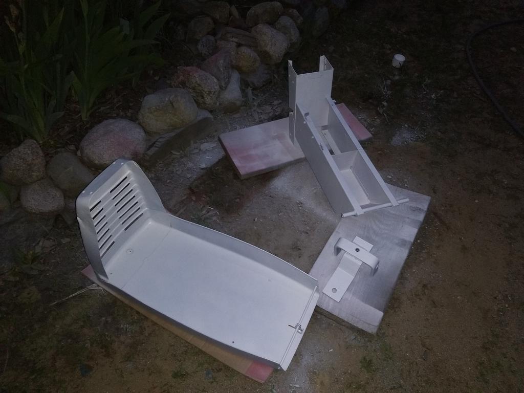

The hitch pin is out!!

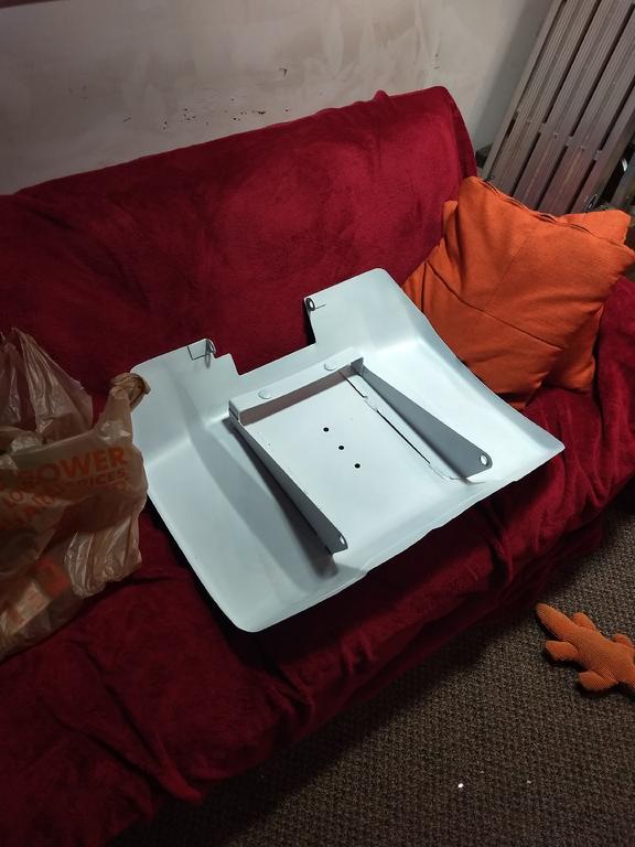

The wind chimes and also the bottom of the seat pan were primed tonight.

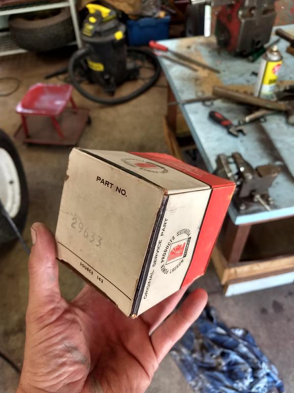

Got a muffler in the mail this morning.
NOS in an old box. I'll keep the box cuz it's cool.

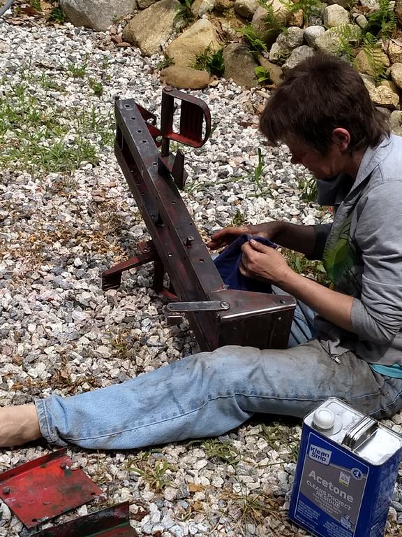

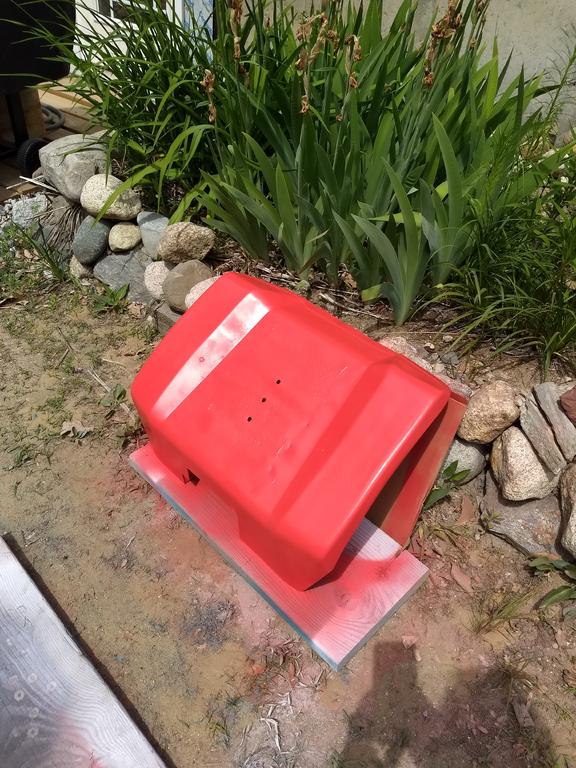

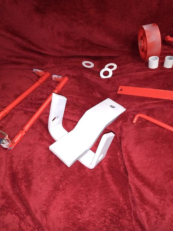

There's red paint on some linkages and the seat pan!!!!
My honey spent a bunch of time cleaning and cleaning and cleaning.

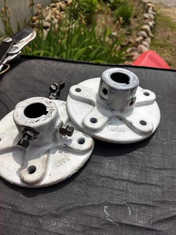

I got another set screw put into the hubs.

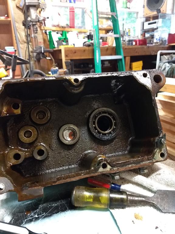

We've hit a snag on the transmission that I hope can be repaired.
I've posted in the transmission section as well.

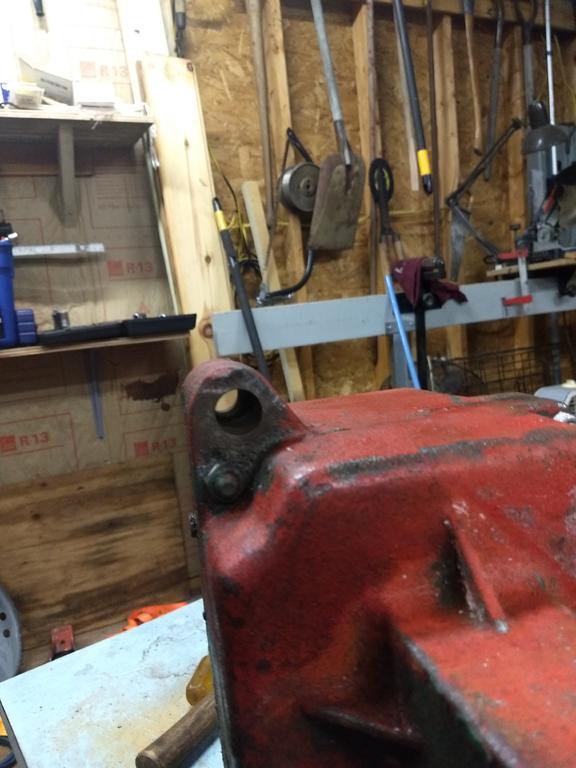

There's a bad wheel bearing so I'll need to split the case and where that bearing sits the case has a chip missing.
Edit. The guys in the other thread say that this is probably just a piece of the bearing missing. I'll split the case and see what happens.

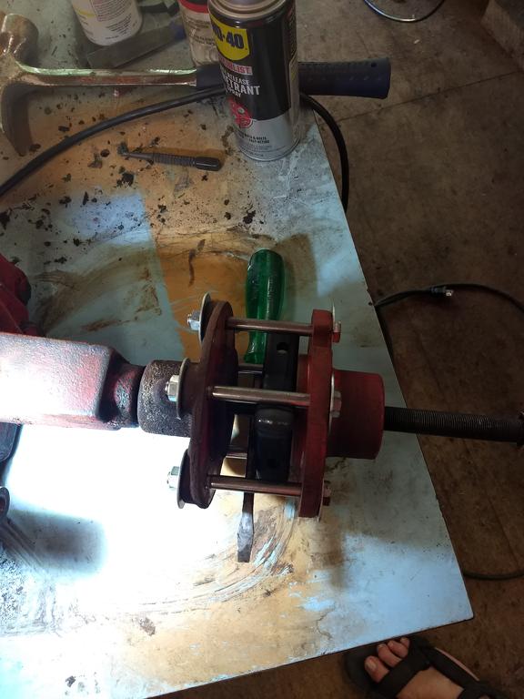

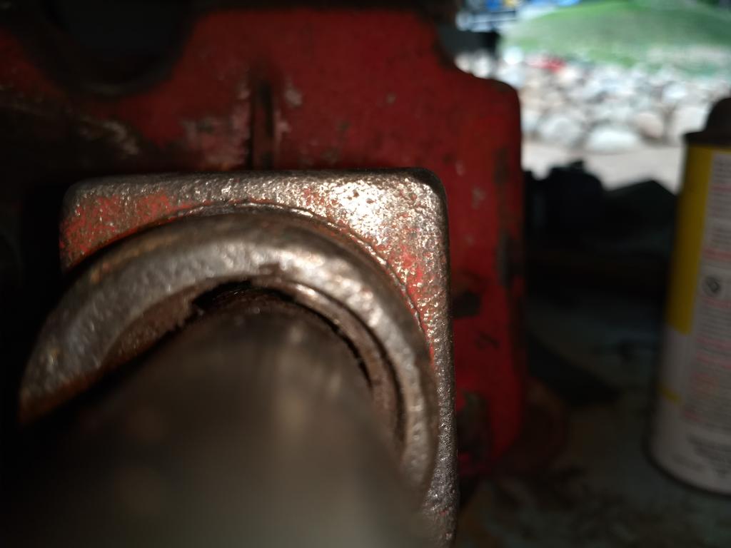

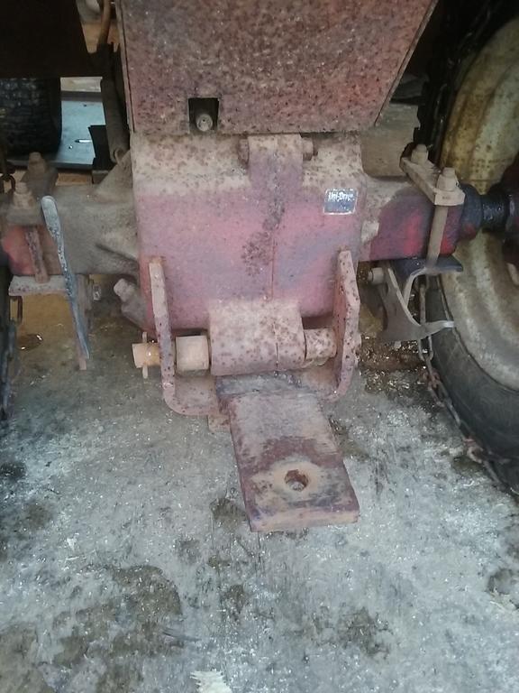

The 657 came with a liftable sleeve hitch on it. Well frozen into place by rust of course.
We're not going to be reinstalling the lift mechanism which was only partially there anyway. Cable was actually looped all the way around the transmission for some silly reason.
So I took a few minutes over the last couple days with heat and hammer and rust penetrant and patience and got the pin out of the transmission.
Here's some before and after pictures of the hitch that used to be on my c-160 when I got it. Note the strange tab hanging straight down below the transmission. No idea why that was there. This is clearly some kind of homemade or company made hitch. It resembles a Wheelhorse hitch but the angles don't match up and the holes are a little off center.
When I put that hitch on the 657, the back of the hitch actually was smashing up against the drain plug for the transmission.
I knew I needed to cut off the huge vertical tab so I just took an extra half inch off to compensate for improper positioning.
Me and a Sawzall and a grinder and an hour or more and it was taken care of.
It's now all primed up and ready to be painted.

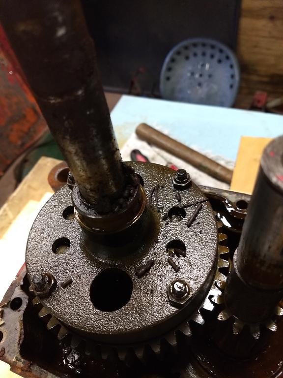

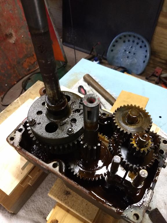

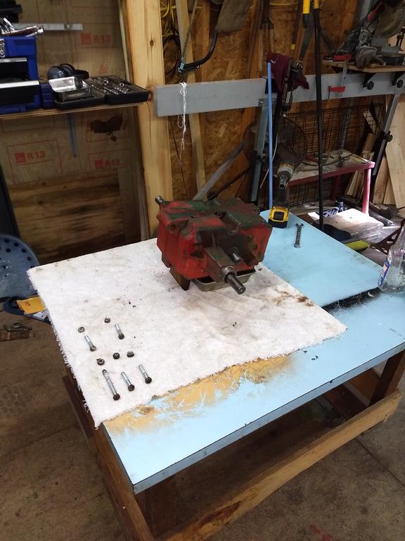

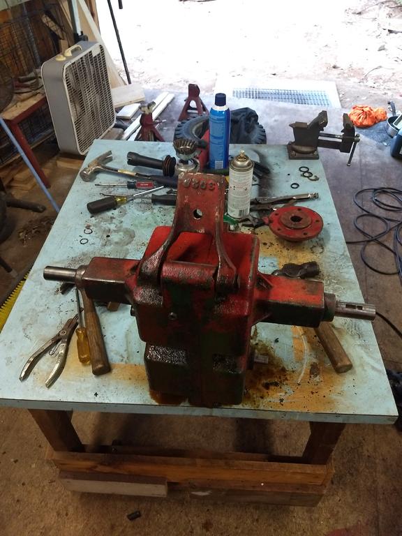

Poking around in the transmission to find the issues this morning.
ebinmaine
I took out the differential and discovered that the wheel bearing in the other side was also in very poor condition.

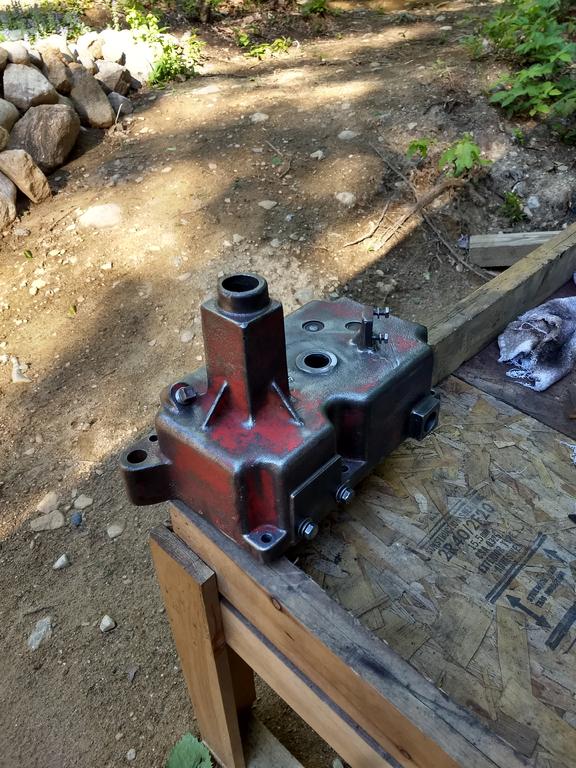

Spent quite a bit of time today cleaning up the case half that was off and degreasing and depainting and derusting and priming it.
Also obviously had to take out every single nut and bolt and washer and lock washer and wire brush all of those.
Very time-consuming work but I really do enjoy doing this.

Emptied all the gears out of the shallow half of the transmission and all the other bearings looked great!

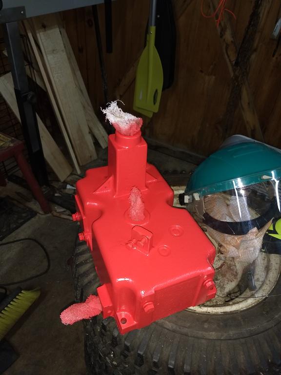

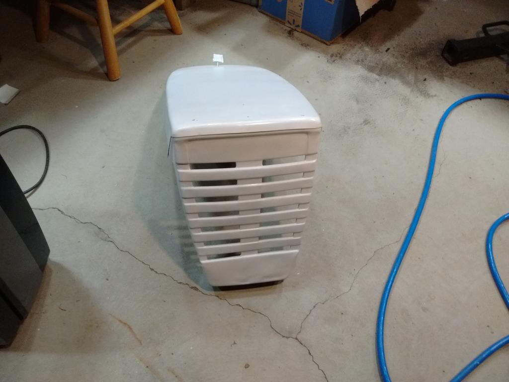

My honey spent some time tonight finishing up cleaning the hood and then priming the top surface of that. The case half that is white in the above pictures is now red.
Couple of other small pieces got primed or painted tonight. Little plates. Pulleys. Stuff like that.

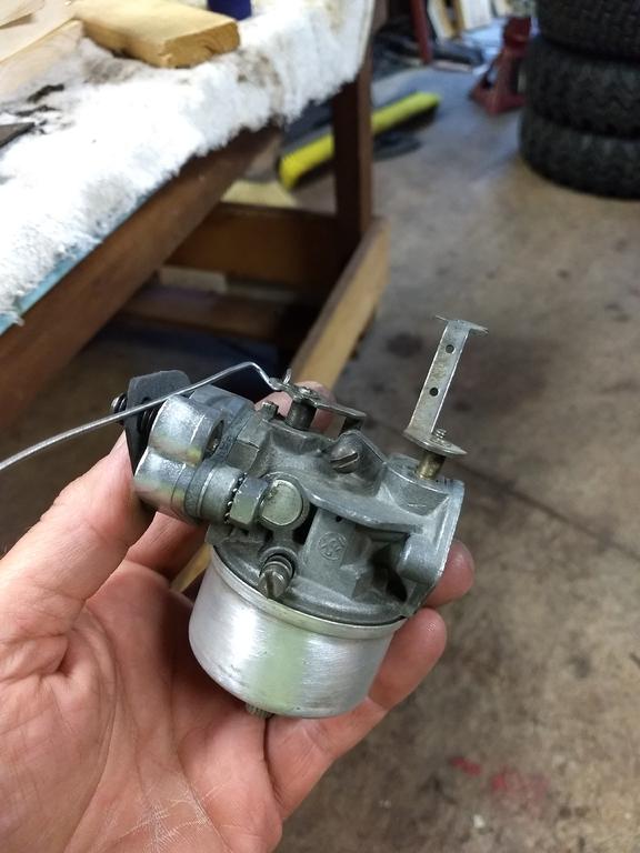

So for tonight's festivities my Honey wire brushed the toolbox area / seat base.
Then she primed that and also put a coat on the inside of the hood and a second coat on the trailer hitch.

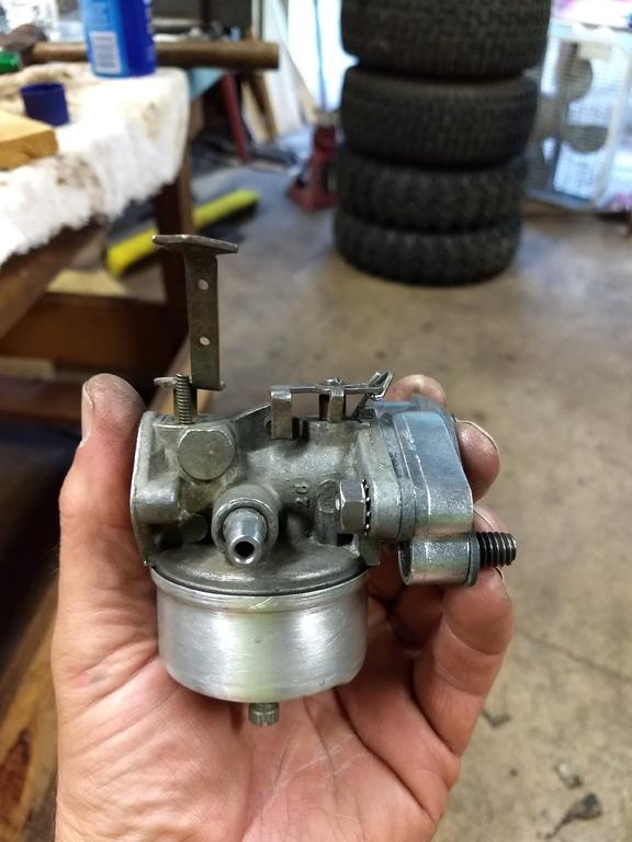

I wire brushed a whole bunch of bolts and then did a wash-out and threw a gasket or two in the carburetor.

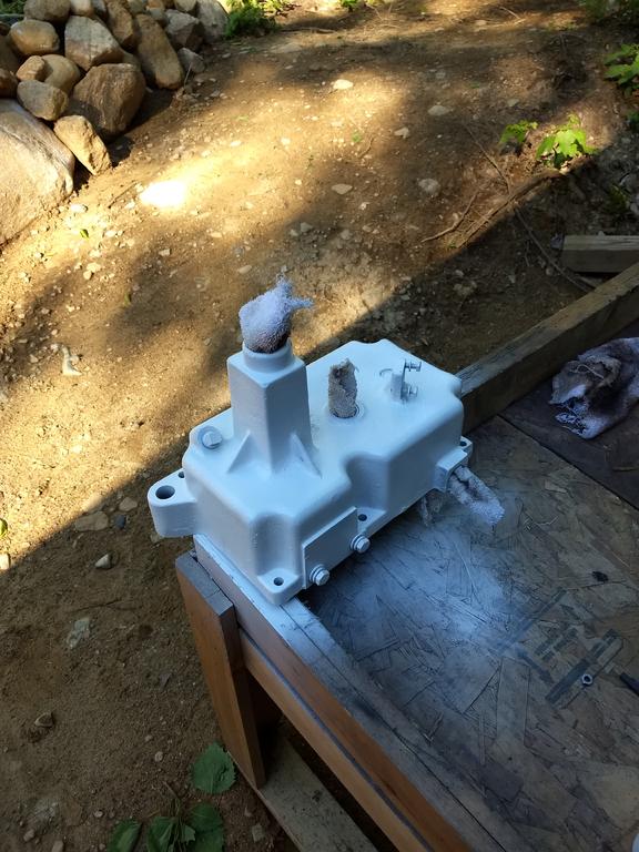

Here's a pic of the transmission half in its new coat of red.
  • Excellent 3
