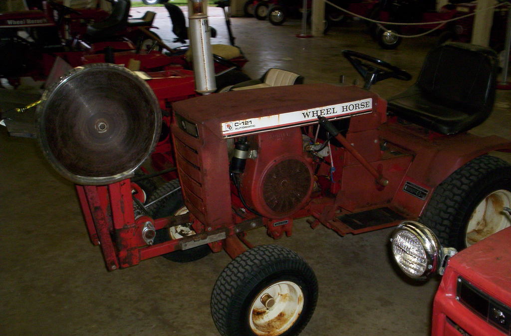

Might be better off with one of these.
  • Like 1
What is that? I've never seen anything like it, but I know I want one. More pics?
Tractor mounted buzz saw, open this post and check this video out.

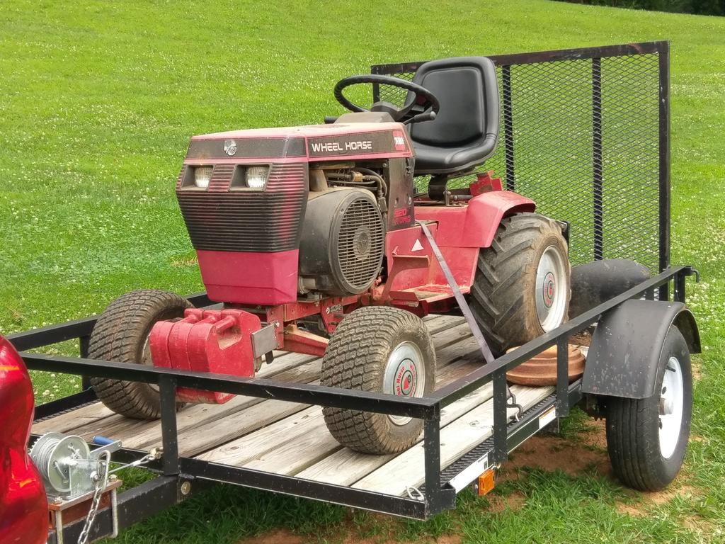

Dick pretty much nailed it on this one. My B has over 250 lb of liquid weight alone. Another hundred lb of wheel weights.
I'm guessing the total weight of the tractor to be a little over 925 lb right now.
As far as tires go, I would not even consider using plain unassisted turfs in my woods. Traction is honestly pretty much zero. I put a large set of Carlisle ags on and I've been very happy with that unless I try to go over a wet tree root and I then lose traction. As @Jerry77 stated, with that engine pulling on logs you will run out of traction before power. I'm going to try using chains at some point but I kind of use my lack of traction as a safety net.
On the concern of trailer safety, I've pulled around 1100 or 1200 lb of trailer behind me through rough hilly woods. I am always conscious of the lack of braking in this situation and am very careful about taking it very slowly.

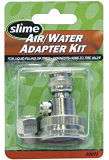

On 6/24/2018 at 12:44 PM, Professor1990 said:
Thanks Professor1990. I picked up one of those water/air valves. I already have an old 12volt rv pump I use for winterizing buildings (I'm a plumber). It should make the filling nice and easy if I put a shutoff valve before the adapter. I'm going to go the windsheild washer fluid route. I got my chains installed and WOW! The thing does not slip on the hills at all. My fuel pump went out though, so I got sidelined waiting for the replacement to arrive.
