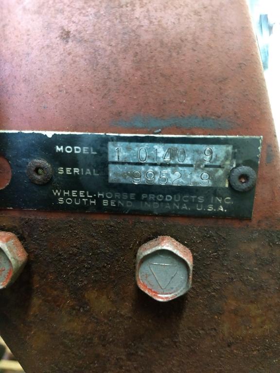

@gwest_ca you seem to be the go-to person for model number identification so if you would be so kind, here's the one off of the aforementioned tractor that we are trying to identify.
From the front of the frame to the back of the transmission mounting plate this measures 35.5 in.
Racinbob
That's a 1974 B-80 Eric. :)

@Racinbob is correct that ID tag is of a 1974 B-80. So someone must have bolted up a 8-spd transmission to it, because 74's had a 4-spd.
Racinbob
In 1973 they had an 8hp 4 speed with a Tecky and an 8 hp 8 speed with a Kohler. I suppose it's possible a few 8 speeds were left over and they retagged them but I think the transplant is more likely. :)

Bob, I am by no means an expert but I believe 74 and 75 were all four speeds if it was a B series.
My 1974 B 80 has a Kohler 8 horse with a 4 speed in it. I'm only the third owner. Chances are nearly 100% that that is how it was made.
Racinbob
Correct, 74 & 75 B's were all 4 speeds. In 73 they made B's with 4 speeds and 8 speeds. But my thoughts there go out the window because the 73 8hp 8 speed was 45.5" and the 8hp 4 speed was 43.5" :)
