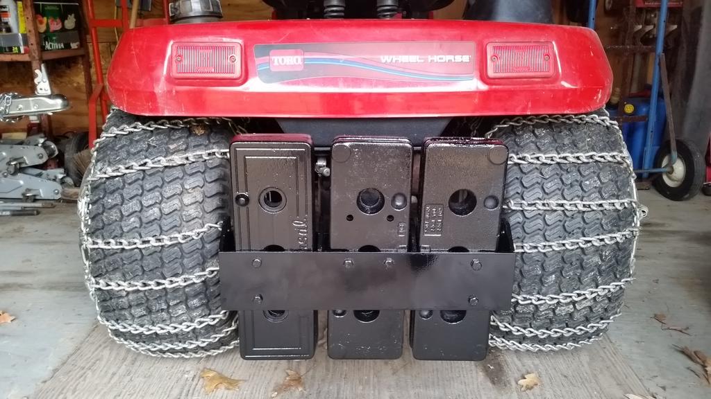

Xearl 131 #26 Posted April 2, 2018 This is 120 lbs. and works fine for me if I can stop stripping the brass gear . 2 Share this post Link to post Share on other sites
