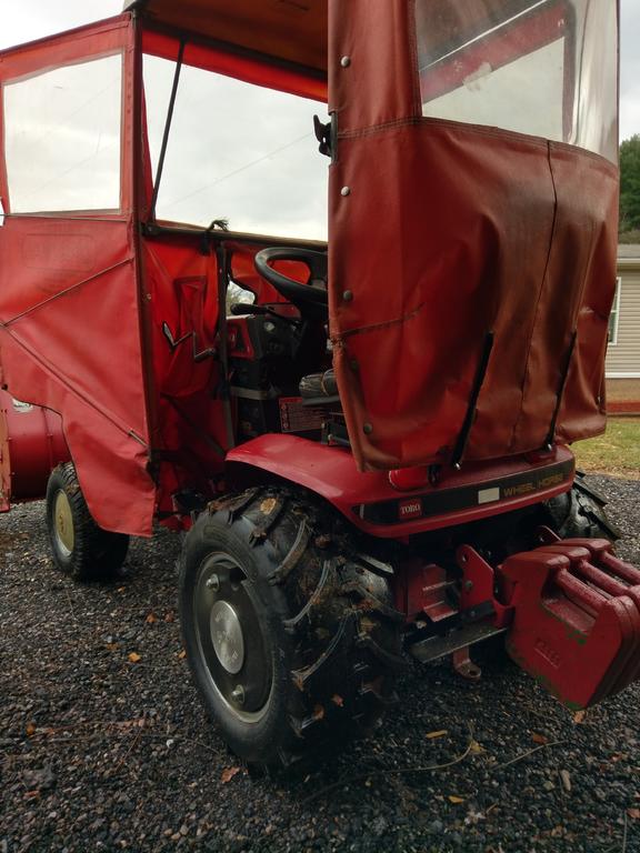

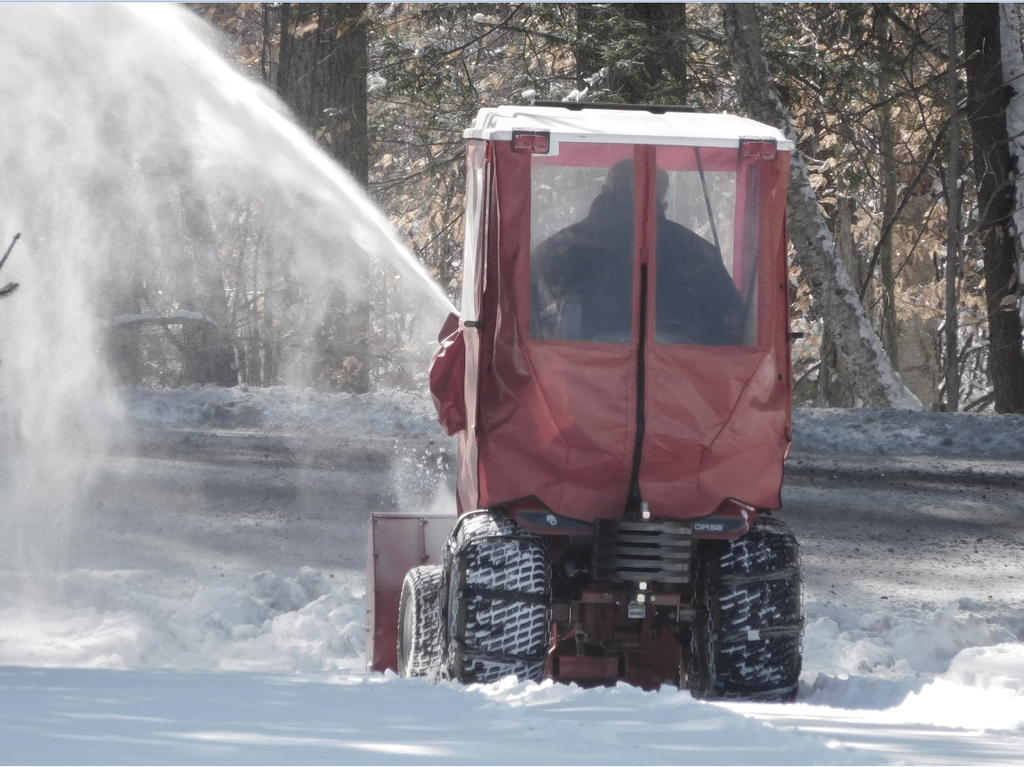

WVHillbilly520H 10,379 #11 Posted February 24, 2018 1 hour ago, Forest Road said: Almost forgot. You will need 300-500lbs ballast hanging off back of tractor to get the most out of her. I’m 275lbs and I’d be stuck without the extra weight. I have done well with fluid loaded tires 150# cast wheel weights and 120# suitcase weights hanging off the back the cab and my 180#, but the blower or cab hasn't came off since mounting 2.5 years ago since I have an extra 520, Jeff. 3 1 Share this post Link to post Share on other sites

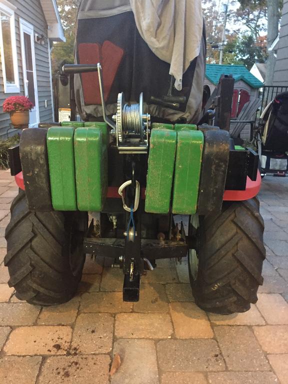

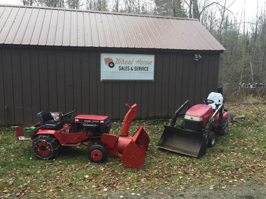

Forest Road 595 #16 Posted February 24, 2018 3 hours ago, roadapples said: @Forest Road I assume you have to stand it on the auger and pull the plate off of the back gear box to check it? And what oil? Thanks I use regular gear lube. Whatever’s available. 75 to 90w whatever you can get your hands on. I’ve been know to put a bottle in a pan next to my wood stove for the night. The front auger case I do w the machine sitting normal. It rarely takes much. The 90 degree gear case I pull the plug and so long as something runs out I’m happy. I’ve never taken the covers off it. As as for the weight my tires are loaded approx 100lbs each 55 lb wheel weights and I have a custom ballast box w a few hundred pounds. Weight hanging off rear is far more effective that loaded tires 1 1 Share this post Link to post Share on other sites
Forest Road 595 #17 Posted February 24, 2018 I have 2 different ballast set ups. Both tractors have 2” receiver hitches. The racks are interchangeable. One on 314h has an original ballast box. I keep 5 gal gas can in there w some cast iron underneath and 4 suitcase weights to the sides. The Xi loader combo originally had a factory ballast box that just seemed to be in the way. The hitch and rack offer alot more versatility. My property is relatively level and all dirt and gravel. The road is 1/2 mile and requires me to cleanup a bit after my snow plow contractor, or pay for a backhoe to come in. With the drop offs weight in rear has been the difference in self extraction verses a tow from another tractor or truck. At times the snow it setup stiff and the weight gives me the extra traction to punch through 5 Share this post Link to post Share on other sites

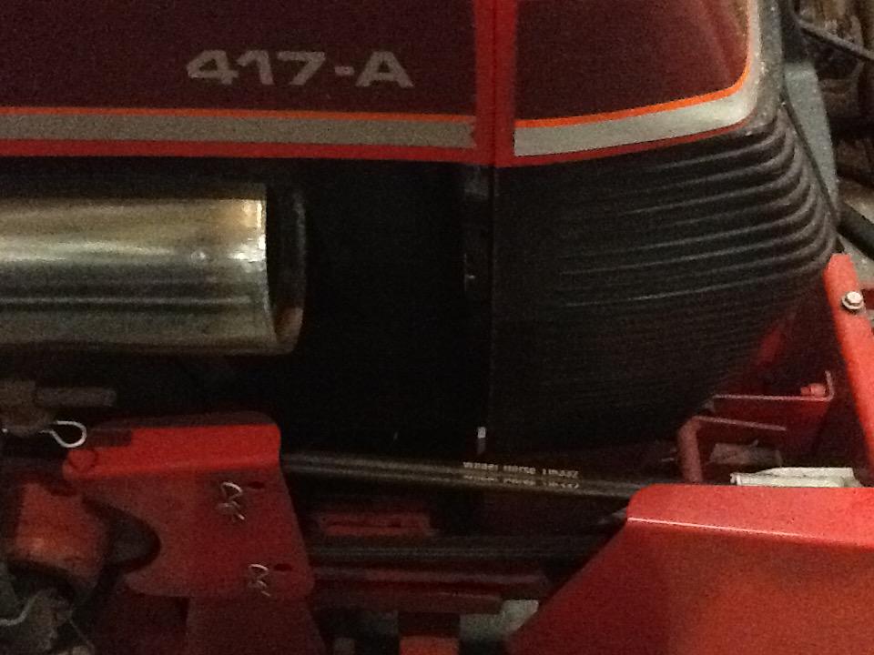

Artmilaca 23 #18 Posted February 25, 2018 On 2/23/2018 at 7:37 PM, c-series don said: Definitely, I have one on a 417-A and love it!! Is the belt length different from the 520 with Onan than 417A with KT17 ? I got the 2 stage blower mounted up in the middle of a blizzard and well after dark. Once I had it mounted up came the pain....The belt is about 5" or more shy of going over the pully even with blower up. As far as I know it was mounted on a 520 with Onan Share this post Link to post Share on other sites

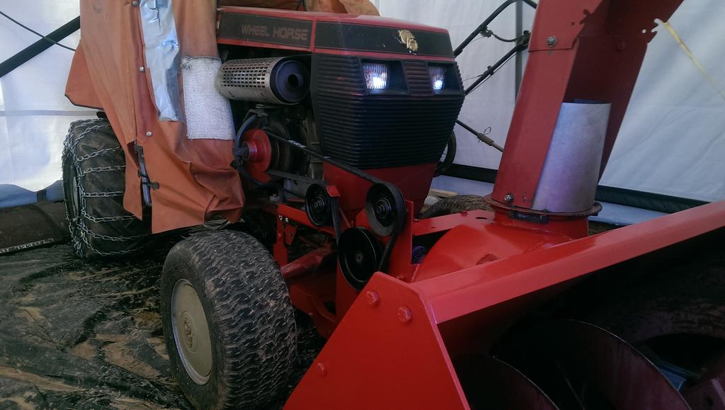

Kurt-NEPA 756 #19 Posted February 25, 2018 (edited) I have my two stage mounted on a 95 520H. It has a Pix (TSC) 5/8" X 65" belt on it that fits well. Not sure about your 417A, but its worth checking the belt length. The tensioner on this beast has a lot of travel, so I would take all the tension off it first. I know mine is a tight fit. I'm a fan of ballast weights too. When I first set mine up, I used 70 lbs wheel weights in addition to chains and my 265 lbs. It was not enough if I had to back up hill with the blower raised. I would just spin. I added about 150 lbs of ballast weights and does just fine now. I've even been able to use rubber chains. My ballast weight. Edited February 25, 2018 by Kurt-NEPA Add Picture 3 Share this post Link to post Share on other sites

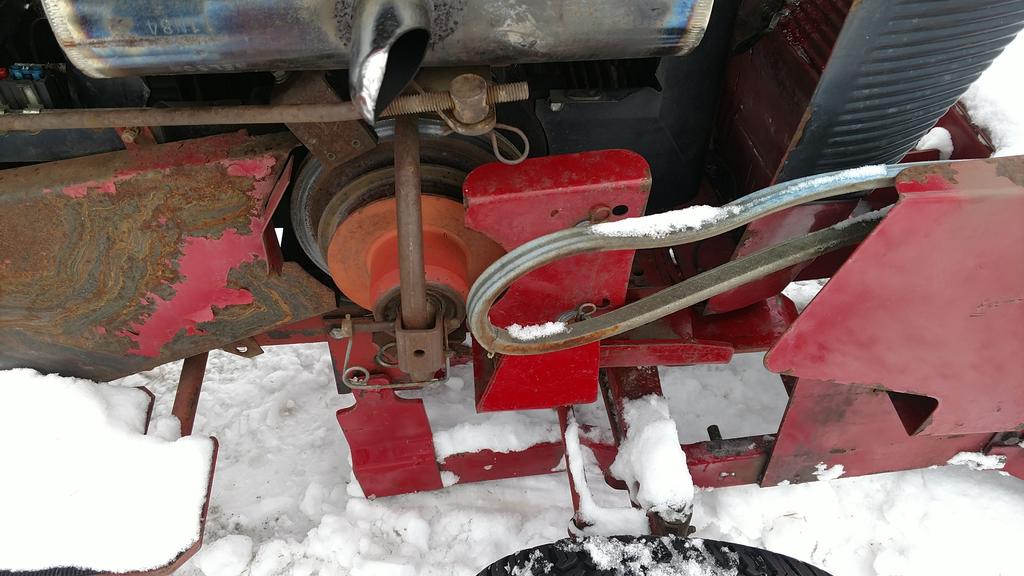

Forest Road 595 #20 Posted February 25, 2018 To get that belt on you need a box wrench on the idler pulley. Think it’s 9/16 or 5/8 put it on the pulleys bolt and pull it back toward tractor. Then the belt should slip right onto smaller pulley on your motor. 2 Share this post Link to post Share on other sites
