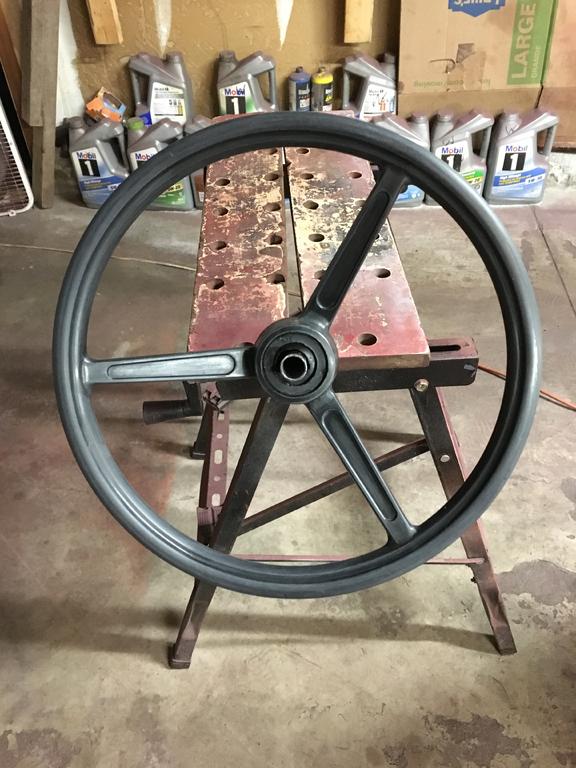

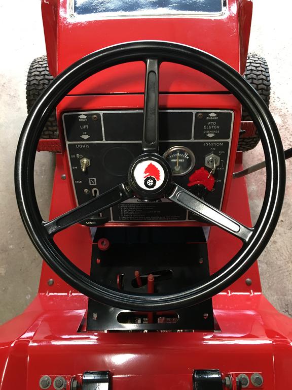

Only minor cosmetic repairs needed to the steering wheel...then scuffed upto 600g:
a few coats of VHT vinyl dye & the mail lady dropped off a package from @GlenPettitright when I was driving the roll-pin home.  Blown away by the quality of the steering wheel cap & keychain Glen!

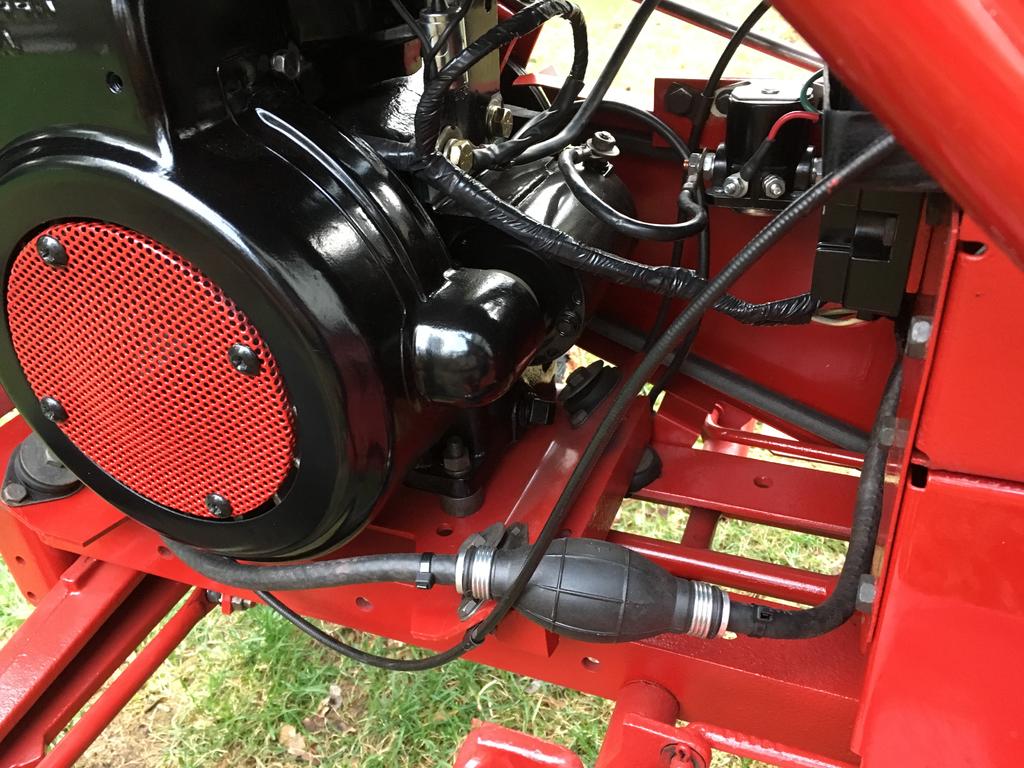

Well, it fired up but ran like crap.  After swapping out the original fuel pump (had an OEM plastic one), filter and points, I started resetting the static timing when I realized my boneheaded mistake at the coil.
I had a ‘dash’ wire marker when I made my wire harness…thinking that it meant “I” for ignition rather than “-“ for negative terminal!  Now it jumps to life with a bump of the start switch and purrs.
I can’t believe it even ran and that I didn’t fry anything (although the points looked a little worse for wear before swapping them!)
I get a little lean pop every once and awhile which goes away when I reach back & give the marine primer bulb a squeeze.
I’m thinking of moving the primer bulb (and check valve) to the engine and putting the filter back at the tank.

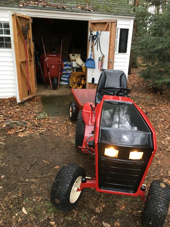

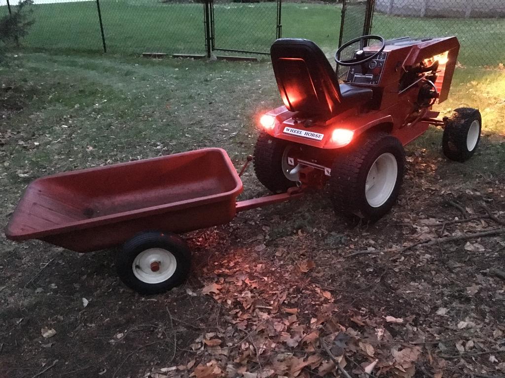

Anyways…enough yapping and here are some pics from this afternoon (between the rain showers.)
We just need to throw on the side hood decals, "new" saddle when it arrives and make a tweak to the fuel system.

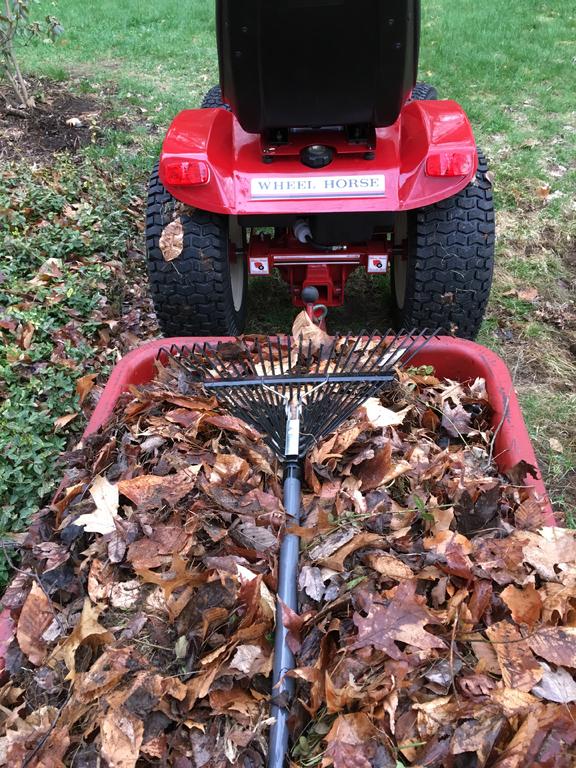

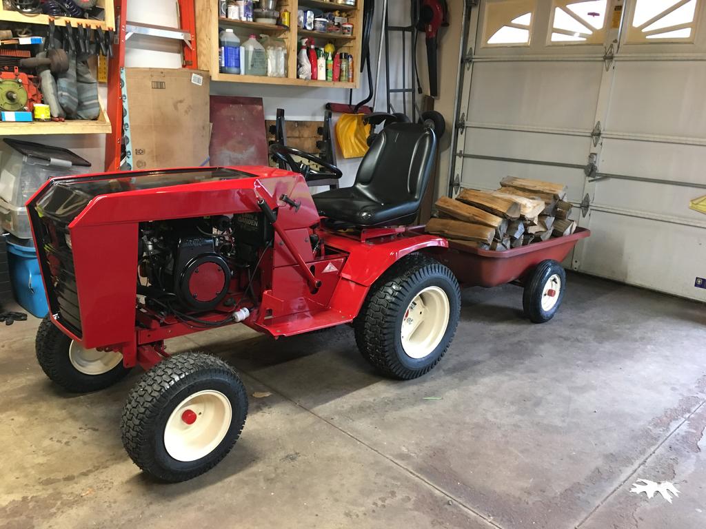

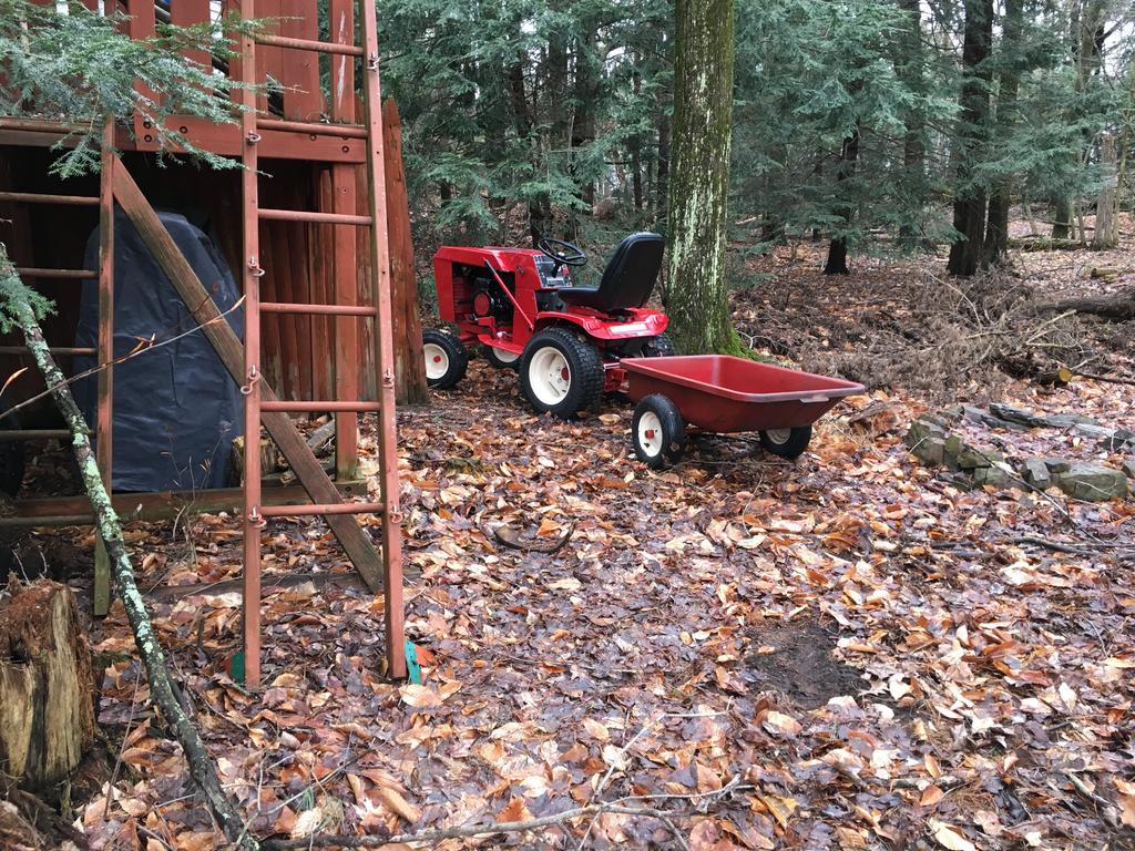

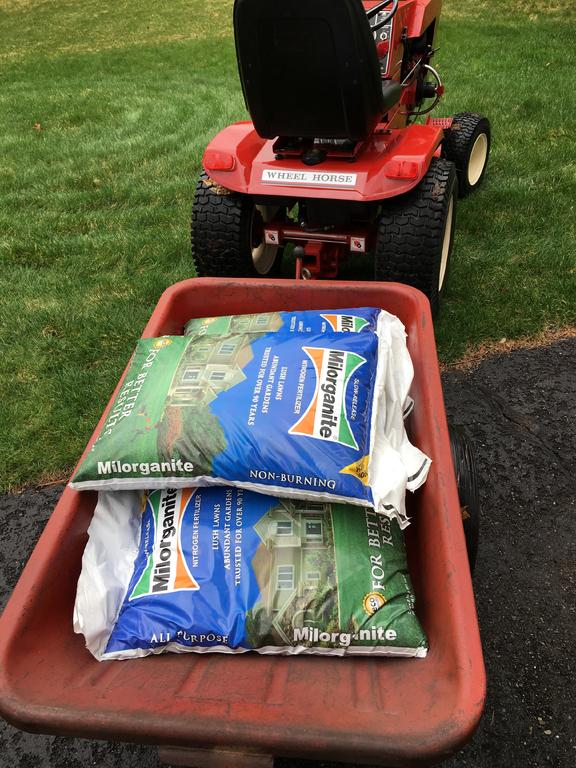

I swapped the primer and filter and played...er I mean worked... cleaning out the planting beds this evening.
Worked like a charm; the machine performed flawlessly hauling somewhere between 4 and 40 loads back to the woods. :lol:
Honkin' filter between @Vinylguy's decal and @wheelhorseman's hitch receiver.

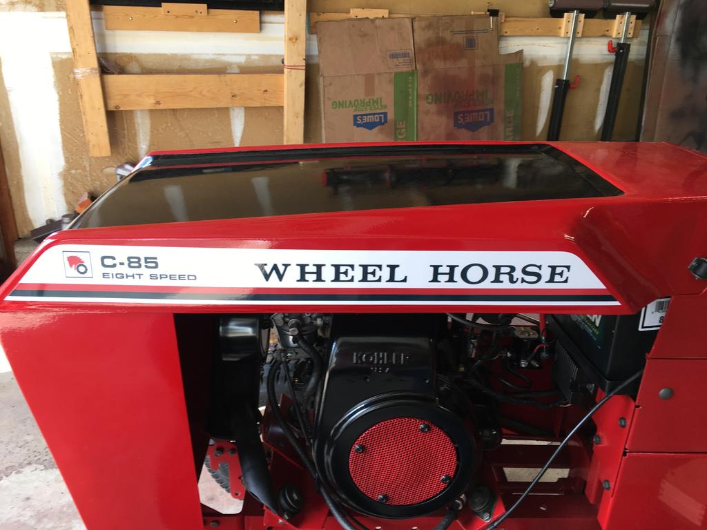

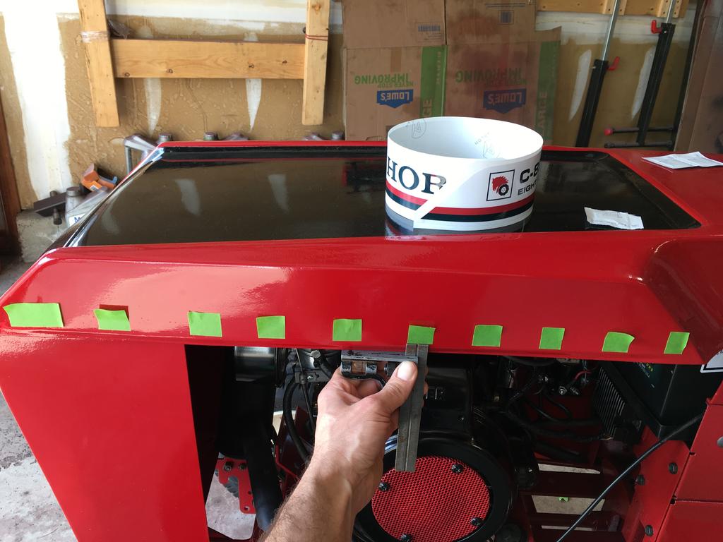

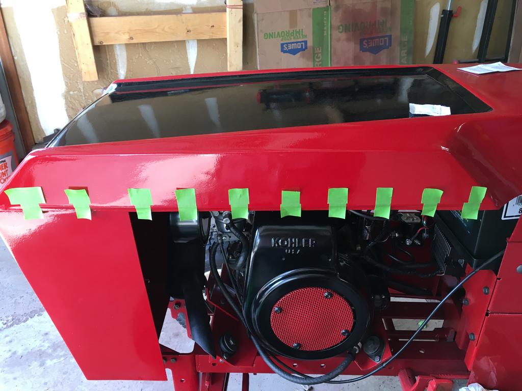

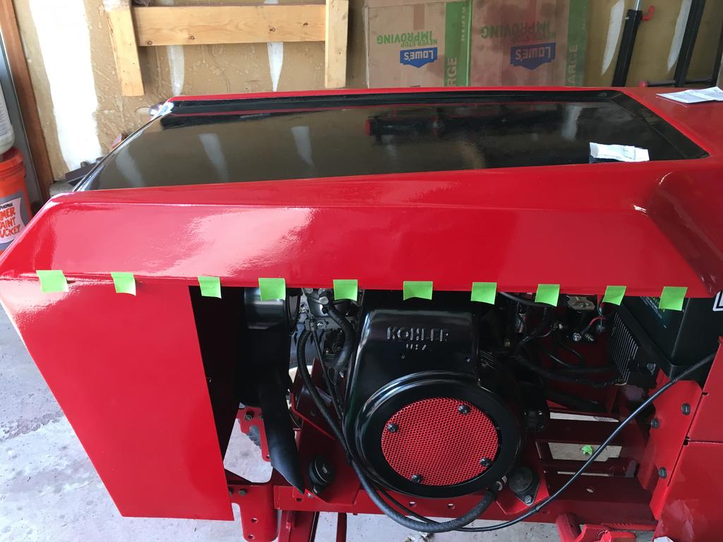

The biggest fear for me in this project (bigger than splitting the tranny!) was screwing up Terry’s big hood decals.
I dove in with both feet this morning for a dry install.
setting the distance with a market pass 1/2” from the bottom hood edge.
Butting the guide tape up to the marker tape
Removed the marker tape then wiped down with IPA and blow dry.
Wearing nitrile gloves, peel and stick.  No bubbles or fuss.
D55AA5B0-8959-488D-A5E1-38EF5A195041.jpeg.5afb5dee6de4b6c0d140ed78e062ad49.jpegA81E960F-C26E-4B66-A642-E2BDE829923C.jpeg.08dd2a5a48eaff2aeef3193e69ab190f.jpeg

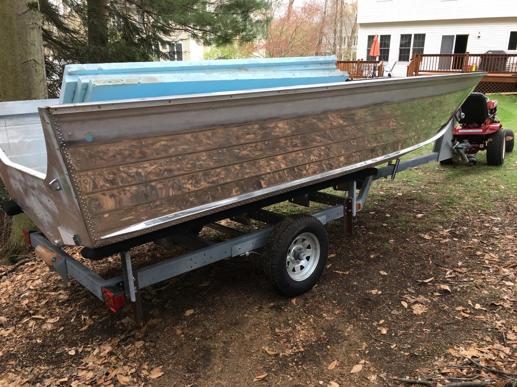

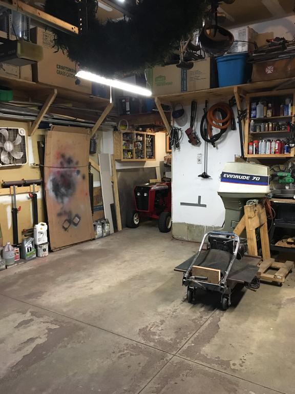

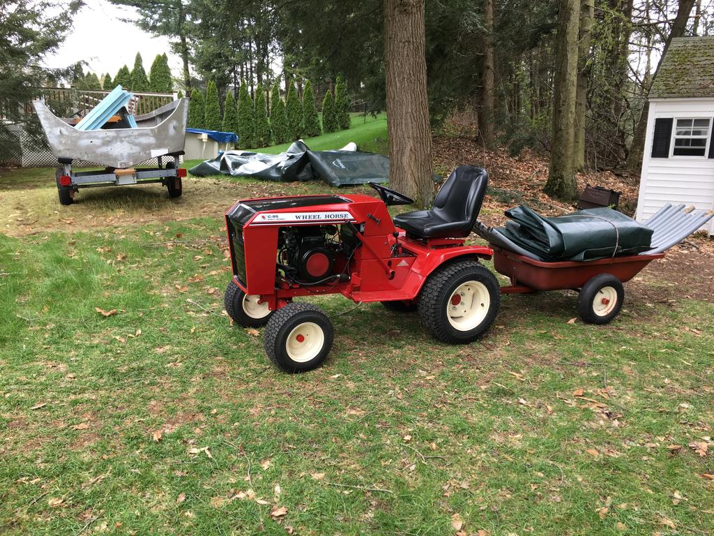

More seat time today...and my back is VERY happy!
I store my boat in a Shelter Logic portable garage in the winters and have been disassembling it come spring until I setup something more permanent (without violating my deed restrictions...too much :ph34r:)
Hauling the garage bits back to a loft in my garage:
Then eventually pulling the boat!  (The sides were sanded upto 800g then polished with Zephyr  wheels/clays last summer.  The top-most faux lap-strake will be tip-n-rolled white once I'm finished with the interior.)
If you like watching paint dry, you'll like this video I shot this afternoon pulling the boat in Low-1 :lol:

maybe when Homer sees that you’ve run out of tractors, he will cave :)
This boat won’t be breaking an speed records (low to mid-30s expected) since it will be powered with the original  3cyl Looper.  So I’ll be keeping weight to a minimum.
heres the engine that I’ve partially restored (exhaust manifold was roached, seized t-stat, leaky lower unit seals).
^^^ The WH has a new designated parking spot in the garage:ph34r:.

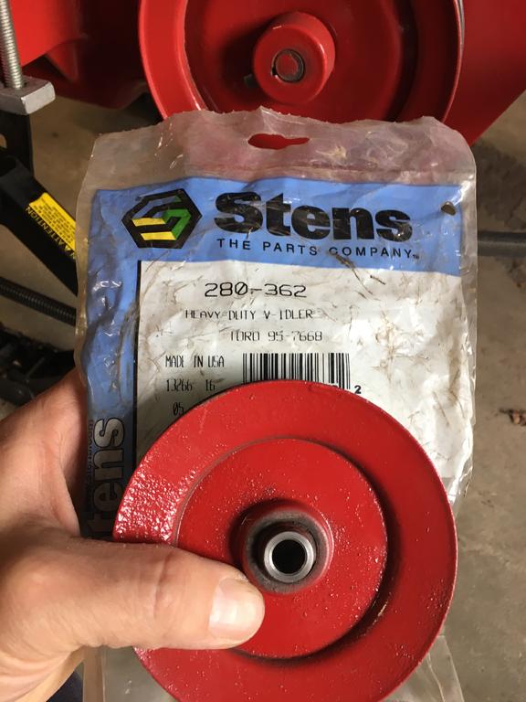

classiccat

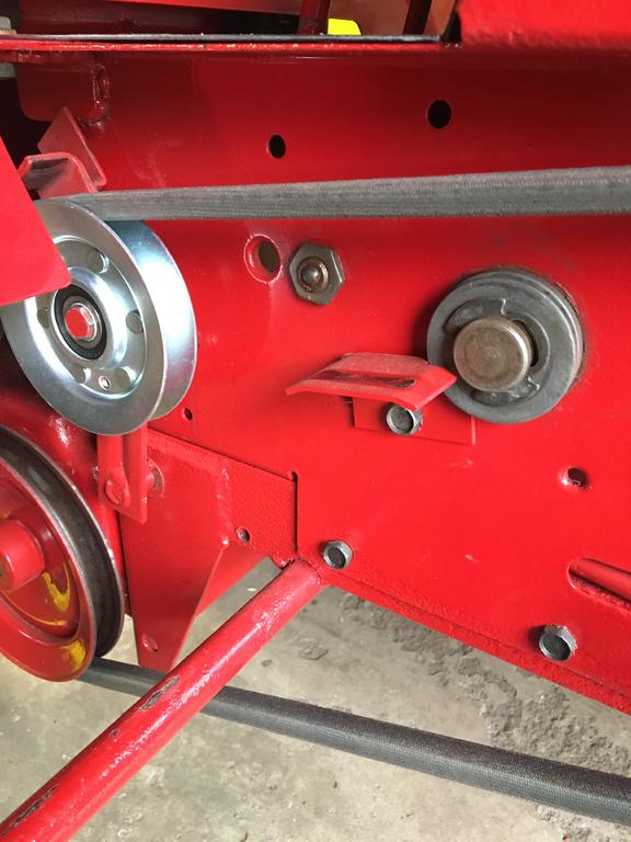

On 4/28/2019 at 8:07 AM, Tuneup said:
My WH gives a bit of a rattle, too, when the clutch is out and not in gear. It's likely the only pulley I haven't replaced and some attention to the bushings. I'll have to get to that.

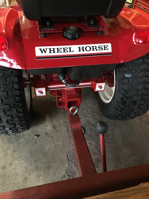

@Tuneup... spot-on with the clutch pulley.  I didn’t even notice the slop when I had it apart...and I had made peace with the rattle!
theres a bearing-equipped Stens assembly (280-362) that runs about $12 shipped...tightened things up really well.
^^ Since this picture was taken, I had to add a washer to the shaft bolt since the excess thread was rubbing on the brake linkage pivot axle.

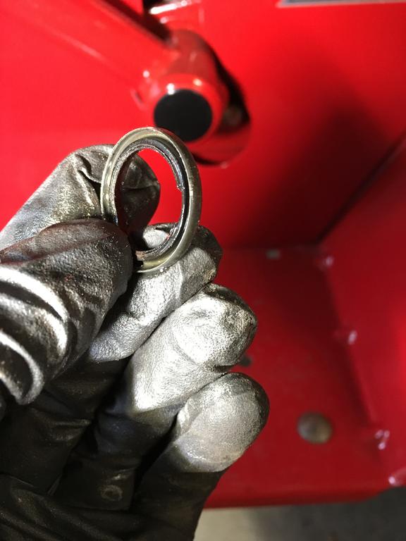

I had to also address a leaky (damaged) brake shaft seal (replaced the SKF with a toro/wheelhorse nos seal).  Must have lost a chunk when reassembling the trans halves.
