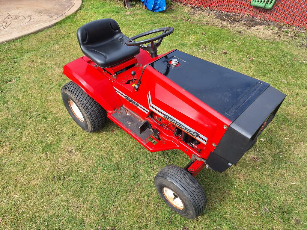

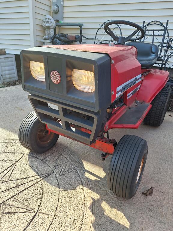

So last fall I got this Dynamark riding mower for free. Engine ran but when you stepped on the clutch/brake it wouldn't disengage. Looking at it I noticed it was a new drive belt. I figured PO got the wrong belt so I looked up what I thought would be the correct belt and ordered it. When it came I removed the belt that was on it and it looked to be the exact same size as the new one. Put new one on and same thing. That was an 82 inch belt. So I looked again and saw that a similar model had an 85 inch belt so I ordered one of those..... close but no cigar ! Now I ordered an 86 inch and are waiting for it. In the mean time I noticed water had gotten into the gas tank. The gas cap was the style with a gage but the bubble is busted off. Since the cap goes through the hood on top water leaks in. I need a new cap but having the same issues finding correct one. I don't need one with a gauge just one the screws on tight. Any help works be appreciated as I am finding multiple part numbers.

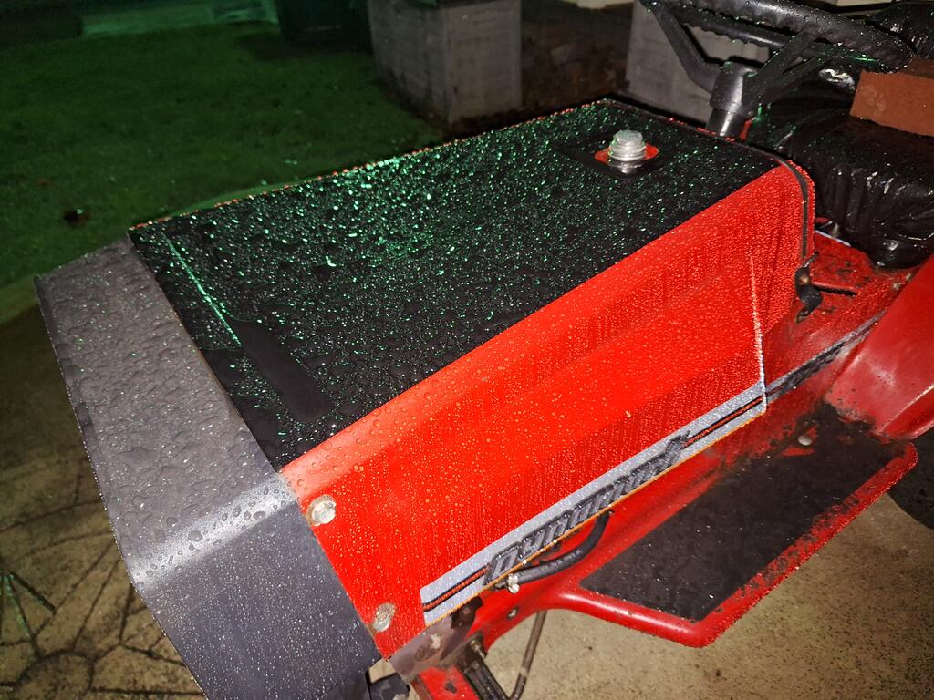

I just stopped at Ace Hardware and got a simple metal cap. Not exactly sure how it's going to keep water out being that the vent holes are on top of the cap and the cap goes through the hood. Guess they are made to be kept inside. Too bad for the Dynamark that my garage is full of Wheel Horses. The 3rd drive belt should be delivered tomorrow. Hopefully 3x's a charm !
D_Mac
Well an update if anyone cares. I got a v belt on that seems to work. It is 86 inches long. The manual that I found online called for an 82 inch belt. I got a gas cap that fits. The manuals replacement cap called for a 2.25 inch cap. The one that I got that fits is a 1.5 inch cap. It's puzzling because it is all original. The pullies and the tank had not been changed. The part numbers I have been looking up have been coming from a pretty popular online small engine parts company. Today I'm putting new tubes in the front tires. Then some clean up and oil change and send it down the road. All said and done I'll have 60 bucks into it. Oh one more thing. I do have the deck for it but it is missing the front deck hanger. In the manual the part is not even listed. It's not on the deck diagram or the body diagram.  I know it's missing because I tried mounting it and in videos and photos of same tractor I can see it in middle of front axle.

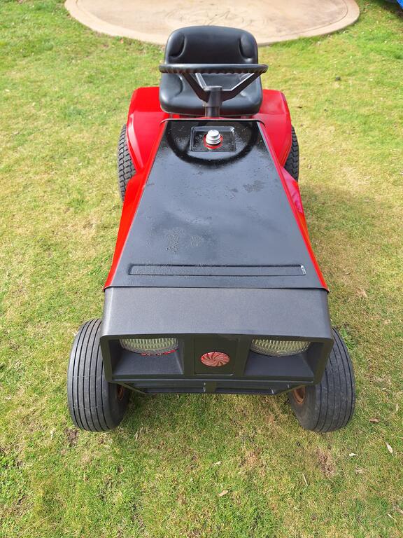

D_Mac
Posted (edited)
So I now own a black hood. I went to the dark side...... kinda.
A little paint , duct tape , wax, and elbow grease goes along way.
Edited by D_Mac
