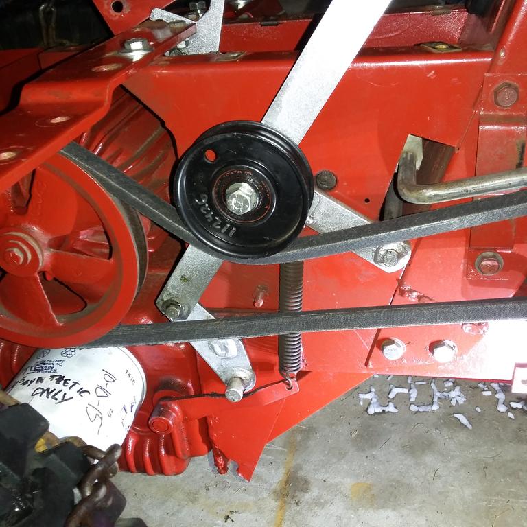

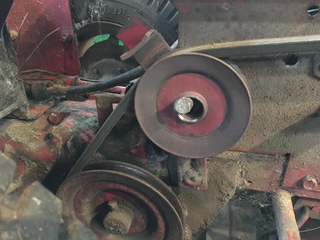

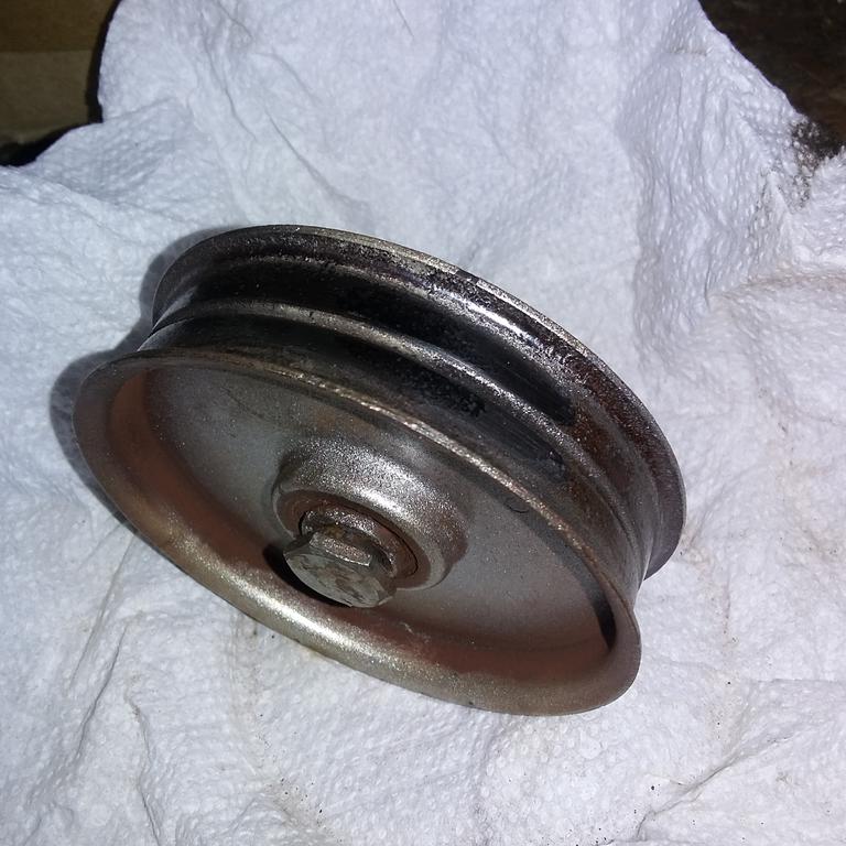

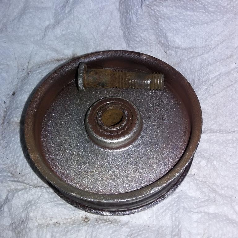

BOB ELLISON 2,983 #1 Posted February 2, 2018 Some dummy forgot to do it when the weather was nice . And I know I waited to long to replace the idler pully on my C160 and I should have done it in the fall. And it cost me more by holding off on a cheap fix. MY BAD. I noticed the idler pulley was bouncing in the spring but I thought I'll get it before winter. Last week while plowing snow I started to smell something burn. So I put it back in the garage and checked the belt. The top of the belt was starting to turn black. So I pulled off the guard and looked at the belt and the pulley was froze solid. I Pulled the pulley off and the pulley was welded to the bolt with rust . The Belt had a large deep crack in it . I ended up replacing the belt and idler pully. I have a toro dealer 25 miles from me and he had both the pully and belt In stock. 7478 belt and 112426 pully $67.00 for both. Well I got both on and it runs great now. I did notice the Parking brake handle has been repaired badly. The diagram shows a spacer goes in the handle so the bolt can be tightened that holds the idler pully. Well the hole was oblong so he welded a spacer to the handle and if I tighten the bolt it binds the handle. I put thread lock on the bolt hoping it holds until spring. I'll replace the handle with a new homemade one as soon as possible. I hope I don't wait to long again. So the morel of this story is . DON'T BE A DUMMY OR IT WILL COST YOU MORE IN THE END. And yes that is belt rubber on the pully. 5 Share this post Link to post Share on other sites

squonk 46,874 #4 Posted February 2, 2018 6 hours ago, BOB ELLISON said: Some dummy forgot to do it when the weather was nice . And I know I waited to long to replace the idler pully on my C160 and I should have done it in the fall. And it cost me more by holding off on a cheap fix. MY BAD. I noticed the idler pulley was bouncing in the spring but I thought I'll get it before winter. Last week while plowing snow I started to smell something burn. So I put it back in the garage and checked the belt. The top of the belt was starting to turn black. So I pulled off the guard and looked at the belt and the pulley was froze solid. I Pulled the pulley off and the pulley was welded to the bolt with rust . The Belt had a large deep crack in it . I ended up replacing the belt and idler pully. I have a toro dealer 25 miles from me and he had both the pully and belt In stock. 7478 belt and 112426 pully $67.00 for both. Well I got both on and it runs great now. I did notice the Parking brake handle has been repaired badly. The diagram shows a spacer goes in the handle so the bolt can be tightened that holds the idler pully. Well the hole was oblong so he welded a spacer to the handle and if I tighten the bolt it binds the handle. I put thread lock on the bolt hoping it holds until spring. I'll replace the handle with a new homemade one as soon as possible. I hope I don't wait to long again. So the morel of this story is . DON'T BE A DUMMY OR IT WILL COST YOU MORE IN THE END. And yes that is belt rubber on the pully. That center pivot pin gets worn also. I have a couple of them repaired by welding the original hole shut and redrilling and welding on a new pin. Those handles like to rattle when worn. Is that a 1410 filter? Share this post Link to post Share on other sites

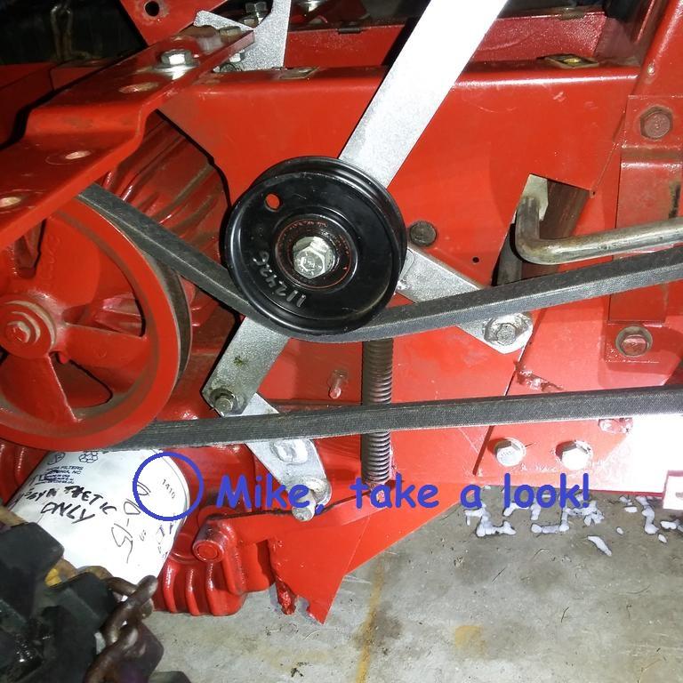

953 nut 66,614 #5 Posted February 2, 2018 48 minutes ago, squonk said: Is that a 1410 filter? Share this post Link to post Share on other sites
elcamino/wheelhorse 9,363 #6 Posted February 3, 2018 @953 nut You know Mike has trouble reading , plus numbers are a mystery to him. 3 Share this post Link to post Share on other sites

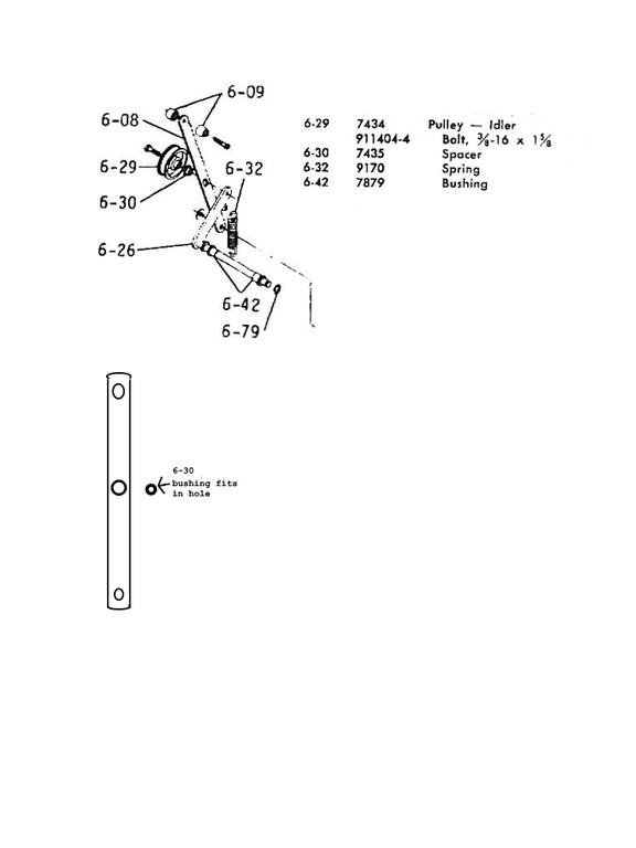

BOB ELLISON 2,983 #7 Posted February 3, 2018 @squonk nothing gets by Richard. I have a question for you . Am I correct in saying that the bushing goes into the hole so the bolt can be tightened ?? to me that's the only way it can go. Here's a diagram I got and I did a little makeover on it. 1 Share this post Link to post Share on other sites
953 nut 66,614 #8 Posted February 3, 2018 Bob, you are correct. Share this post Link to post Share on other sites
squonk 46,874 #9 Posted February 3, 2018 (edited) 1 hour ago, elcamino/wheelhorse said: @953 nut You know Mike has trouble reading , plus numbers are a mystery to him. Looking on my regular monitor sitting in a chair I couldn't see it with my crappy eyes. Blowing it up on a tablet like I'm doing now I can see it. Plus I had to braze today without the aid of dark glasses. Eyes take a beating. You better hope I don't steal your suspenders. You won't be able or allowed to go outdoors! Edited February 3, 2018 by squonk 1 2 Share this post Link to post Share on other sites

BOB ELLISON 2,983 #11 Posted February 3, 2018 @Sarge is that bushing brass or bronze? And yes I'm just going to make a new one . The other parts I'll inspect and if needed replaced them also. I'll do it when its warmer. Thanks guys 1 Share this post Link to post Share on other sites
Sarge 3,471 #12 Posted February 3, 2018 IIRC, the original seemed to be straight brass - I use bronze oil impregnated on mine. Any of those linkages that I've welded up get ER80SD2 filler rod , it's closer to tool steel and a lot tougher but expensive. Sarge 1 1 Share this post Link to post Share on other sites
