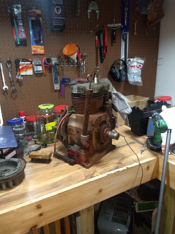

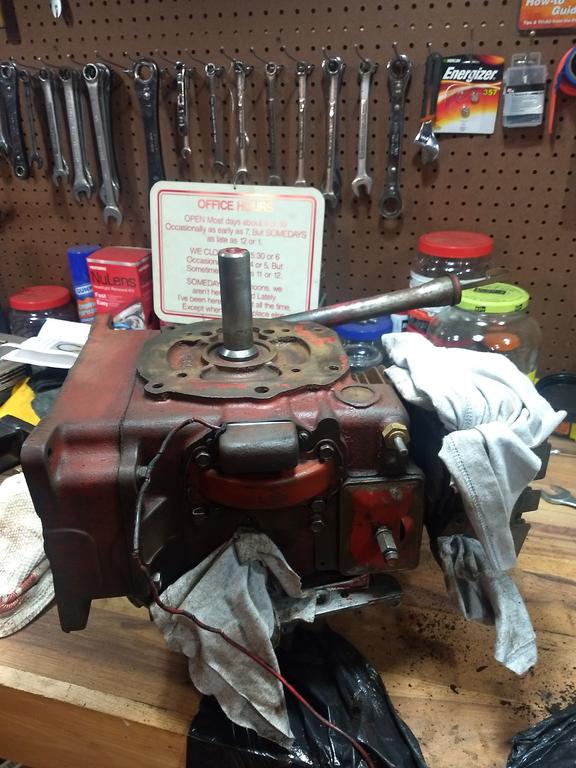

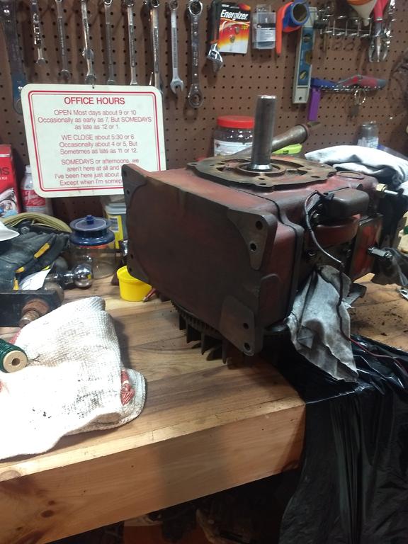

ebinmaine 79,745 #260 Posted January 2, 2019 She's a rollin' chassis now!! How do I remove the engine pulley to clean behind it? Trina worked on cleaning up the engine today. Here's a before and after comparison. 1 Share this post Link to post Share on other sites
WVHillbilly520H 10,378 #261 Posted January 2, 2019 6 minutes ago, ebinmaine said: She's a rollin' chassis now!! How do I remove the engine pulley to clean behind it? Trina worked on cleaning up the engine today. Here's a before and after comparison. Eric, it looks like a set screw on that pulley? If so make sure it's not a double and if have a 6" 3 jaw puller I believe you can get that pulley to move on the crank snout, but just my opinion as the K161 and K181 in the Cub Cadet Original is all I've done. 2 Share this post Link to post Share on other sites
953 nut 67,524 #262 Posted January 2, 2019 May want to use an air hammer on the thick part of the pulley going toward the crank. Go all the way around, then add more penetrating oil. Next day put a few hard wood wedges between the pulley and the block and tap them in tight, repeat the air hammer, tap the wedges, repeat, repeat. 2 Share this post Link to post Share on other sites
ebinmaine 79,745 #263 Posted January 2, 2019 @WVHillbilly520H We got the set screws to back all the way out. Still seems as though it has no intention of moving. 3 minutes ago, 953 nut said: May want to use an air hammer on the thick part of the pulley going toward the crank. Go all the way around, then add more penetrating oil. Next day put a few hard wood wedges between the pulley and the block and tap them in tight, repeat the air hammer, tap the wedges, repeat, repeat. I like that plan. Thank you. Is the Chrome sleeve that you can see which is part of the PTO attached to the crank or the pulley? I thought those just slid off but this machine likely has not been apart since 1974. 1 Share this post Link to post Share on other sites
Howie 900 #264 Posted January 2, 2019 Not attached to the pulley. Supposed to come off by itself, must be rusted to the shaft. 1 Share this post Link to post Share on other sites
953 nut 67,524 #265 Posted January 2, 2019 5 minutes ago, ebinmaine said: sleeve that you can see which is part of the PTO I hadn't noticed it. Probably that needs to be warmed up a bit to get it moving. I wouldn't apply too much heat, could damage it. 1 1 Share this post Link to post Share on other sites

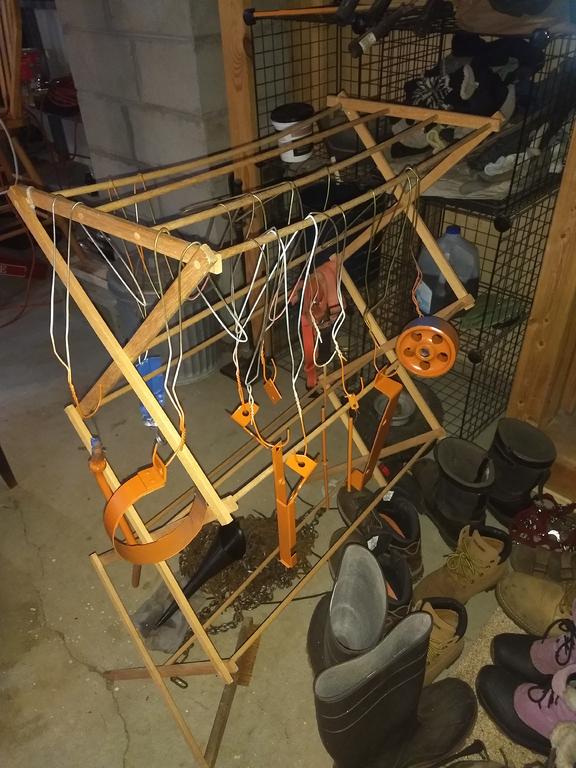

ebinmaine 79,745 #266 Posted January 13, 2019 Well over the last week or so we did the penetrating oil taptap repeat, and we finally got the Chrome sleeve for the PTO off of the crankshaft. After that I also removed the engine Drive pulley so Trina could clean behind it. We've spent most of today puttering around on the soon-to-be cinnamon horse. She spent several hours today sanding and scraping and removing General muck from the engine and brackets and such. Also finished emptying the oil from the engine and removed the drain and some other small parts. I was cleaning this and wire brushing that and installing a bracket or two and I put a seal in the transmission for the drive pulley. We spent a few minutes cleaning out the keyway and the interior of the drive pulley and I ground a couple thousandths off the key and finally got it all to go together. I wire brushed what seemed like 1 million bolts and nuts and washers and screws today..... And also cleaned off some of the parts and brackets and even cleaned the rust off a few tools. Every single one of these was covered in grease, paint or rust this morning. Trina did a little more painting as you can see from the next version of our Cinnamon Wheelhorse mobile hanging on the laundry drying rack. 1 2 1 Share this post Link to post Share on other sites

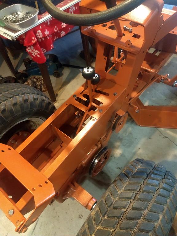

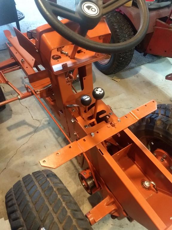

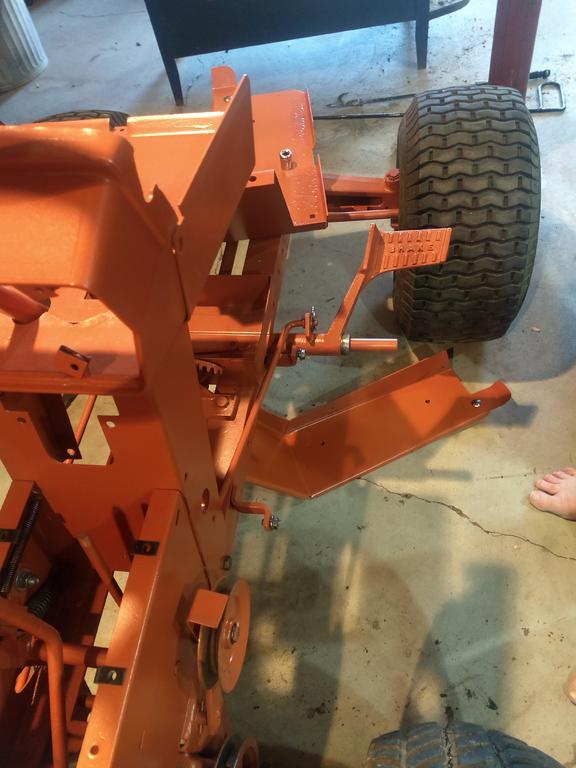

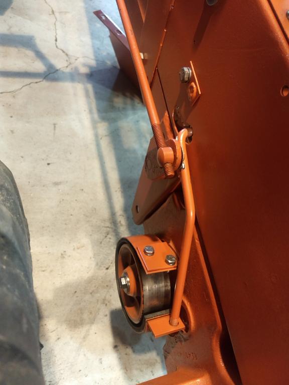

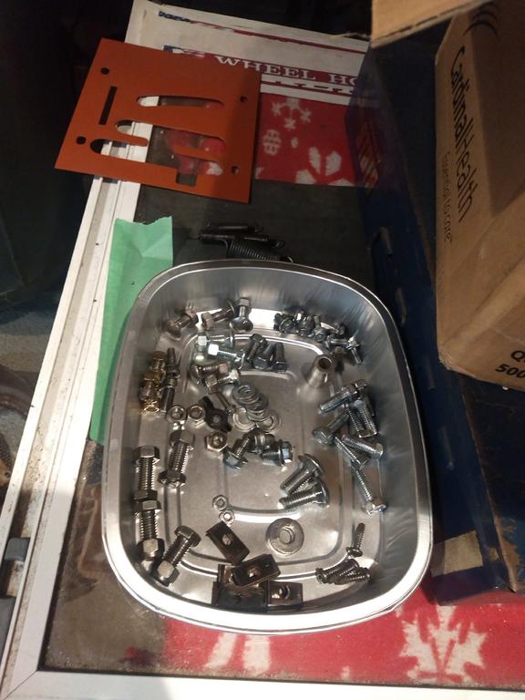

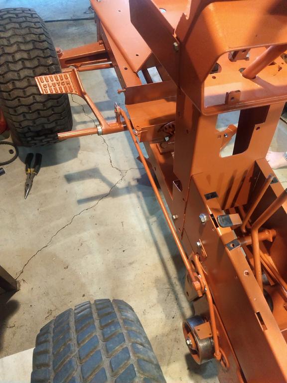

ebinmaine 79,745 #272 Posted January 13, 2019 Got in a little more time on the Cinnamon Horse this morning. Put a new brake shoe on that I had ordered from @rmaynard Bob. I need to remember to order another one of those to have in stock.... Installed the linkage and brackets for the Clutch and Brake pedals and parking brake. I can't imagine there would be a difference between a 74 and a 77 but the low high shift rod was at least a half inch too far to the left. I got after that with a wrench and put a little twist in it. All the nuts and bolts were wire brushed and cleaned up as I've stated before but I put some new washers and all the hairpins and cotter pins are new replacement. Shifter plate and the knobs are on. Next up will be to install the side steps. A few pics for you all. 6 Share this post Link to post Share on other sites
squonk 47,447 #273 Posted January 13, 2019 (edited) If you want to clean all of those bolts/ small pieces etc that are really gunked up without shooting said gunk all over you, your tools and bikini calanders, get a gallon can of carb cleaner with the basket. Toss em in and let them soak a day or two. The gunk will be gone and the paint will be stripped as well. Edited January 13, 2019 by squonk 3 1 1 Share this post Link to post Share on other sites
ebinmaine 79,745 #274 Posted January 13, 2019 @squonk Fantastic suggestion Mike. I do actually already have one of those carb clean kits here. I will absolutely do that in the future. Thank you. 1 Share this post Link to post Share on other sites

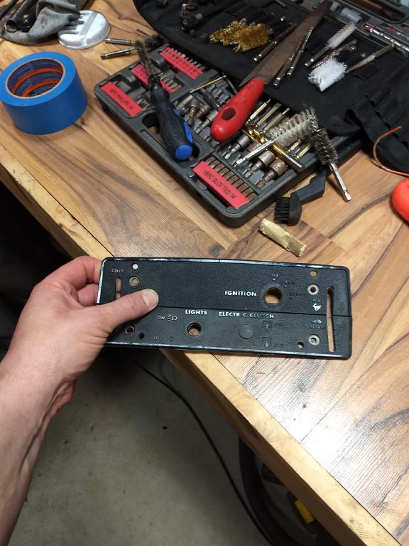

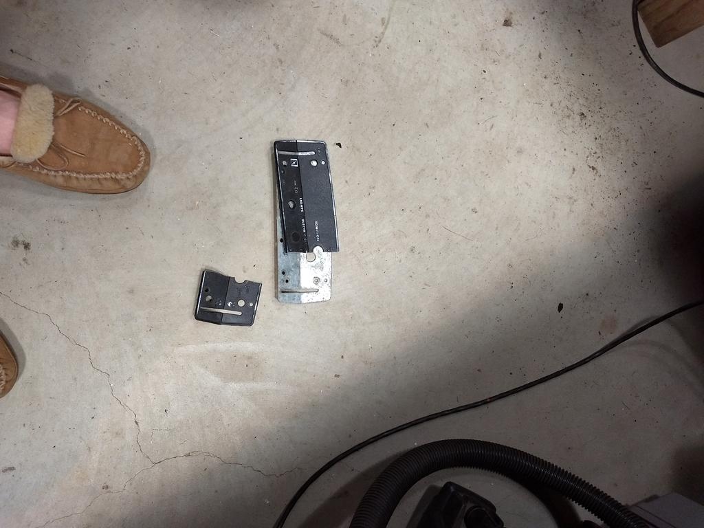

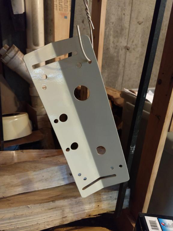

ebinmaine 79,745 #275 Posted January 15, 2019 (edited) I had a bit of an epiphany this evening. I really like the look of metal on an old tractor. I've replaced plastic gas tanks with metal. Tonight I was looking at the different dash panels of the B/C series versus the older tractors we have. I reeeelly like the look of the old school metal dashes but I prefer the sliding type throttle and choke control over the pull/twist lock. Well I was going to just clean up the C160 plastic piece and spray it flat black then repaint the raised parts white (or silver to match the tractor). Then.... I dropped it. WAAAAIT A MINNNIITT!!!! Loookie here.... A metal dash with the sliding type control slots!!!! So I cleaned it up and MMM scuffed it and my Honey throwed a little paint on it. Oh yeah.... Edited January 15, 2019 by ebinmaine 3 Share this post Link to post Share on other sites
