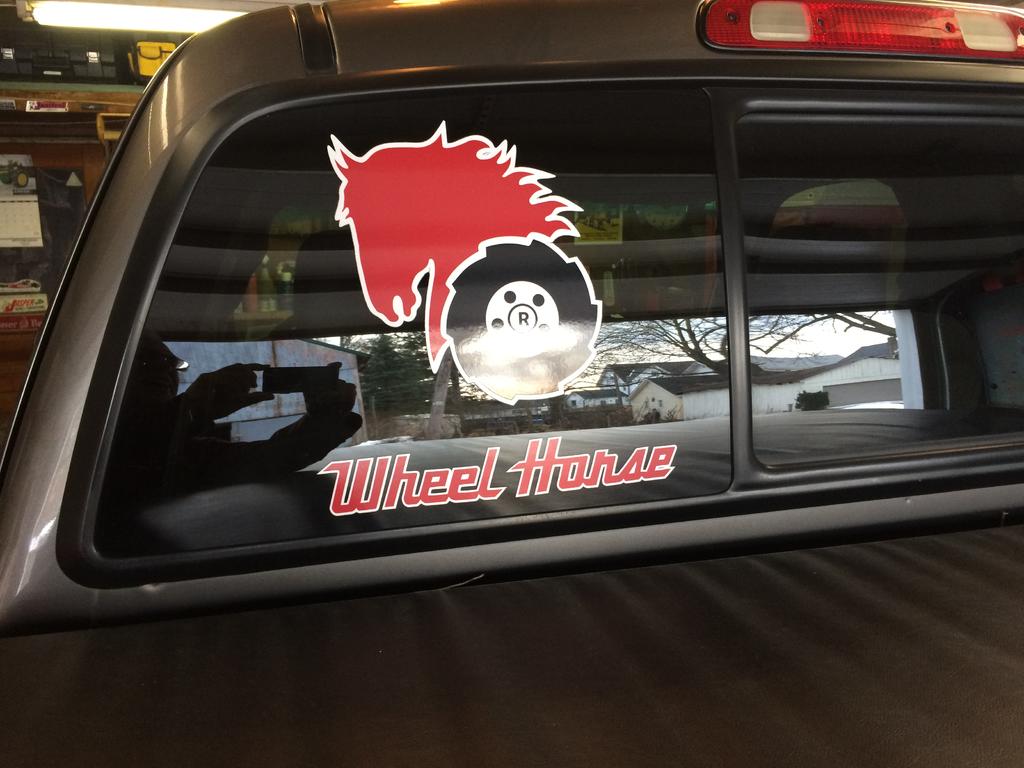

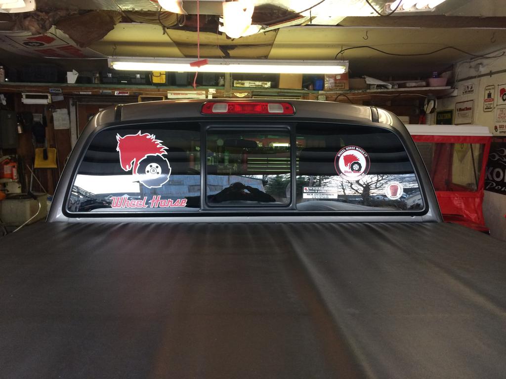

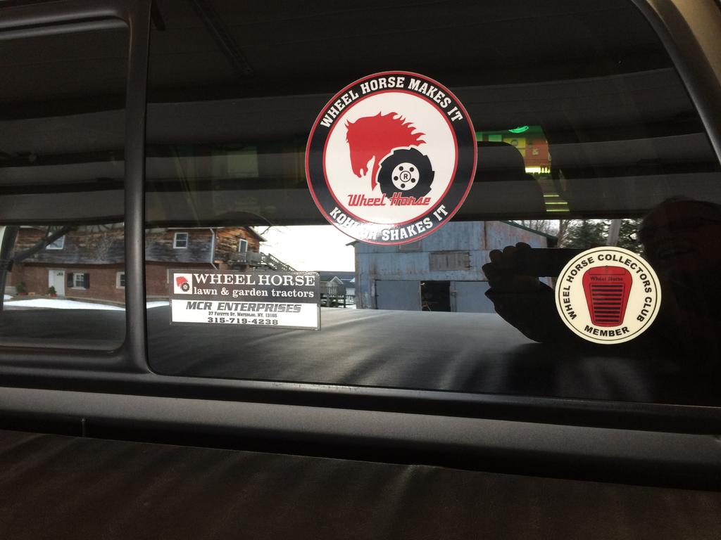

squonk 47,338 #28 Posted January 27, 2018 Ok. you guys made me go out and take a pic of my truck window. 2 3 1 Share this post Link to post Share on other sites
