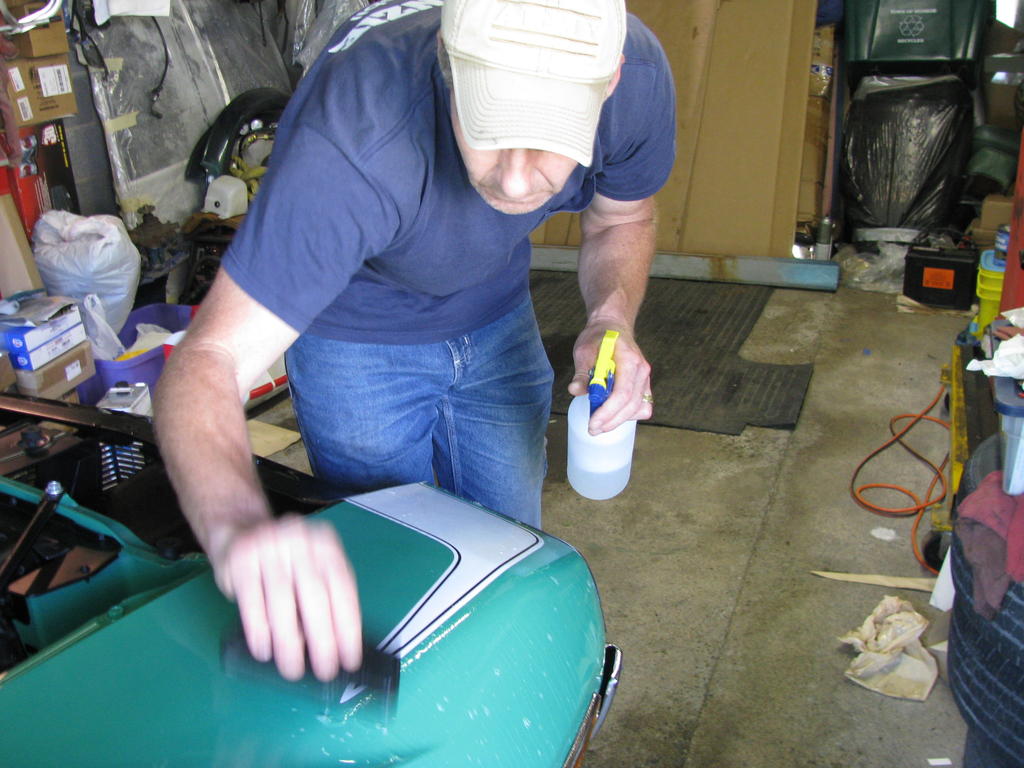

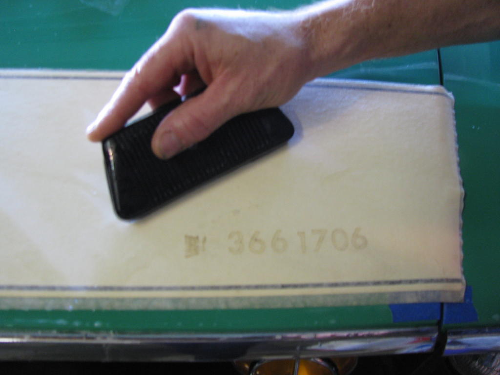

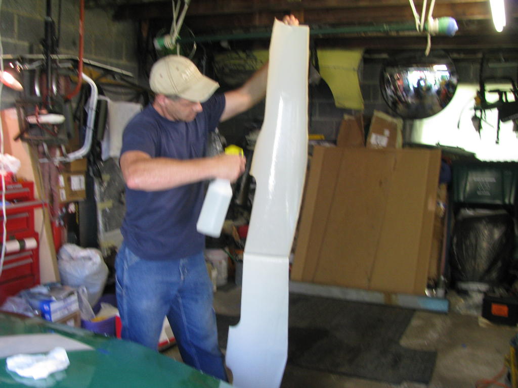

AMC RULES 37,256 #2 Posted January 20, 2018 Spray it, apply it, position it, then squeegee it in place. 7 1 Share this post Link to post Share on other sites

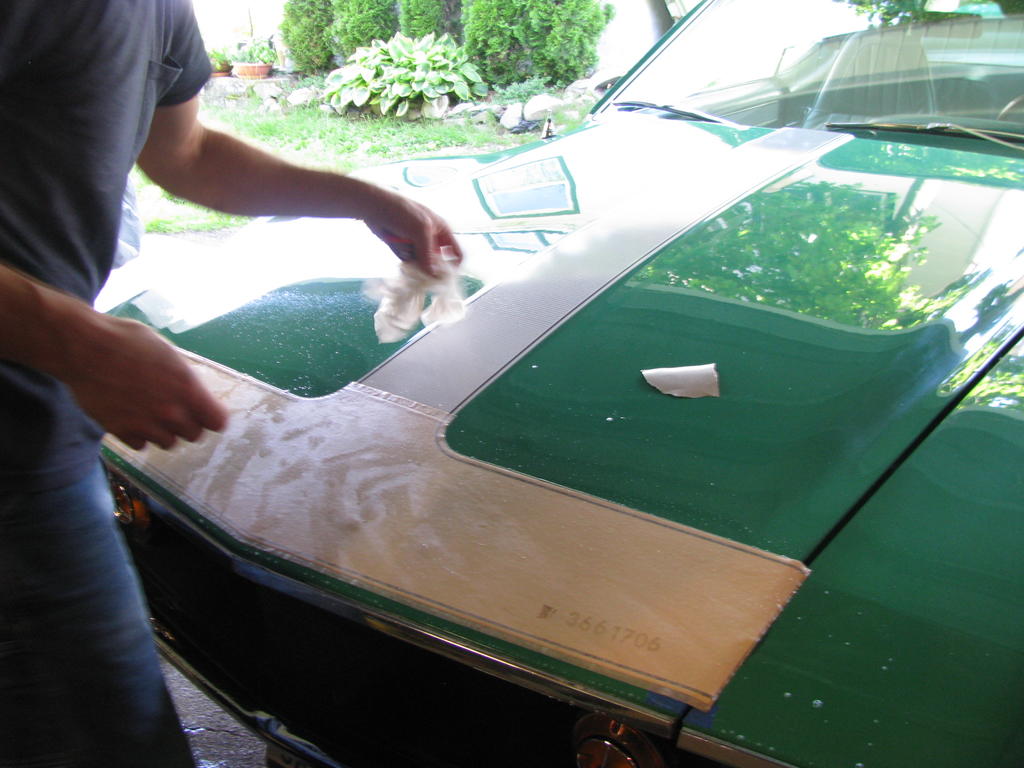

GlenPettit 1,718 #5 Posted January 20, 2018 Another method is to use dishwashing soap & water (just like the Windex method); wet the glass or metal with the soapy water then lay the decal on that, slide around until you get the exact position then using a squeeze (start in center >out), remove the water from beneath the decal. This method works especially well with larger and longer decals, the watery residue left beneath the decal will evaporate in time. Naturally, clean/degrease/clean the surface very well first before applying the decal (alcohol would be smart too). Now we know Craigs occupation. 6 1 Share this post Link to post Share on other sites

c-series don 11,761 #7 Posted January 20, 2018 I remember after I restored my C-121 and brought it to the big show. Ed Mayhew just finished making all the C-1_1 decals and brought them to the show. My brother told me to get a spray bottle with soap and water spray the area, apply the decal, squeegee out the soap and water with a credit card. He says "It's no big deal", I think okay fine. However one thing that I didn't count on was the fact that when I went to do this at the big show there would be a crowd of people watching me! So here I am putting these decals on with all these people watching me and I'm trying to act like I know exactly what I'm doing and not show how nervous I really am, when who shows up? The man himself Cecil Pond😳 It was the first show he had been to. Anyway the decals came out perfect with this method and Cecil signed my tractor right after that. This might sound corny but that was one of the proudest days of my life. My profile picture or avatar I think it's called in the top left corner shows me, Betty and Cecil soon after applying the decals. Speaking of which we took a large group photo this day with my tractor in front. If anyone has this picture I would love to have a copy. I'm not sure who took the pictures. Thanks! 4 7 Share this post Link to post Share on other sites

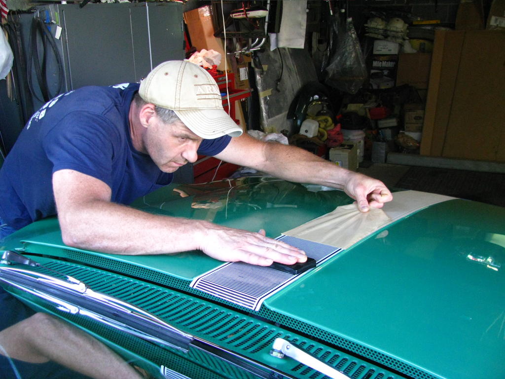

Achto 31,445 #8 Posted January 21, 2018 Here is my method - I place a piece of masking tape along the top of the new decal. Use the tape to position the decal in place. After you have it measured out and are sure that it is where you want it, press the tape down tight. Then using the tape as a hinge, fold the decal up and remove the backing, at this time you may spray soapy water on if you wish. Bring the decal back down and squeegee the air / soapy water out. Always start in the middle and work the bubbles to the out side. 2 2 Share this post Link to post Share on other sites

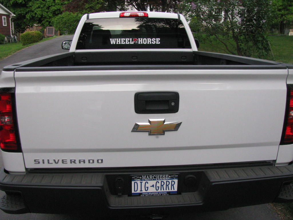

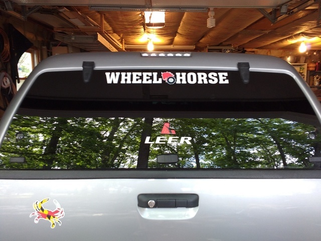

953 nut 64,933 #9 Posted January 21, 2018 (edited) I know I'm beating a dead horse here and it has been well documented that Windex is the way; I just want to show off my window decal too! Edited January 21, 2018 by 953 nut 5 4 Share this post Link to post Share on other sites

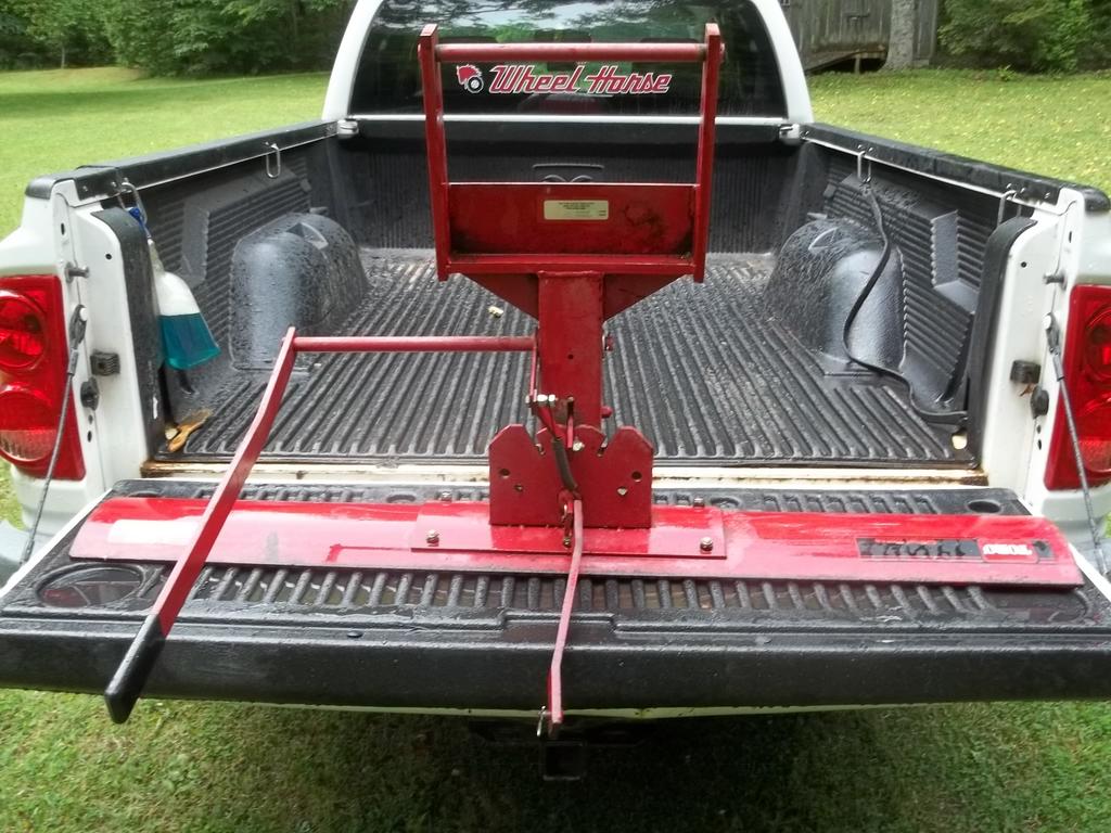

rmaynard 17,037 #10 Posted January 21, 2018 Me too. I have to show my rear window as well... I always clean the glass or painted surface, then I use a spray bottle filled with water and a few drops of dish washing detergent. I spray the receiving surface, then the adhesive side of the decal. Makes placement and adjusting simple. I used to have an office next door to a truck lettering business. I have watched literally hours of vinyl application, and that is the way they did it. 6 1 Share this post Link to post Share on other sites
rmaynard 17,037 #11 Posted January 21, 2018 It is especially important to use the "wet" method when doing a die-cut decal as shown above. Dry placement would be a nightmare if you needed to reposition each individual letter. 2 Share this post Link to post Share on other sites

19richie66 17,856 #15 Posted January 26, 2018 (edited) Yes you can use this method. When you wet it with (dish) soapy water, the soap helps keep the decal suspended on the liquid till you get it where you want it. Squeegee the water out from under the decal getting all the bubbles out and then park it in the sun for a couple hours. Edited January 26, 2018 by 19richie66 5 Share this post Link to post Share on other sites

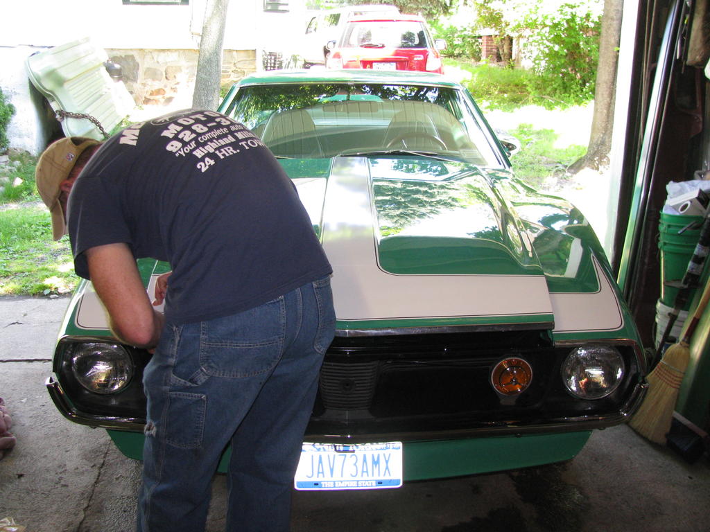

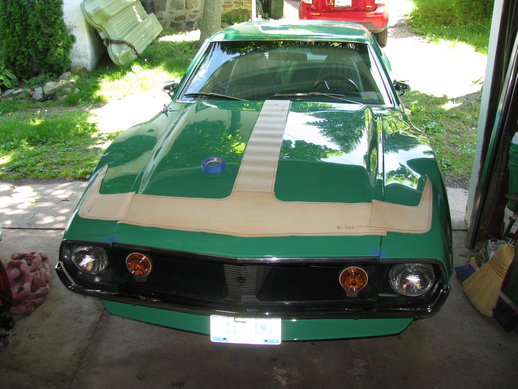

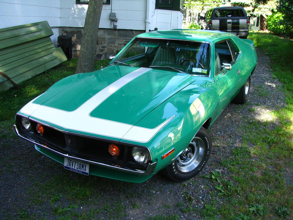

AMC RULES 37,256 #19 Posted January 26, 2018 I've never really felt applying decals was that much of a challenge. Might just be all the experience I've acquired applying the old water slide decals during my scale model building days... that gives me the confidence? I typically only like to use factory originals whenever available...regardless of their age. To my eye, new vinyl, and the modern printing process just can't compare to the originals. I remember taking a chance on Ebay auction, obtaining an over 30 year old NOS factory original T-stripe for the hood of my AMX. Everyone told me there is no way it would ever work, don't waste your money...let me tell you, that thing turned out sooo nice. 9 5 Share this post Link to post Share on other sites

Achto 31,445 #23 Posted January 27, 2018 @AMC RULES that's one awesome looking AMX!! Great work on the decals. 1 1 Share this post Link to post Share on other sites

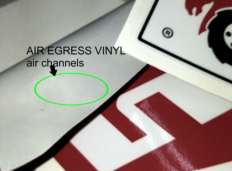

Vinylguy 4,770 #24 Posted January 27, 2018 (edited) I make most of my graphics using Arlon 4600lx Air Egress prepositional Eco Solvent printable wrap vinyl and laminate. You will notice the air channels in the adhesive of the decals that allows trapped air to escape in the event you should have a bubble after application. I am attaching a link to a you tube video that demonstrates removing post application bubbles. Air escape vinyl is very user friendly and a wet application is NOT recommended as the air channels can and will trap moisture under the decals. If you do use the wet method with this material just be patient, allow extra time for the solution to completely dry and then make sure to go over all edges to ensure a good seal. Use a soft cloth or cotton glove to prevent scratching the decal. This will prevent contaminates from lifting the edge and causing premature failure of your graphics. You can use Windex or mix a small amount of dish soap in a quart spray bottle for your wet application. . Also I highly recommend watching the video on the installation tips page at redoyourhorse.com Make sure all surfaces especially glass are super clean. Glass is porous and needs to be cleaned with isopropyl alcohol to remove residue trapped in the glass. This will help the edges remain sealed and prevent premature failure of your window decals. Installing air escape decals Installing air escape on glass Edited January 27, 2018 by Vinylguy 2 7 Share this post Link to post Share on other sites
