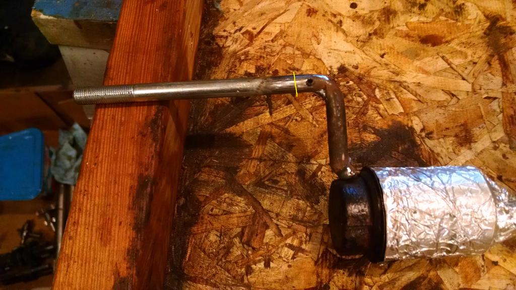

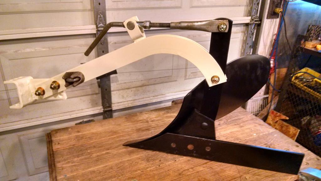

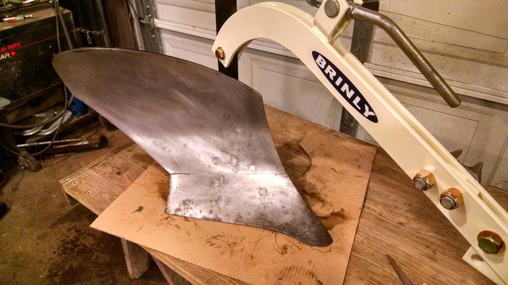

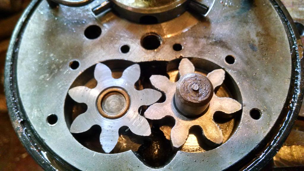

Achto 30,161 #81 Posted February 26, 2018 My new drive gear from @wheelhorseman arrived and fit perfectly. A special thanks to Lowell for making the parts to keep these pumps in working order. Part of the control lever for the hydro pump had been broken off before I purchased the tractor. The break was about where I have the yellow line drawn. My plans are to use a heim joint to connect the lever to a handle on the dash for easier access. In order to do this I needed some more material to work with, so I welded an extension on. After I get my hiem joint I can cut the extension down to the appropriate length. Before welding on the handle, I wrapped foil around the valve drum to keep weld spatter off. I had cleaned up my plow & repainted it so I decided to put it back together. Only thing left to do is to put the new decals on. 4 3 Share this post Link to post Share on other sites
Shynon 7,505 #82 Posted February 26, 2018 Dan looking good, you got me worried, looks like you be sitting and watching us plow 1 Share this post Link to post Share on other sites
WHX?? 53,247 #83 Posted February 26, 2018 Might be looking too good ... might not want o get it dirty! At a loss as to why you had o weld on that drum (I call it the valve spool) but was it not threaded where the handle attached and is it not cast iron? Share this post Link to post Share on other sites
Achto 30,161 #84 Posted February 26, 2018 12 minutes ago, Shynon said: looks like you be sitting and watching us plow No worries Tom, Still intended to be a plow tractor. 5 minutes ago, WHX14 said: ) but was it not threaded where the handle attached and is it not cast iron? This tractor was formally owned by a "shoe man", this was one of those things that I had to repair as best as I could. 1 2 Share this post Link to post Share on other sites

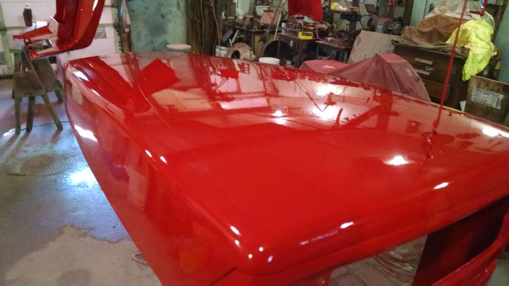

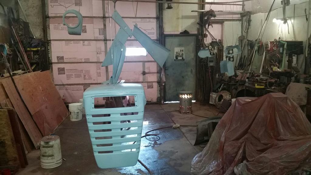

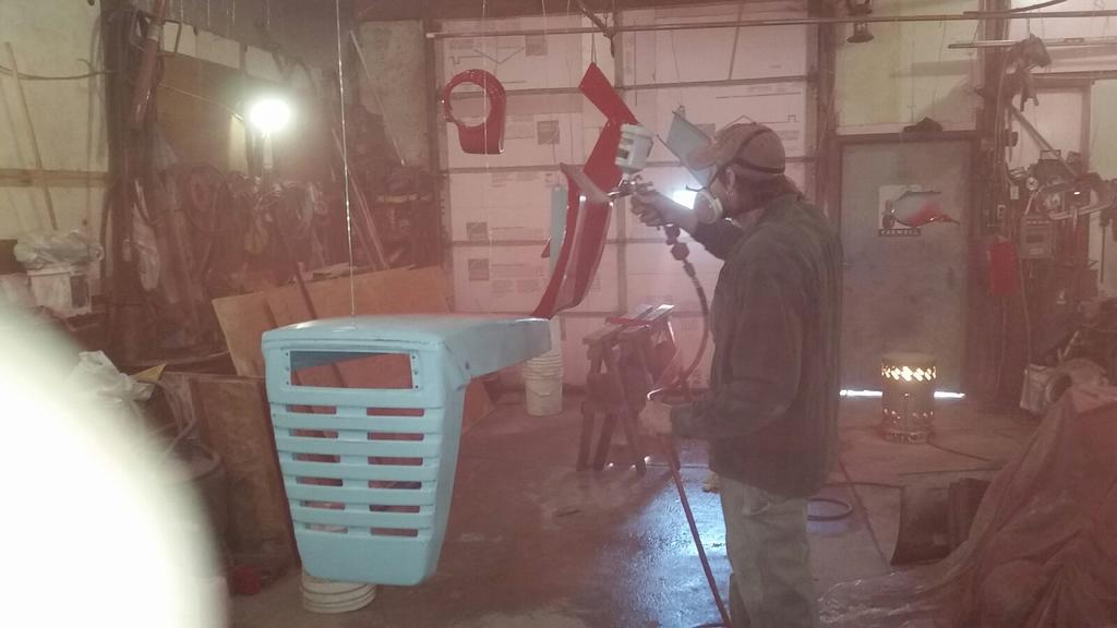

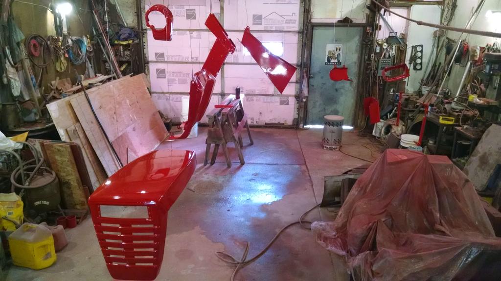

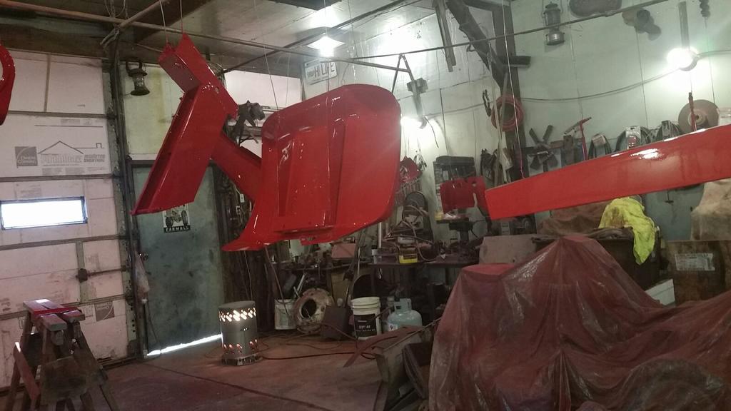

Achto 30,161 #90 Posted March 4, 2018 (edited) I was able to get the sheet metal sprayed today. Jim @WHX14 stopped by to help with some wet sanding & get some observation time in on the painting. Always great to hang out with friends like Jim, hopefully I was an ok teacher for him. I should have taken some in process pics of the wet sanding process, sorry. I had sprayed a mist coat of flat black ( cheap $.98 spray bomb from Wal-Mart) over the gray primer, this helps greatly when wet sanding. When the black paint is sanded off the the part has been completely sanded. Jim got a pic of the parts after they were wet sanded with 400grit, washed with preps all, tacked off and ready for paint. Apparently he also was able to get an action shot of me spraying. Of course safety equipment is a must when spraying paint. Plus it helps cover ones face so that cameras are not damaged. A couple pics after the sheet metal was painted. 2 coats of paint on the inside of the parts, 3 coats on the out side. A closer pic of the hood to show off the gloss of the VanSickle acrylic enamel paint. This pic was taken about a hour after painting. Decals also came in this week, Terry @Vinylguy does such great work. I can't wait until I'm ready to put the decals on the tractor. I was able to put the finishing touches on my plow though. One more color to spray, then I can start putting things together. No wait, I have some axle repair to do yet. Edited March 4, 2018 by Achto 3 8 1 Share this post Link to post Share on other sites

wheelhorseman 3,241 #92 Posted March 4, 2018 (edited) Looking excellent Dan!!! Did the (fly on the wall) behave himself??? 😂😂 I’m looking forward to July at Portage Wisconsin so I can see your tractor. And it looks like I will need to bring sunglasses good job on the paint!! Edited March 4, 2018 by wheelhorseman 1 1 1 Share this post Link to post Share on other sites
Achto 30,161 #93 Posted March 4, 2018 22 minutes ago, wheelhorseman said: Did the (fly on the wall) behave himself??? 😂😂 No glue strips required. 6 Share this post Link to post Share on other sites
