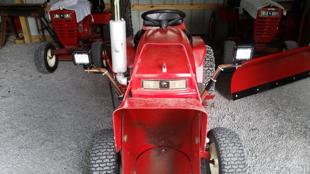

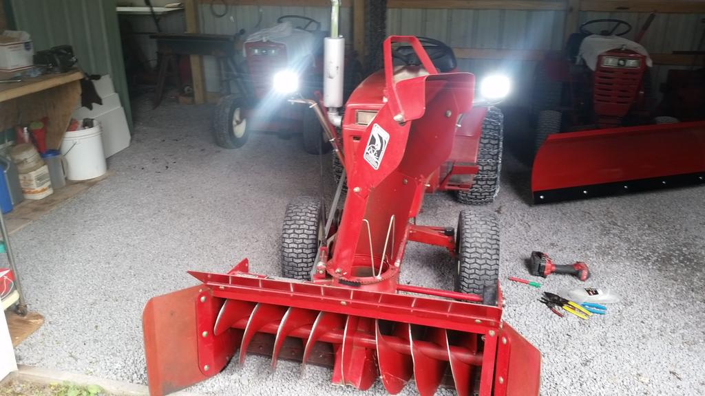

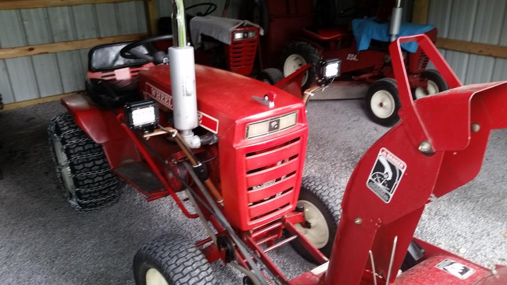

rjg854 13,403 #2404 Posted June 2, 2019 I rigged up a set of LED lights on the 16 Automatic which happens to be the tractor I use for snow blowing. With the tall chute blower being in front of the stock headlight location it wasn't very good at night. This I'm hoping will make a big difference. I somewhat copied the way the lights are mounted on the 854 If this works out the way I think it will, I'll make it out of something more sturdy than the copper pipe I used. 10 1 Share this post Link to post Share on other sites

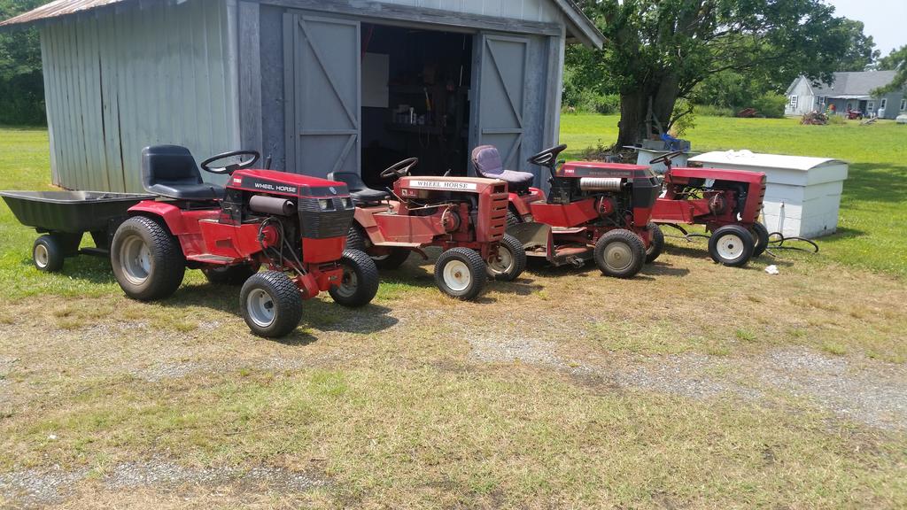

chip61 666 #2410 Posted June 3, 2019 Here is a pic of most of my herd in Mathews. The C100 and Automatic10 had been written off, but neither took a whole lot to get them running. I also have another 416H that is pretty rough although it runs pretty good on one cylinder (I guess that makes it a 408??) but I took the battery out to get my neighbor up and running. 6 1 Share this post Link to post Share on other sites

itsmeraymond 4 #2414 Posted June 4, 2019 On 6/3/2019 at 4:48 AM, rjg854 said: I rigged up a set of LED lights on the 16 Automatic which happens to be the tractor I use for snow blowing. With the tall chute blower being in front of the stock headlight location it wasn't very good at night. This I'm hoping will make a big difference. I somewhat copied the way the lights are mounted on the 854 If this works out the way I think it will, I'll make it out of something more sturdy than the copper pipe I used. I hope this will work out! Best of luck 1 Share this post Link to post Share on other sites

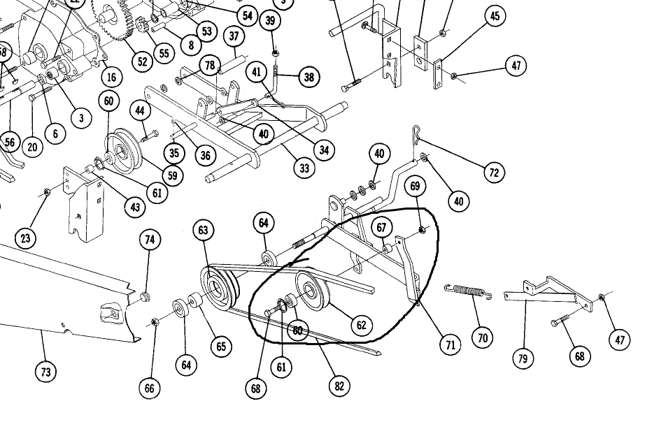

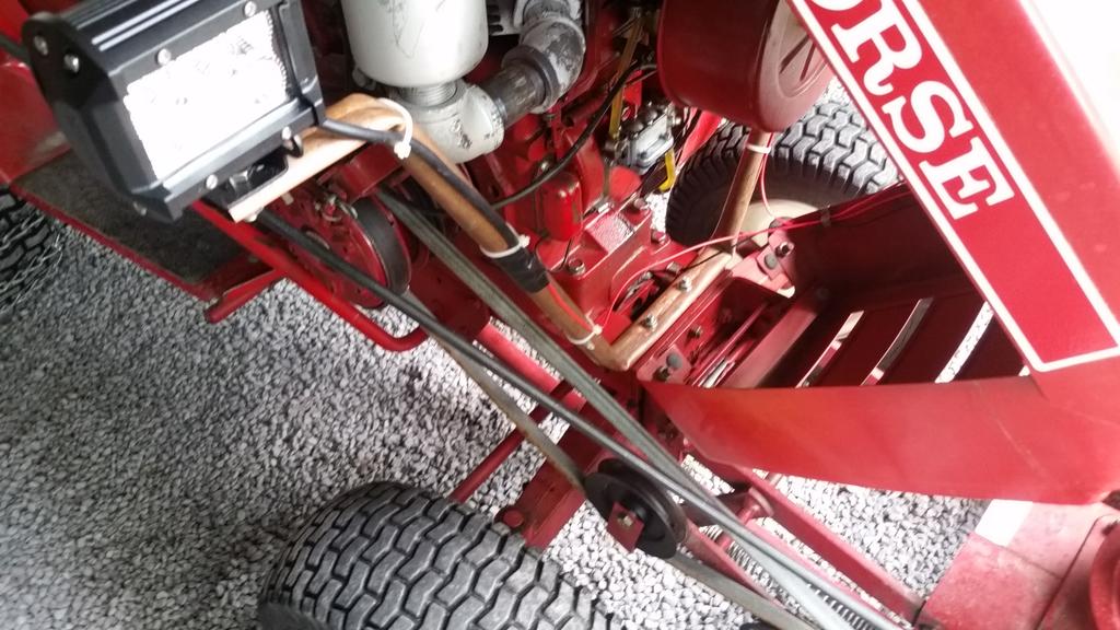

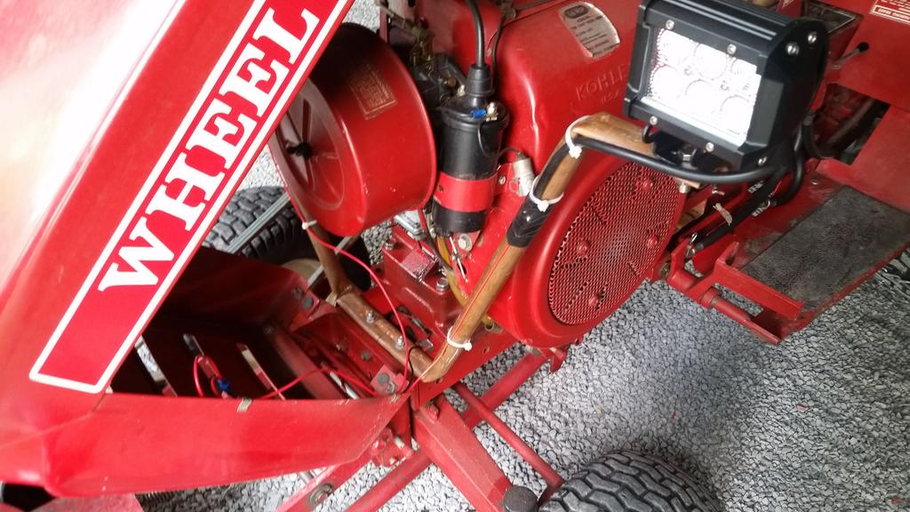

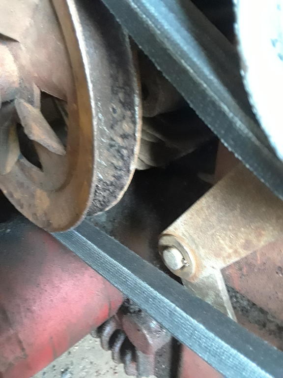

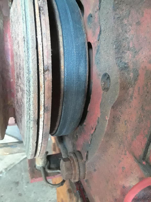

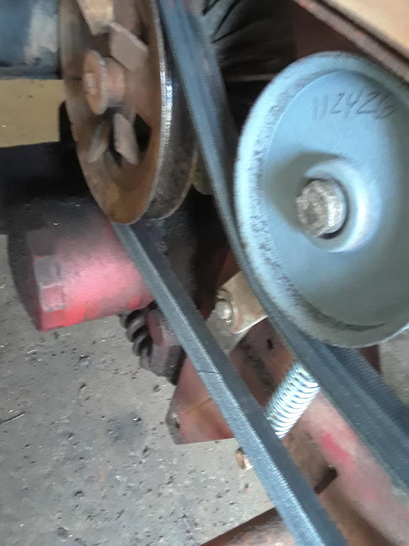

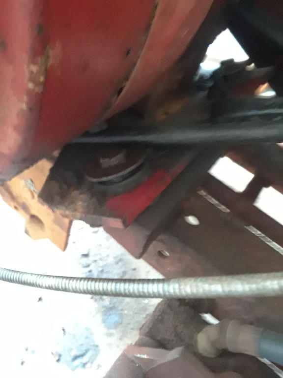

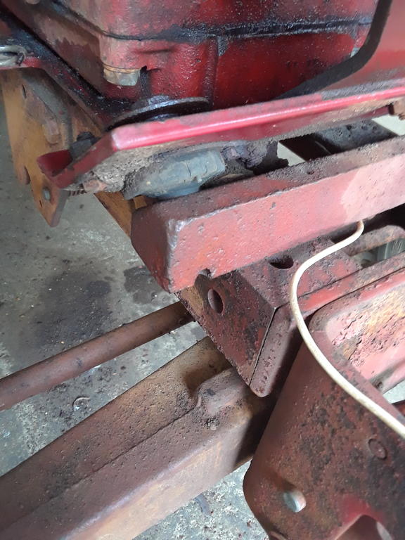

Goldann520 242 #2415 Posted June 4, 2019 Alright, callling out the big guns on this one. @WVHillbilly520H , @ACman, @pfrederi, @AMC RULES, @ebinmaine. Got my new drive belt, idler, and spring. Its still throwing the drive belt like when i got it to the tire side. (Right). From drive sheave to idler looks like a little twist and rolling right off the idler. Sheave on trans is not ideal, i chiseled and wire wheeled the rust best i could. Seems like engine wants to go to the flywheel side a half inch or so. Cannot find any ajustment for engine on cradle or mounts to frame. Isolators not the best. Btw, installed new head gasket and reset valves. Engine running pretty good. Ps drive belt is aftermarket and seems a little short. Ive had a lot of ratty wheelhorses and none ever threw belts. Share this post Link to post Share on other sites
rjg854 13,403 #2416 Posted June 4, 2019 9 hours ago, itsmeraymond said: I hope this will work out! Best of luck Had the tractor out Sunday night, the lights just about shine the length of the driveway. My driveway is close to a 1/4 mile. Does just what I wanted. Thanks. 1 Share this post Link to post Share on other sites
ebinmaine 80,909 #2417 Posted June 4, 2019 @Goldann520 We have no hydro tractors here at all so I'm going to defer to the other guys for helping you out. The only thing I can really add is that if you have any rust or crust or chips left on the pulleys you may have to replace them instead of cleaning them up. Also, Trina just reminded me that if they are too worn on the inside and the curvature is not correct, they will not be usable. The belt itself will sit too low and not work correctly. It will burn out the belt. Share this post Link to post Share on other sites
Ed Kennell 47,592 #2418 Posted June 4, 2019 That right front engine isolator in your second picture appears to have completely pulled thru the cradle allowing the drive belt to pull the engine clockwise when under load. I would can the isolators and bolt that engine rigid to the frame. Share this post Link to post Share on other sites
Goldann520 242 #2419 Posted June 5, 2019 48 minutes ago, Ed Kennell said: That right front engine isolator in your second picture appears to have completely pulled thru the cradle allowing the drive belt to pull the engine clockwise when under load. I would can the isolators and bolt that engine rigid to the frame. Ok, ed, i can do that? This problem has been there since i first fired it up. Engine does shake quite a bit and isolators not so hot like i mentionedbefore. It will bolt to the frame and line up properly? Ive never had a wh with a cradle and isolators 1 Share this post Link to post Share on other sites
Goldann520 242 #2420 Posted June 5, 2019 1 hour ago, ebinmaine said: @Goldann520 We have no hydro tractors here at all so I'm going to defer to the other guys for helping you out. The only thing I can really add is that if you have any rust or crust or chips left on the pulleys you may have to replace them instead of cleaning them up. Also, Trina just reminded me that if they are too worn on the inside and the curvature is not correct, they will not be usable. The belt itself will sit too low and not work correctly. It will burn out the belt. Thanks, belt rides high on both sheaves Share this post Link to post Share on other sites
