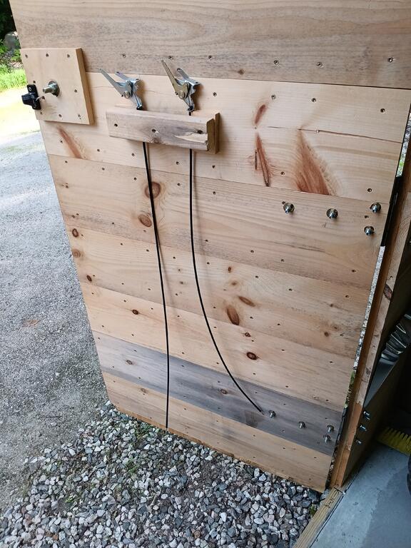

ebinmaine 81,048 #24052 Posted July 3, 2025 @peter lena would be happy with this one. I found a couple NOS choke cables in my stock and I wanted to run a little Lube down through them. Turns out my door handle is the perfect place to hang these where they can't fall through. 6 1 1 Share this post Link to post Share on other sites
peter lena 10,103 #24053 Posted July 3, 2025 @ebinmaine like that , hiding in plane site ! also like SUPER LUBE , SMALL BOTTLE ,HYDRAULIC OIL , check out temp range , in a tough spot , like penetrating oil , first to verify flow / tracking , then SUPER LUBE , once you try , verify that , you are hooked . thank you for the shout out , BTW , can you send me your mailing address ? pete 3 Share this post Link to post Share on other sites

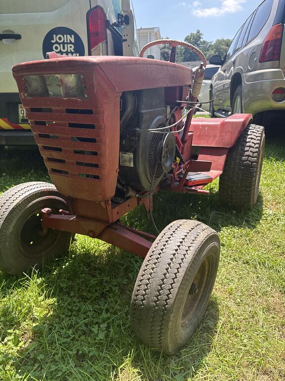

davem1111 2,432 #24057 Posted July 4, 2025 This isn't a "what I did with my wheel horse today" post (although I did some trail mowing with my GT-1848 after it cooled down a bit...) Yesterday my wife and I went to our local county fair - lucky for us the fairgrounds is only 4-5 miles away. They were having their tractor pull and we hadn't been there in quite a few years. Turns out the sled for the big tractor pullers didn't make it there in time, so it was only garden tractors. I didn't get pictures of all of them, but I particularly liked this one (it took third in it's class) - "Wicked Horse": It had a V-Twin in it but can't tell what brand or size. They had a lot of mostly big, some small, tractors on display inside a pole barn. Here are a few pics: Thought this ice cream maker was pretty cool: 2 8 Share this post Link to post Share on other sites

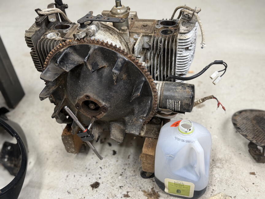

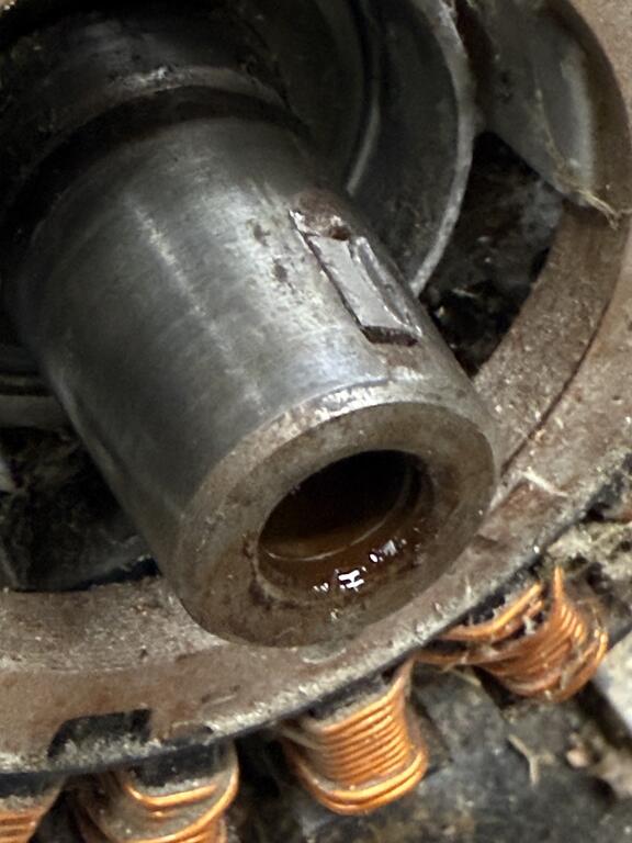

Handy Don 17,634 #24060 Posted July 4, 2025 (edited) Well into stripping a late 90’s P220 off a 520-H that came to me as a parts engine with major internal injuries--one piston moves but neither the other piston nor the valves move at all. Not too hard to see how it came to its demise. Most of the airflow in the main shroud was clogged with grass and leaves--the rear fins were all but totally clogged and there was no gasket around the oil filter. Every nook and cranny atop the engine was littered deep with acorn shells and other small animal detritus. Most vivid is the differing states of the two heads with the rear one showing signs of extreme overheating. I paused to take a picture as I was draining the oil and chasing the holes to get ready to pull the flywheel--gotta make a puller plate today. Only have the electrical and governor parts behind the flywheel left to go, assuming they are usable. Edited July 4, 2025 by Handy Don 2 2 2 Share this post Link to post Share on other sites

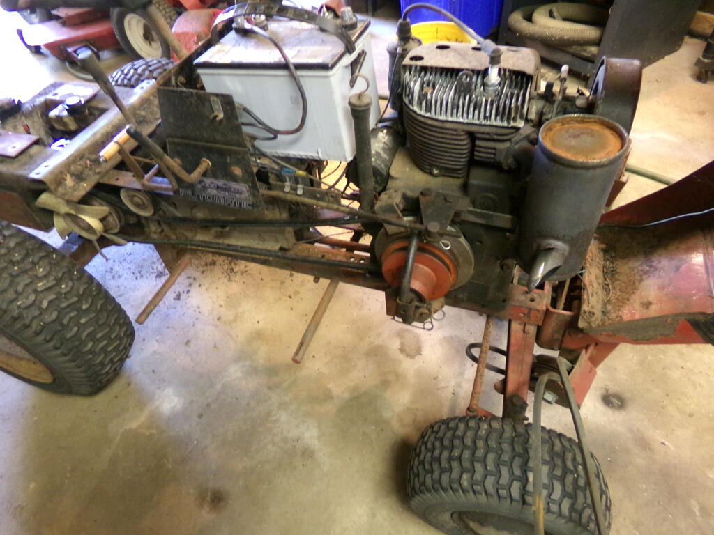

Ed Kennell 47,750 #24065 Posted July 4, 2025 Worked on the 314A that @c-series don gave me at the big show. When I brought it home and unloaded it, the engine ran fine but it but barely moved. I put it in the barn and planned to leave it for a winter project, but today curiosity got to me and I had to open it up. Got the choke cable freed up and working. Then pulled the tins off to find the problem that seemed to have the motion control system locked up. I disconnected the link to the cam plate and with some cleaning and lubrication, got full motion from the cam. The motion lever was still locked up. Then I saw it, the brake pedal spring was missing and allowed the pedal to fall down and lock the motion control lever in the neutral position. Duh ! Added a spring to pull the pedal up and all is well. 2 14 Share this post Link to post Share on other sites

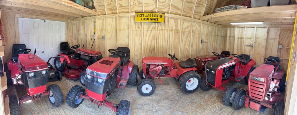

Sparky-(Admin) 26,621 #24067 Posted July 5, 2025 Jammed one more into the shed (7 now) Maybe room for one more. Tried to take a panoramic pic. 4 9 Share this post Link to post Share on other sites

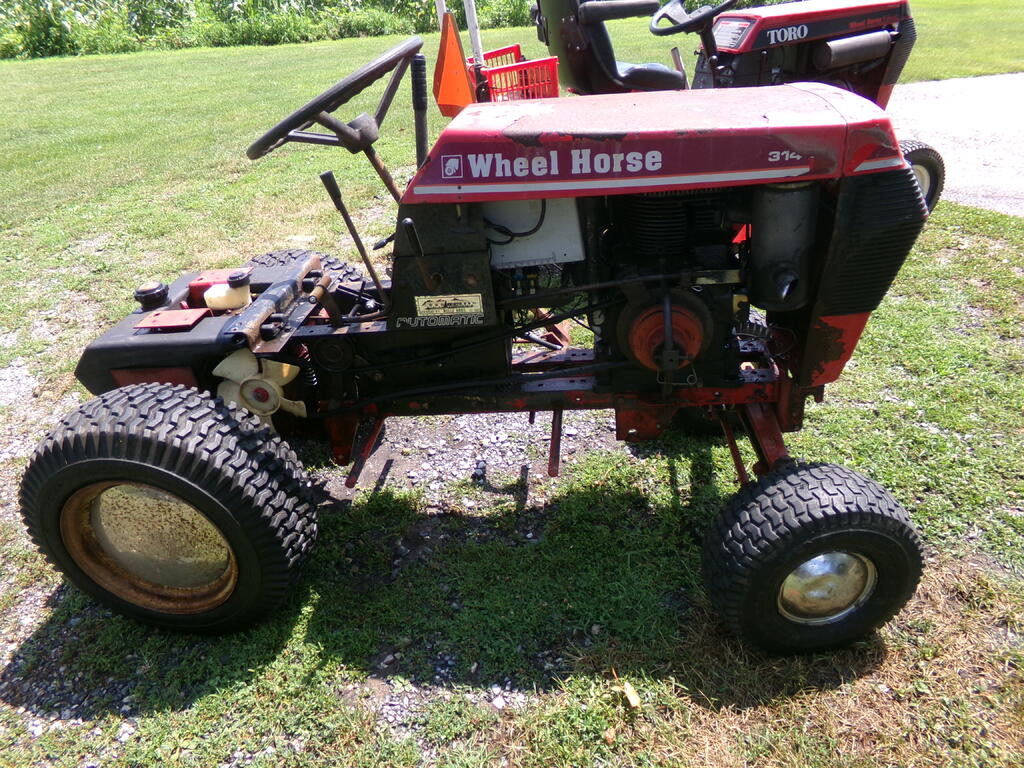

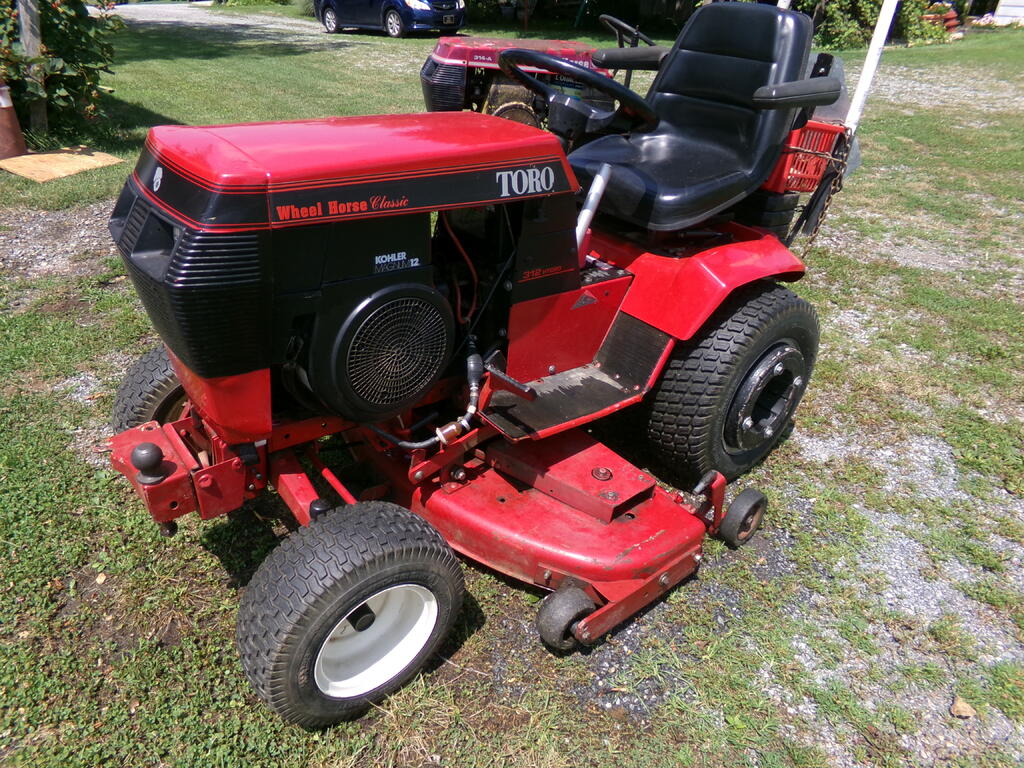

Ed Kennell 47,750 #24069 Posted July 5, 2025 Gave the 314A a bath. No pic, but I tested the 700. Hooked to a locust tree and she spins the tires in Fand R. Gave the 312H a bath while I had the pressure washer out. 3 6 Share this post Link to post Share on other sites

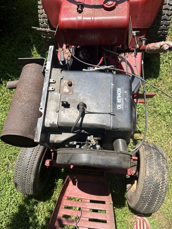

GlenW 60 #24070 Posted July 5, 2025 (edited) Finished wiring a Kohler Magnum 10 to the ignition switch of one of the Raider 12’s. The engine was from a Cub Cadet that someone had on a wooden stand with the whole wiring harness, electric clutch, switch and ignition switch. Removed that harness and wired it up to the igntion switch that was in the tractor. So much less wire than what was on the Magnum when purchased. I still have things to do to it. But it’s progress. Edited July 6, 2025 by GlenW Added photos. 5 1 Share this post Link to post Share on other sites
Handy Don 17,634 #24071 Posted July 5, 2025 (edited) 6 hours ago, Sparky said: Jammed one more into the shed (7 now) Maybe room for one more. Tried to take a panoramic pic. Cool picture! Haven't ya seen those lifts in the city parking lots that put one car above the other? You could get at least 4 of those in there--probably fit 10 tractors! Edited July 5, 2025 by Handy Don 2 2 Share this post Link to post Share on other sites
8ntruck 9,368 #24072 Posted July 6, 2025 9 minutes ago, Handy Don said: Cool picture! Haven't ya seen those lifts in the city parking lots that put one car above the other? You could get at least 4 of those in there--probably fit 10 tractors! Look at the pictures that @Pullstart has posted of the insides of his magic barn. He has heavy duty industrial shelving where he can stack them 3 high. 1 Share this post Link to post Share on other sites
Handy Don 17,634 #24073 Posted July 6, 2025 (edited) Finished up stripping a “for parts" P220. When I got into it, I discovered it‘d likely been running hard and died rough. One piston is seized solid. The crankshaft is intact but the flywheel key was sheared and the camshaft is in three pieces as is one connecting rod. Musta been quite a bang. Good news is I”ve now got a solid muffler and known good starter, ignition sender/sensor, stator, voltage regulator, coil, and governor components all of which can port directly to our worker P218 should the need arise. I’ll be putting the usable parts that I know I won’t need in a Classified. Free for pickup or for the cost of shipping. Edited July 6, 2025 by Handy Don 4 5 Share this post Link to post Share on other sites
squonk 48,288 #24074 Posted July 6, 2025 On 7/5/2025 at 1:16 PM, Sparky said: Jammed one more into the shed (7 now) Maybe room for one more. Tried to take a panoramic pic. Going to have to start hanging them from the ceiling! 2 1 2 Share this post Link to post Share on other sites
Wayne0 1,659 #24075 Posted July 6, 2025 10 minutes ago, squonk said: Going to have to start hanging them from the ceiling! Ala @Pullstart ?? 2 1 Share this post Link to post Share on other sites
