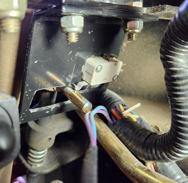

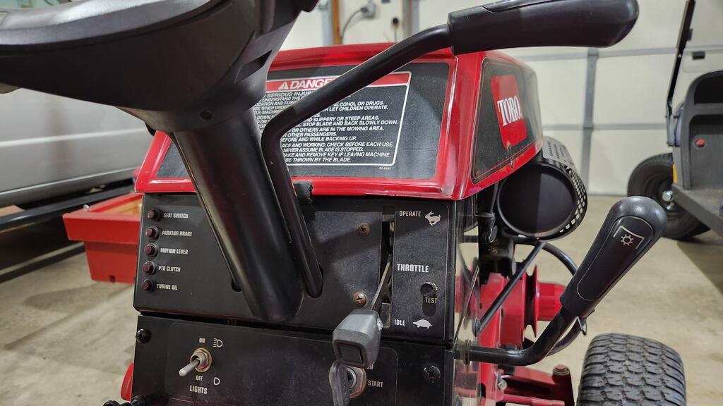

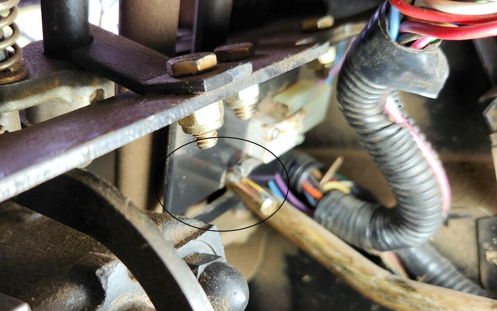

Racinbob 13,250 #23726 Posted May 30, 2025 Not that it looks like the issue with the 314H has been resolved I'm a little more motivated to tweak a few things on it. My wife will be pretty much the sole operator so I need to address things with that in mind. I prefer a foot control but she is fine with the hand thingy. Totally unacceptable was that you had to push the lever down and then back to reverse it. It was awkward. This bracket was the culprit. It served two purposes. To block the motion lever forcing you to push down to back up and to hold the neutral safety switch. If I was the only operator the bracket and switch would disappear. But remembering that she drove a hydro through a fence gate and managed to clean out the hinges I figured I should leave it on. I pulled it off and made the modification and this is the result. Depressing the brake centers the rod on the switch arm. The result is a much smoother and easier forward/reverse motion. If I do put a foot control on it I would need this modification anyways. Another thing I'd like to replace is the 'fat' steering wheel. She said she likes the feel. I'm here typing this so obviously I refrained from comment. 6 4 Share this post Link to post Share on other sites

Bill D 3,177 #23728 Posted May 30, 2025 2 hours ago, Ed Kennell said: Thanks for the fix Bob. I got rid of several of these tractors with this awkward motion control lever. I do a similar mod to all my hydro console cover plates when I add the foot control. You can also scrap that bracket completely and add an 8 speed style clutch switch. There is a cutout on the left side of the hoodstand for it. Splice in some longer wires and your all set. This forces you to press the brake to start the engine. 3 Share this post Link to post Share on other sites
Lee1977 7,807 #23729 Posted May 30, 2025 A modified hydro control to make it easer is always better. I did the same with my 89 520. Longer hand lever and straighten the pattern with just a half notch for natural. 5 5 Share this post Link to post Share on other sites

Handy Don 17,634 #23731 Posted May 30, 2025 3 hours ago, Lee1977 said: I've purchased pedal motion controls for our 312-H and 518-H++. When I install them, i plan to adopt the “modified plate” idea that @Lee1977 & @Ed Kennell have done while leaving a stubbed motion lever in place so the “neutral” switch won’t need a mod. 3 Share this post Link to post Share on other sites
Racinbob 13,250 #23732 Posted May 30, 2025 1 hour ago, Handy Don said: I've purchased pedal motion controls for our 312-H and 518-H++. When I install them, i plan to adopt the “modified plate” idea that @Lee1977 & @Ed Kennell have done while leaving a stubbed motion lever in place so the “neutral” switch won’t need a mod. Those options aren't available on a 96 314. 5 hours ago, Bill D said: You can also scrap that bracket completely and add an 8 speed style clutch switch. There is a cutout on the left side of the hoodstand for it. Splice in some longer wires and your all set. This forces you to press the brake to start the engine. That would work but for me the only other option is remove the bracket and switch entirely. And maybe make sure the gates are open. 1 2 Share this post Link to post Share on other sites

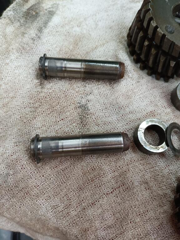

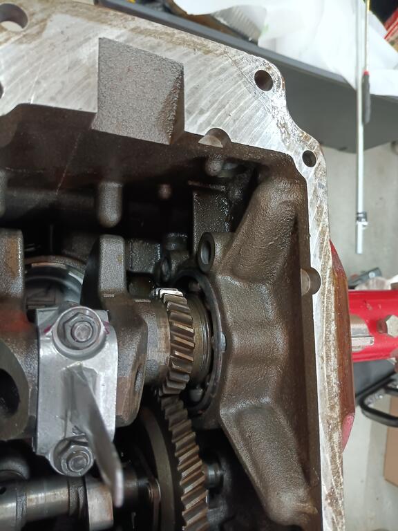

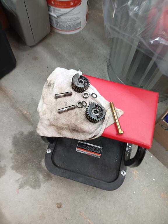

ebinmaine 81,049 #23733 Posted May 30, 2025 I got the balance gears ⚙️ outta the rebuilt K341 I picked up from @Bill D a few months ago. I had to clean out the holes 🕳 with a wire brush and drill bit. Then I used a 1/2" x 4" Grade 8 bolt as a driver. Worked SLICK. Gotta remember that..... 4 6 Share this post Link to post Share on other sites

ebinmaine 81,049 #23735 Posted May 30, 2025 24 minutes ago, Easton Rich said: @ebinmaine you’ve saved another one! I have 5 K341s and another coming soon. A 12 HP, a Magnum 16. ALL will have the gears removed as I go through them in the next few years. I can certainly understand someone installing new shafts, bearings and gears. But I don't mind the change in vibration. 4 Share this post Link to post Share on other sites
Easton Rich 1,284 #23736 Posted May 30, 2025 Holy cow! For sure, but if it was me and I was building a worker I would chuck em’ 2 Share this post Link to post Share on other sites

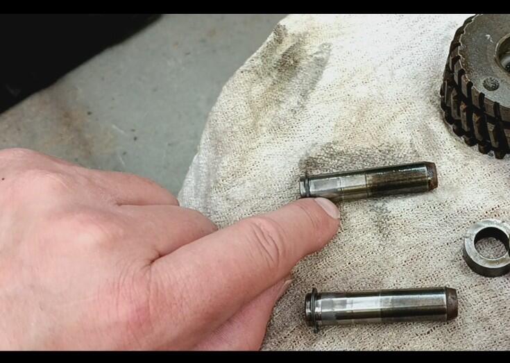

Handy Don 17,634 #23737 Posted May 31, 2025 2 hours ago, ebinmaine said: Aren't those little bitty shafts cute? 3 Share this post Link to post Share on other sites
ebinmaine 81,049 #23738 Posted May 31, 2025 1 hour ago, Handy Don said: Aren't those little bitty shafts cute? Here's one with a Bear paw for reference. 4 Share this post Link to post Share on other sites
peter lena 10,103 #23739 Posted May 31, 2025 @ebinmaine @Easton Rich functional detailing is what I regularly come too on a repetitive issue , that will always point to another stress transfer spot , the DISCOLORATION on the small shafts point to heat / stress issue , check out related lubricants for heat / stress ratings . years back now, tried rislone , zinc , in my oils , the running ease is very apparent , realise this is a very confrontational issue , but it eliminated engine effort / easy operation issue , good exchange , pete 3 Share this post Link to post Share on other sites

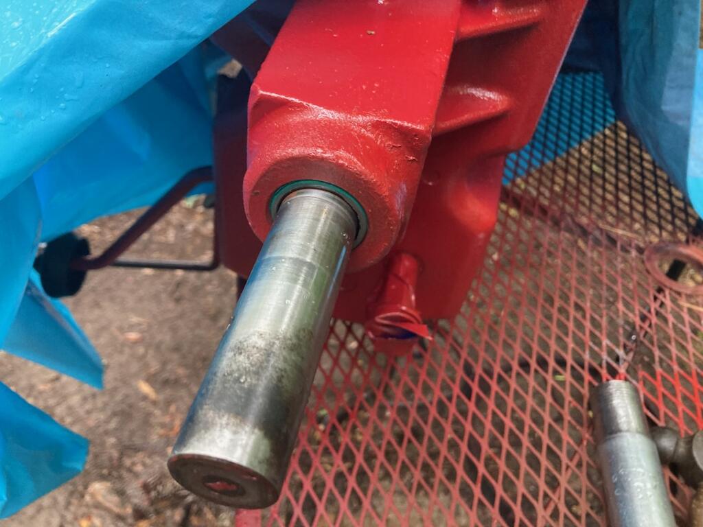

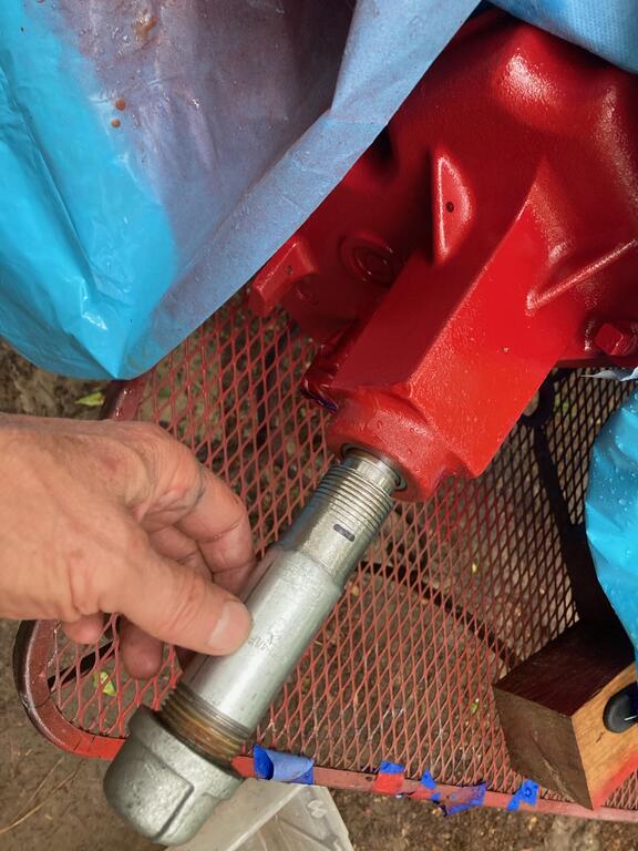

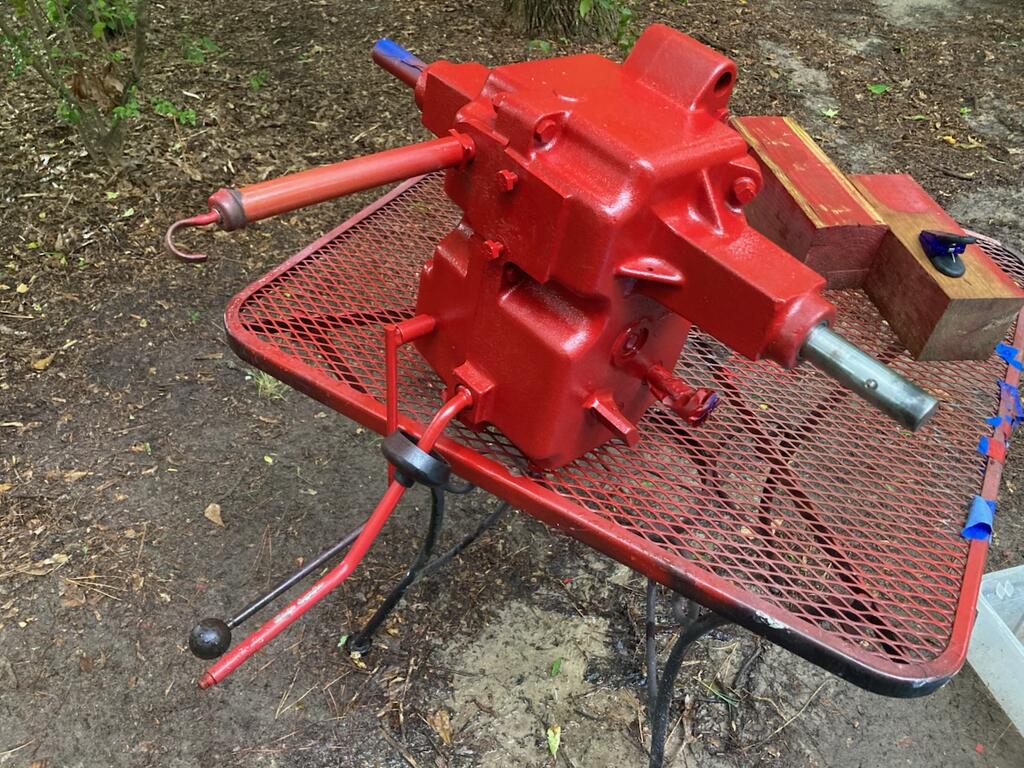

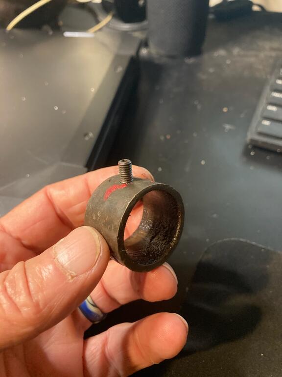

ineedanother 2,885 #23740 Posted May 31, 2025 Trying to knock out a few of those save it or toss it things in the shop and this 8-speed just needed a wheel bearing...well, the story of my life is that things are rarely that easy. Picked up a pair of bearings and seals so I could put a spare on the shelf. De-grease, pressure wash and time to address the existing bearing, or more accurately, bearing housing. No needles left of that one and I'm just going to drive it in and press in a new one. Went to Ace and got a 1" x 5" galvanized nipple and cap. Ground the end of my new "driver" down to 1 1/4 O.D. and flattened the end. Worked perfectly! 3 8 Share this post Link to post Share on other sites
lynnmor 9,066 #23741 Posted June 1, 2025 2 hours ago, ineedanother said: No needles left of that one and I'm just going to drive it in and press in a new one. Went to Ace and got a 1" x 5" galvanized nipple and cap. Ground the end of my new "driver" down to 1 1/4 O.D. and flattened the end. Worked perfectly! So how did you remove the needles and debris? How did you check the axle where the failed bearing might have wasted it? I guess that you had the cases split and the axles out before you started? 3 Share this post Link to post Share on other sites
WHX?? 58,328 #23742 Posted June 1, 2025 On 5/30/2025 at 5:34 PM, ebinmaine said: I got the balance gears ⚙️ outta the rebuilt K341 What did the bearings look like? 2 Share this post Link to post Share on other sites
ineedanother 2,885 #23743 Posted June 1, 2025 1 hour ago, lynnmor said: So how did you remove the needles and debris? How did you check the axle where the failed bearing might have wasted it? I guess that you had the cases split and the axles out before you started? That's really intuitive for you to ask and those were some of my initial questions as well. I'll say up front that I really didn't want to have to split the case and didn't find any evidence to lead me there. The gears shift smoothly. The oil I drained was clean. The axle looks fine. It appears from what I can surmise, is that they dug the oil seal out and attempted to remove the bearing from the outside and managed to peel the front of the bearing off and extract the needles but couldn't pull it out in one piece so left it and slid what's in the picture below onto the axle. I don't think it was run much from that point. That's the best explanation I can come up with for what happened. I've never seen such but that's what I've accepted as a plausible history. 1 2 1 Share this post Link to post Share on other sites
ineedanother 2,885 #23744 Posted June 1, 2025 7 minutes ago, WHX?? said: What did the bearings look like? I wish I could have gotten a good picture of it but it was essentially the outside casing of the bearing with the majority of the inside "rim" of the race still in tact. The needles and the outside of the bearing had been removed. Some of the bearing housing was clearly "torn" and I drove that in on the axle to make room for the new one. 1 Share this post Link to post Share on other sites
ebinmaine 81,049 #23745 Posted June 1, 2025 14 minutes ago, WHX?? said: What did the bearings look like? Toast 🍞 1 Share this post Link to post Share on other sites
WHX?? 58,328 #23746 Posted June 1, 2025 1 minute ago, ebinmaine said: Toast 🍞 Another good reason to yank them then. 2 Share this post Link to post Share on other sites
ebinmaine 81,049 #23747 Posted June 1, 2025 11 minutes ago, WHX?? said: Another good reason to yank them then. Yessir. I don't like toast in my engines. 1 2 Share this post Link to post Share on other sites
ineedanother 2,885 #23748 Posted June 1, 2025 1 minute ago, ebinmaine said: Yessir. I don't like toast in my engines. Absolutely agreed but in this case the front lip of the bearing had been removed along with the needles. I would have been more concerned if the internal lip of the bearing had been gone, but with that still there, there would have been no way for anything to contaminate the gearbox. I just rinsed that section with WD before driving the bearing housing in on the axle. It looked to have been little more than an aborted attempt to remove the bearing. 2 Share this post Link to post Share on other sites
