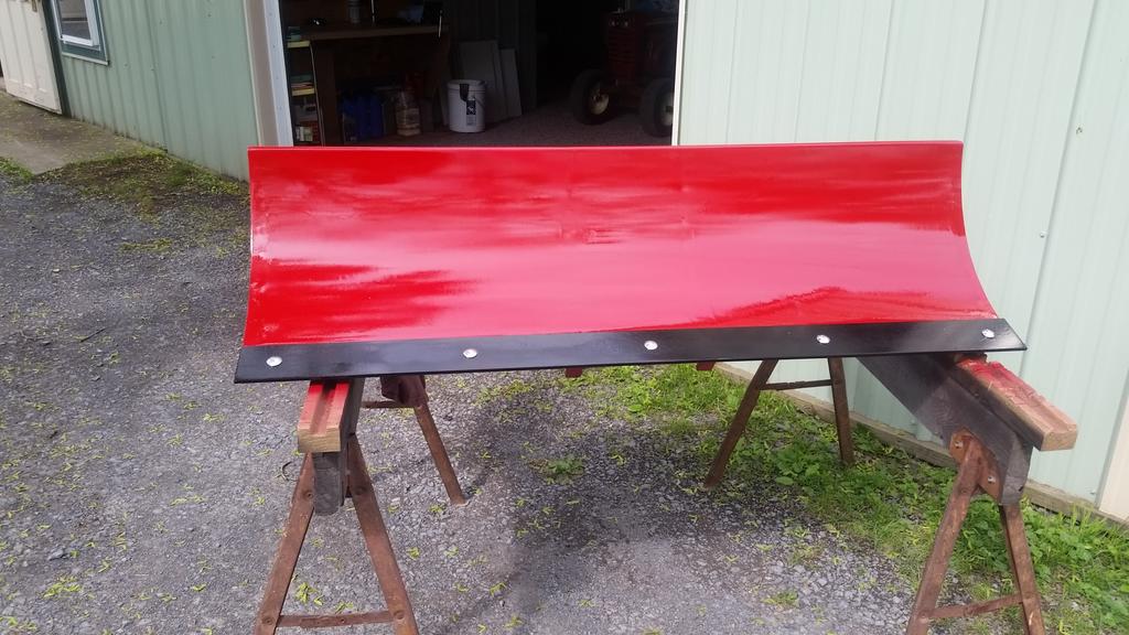

rjg854 13,403 #2354 Posted May 26, 2019 Over the past few weeks, I've been working on a 48" dozer blade that I recently purchased. It was pretty rough and rusty. I took it off it's long frame and swapped it for the dozer blade that is on my short frame Commando 8. I put the 42" dozer blade that was on that on the long frame and was able to sell it for a bit more than what I paid for it. That just about covered the cost of a new scraper bar. I wire brushed and ground it down to get the rust off it and filled all the pits. I'm happy enough with how it turned out. Now it has plenty of time to cure before I need it. 5 4 Share this post Link to post Share on other sites

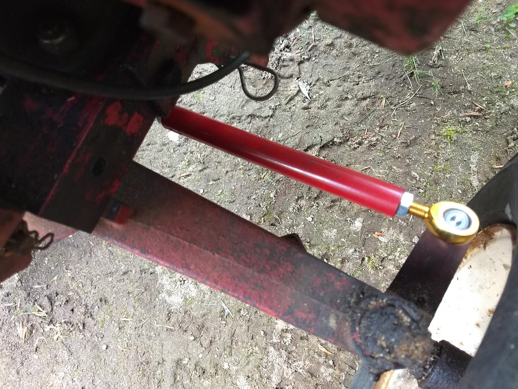

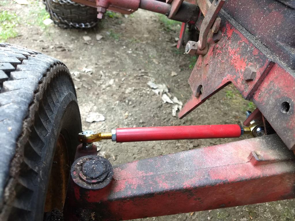

ebinmaine 80,910 #2356 Posted May 26, 2019 Trina made up some new tie rods for her 867 yesterday. This'll be her primary work tractor and we move some decent loads so I ordered the parts from McMaster Carr to change over to heim joints. A very helpful and generous Redsquare member made the center sections. They're made from larger round stock. (.750?) She painted them Rust-Oleum Apple red because the tractor will be that color next winter. @bellevillerod @LengerichKA88 @Mows4three 1 5 Share this post Link to post Share on other sites
adsm08 5,194 #2357 Posted May 26, 2019 (edited) 2 hours ago, rjg854 said: Over the past few weeks, I've been working on a 48" dozer blade that I recently purchased. It was pretty rough and rusty. I took it off it's long frame and swapped it for the dozer blade that is on my short frame Commando 8. I put the 42" dozer blade that was on that on the long frame and was able to sell it for a bit more than what I paid for it. That just about covered the cost of a new scraper bar. I wire brushed and ground it down to get the rust off it and filled all the pits. I'm happy enough with how it turned out. Now it has plenty of time to cure before I need it. Hubba hubba Edited May 26, 2019 by adsm08 Share this post Link to post Share on other sites

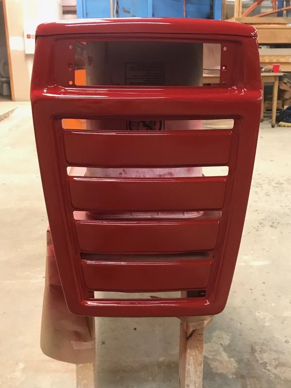

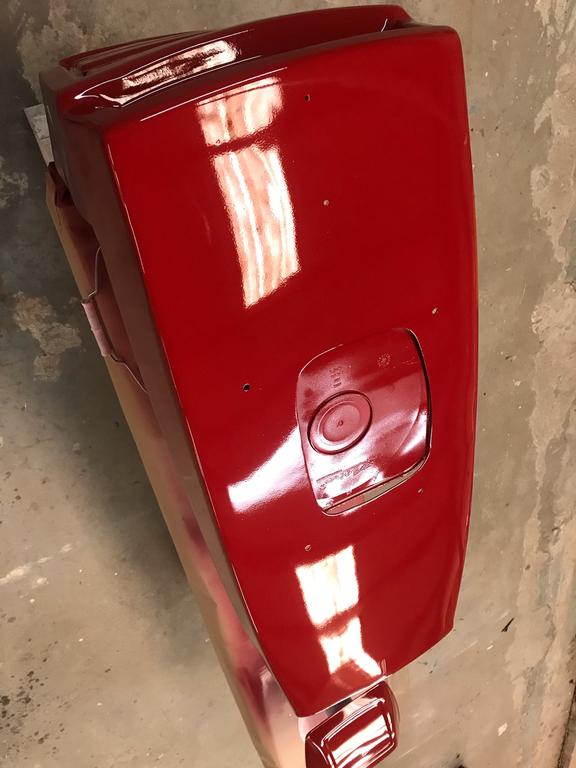

McGrew 461 #2358 Posted May 27, 2019 Project creep... Anyone familiar with that? It is when a really simple job becomes a major project. I did not like the way the hood fit on my 71 Raider 10. The hood had been tweaked a few times by my Dad when he ran into things... I made new brass bushings and a new hinge pin. The hood still did not fit right, as it was a half inch too short. I redrilled the holes in the hinges and slid the hood back. Now it fit great! That is when the project creep kicked in... Now that the hood fit, The dings and dents, particularly in the grill really bothered me. So I sandblasted the hood and started the bodywork. I learned a couple of things: 1) I am not a body man, and 2), do not want to be! I have a newfound respect for those who are! I am happy with the results, considering with what I started with. I spent hours with sheet metal hammers and body dollies. This tractor was repowered with a Techy HH140 years ago, and the hood was cut then. I don’t think it looks too bad with the hood scoop. I ordered a 7” long LED light bar to replace the factory headlights, and made a new aluminum insert to accept it. I made a new Lexan cover to replace the original. The light bar has yet to arrive, but will post more pics when I get it done. Danny 8 2 Share this post Link to post Share on other sites
ebinmaine 80,910 #2359 Posted May 27, 2019 5 minutes ago, McGrew said: Project creep... Anyone familiar with that? It is when a really simple job becomes a major project. I've learned to accept over the last few years that most of my To Do list items go this way. Used to bug me some.... But now I embrace it. Between being very particular about the way I do things and also having a never-ending project list ... I often begin to do something only to discover or remember that I had 1 or 68 other things to do first. It's all good. 1 1 Share this post Link to post Share on other sites
McGrew 461 #2360 Posted May 28, 2019 Eric, Yes, i plan for project creep, as I know me pretty well. I learned a long time ago that if you do the job right, you don’t have to do it over... Unfortunately, that takes time... Danny 2 1 Share this post Link to post Share on other sites

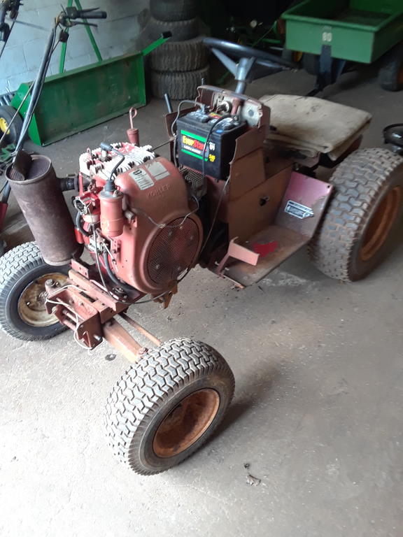

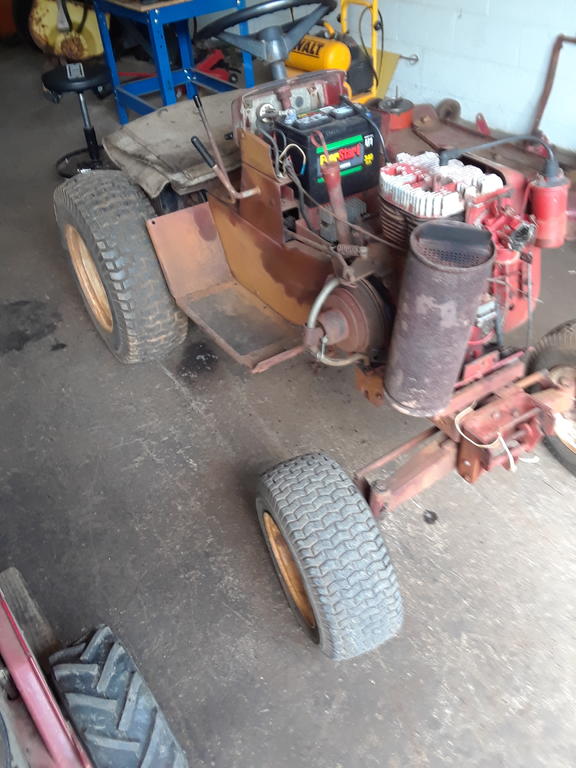

Goldann520 242 #2361 Posted May 29, 2019 Plugged the rear tire that had a hole in it on the bomb. Put a used tire i had on the front. Drive belt junk, idler rough, tension sping weak, need replaced. Im seeing this as a '79? Spraying and working everything rusted. Same tranny filter as a 520? Share this post Link to post Share on other sites
ericj 1,580 #2362 Posted May 29, 2019 2 hours ago, Goldann520 said: Plugged the rear tire that had a hole in it on the bomb. Put a used tire i had on the front. Drive belt junk, idler rough, tension sping weak, need replaced. Im seeing this as a '79? Spraying and working everything rusted. Same tranny filter as a 520? the 16 should be the hp the K for Kohler and the S for Sunstrand. I just reread your question yeas same filter for the hydro eric j Share this post Link to post Share on other sites
WHX?? 58,302 #2363 Posted May 29, 2019 On 5/27/2019 at 6:39 PM, McGrew said: 1) I am not a body man, and 2), do not want to be! Nor am I! Man has got to know his limitations! Looks nice tho Share this post Link to post Share on other sites
Goldann520 242 #2364 Posted May 29, 2019 12 hours ago, ericj said: the 16 should be the hp the K for Kohler and the S for Sunstrand. I just reread your question yeas same filter for the hydro eric j '79 ? Tractor data doesnt have the year serial #s Share this post Link to post Share on other sites
ericj 1,580 #2365 Posted May 29, 2019 42 minutes ago, Goldann520 said: '79 ? Tractor data doesnt have the year serial #s sorry I don't know the serial numbers either. If I remember correctly you are working on a C161, So 79 could be correct eric j Share this post Link to post Share on other sites
ebinmaine 80,910 #2366 Posted May 29, 2019 @gwest_ca Might be able to help out with the serial number Share this post Link to post Share on other sites

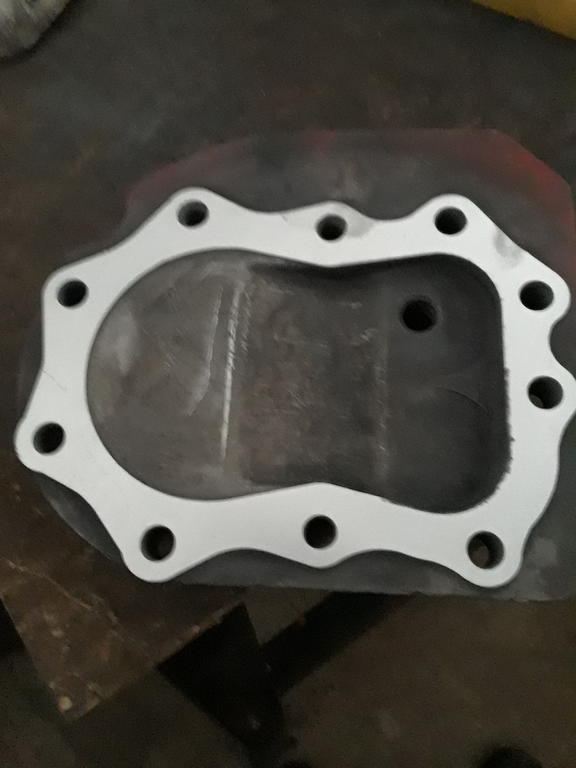

Goldann520 242 #2367 Posted May 29, 2019 Thanks @ebinmaine, i owe you a beer. 1st pick after 5 min with 320 grit and a countertop sample. 2nd a little over an hour with 320 and 400 grit 5 Share this post Link to post Share on other sites
ebinmaine 80,910 #2368 Posted May 29, 2019 1 minute ago, Goldann520 said: Thanks @ebinmaine, i owe you a beer. 1st pick after 5 min with 320 grit and a countertop sample. 2nd a little over an hour with 320 and 400 grit Well done!! Looks fantastic at least on my tiny little smartphone picture... Share this post Link to post Share on other sites

McGrew 461 #2371 Posted May 29, 2019 (edited) 14 hours ago, WHX22 said: Nor am I! Man has got to know his limitations! Looks nice tho WHX22, Thanks! I think it turned out pretty good. A long way from show quality, but a darn site better than it was, I had to keep reminding myself this tractor is a worker... It sure is frustrating to be a poor bodyman with a touch of OCD... Danny Edited May 30, 2019 by McGrew 4 Share this post Link to post Share on other sites
Goldann520 242 #2372 Posted May 30, 2019 (edited) Well, quelled my own aggravation today on the bomb. Pulled carb and went through the low side again. Also pulled main jet and cleaned out the tiny holes in it. Put back together and idles again. Figured a piece of crap got in there. Its a cocktail shaker at idle a little bit, but can tune on that. Gave me the courage to order the drive belt, ider and spring. While waiting for them will start scraping the rust off the sheaves. Like my seat? Its the "majic carpet" what i lay on on the ground. Excuse the jd muffler, its all i have right now. Edited May 30, 2019 by Goldann520 1 Share this post Link to post Share on other sites
ebinmaine 80,910 #2373 Posted May 31, 2019 3 hours ago, Goldann520 said: Figured a piece of crap got in there Glad to see you got it running again. I can't tell from the picture... Have you changed the fuel lines? Share this post Link to post Share on other sites
Goldann520 242 #2374 Posted May 31, 2019 19 minutes ago, ebinmaine said: Glad to see you got it running again. I can't tell from the picture... Have you changed the fuel lines? Ya put on a used one i had. Should go new, i know Share this post Link to post Share on other sites
