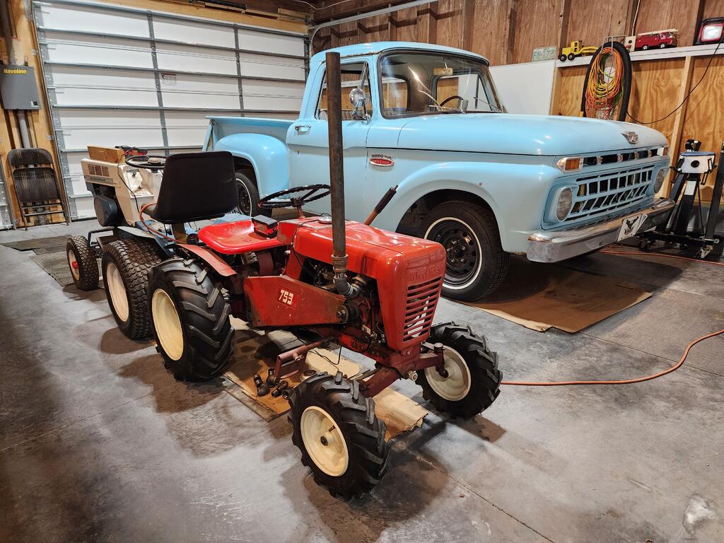

Wheel-N-It 2,978 #19776 Posted August 11, 2023 8 minutes ago, Colby G said: That's a bad to the bone wheel horse! Beautiful truck btw Thank you Colby Notice that I upsized the stack (as it goes vertical) from 1" steel pipe to 1&1/4" steel. I thought that would be a nice upgrade. 2 Share this post Link to post Share on other sites
oliver2-44 11,708 #19777 Posted August 11, 2023 47 minutes ago, Wheel-N-It said: Do you guys have any suggestions on anything I could do better before the final assembly? I'm open to suggestions Possible add a support to the pipe to take the weight and wobble forces of the exhaust flange. Nice 65 Ford, I had a 66 years ago. 2 1 Share this post Link to post Share on other sites
Wheel-N-It 2,978 #19778 Posted August 11, 2023 12 minutes ago, oliver2-44 said: Possible add a support to the pipe to take the weight and wobble forces of the exhaust flange. Nice 65 Ford, I had a 66 years ago. Yes, thank you. I've thought about a support of some kind as well. The stack itself is a little heavy, I'll see what I can some up with. Also thank you for the good words on my truck. It runs every bit as good as it looks. It's powered by a 240 cubic inch straight 6, and has a three speed transmission still on the column. 2 1 Share this post Link to post Share on other sites

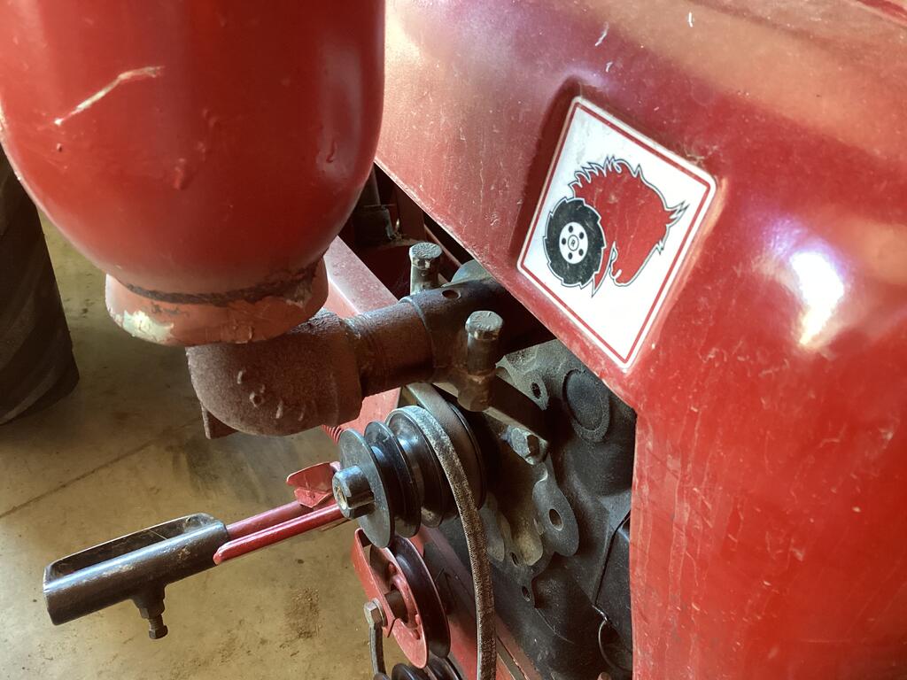

ebinmaine 80,445 #19779 Posted August 11, 2023 7 hours ago, Wheel-N-It said: stack itself is a little heavy, I'll see what I can some up with. I ran a piece of flat stock steel down to a frame hole. 1 1 Share this post Link to post Share on other sites
Wheel-N-It 2,978 #19780 Posted August 11, 2023 2 hours ago, ebinmaine said: I ran a piece of flat stock steel down to a frame hole. Eric, can you post a pic of that for me? 1 Share this post Link to post Share on other sites

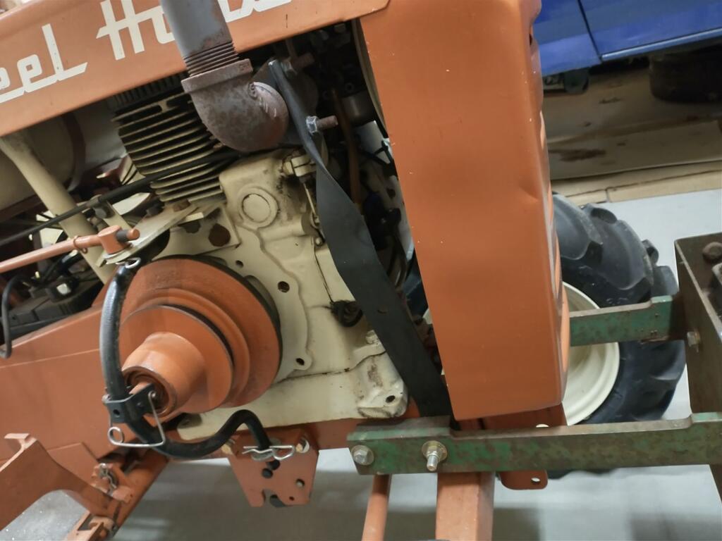

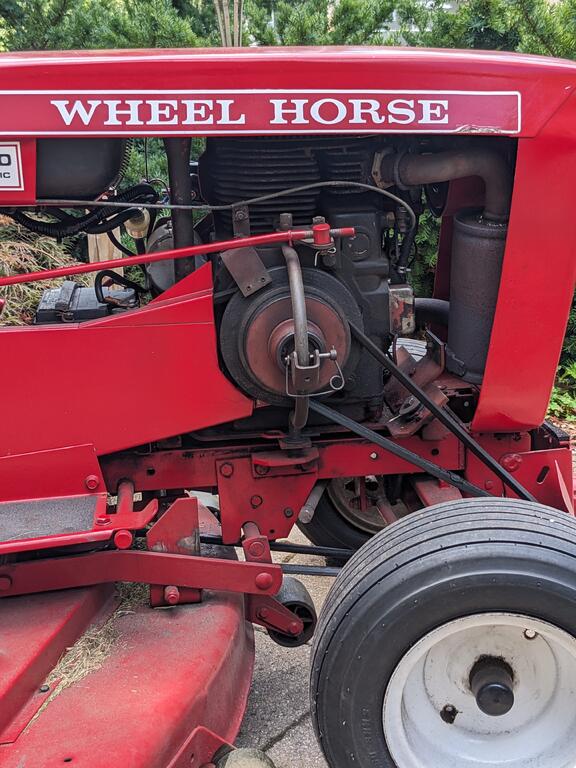

ebinmaine 80,445 #19781 Posted August 11, 2023 1 hour ago, Wheel-N-It said: Eric, can you post a pic of that for me? The top attachment point is a correctly sized exhaust clamp. You can see the ends of it where it's laying sideways and going through the bracket. The bottom just goes through the bolt at the back of the bracket for the chipper there. Right against the frame. 2 2 Share this post Link to post Share on other sites
Wheel-N-It 2,978 #19782 Posted August 12, 2023 @ebinmaine Eric, thank you for the pic.. I took a piece of right angle aluminum and held it up to the head pipe, and down to the frame like yours. Also looking at instead of connecting to the frame, maybe connecting to the engine block. The 753 is not a worker for me, so I have some time to experiment. I've even give some thought to clamping off to the stack instead of the head pipe. No telling what I'll come up with but its nice to have a starting point, and I'll use your set up as a measuring stick 2 Share this post Link to post Share on other sites

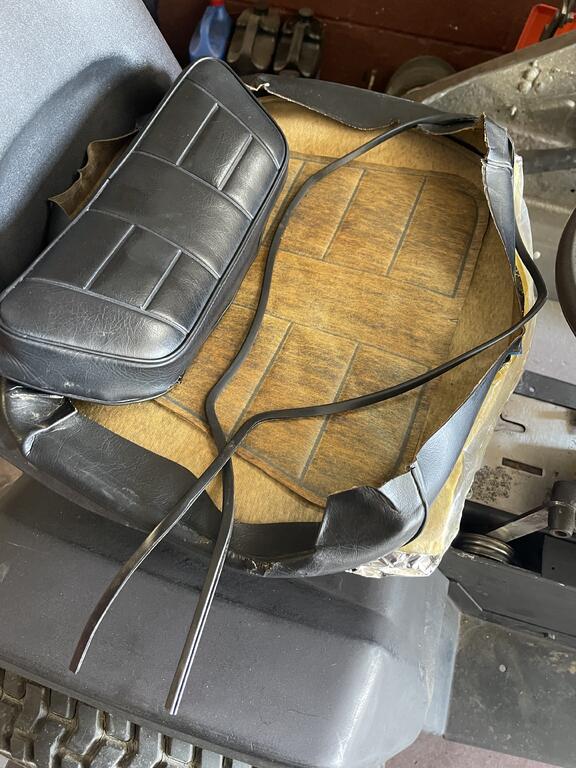

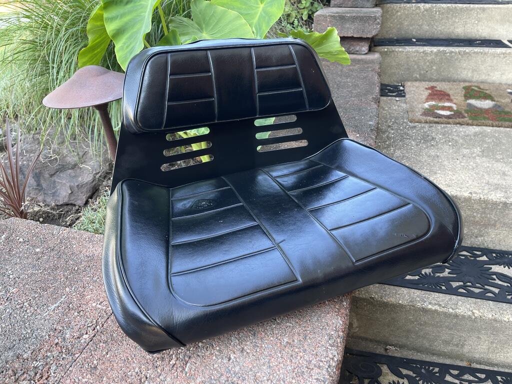

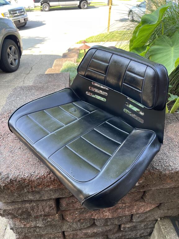

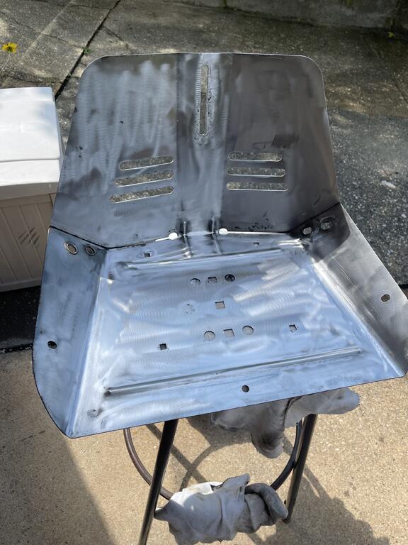

Wheelhorse#1 1,975 #19783 Posted August 12, 2023 Finally got around to fixen up the seat I found at the big show this yr.for a great price ! It was in pretty good shape, just needed some love.Stripped it all down painted the pan and cleaned up the vinyl and re wrapped the foam cushion. I think it came out pretty good.I’m planning on putting it on a 12 Auto,this is the seat it originally with I believe. This thing really has some weight to it ! 6 9 Share this post Link to post Share on other sites
Pullstart 71,144 #19784 Posted August 12, 2023 Shift work, hard work, lookin’ this good! 1 7 1 Share this post Link to post Share on other sites

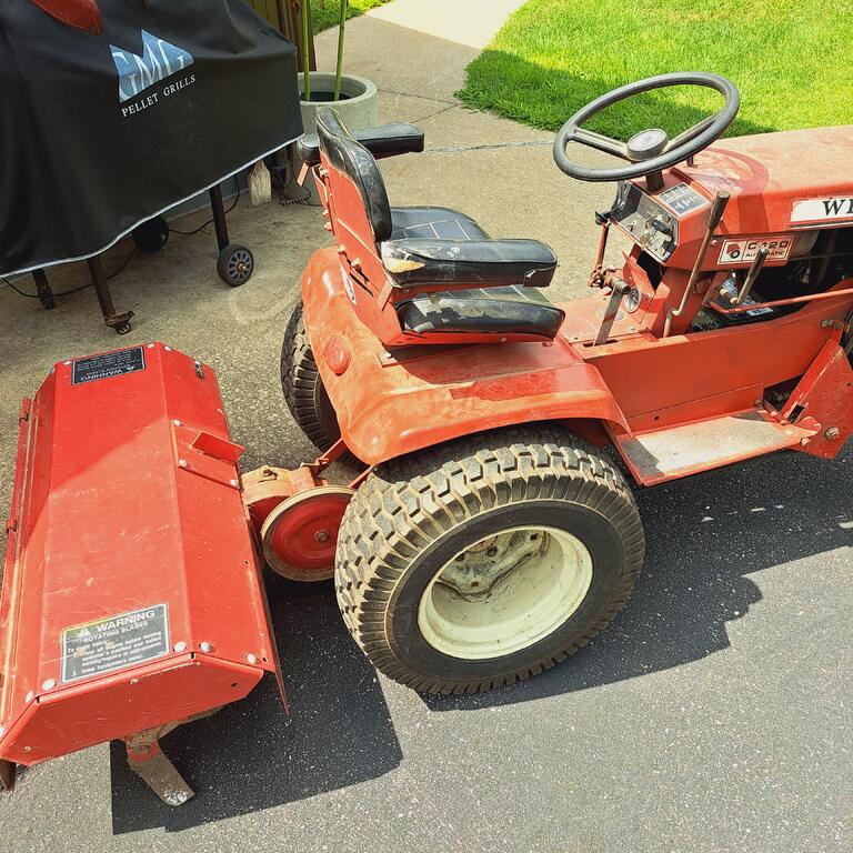

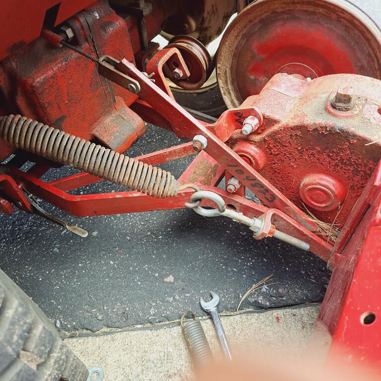

WHX?? 57,876 #19785 Posted August 13, 2023 (edited) Fitted up a tiller to Alice. Early 80s vintage tiller and Alice is a 74 C-120. No rear rockshaft. Couldn't figure why the tiller had this bracket on it but research said it was some kind of lift service assembly to put a late model tiller on an earlier tractor. Or vice versa? Almost makes me think it's for a tractor that has the rear rockshaft? Lift height was questionable so just extended the cable with chain to the lift plate. Edited August 13, 2023 by WHX?? 6 7 Share this post Link to post Share on other sites

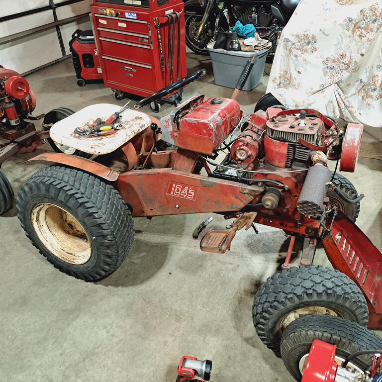

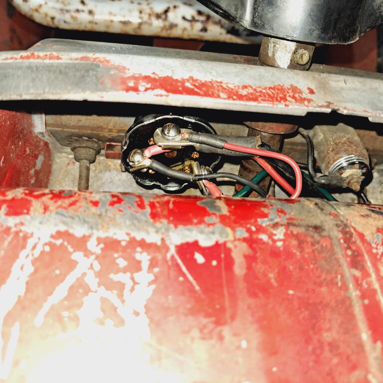

WHX?? 57,876 #19786 Posted August 13, 2023 (edited) Busy day... finally had to replace the original ig switch on the 1045. What a PIA. I re-wired it from stem to stern when I got it but of course the new switch was completely different term layout. Working with these 70 Amp switches is never fun. Hats off to Mr. David @new2horses for prompt shipping of the show replacement. He's invited to my camp anytime I don't care if @wheelhorseman does have better chow... Edited August 13, 2023 by WHX?? 3 8 Share this post Link to post Share on other sites

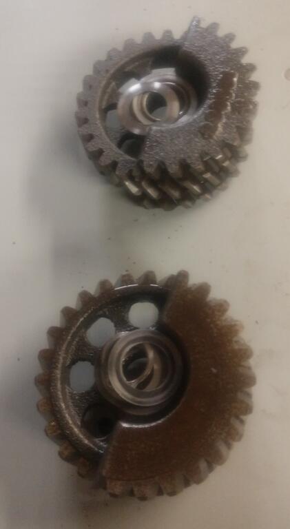

kpinnc 18,916 #19787 Posted August 13, 2023 It was pretty muggy this evening but I finally got around to removing the grenade gears from my Bronco. It's the last big block Kohler I currently have on a tractor, and something I should have done years ago. Only issue was some moron decided to dead lift the engine off the frame onto the workbench. Said moron knew better, and previously even built a crane as to not have to do that anymore. Then I got in a hurry. Guess I'll walk funny for a couple days... Gotta swap hydraulic cylinders tomorrow. The original has been weeping for a while, so I have a freshly rebuilt one ready to go. 6 4 Share this post Link to post Share on other sites

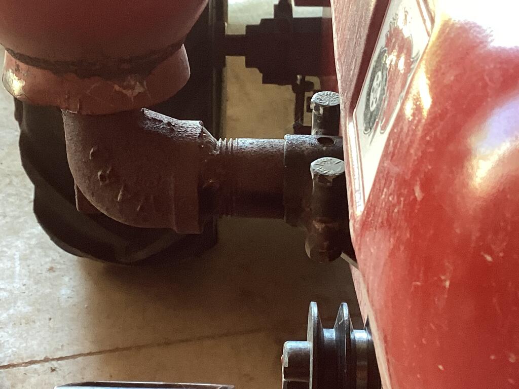

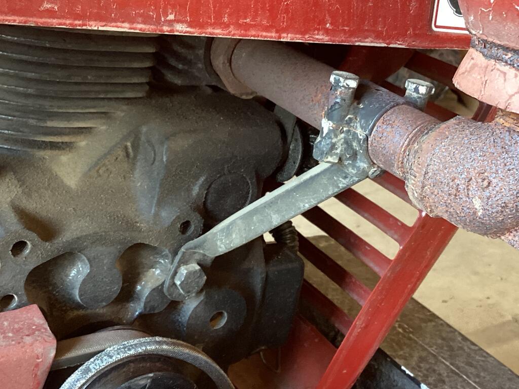

Pullstart 71,144 #19790 Posted August 13, 2023 @Wheel-N-It Van here are some pictures of my stack brace. I used 1/2” square tube, smashed into a flange at the block. For the pipe clamp, I used n old racer’s clamp trick. Weld a couple 1/4” tubes to a sleeve, then cut the sleeve and tubes sectionally. I also TIG welded the 90 degree elbow to the 3/4” pipe to prevent it from rotating. A good quality conduit lock nut could do the same job. Ultimately, I imagine we have about the same weight to support, your heavy pipe and my Cherry Bomb. 1 4 1 Share this post Link to post Share on other sites

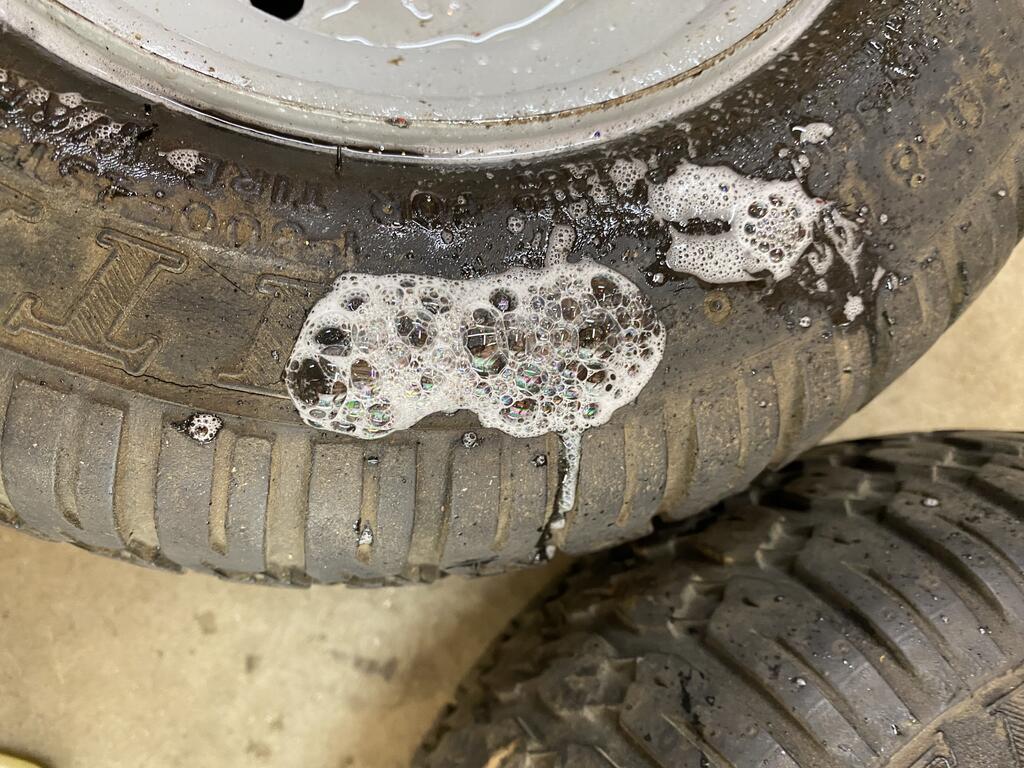

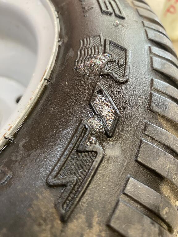

squonk 47,979 #19791 Posted August 13, 2023 On 8/6/2023 at 10:34 AM, Sparky said: CRUD!! The wheels are perfect…and I thought the tires were as well so I skipped (cheaped out) on tubes. Apparently the tires are NOT perfect. Both have issues ! Now I have to break em down and install tubes. First guy to tell me that I shoulda put tubes in right from the start gets a 30 day suspension from Red Square .. Your nice new tubes will be right thru those sidewalls before ya know it! Should bought new tires and skipped the tubes! 1 Share this post Link to post Share on other sites

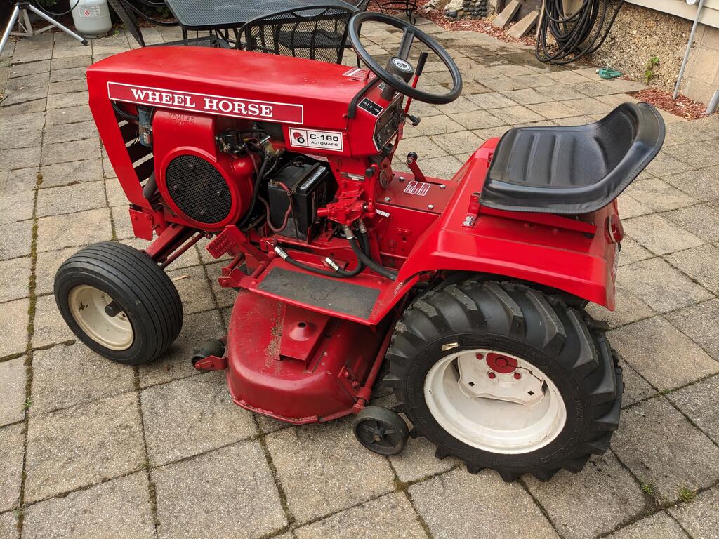

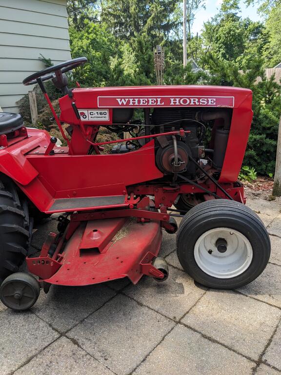

LandoCommando214 82 #19792 Posted August 13, 2023 Frankensteined a C-161 motor into my C-160, and I love it. I think the vibration isolators are on their last leg, but a little dampening while at PTO speed is nice. Also this muffler is 8 billion times quieter than my old one. 5 5 Share this post Link to post Share on other sites

ebinmaine 80,445 #19794 Posted August 13, 2023 23 hours ago, Wheelhorse#1 said: Seat I found.... NIIIIICE 👍👍👍 2 Share this post Link to post Share on other sites
squonk 47,979 #19795 Posted August 13, 2023 On 8/6/2023 at 11:13 AM, Gasaholic said: Nah... just fill 'em up with Great Stuff expanding foam (2-3 cans per tire) and let it cure a couple days, you got run-flats. (Unfortunately, I HAVE seen that done by someone thinking they hit on a great idea... then wanted me to break down the tires and put on new tires & tubes... I told 'em it would be cheaper for them to buy whole new tires & rims than pay for my shop labor time to do it.) I think @wallfish tried that a few years ago with comical results! 2 Share this post Link to post Share on other sites

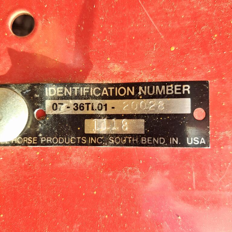

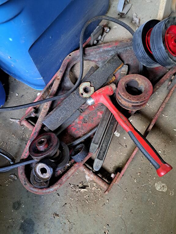

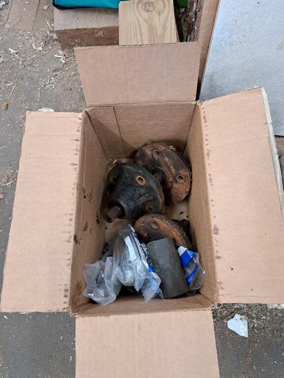

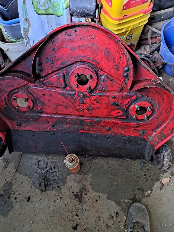

Gasaholic 390 #19797 Posted August 13, 2023 Got my '74 36" RD Deck torn down today to replace the 3 bearings. everything came apart a lot more easily than I had expected. I was prepared to go hunting for new pulleys (cast iron double-d) and just a little finesse and lots of kroil, they slid right off! Yay! Now to run over to the local car shop tomorrow and borrow his shop press to replace my bearings, new 5188 bolts on order coming next week for the new gage wheels, clean and coat the deck (Mo-deck) and I should have my C-100 mowing again. (Mows much better than that 2014 Columbia/MTD does, and that POS needs a bit of work on it, as it is starting to show its age, have to have deck lifted to the next to highest notch to get a normal cut height, when it used to sit at the middle notch... Plus, maybe surprisingly, maybe not, that 20 HP Kohler Courage uses more gas than my C-100 for the same work, despite the deck size difference.... 10 HP Kohler is just so efficient... and actually has MORE power than that 20 HP. ) 5 1 Share this post Link to post Share on other sites

wallfish 20,547 #19799 Posted August 13, 2023 30 minutes ago, squonk said: I think @wallfish tried that a few years ago with comical results! Ha Yeah, I foamed a small walk behind snow blower tire a while ago. It worked for about 2 years then got flat on the bottom! LoL BUT, the foam keeps it like that so it can be flat on the top too. I forgot to prop it up to take the weight off when sitting for a while. Forget exactly what I did but opened something or poked a hole in it or something before it was completely cured and that $@!t spit out and splattered everywhere 1 6 Share this post Link to post Share on other sites
Wheel-N-It 2,978 #19800 Posted August 13, 2023 2 hours ago, Pullstart said: @Wheel-N-It Van here are some pictures of my stack brace. I used 1/2” square tube, smashed into a flange at the block. For the pipe clamp, I used n old racer’s clamp trick. Weld a couple 1/4” tubes to a sleeve, then cut the sleeve and tubes sectionally. I also TIG welded the 90 degree elbow to the 3/4” pipe to prevent it from rotating. A good quality conduit lock nut could do the same job. Ultimately, I imagine we have about the same weight to support, your heavy pipe and my Cherry Bomb. Hey now Kevin, that's pretty slick!!! Those old Racers tricks are battle tested and approved BTW, did you know that " Racecar " spelled backwards is " Racecar " ? 1 7 Share this post Link to post Share on other sites
