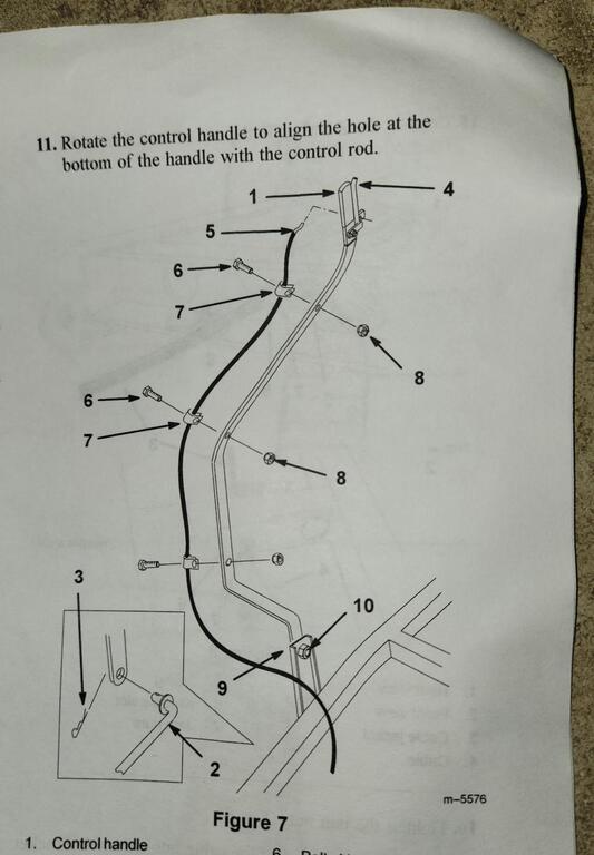

Handy Don 16,933 #17779 Posted November 22, 2022 14 minutes ago, ebinmaine said: Folks on that bike cable to release lever idea, any threads on that? Been thinking of doing that to our plows here for ease of changeover. I did search this a couple weeks ago and found a couple of mentions of this as an idea but no pictures or "done that" posts. However, Toro did this as a factory job on at least one blade. I found the manual in the files (link below) and since I have a LOT of spare bike parts, I'll model my conversion on their design. 1 1 1 Share this post Link to post Share on other sites
ebinmaine 79,633 #17780 Posted November 22, 2022 32 minutes ago, Handy Don said: Toro did this as a factory job on at least one blade. I found the manual in the files (link below) Excellent. Thank you. Share this post Link to post Share on other sites

ebinmaine 79,633 #17784 Posted November 22, 2022 2 hours ago, Handy Don said: this as an idea but no pictures or "done that" posts. However, Toro did this as a factory job on at least one blade. I found the manual in the files (link below) and since I have a LOT of spare bike parts, I'll model my conversion on their design Looks like @pfrederi Paul and @Ed Kennell both have experience with this changeover in the past. Seems like it would be a relatively straightforward transformation. I'd like to see how the barrel end of the brake cable would be attached and what end it was used on, etc. 2 Share this post Link to post Share on other sites

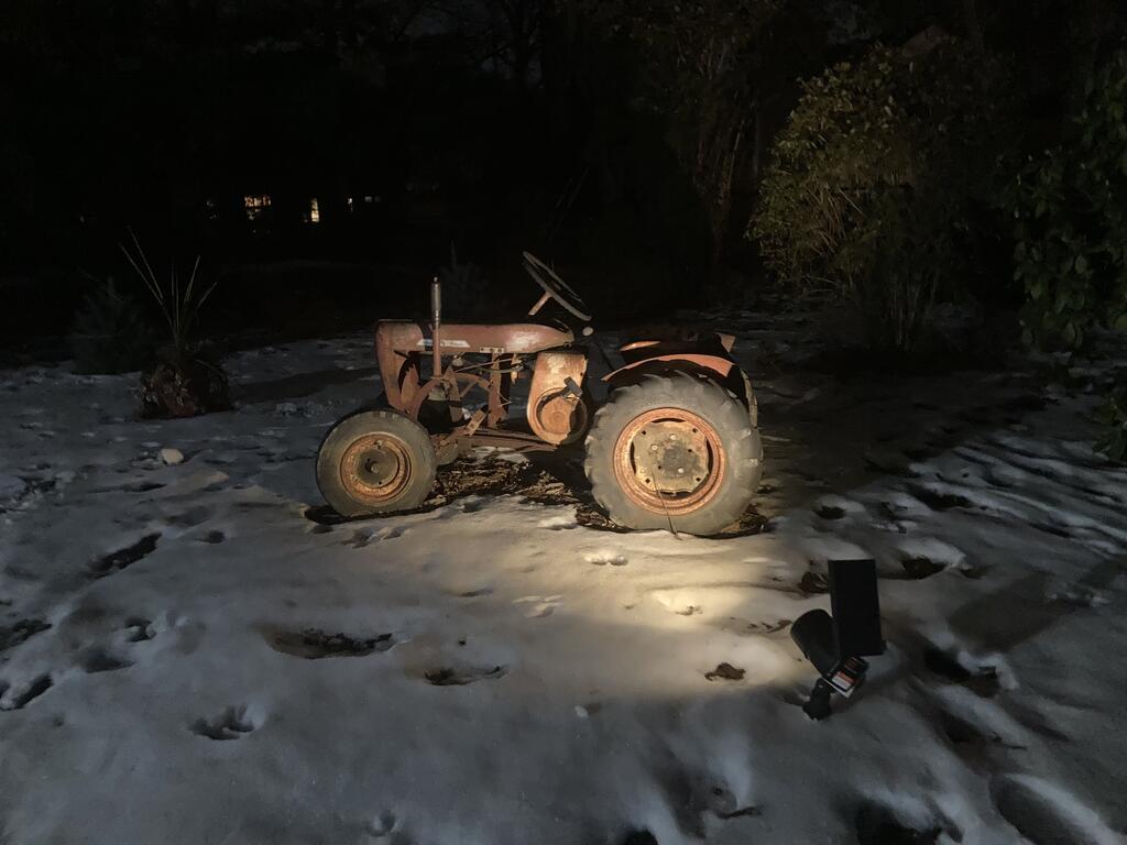

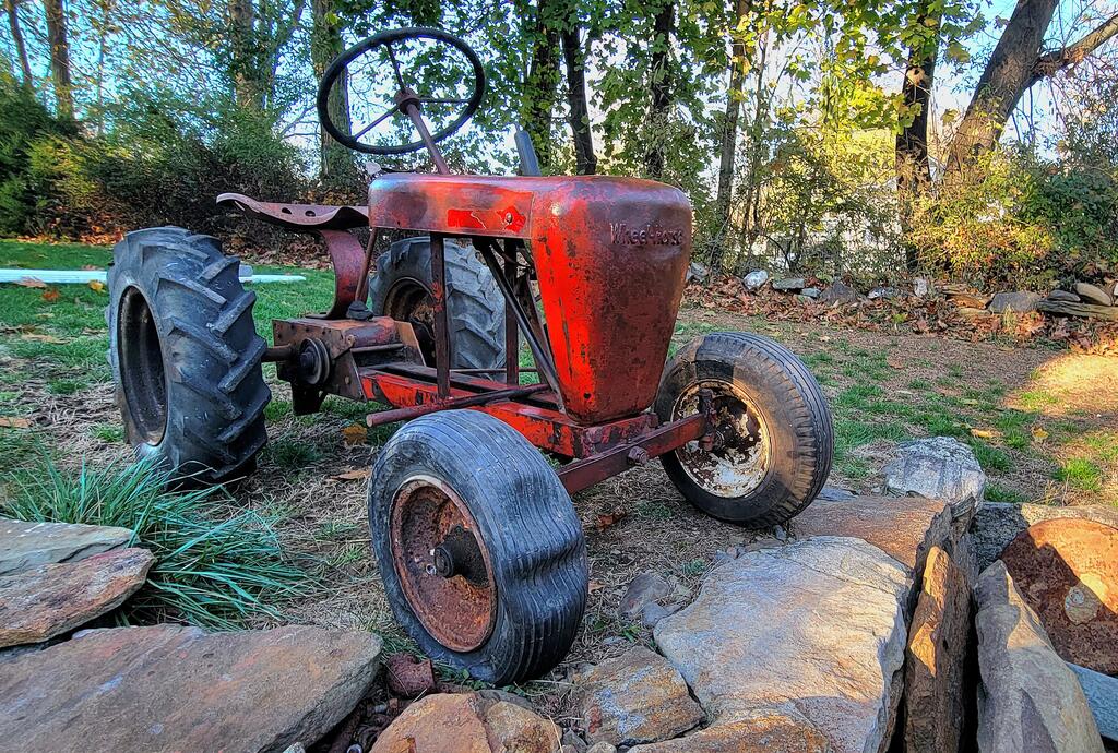

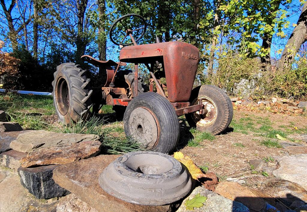

AMC RULES 37,259 #17786 Posted November 22, 2022 Got a start on it's true patina restoration here today. 3 6 4 Share this post Link to post Share on other sites

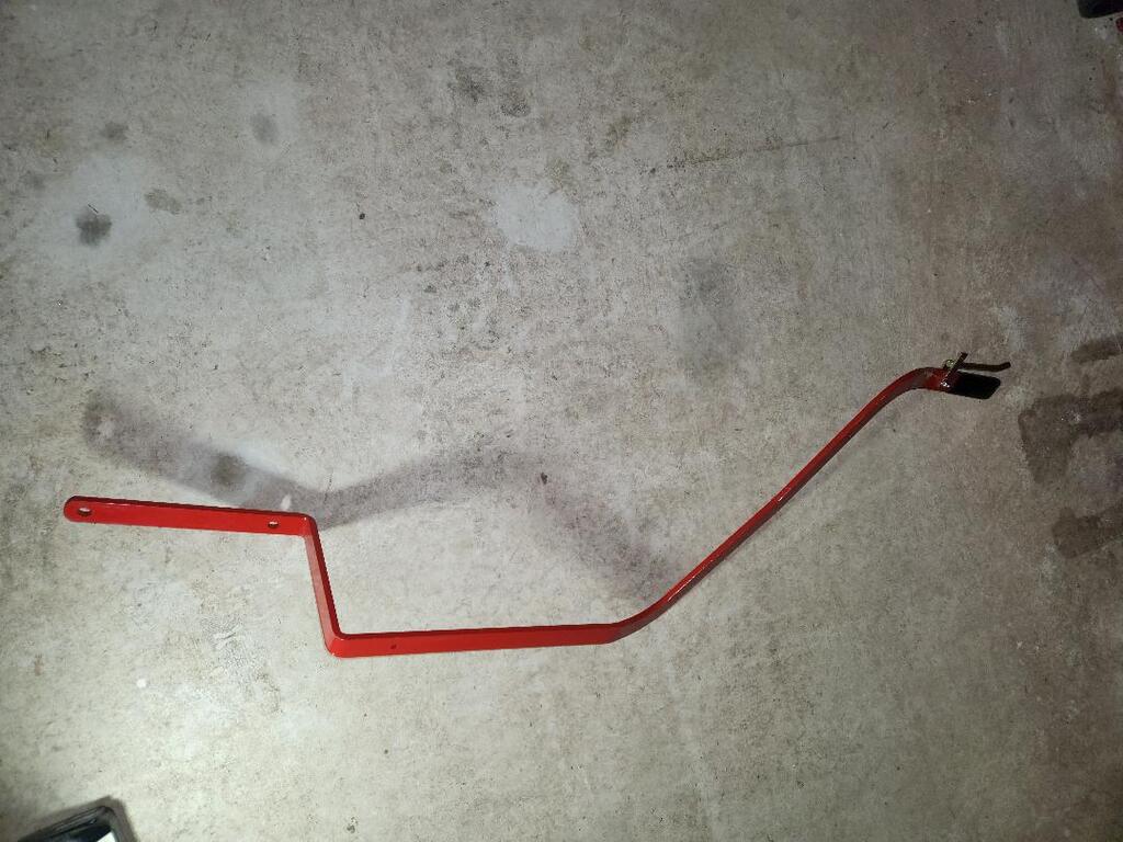

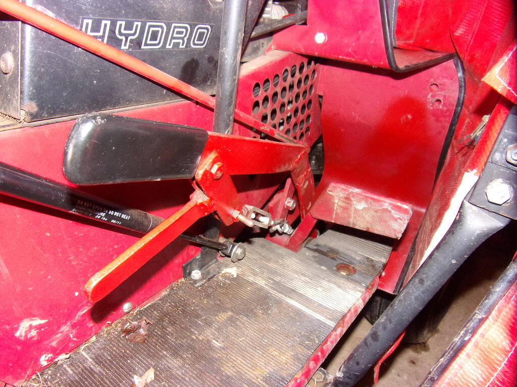

Ed Kennell 46,551 #17793 Posted November 22, 2022 (edited) 3 hours ago, ebinmaine said: Looks like @pfrederi Paul and @Ed Kennell both have experience with this changeover in the past. I never used a bike brake cable, but I did use a piece of garage door cable to replace the upper wire when I reworked my blade angle lever to bring it inside the warm cab. I used small eyebolts as guides and a small turnbuckle for tension adjustment. Edited November 22, 2022 by Ed Kennell 7 4 Share this post Link to post Share on other sites
Handy Don 16,933 #17794 Posted November 22, 2022 (edited) 40 minutes ago, Ed Kennell said: I never used a bike brake cable, but I did use a piece of garage door cable to replace the upper wire when I reworked my blade angle lever to bring it inside the warm cab. I used small eyebolts as guides and a small turnbuckle for tension adjustment . Kinda snug in there! What is the gas cylinder for? Edited November 22, 2022 by Handy Don 3 Share this post Link to post Share on other sites
Ed Kennell 46,551 #17795 Posted November 23, 2022 30 minutes ago, Handy Don said: Kinda snug in there! What is the gas cylinder for? Yep, warm and cozy. The cylinder is connected to the motion control lever and pushes it back to reverse. The lever is then connected to the right foot pedal. Push pedal down for forward and let cylinder pull pedal up for reverse. Push left pedal for neutral and brake. I have springs on some and cylinders on some. Both work equally well. 7 1 Share this post Link to post Share on other sites

Brockport Bill 2,425 #17797 Posted November 23, 2022 6 hours ago, Handy Don said: I did search this a couple weeks ago and found a couple of mentions of this as an idea but no pictures or "done that" posts. However, Toro did this as a factory job on at least one blade. I found the manual in the files (link below) and since I have a LOT of spare bike parts, I'll model my conversion on their design. i have a new OEM plow blade of the model 79364 you reference in the thread -- i removed the parts kit from the box and and plan to install plow in next couple of weeks before a first snow storm -- I am curious to see how well the "cable" design works versus the old style wire rod --- since my other plow is 06-48bc-01 for my original new 1989, 312-8 bought 33 yrs ago...... of course with the newer version lever arm handle having many twists and turns it wouldnt work very well with the old style straight wire.... thus they advanced the design to the flexibility of the cable design----- My neighbor needs a missing lever arm and squeeze handle, and wire rod, for an older 80s style plow he just got ---- and our first thought was the bike brake handle and cable as a solution rather than hunting for the traditional solution---- so it was interesting to coincidentally see this thread today about the cable --- I will be eager to experience this winter how the newer cable design works verus the old style 4 Share this post Link to post Share on other sites

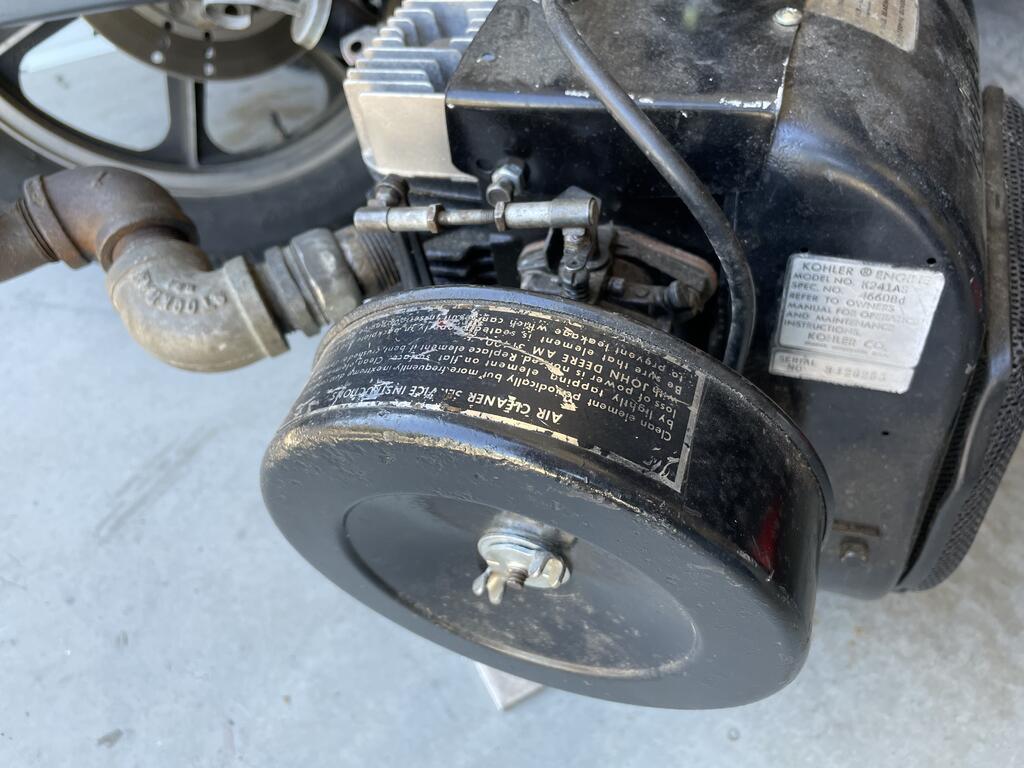

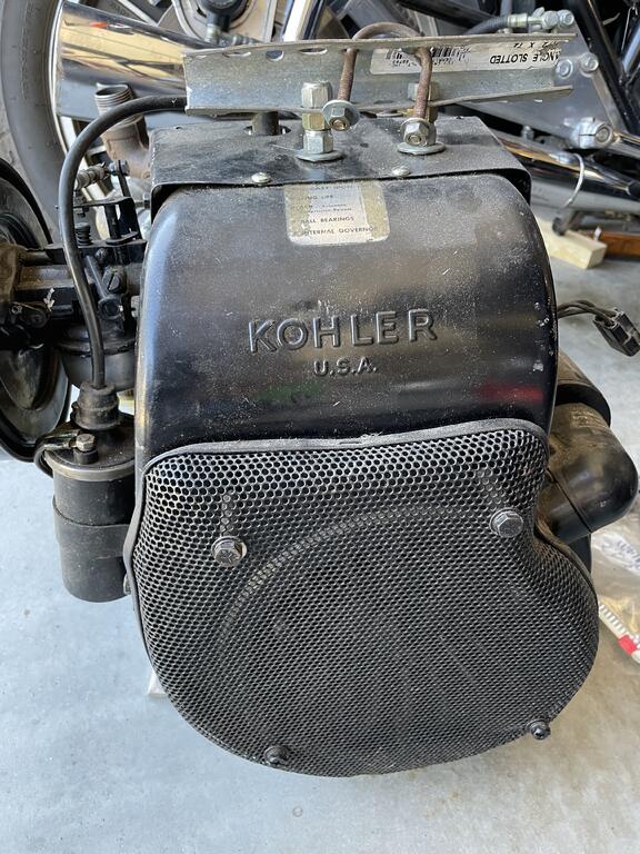

Tuneup 1,459 #17798 Posted November 23, 2022 (edited) On 11/18/2022 at 1:59 PM, Tuneup said: HaHa - hate taking pics and my flip phone is not a joy. The company phone can send but through Outlook which - this time - didn't work. I'll take a video of it putt-putting. That'll be fun. First, the old Ridgid drill press gets its facelift. I've pulled about 5 lbs of dirt dauber nests from it so far (was just given to me). And so, it's finally time to see if this auction found '71 K241 can live! I attached it to a scrap pallet which took most of the time. Added an old muffler. Hooked it up to the 516 battery because she's not shy at helping to start a John Deere engine - as long as it's a K. Had to add about a pint of oil. She started easy with a little choke and purrs. So, the promised video? I hope it works . . . well, nope! Standard iPhone video MOV. Oh, well. Now, what the heck to do with this thing? I'm like its former owner - sit it on a rack until needed but, considering the way these are made, I'll probably die first and some estate sale slob will get it cheaper than me. The 125's just got bored .020 and is a brute sans its balance gears. The old '77 K301 just goes and goes. Anyway, HAPPY THANKSGIVING! Edited November 23, 2022 by Tuneup 3 2 Share this post Link to post Share on other sites

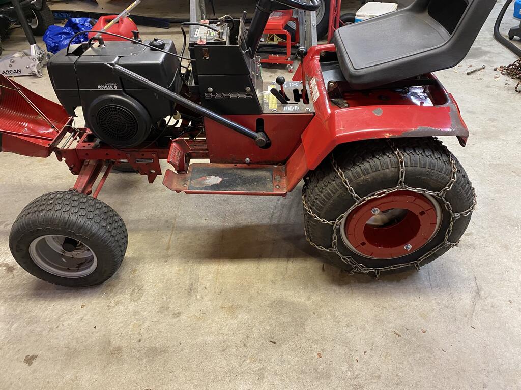

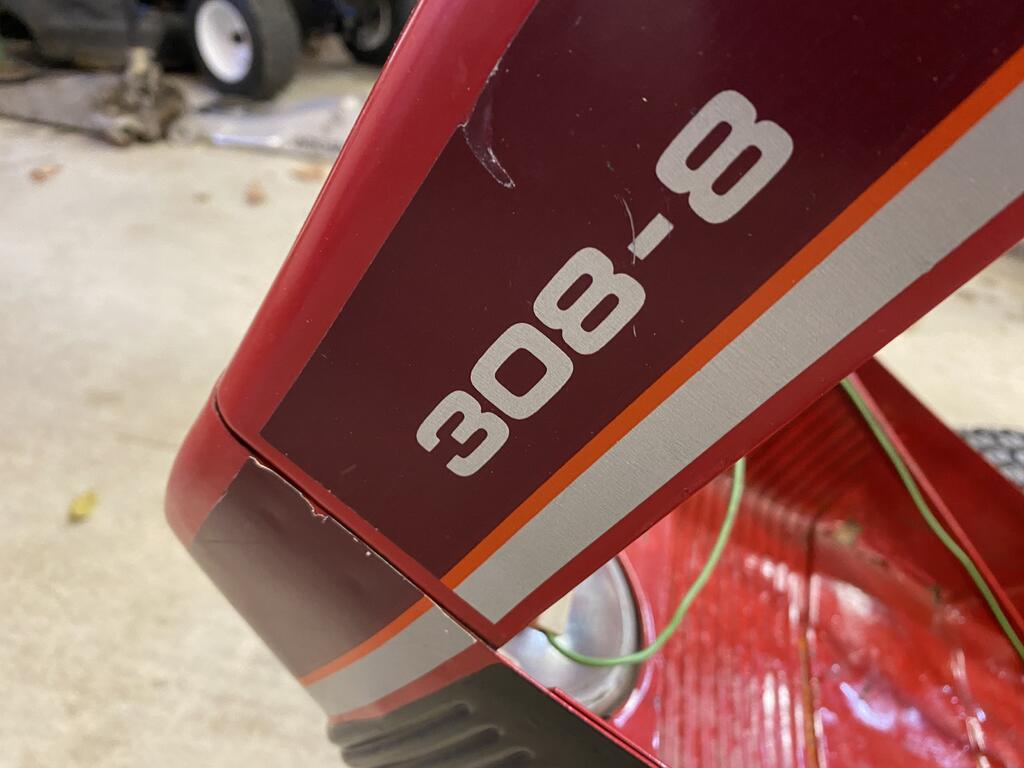

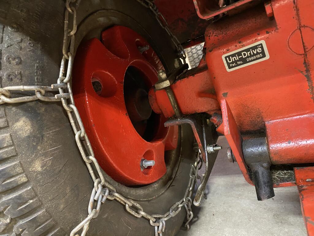

Sparky-(Admin) 25,934 #17799 Posted November 23, 2022 Got all the weights mounted up on the 308…one step closer to being a snowplow tractor. 6 8 Share this post Link to post Share on other sites
ebinmaine 79,633 #17800 Posted November 23, 2022 15 minutes ago, Sparky said: all the weights Like them inner n outer... 4 1 1 Share this post Link to post Share on other sites
