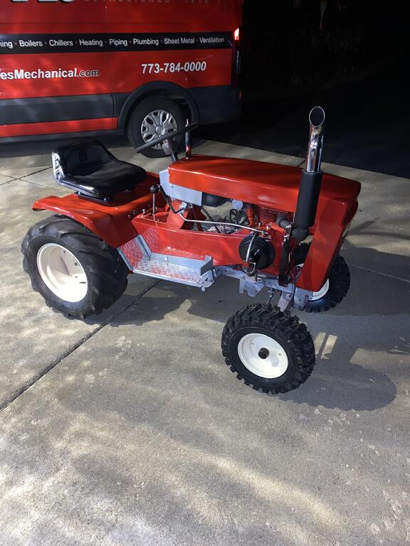

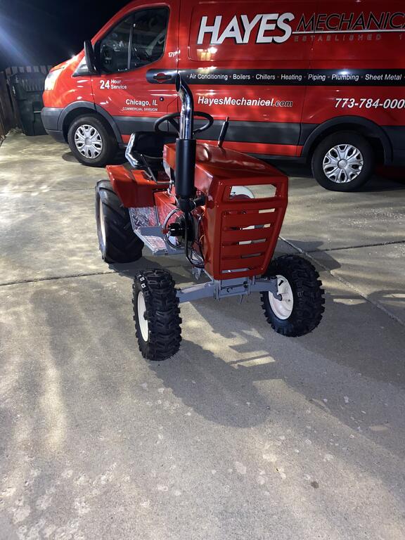

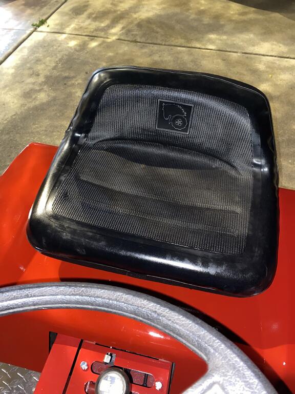

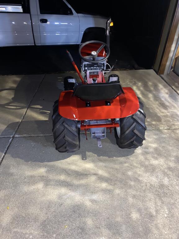

Heatingman 977 #17256 Posted October 3, 2022 (edited) Just about finished with the B-80 overhaul. Still need to put in the lifing arm, head and tail light, make the trim for the headlight, and a few other odds and ends. Gotta wait a few weeks before I put the decals I got from redoyourhorse.com on. So the paint can cure some. I was able to make the seat cover and cushion from @Burnerman work, and the headlight I got from him should work aswell. I did not notice when I first got the replacement seat cover that it was a touch taller then the original, so to get it to fit, I had to trim about an inch of foam from the back rest, and trim the vinyl to get the windlace to secure it properly Edited October 3, 2022 by Heatingman 4 13 Share this post Link to post Share on other sites
ebinmaine 80,198 #17257 Posted October 3, 2022 2 hours ago, Heatingman said: B-80 overhaul Looks excellent!! 1 Share this post Link to post Share on other sites

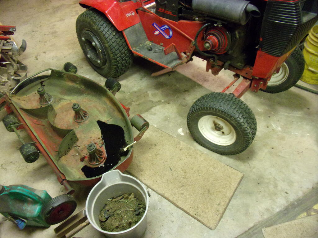

Ed Kennell 46,879 #17259 Posted October 3, 2022 Four days of cold rain and no sign of any sun for a few more days till Ian decides to head across the Pond. So I pulled the 312H in to the heated shop and started the switch from lawn mowing to snow plowing. Pulled the 42"SD and gave it a greasy Pete winterizing treatment. No sun so it'll have to dry inside this winter. Changed engine oil and greased all zerks. Except that dag blamed steering block. Guess I gotta take the belt guard off to get to it...nuther day. The rubber tire chains and the 48" snow plow will go on for the winter. 3 9 Share this post Link to post Share on other sites

peter lena 10,000 #17262 Posted October 3, 2022 @Ed Kennell glad to see that winterising oil soak going down , the opposite of wet / moldy for months lets the oil soak in and feed that metal . my decks are stained black , zero rust / grunge , leave them on the back side , so the treatment is held there . after weeks , use a spring to hold them up against the wall . no oil drip issues , been working for me , pete 4 Share this post Link to post Share on other sites

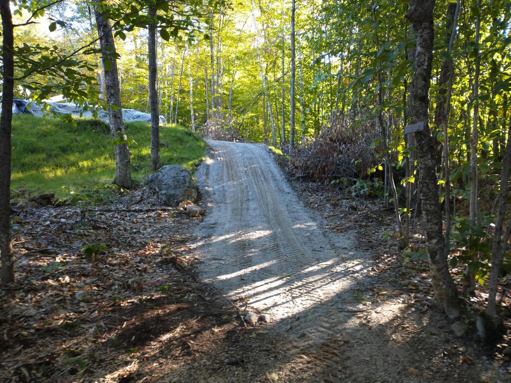

ebinmaine 80,198 #17264 Posted October 3, 2022 @squonk here's the heaviest load I've tried to pull up the new ramp. That's a 17 cubic foot Ohio Steel trailer that's mounded over with wet maple. Note I said tried. The underlayer of VERY soft sand stopped me from getting all the way up the new ramp to the new building site. Not a big deal. I just backed down and went around to the backyard access gates which was an easy climb. I'll be starting a thread looking for ideas about how to address that situation. 6 Share this post Link to post Share on other sites
lynnmor 8,997 #17265 Posted October 3, 2022 22 minutes ago, ebinmaine said: @squonk here's the heaviest load I've tried to pull up the new ramp. I'll be starting a thread looking for ideas about how to address that situation. I wonder how much rolling resistance is caused by the heavy front end pushing the ag tires into the soft surface. Share this post Link to post Share on other sites
ebinmaine 80,198 #17266 Posted October 3, 2022 Just now, lynnmor said: I wonder how much rolling resistance is caused by the heavy front end pushing the ag tires into the soft surface. Nowhere near enough... Odd as that sounds. With that heavy load on the rear hitch the front of this tractor is still QUITE light by the time I get to the top of that ramp. Like light enough that it barely steers. 1 Share this post Link to post Share on other sites
lynnmor 8,997 #17267 Posted October 4, 2022 I have a similar trailer hauling similar loads of wood, my 23" turf tires spin easily going up a grade that isn't much. I have wheel weights but don't use the chains. What I do is put the hammer down before the grade and keep it down. 1 Share this post Link to post Share on other sites

ebinmaine 80,198 #17269 Posted October 4, 2022 45 minutes ago, lynnmor said: I have a similar trailer hauling similar loads of wood, my 23" turf tires spin easily going up a grade that isn't much. I have wheel weights but don't use the chains. What I do is put the hammer down before the grade and keep it down. Yessir. Done did that too. I have Cinnamon Horse's K341 top RPM set at 3300. That in 3rd high is what began the approach. With a less loaded trailer it'll easily climb the hill but at the top I have to kill the RPMs or I can't make the slight left turn due to floaty front tires. Share this post Link to post Share on other sites
SylvanLakeWH 32,074 #17270 Posted October 4, 2022 21aa gravel might do the trick… sand spreads under load. 21aa locks up. 1 Share this post Link to post Share on other sites
ebinmaine 80,198 #17271 Posted October 4, 2022 5 minutes ago, SylvanLakeWH said: 21aa gravel might do the trick… sand spreads under load. 21aa locks up. What is that by size of rock? Share this post Link to post Share on other sites
8ntruck 9,204 #17272 Posted October 4, 2022 Roto roller and Portland cement? Share this post Link to post Share on other sites
