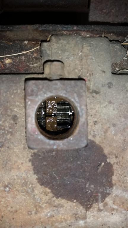

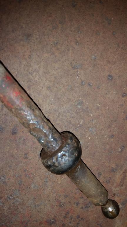

WHX?? 57,483 #1692 Posted January 4, 2019 14 minutes ago, oliver2-44 said: If what comes out is really ugly The 604 came out real ugly & mostly water... sitting for the winter filled to dang near the top with kerosene. Over added through the shifter hole. Will run it come spring and re-drain/refill. Never saw a shift lever quite so bad. 1 Share this post Link to post Share on other sites

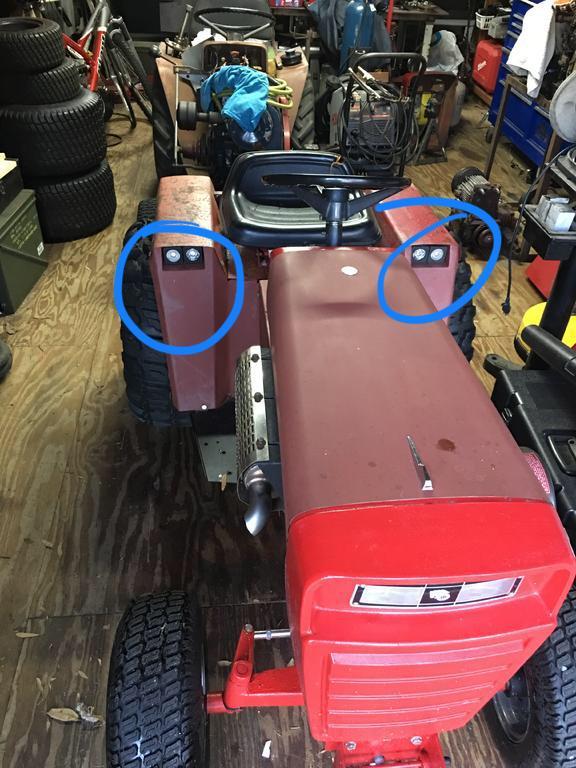

LengerichKA88 1,885 #1693 Posted January 4, 2019 @19richie66 I’m just now seeing this picture, but are those headlights? Share this post Link to post Share on other sites

19richie66 17,930 #1696 Posted January 4, 2019 (edited) 3 hours ago, KyleLengerich said: @19richie66 I’m just now seeing this picture, but are those headlights? Yes they are. They are 2" 10 watt LED lamps mounted together with a small tab that comes with them. Just search 2" LED spot lamp Sorry to put my mug in there but here is how they look. That was my first test drive after getting it together. Still have some small tweaks to do on her. The lights work great but you have to watch your legs or they get in the way of the light. @PeacemakerJack can vouch for how well they work. Edited January 4, 2019 by 19richie66 3 4 1 Share this post Link to post Share on other sites
LengerichKA88 1,885 #1697 Posted January 4, 2019 @19richie66 that’s really cool. I would’ve never thought of sticking lights there, but as soon as I saw it I thought “That’s genius!” Idea tucked away for later for sure lol 1 Share this post Link to post Share on other sites
19richie66 17,930 #1698 Posted January 4, 2019 Well I'm no genius but whoever put them there in the larger tractors could be 2 3 Share this post Link to post Share on other sites

LengerichKA88 1,885 #1700 Posted January 4, 2019 59 minutes ago, 19richie66 said: Well I'm no genius but whoever put them there in the larger tractors could be I guess I’ve just never noticed em before, I thought you cut the spot out and put em in there yourself. I guess that’s why I don’t design tractors 😂😂 1 Share this post Link to post Share on other sites
