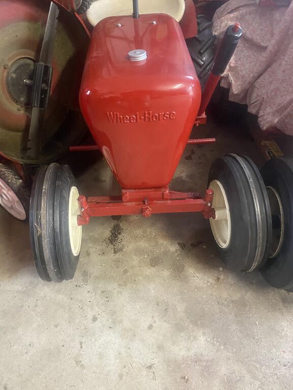

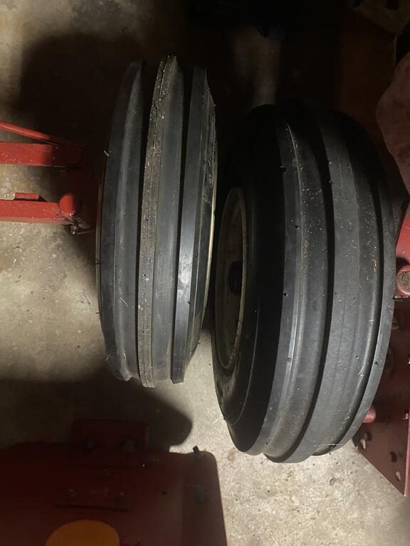

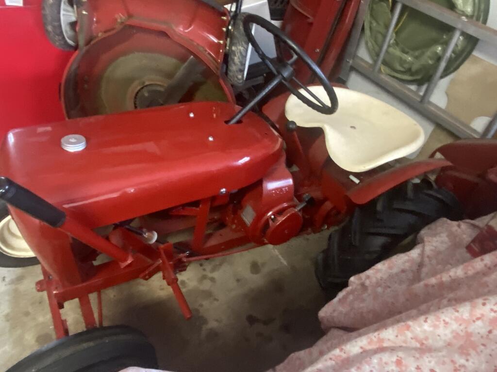

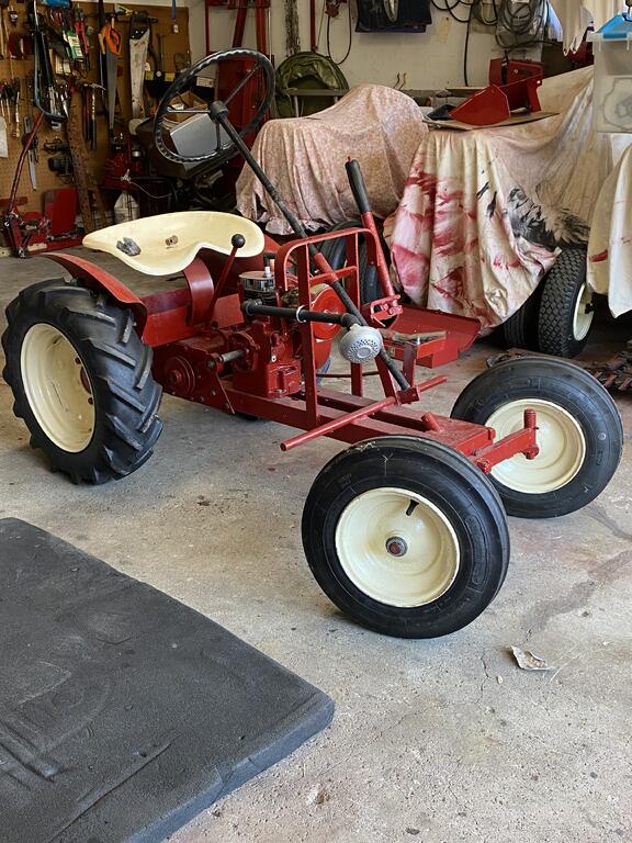

Lane Ranger 12,131 #13603 Posted November 19, 2021 (edited) On 11/11/2021 at 8:02 AM, JoeM said: @Lane Ranger Front tire mfg? Front wheel color? looks good! I use Rustoleum Canvas White for my wheels. The tires are Deestone . In this case for the RJ I put 3.50 x 8. Instead of the bigger 4 . Here is a side by side view of tri-ribs 3.50 and 4.00. I have made some progress on the RJ since this first photo. Edited November 19, 2021 by Lane Ranger 8 3 1 Share this post Link to post Share on other sites

Wheelhorse#1 1,997 #13606 Posted November 20, 2021 22 hours ago, Lane Ranger said: I use Rustoleum Canvas White for my wheels. The tires are Deestone . In this case for the RJ I put 3.50 x 8. Instead of the bigger 4 . Here is a side by side view of tri-ribs 3.50 and 4.00. I have made some progress on the RJ since this first photo. Nice.Are those the Firestone tri ? 1 Share this post Link to post Share on other sites

Lane Ranger 12,131 #13610 Posted November 21, 2021 On 11/19/2021 at 7:26 PM, Wheelhorse#1 said: Nice.Are those the Firestone tri ? The tires are Deestone 1 Share this post Link to post Share on other sites

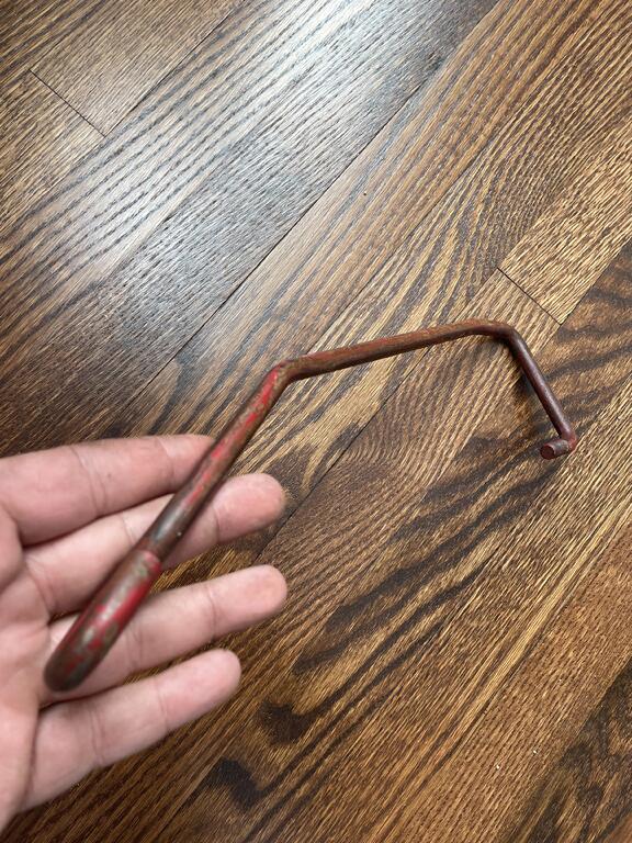

whtractors24 3,572 #13611 Posted November 21, 2021 Taking some of Lowell’s parts and matching them to my patina machine . This was a fun process . 5 Share this post Link to post Share on other sites

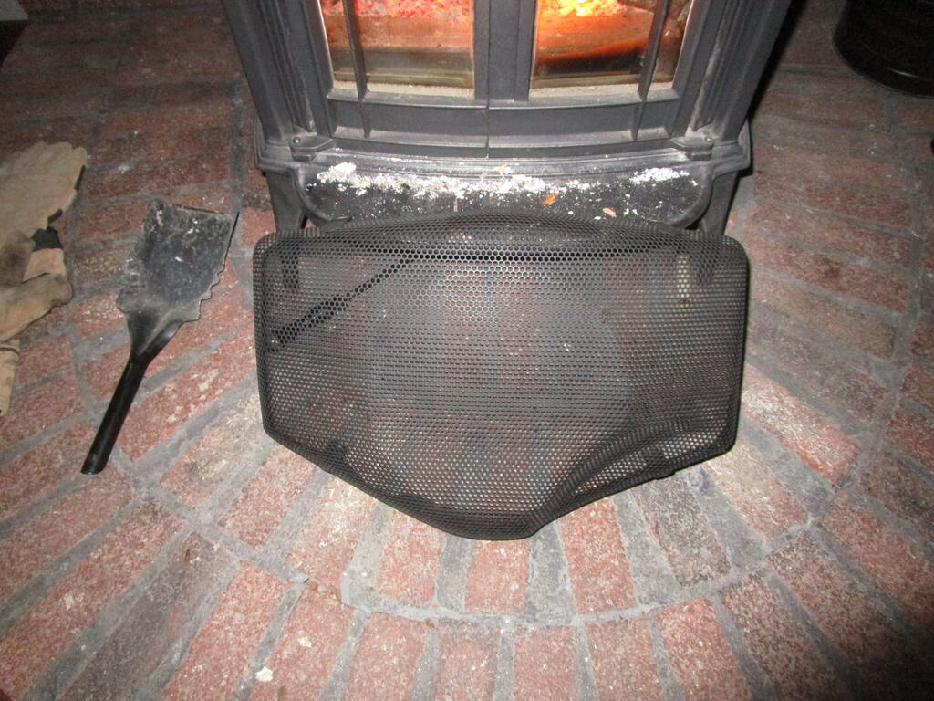

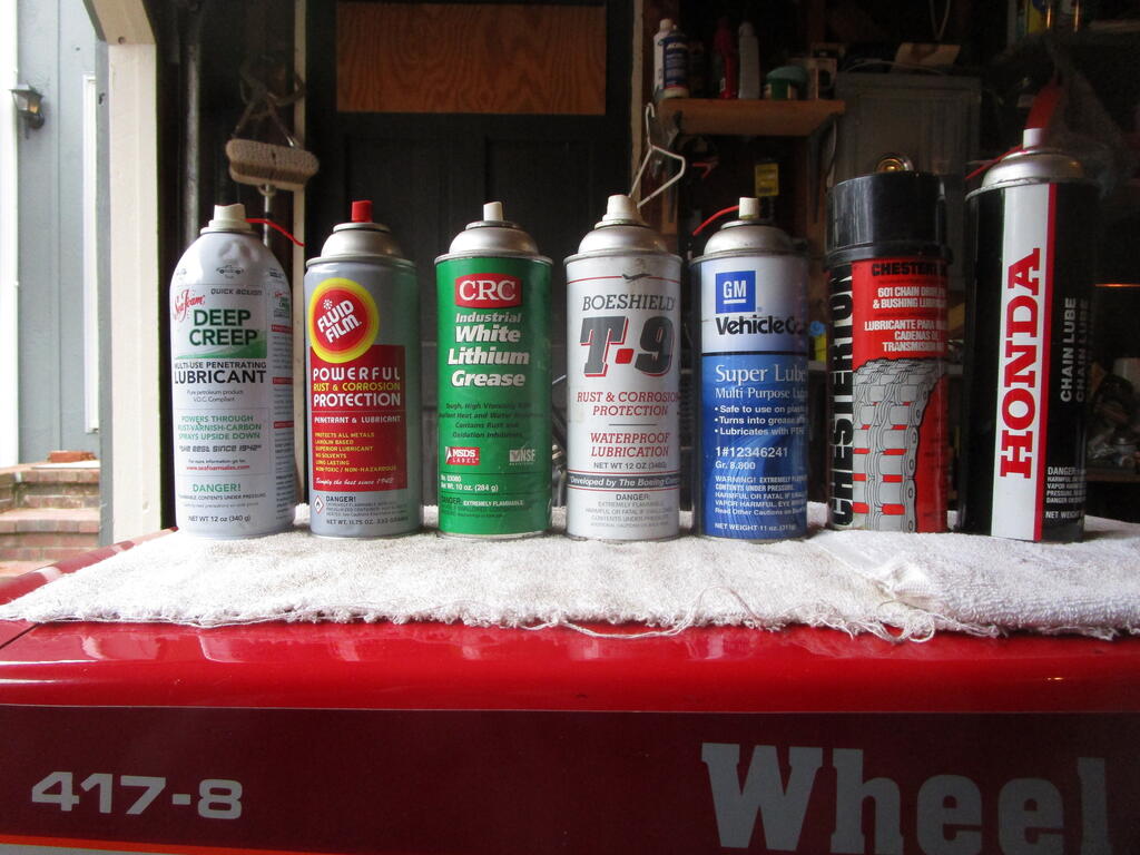

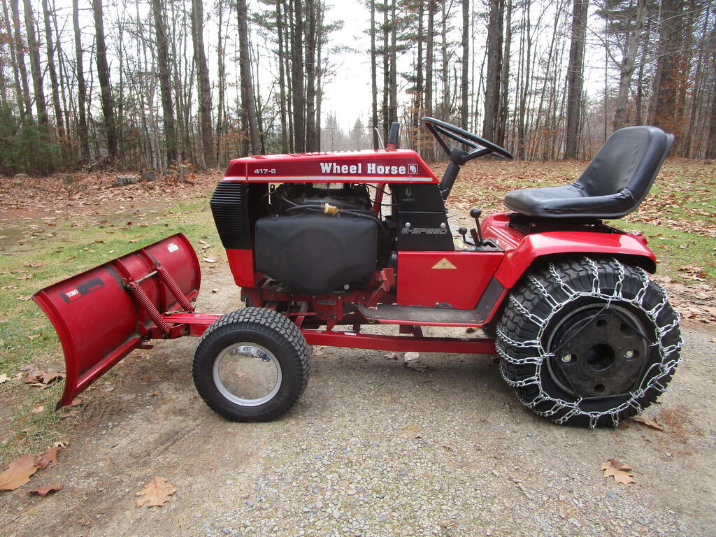

JCM 11,419 #13615 Posted November 21, 2021 Between yesterday and today painted the chaff screen and set up the 417-8 for Winter duty. After reading all the comments on here about painting in cooler weather I thought I would try it. After spraying immediately brought the screen in the basement for 4 hours then in front of the woodstove to bake for 4 more, seemed to work well. Also because of our resident lubrication technician @peter lena I lubricated things that I usually do not. The only problem is the array of lubricants in the shop, which one do you use. 4 9 Share this post Link to post Share on other sites
ebinmaine 80,852 #13616 Posted November 21, 2021 4 minutes ago, JCM said: which one do you use Boy I'd forgotten about that GM Super Lube. That's the stuff. 2 Share this post Link to post Share on other sites
Handy Don 17,533 #13617 Posted November 21, 2021 That's one slippery collection of stuff but looks like the tractor will have good friction. 1 1 Share this post Link to post Share on other sites
SylvanLakeWH 32,668 #13618 Posted November 21, 2021 57 minutes ago, JCM said: The only problem is the array of lubricants in the shop, which one do you use. The one with the least amount in it… use it up and keep going… 5 1 1 Share this post Link to post Share on other sites
ebinmaine 80,852 #13619 Posted November 21, 2021 14 minutes ago, SylvanLakeWH said: The one with the least amount in it… use it up and keep going… I like the practicality behind that. 2 1 Share this post Link to post Share on other sites
peter lena 10,081 #13620 Posted November 21, 2021 @JCM use the seafoam deep creep , great for fuel issues , used the fluid film in confined areas , very nice looking horse , thank you for keeping it that way , too many in rough shape , pete 3 1 Share this post Link to post Share on other sites
pfrederi 21,214 #13621 Posted November 21, 2021 GAA (grease Artillery and Automotive) works OK on my stuff. (won the last big war too!!!) 3 Share this post Link to post Share on other sites
Bob Lister 142 #13622 Posted November 21, 2021 I am a big fan of Fluid Film I use it in my shop all the time. Door hinges and hood latches especially Tractors wherever parts move get a shot. My grease gun usually has marine grease as it is good for the outboard steering and easier than reloading grease gun for different purposes 6 1 Share this post Link to post Share on other sites
76c12091520h 4,290 #13623 Posted November 21, 2021 10 minutes ago, Bob Lister said: I am a big fan of Fluid Film I use it in my shop all the time. Door hinges and hood latches especially Tractors wherever parts move get a shot. My grease gun usually has marine grease as it is good for the outboard steering and easier than reloading grease gun for different purposes I'm also a big fan of Fluid Film, I did a "concours" correct restoration of my 67 Coronets' chassis and suspension about 10 years ago. the leaf springs on those cars are bare metal from new. After they were prepped and bare, I coated them with a good dose of Fluid Film. To this day it looks like I just did it yesterday, and bare leaf springs normally rust REAL quick. 4 Share this post Link to post Share on other sites

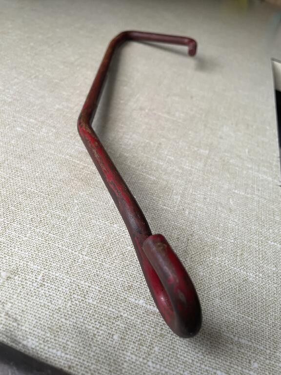

whtractors24 3,572 #13624 Posted November 21, 2021 Making patina match. 6 Share this post Link to post Share on other sites

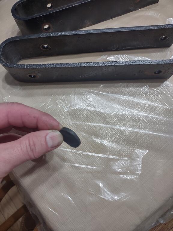

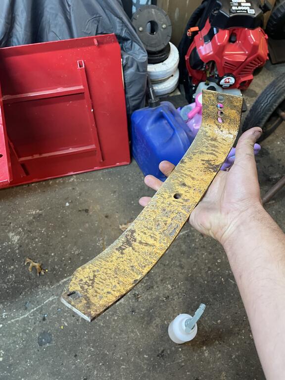

ebinmaine 80,852 #13625 Posted November 22, 2021 Spent a few minutes working on my C-160 Automatic this evening. I removed the seat springs in prep to send them to another member. Also replaced the rubber baby buggy bumpers under the cross support for the seat pan latch. The piece pictured is a result of me shaving the bumpers I had here to make them fit. Also got a new seat for it from a work buddy. He dropped off an old lawn tractor for us to use as a parts rig. The seat is only a year old so I'll run that for winter and try to repair/preserve the original WH seat. 3 Share this post Link to post Share on other sites
