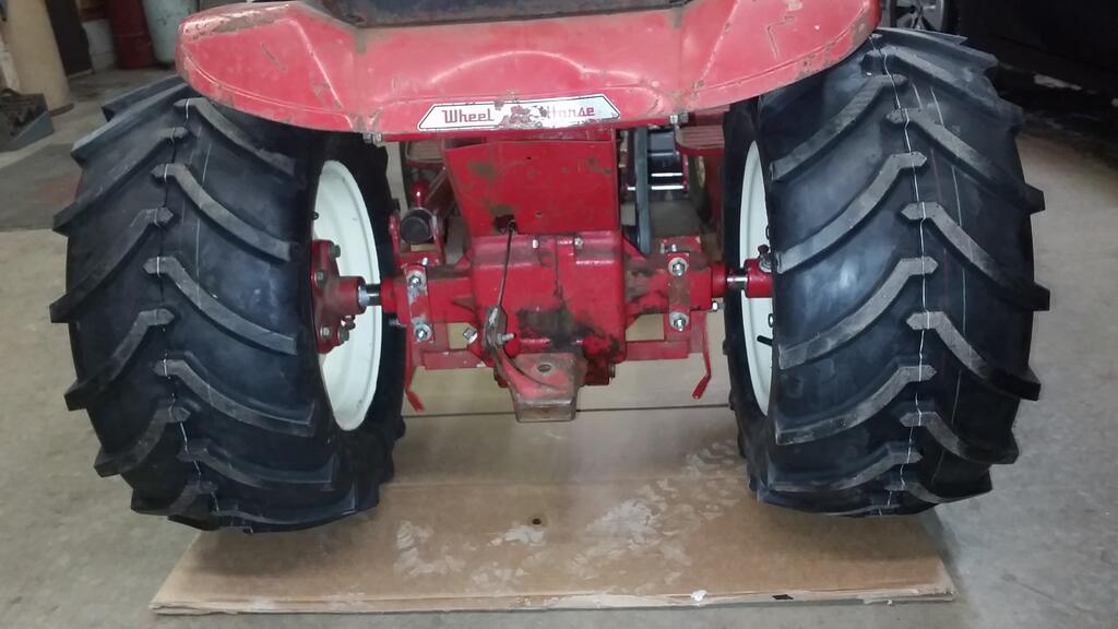

Raposo 532 #13301 Posted October 25, 2021 Put some new rear rims and tires on the 312-8 6 8 2 Share this post Link to post Share on other sites
ebinmaine 80,856 #13302 Posted October 25, 2021 6 minutes ago, Raposo said: Put some new rear rims and tires on the 312-8 That's a top quality candidate for the Wide Rear Wednesday thread! 4 Share this post Link to post Share on other sites

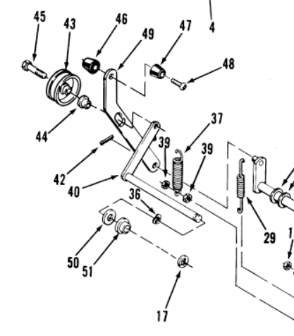

19richie66 17,937 #13303 Posted October 25, 2021 1 hour ago, cleat said: I have removed this release mechanism from my 520's (only came on the early ones) because I never use it and they always seem to rattle. Hey Cleat, Please elaborate on “removed”. I am tired of the rattling myself and thought about removing mine. I’d be interested in how you did yours. I have an idea but I am open to all possibilities 👍 1 Share this post Link to post Share on other sites

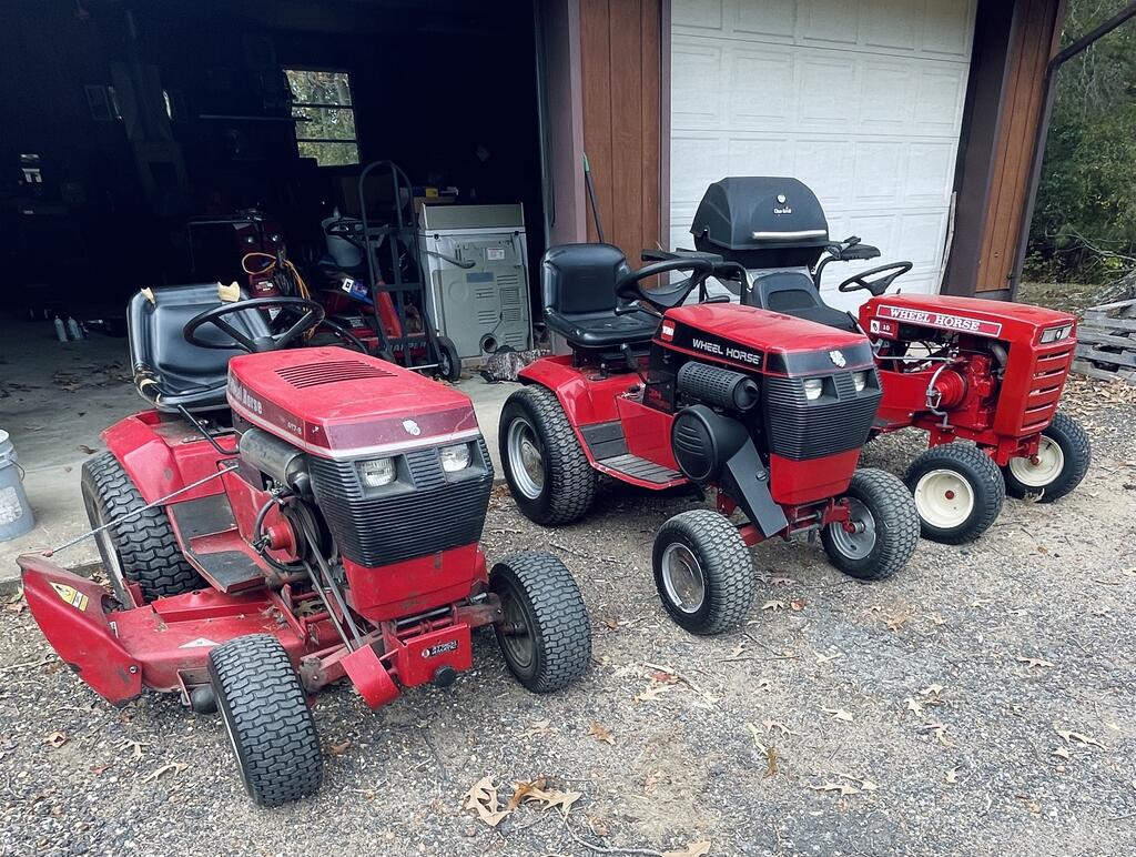

bigcreek 205 #13304 Posted October 25, 2021 Sad but happy day, have a horse leaving the herd. Headed for green grass in South Carolina Best of luck to a new owner, the 314h finds a now home today. This was my first WH, acquire her in 2018 in Maine. She has only 60 hours when I got her, she leaves today with 99.8 hrs. Hate to see a horse leave but when you care for these babies you want them to go to a good home. 6 5 3 Share this post Link to post Share on other sites
cleat 9,376 #13305 Posted October 25, 2021 48 minutes ago, 19richie66 said: Hey Cleat, Please elaborate on “removed”. I am tired of the rattling myself and thought about removing mine. I’d be interested in how you did yours. I have an idea but I am open to all possibilities 👍 Here is the early hydro tension parts list with the belt tension release. Early 520 tension.pdf And here is the later hydro tension parts list without the belt tension release. Late 520 tension.pdf As you can see, the main tension arm #40 and it's spring #37 is the same. You can basically just remove the release arm parts #46,47,49,42,29,,31,35,17. I just put washers behind the pulley #43 to space it out from the arm #40 so it does not rub and the belt lines up. Here is a pic of a machine without the release. 2 2 Share this post Link to post Share on other sites

peter lena 10,081 #13307 Posted October 25, 2021 @bigcreek can relate on wanting your horses to go to a like thinking owner , like my wife often says to me , nobody treats their equipment like you do , they are not people ! but to me they are a well cared for old friend . btw , thank you for keeping it in a very well cared for condition , pete 1 1 Share this post Link to post Share on other sites
19richie66 17,937 #13308 Posted October 25, 2021 (edited) 1 hour ago, cleat said: As you can see, the main tension arm #40 and it's spring #37 is the same. You can basically just remove the release arm parts #46,47,49,42,29,,31,35,17. I just put washers behind the pulley #43 to space it out from the arm #40 so it does not rub and the belt lines up. Ok. That’s what I was thinking. I have my wife’s 1054 set up without a release arm. I appreciate the info. Edited October 25, 2021 by 19richie66 1 Share this post Link to post Share on other sites

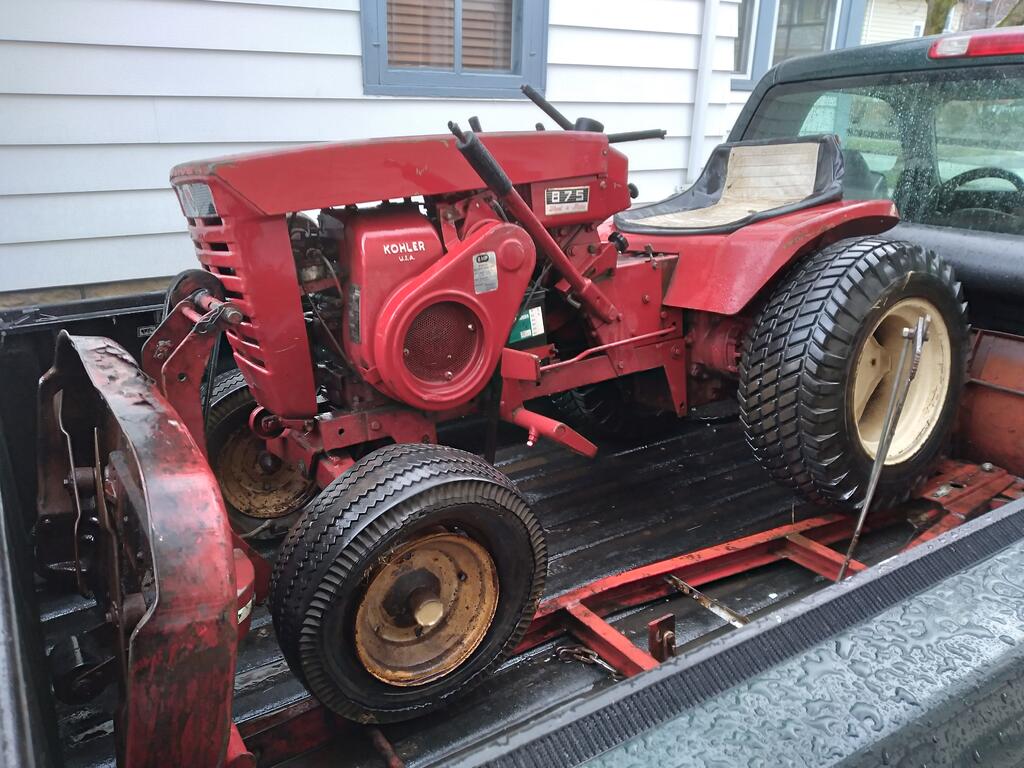

D_Mac 9,339 #13310 Posted October 25, 2021 (edited) I changed the little rubber washers in the metal fuel line that runs from the fuel pump to the carb. Leaked badly.... not anymore!! Remember this was a tractor I picked up for parts and ended up replacing the engine. @squonkpicked up the engine for me at the Big Show. I still need to replace the fitting on the gas tank. When I get to that I will paint the tank. I'm really happy with this 875. Runs fantastic and looks great. Not bad for a parts machine. Edited October 25, 2021 by D_Mac 10 Share this post Link to post Share on other sites
squonk 48,203 #13311 Posted October 25, 2021 Yup. that tank looks like it came from a Freddy Krueger movie! 1 1 Share this post Link to post Share on other sites
D_Mac 9,339 #13312 Posted October 25, 2021 Just now, squonk said: Yup. that tank looks like it came from a Freddy Krueger movie! It has the "wrinkle" finish 1 Share this post Link to post Share on other sites
johnnymag3 2,646 #13313 Posted October 25, 2021 6 hours ago, Gregor said: I was looking at the parts breakdown for a 417-A. This shows the wave washer (36) on the end of the cross shaft, (arm assembly). Is this really where it goes on a 417-A? That's where it is on my 418-A.....where did you find your parts? thanks, John Share this post Link to post Share on other sites

WHX?? 58,280 #13315 Posted October 25, 2021 (edited) If I'd know @Jennifer that that scraper had sides on it I would have gotten it from Craig they sure are handy! Ok Dan @Achto now how did you go go about putting that ahead of the hump drain hole in?!?!? Laying on your back with goo running over the drill and down your arm?!?!? Got a few of those tank straps set one aside for you. Coulda swore one was with it. Lose it on the ride over??? Those tires must be Hi-runs @Raposo they do run a bit wide! They bite like no tomorrow tho That manual for adjusting the VR is here too fellas. @Handy Don @Horse NewbieI'll share what I have on them below. Since I am a early-mid sixties & S/G freakazoid and since my electrical skills are a bit better than my heat wrench skills I have lots of stuff on them DELCO-REMY_SERVICE_BULLETIN.pdf Delco_Remy_Generator_Regulators.pdf 1 Checking a Mechanical Voltage Regulator.pdf Edited October 25, 2021 by WHX?? 4 3 1 Share this post Link to post Share on other sites
Andy N. 2,845 #13316 Posted October 25, 2021 2 hours ago, johnnymag3 said: That's where it is on my 418-A.....where did you find your parts? thanks, John Partstree.com and eBay. When I got the tractor, 46, 47, & 48 were completely gone and the arm (49) was stuck below the cut out slot in the tunnel cover plate. The belt had some marks on it, but I already had a new one so I replaced it. I noticed that the new pulley didn't line up exactly with the PTO and Hydro pulley, so I'll try adding some washers and see how that works. 1 Share this post Link to post Share on other sites

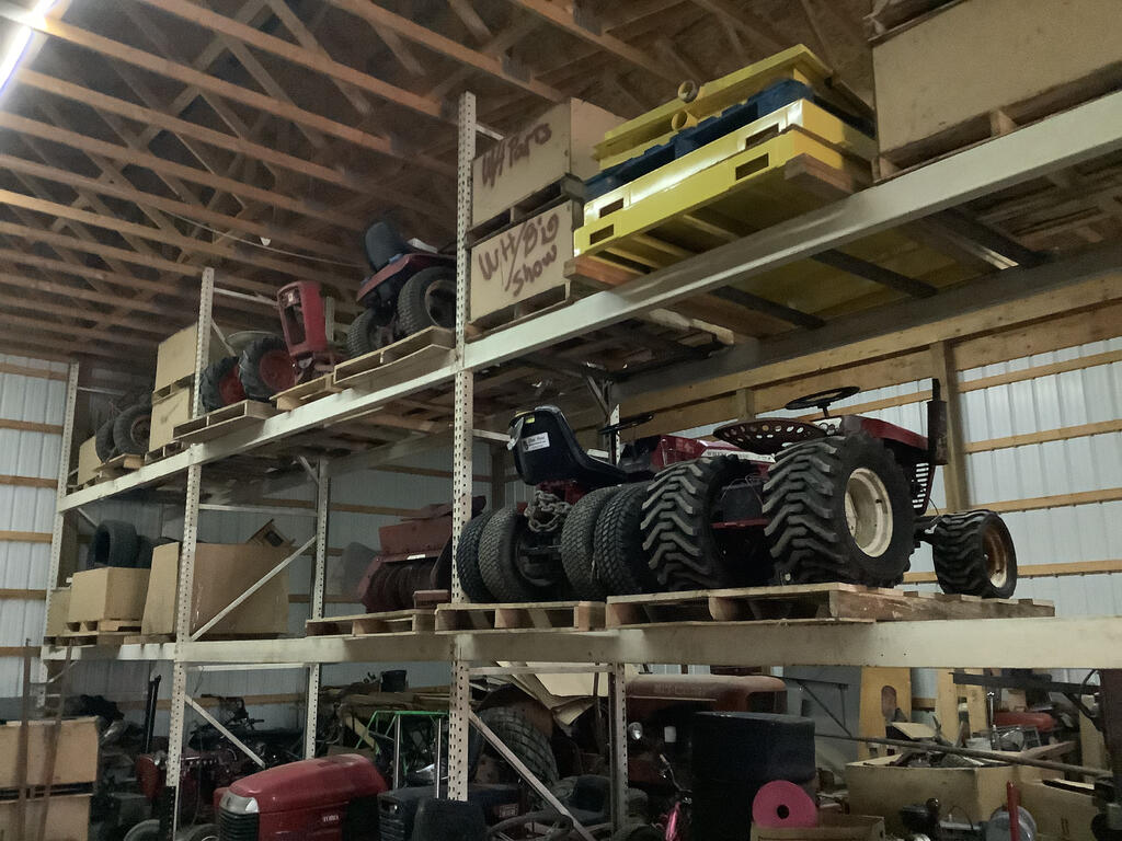

Pullstart 71,350 #13317 Posted October 25, 2021 Moved some machines around, putting some to nap for winter time. 4 into the racks, one down for the chop shop, plus a tote of what could be called a GT-14 came down. I have room for 3 more to go into racking, but am short on pallets. 5 2 Share this post Link to post Share on other sites

SylvanLakeWH 32,676 #13319 Posted October 25, 2021 @Pullstart you tellin' me WHrat WHrecker needs a nap...???!!! Gonna make a sissy outa that tractor... putting' her in a rack like that... 6 Share this post Link to post Share on other sites
