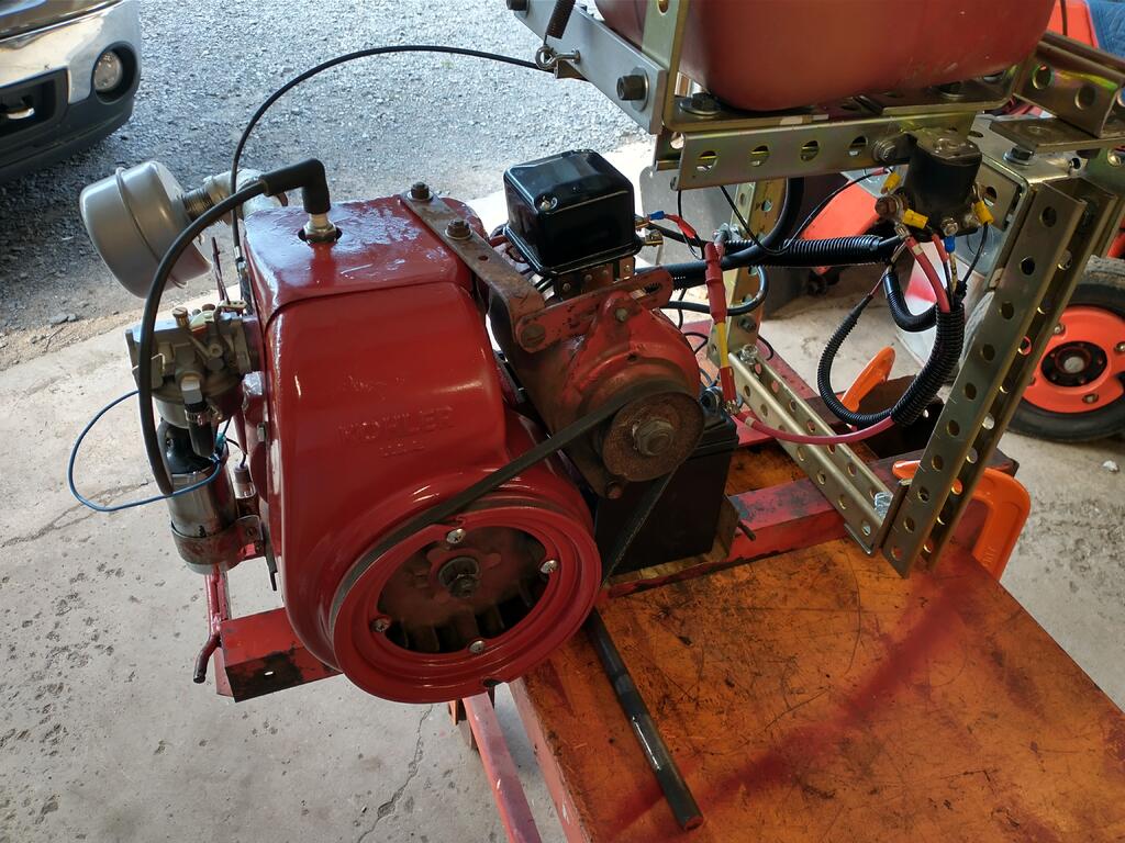

Ifixoldjunk 778 #12726 Posted September 9, 2021 On 9/2/2021 at 4:08 PM, squonk said: Rehabbed 2 Delco gennys and tested them on the test stand. Need a new pulley. Think I got one stashed somewhere. That's a pretty cool way to test those old starters. A cool show piece too. Share this post Link to post Share on other sites

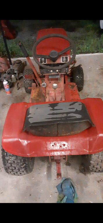

Ifixoldjunk 778 #12727 Posted September 9, 2021 I haven’t had too much time for my tractors lately, as I’m pretty much focusing all my time on my project YJ wrangler. I did however clean the underside of my 42 side discharge. I noticed my one spindle housing is a little chewed up looking, it only has 3 bolts holding it in. I’ll probably just run it until I need to put a new one in. (It’s the one farthest right) I mostly use the deck as a back up so fixing it immediately isn’t a top priority. I did however find a cool little NGK spark plug decal that I think looks right at home on the 310s fender. 1 1 Share this post Link to post Share on other sites

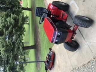

squonk 47,076 #12732 Posted September 9, 2021 (edited) Finished rehabbing a shortie frame plow frame and got a little more done on the 8 Horsie. @rjg854 notice the governor parts! Edited September 9, 2021 by squonk 5 2 1 Share this post Link to post Share on other sites

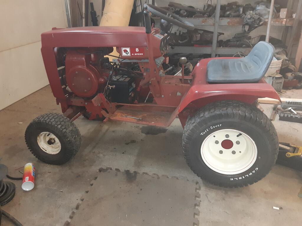

WheelPuke 78 #12736 Posted September 9, 2021 I fixed my deck today where I broke it. Through bolts installed in the spindle finished cleaning it, fixed the bent left guide so that the height adjustment works completely. Gave the tractor paint some good loving, and cleaned up the plow. I’m the photo is the finished tractor and the deck after I finished repairing it hence the upside down position. 4 Share this post Link to post Share on other sites

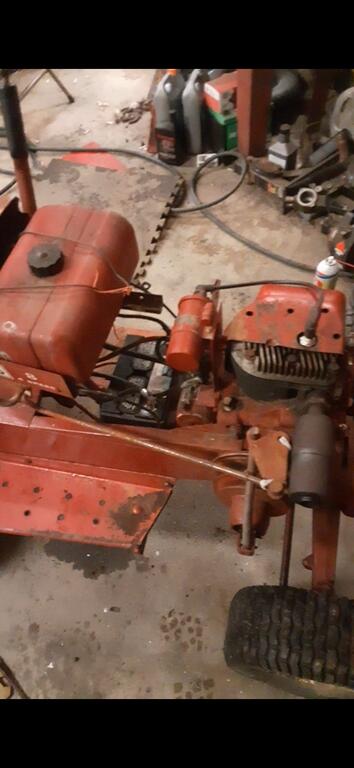

Oldskool 6,678 #12737 Posted September 10, 2021 Picked up a '73 a couple days ago. PO gave up on it. It ended up having a stuck valve and a gummed up carb. Got it up and running today. Also managed to put all the removed sheet metal back on ( 1 running board and bracket, fenders, seat). Still have to finish assembling the pto, a couple tubes in the front tires, neaten up the wiring a bit and patch the deck. 8 1 Share this post Link to post Share on other sites

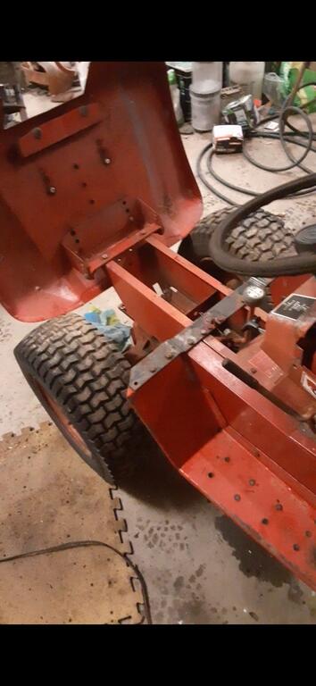

Oldskool 6,678 #12741 Posted September 10, 2021 Having a bit of quiet time in the garage this afternoon..... Cleaning up the old girl. Ita amazing how just a little paint changes the looks of things. 3 more to go. 6 4 Share this post Link to post Share on other sites
