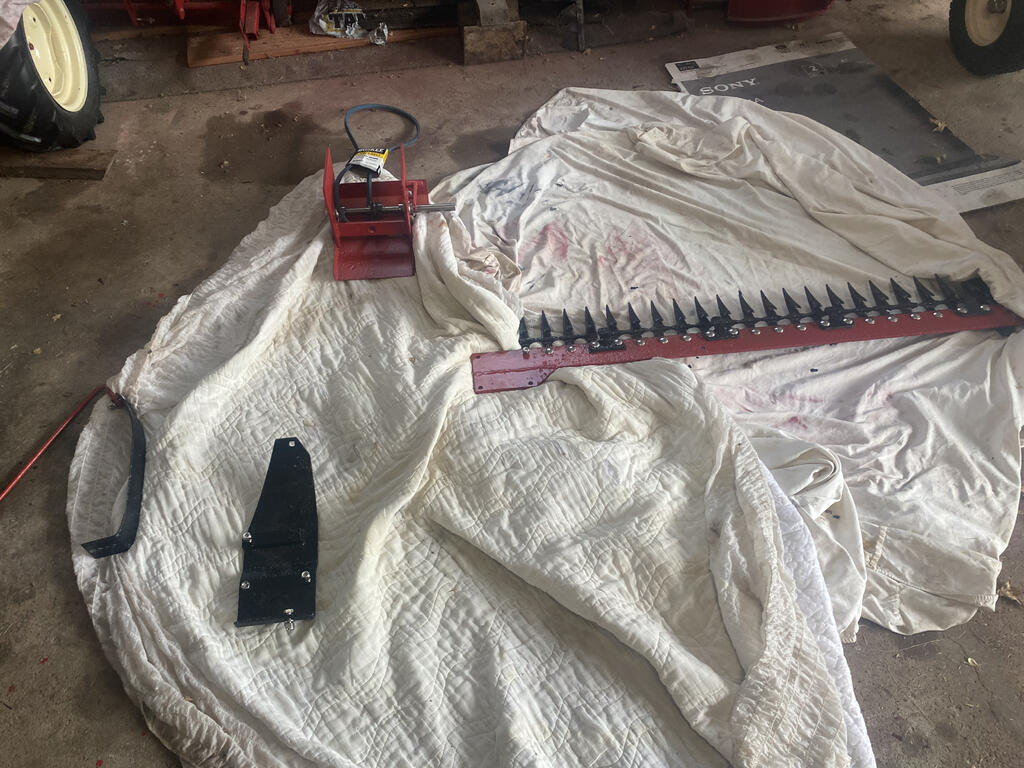

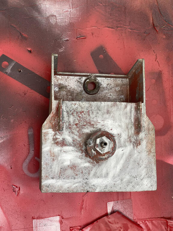

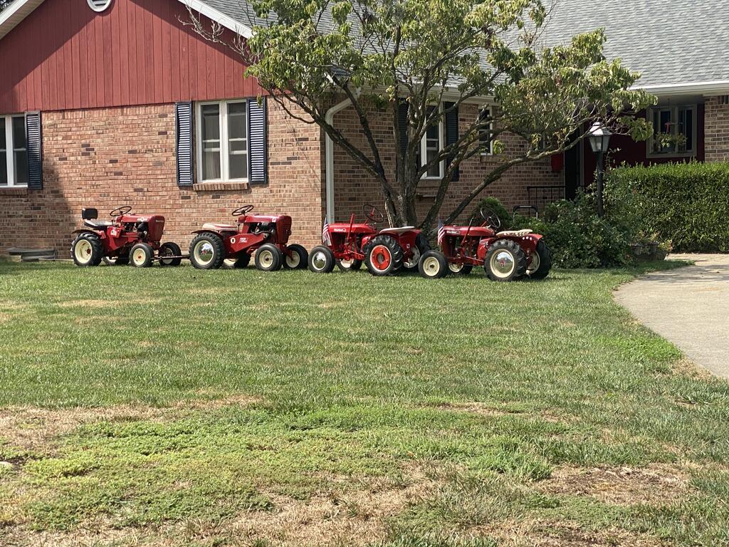

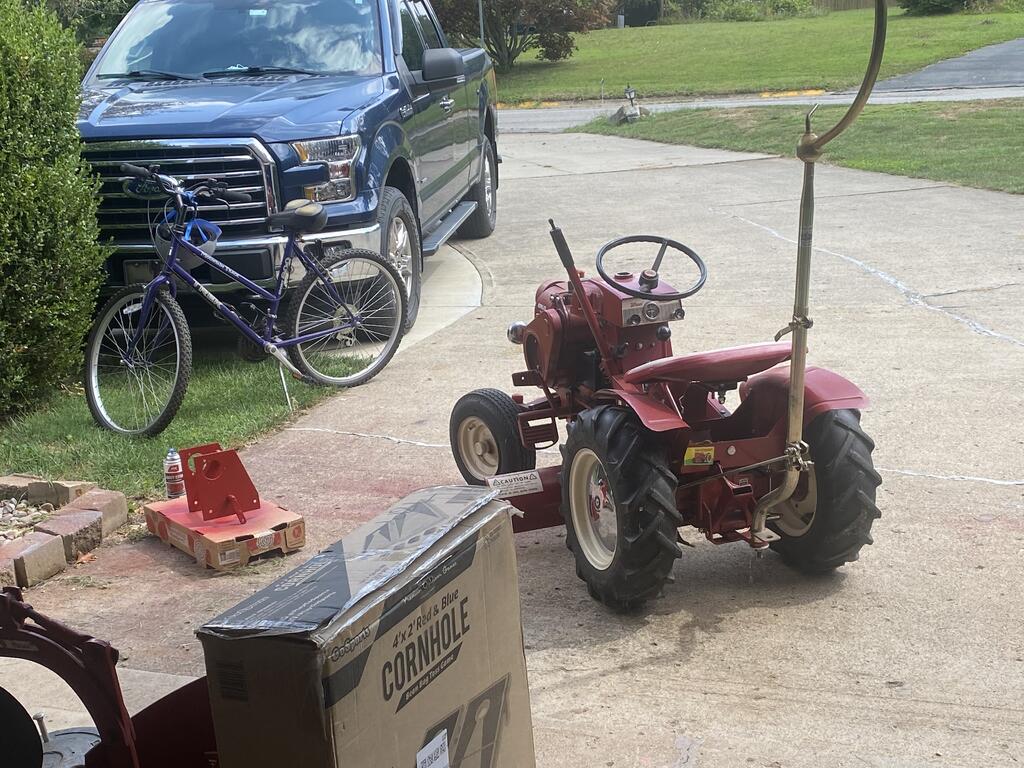

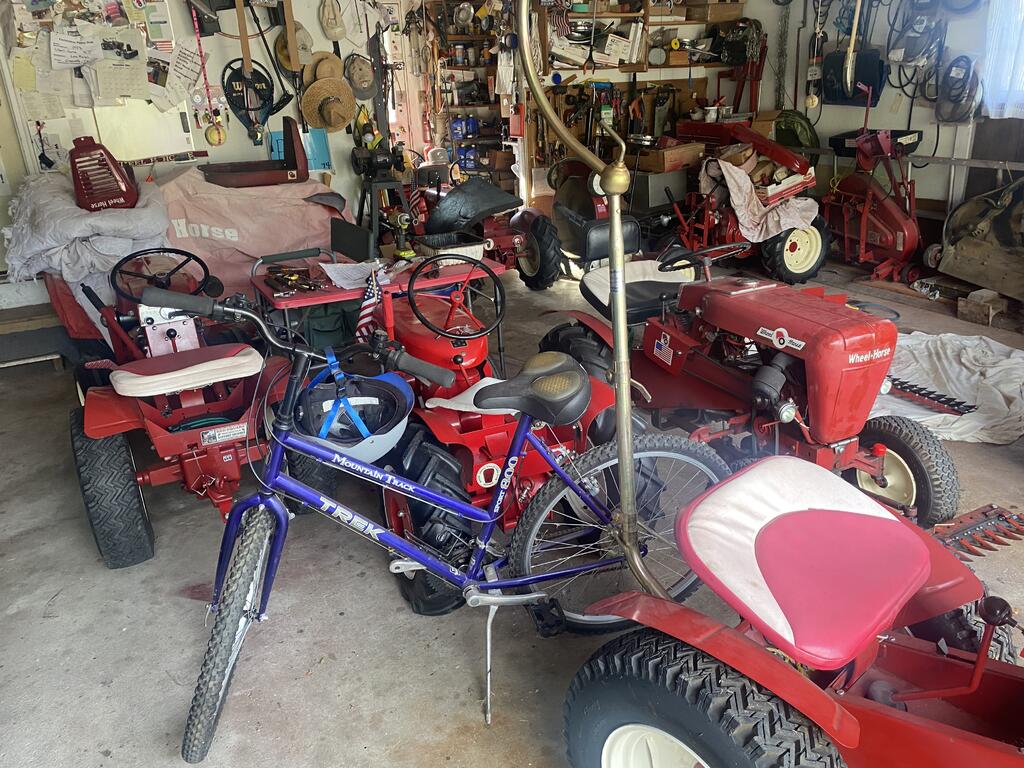

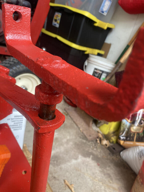

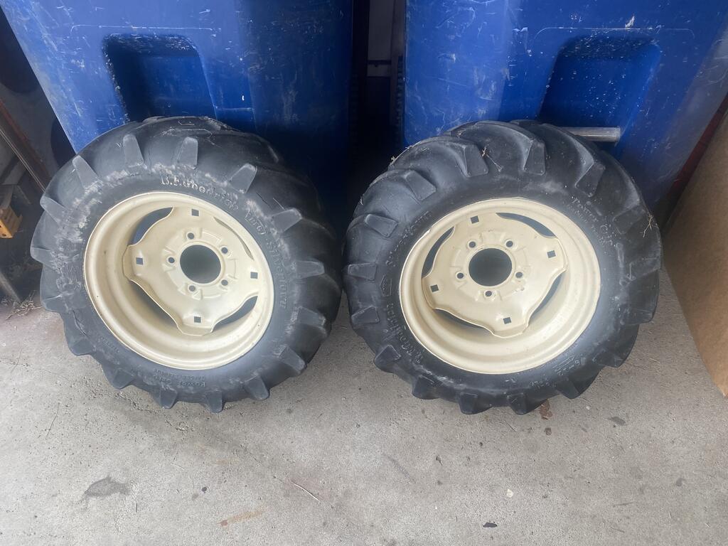

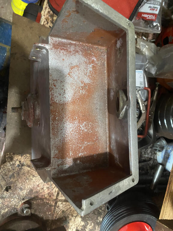

Lane Ranger 12,151 #12635 Posted August 31, 2021 (edited) A very busy Wheel Horse day today. Started working on reassembly of Rodney Burgers 42 inch sickle bar. I was waiting for a cooler day to work on this snd today was the day. Rodney is coming up to Indiana and Ohio next week. I wanted to clean up the garage so started moving tractors outside. I was surprised to see no gas in 701, 702 or 854. I put my last gallon of gas in two RJs and moved them out. Moved the B-80 which started right up like normal. went to get seven gallons of gas. Filled up 70-, 702 and 854. Moved 701 snd 702 out front. Came back to 854 and woah a leaking two piece gas tank. I had trouble with this one in January. This tank was redone with new gadget by the previous owner. I took off steering wheel snd four bolts holding the gas tank in the tower and relighted all the bolts with my impact drill. I put in gas and it held -however I have a one piece tank and I am going to redo this as I just don't trust this tank. The oppressive 90 degree heat this summer had to do something to the evaporation of the gas and the loosening of the gas tank sealer on the 854. We had three weeks of high temps. I also changed out an old pair of B F Goodrich Power Grip tires on my 854 and put my new old stock set of Firestone Town and County tires I picked up at the Big Show in Gettysburg this year. This gave me an opportunity to sell them to a new RJ58 owner (HorsePower58 that lives 20 miles away in Mooreville) that needed a set. I cleaned snd painted the 702 gas tank and called a friend to see if he could help me find a 703 dash to put on my 701 tank on my 854 tractor! Glory be he had one! So all in all a good horsin around day! Edited August 31, 2021 by Lane Ranger 2 10 Share this post Link to post Share on other sites
953 nut 69,857 #12636 Posted August 31, 2021 1 hour ago, Lane Ranger said: So all in all a good horsin around day! I'm exhausted just thinking of all you accomplished today. 3 4 Share this post Link to post Share on other sites

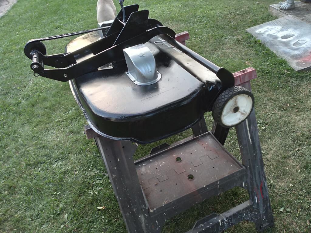

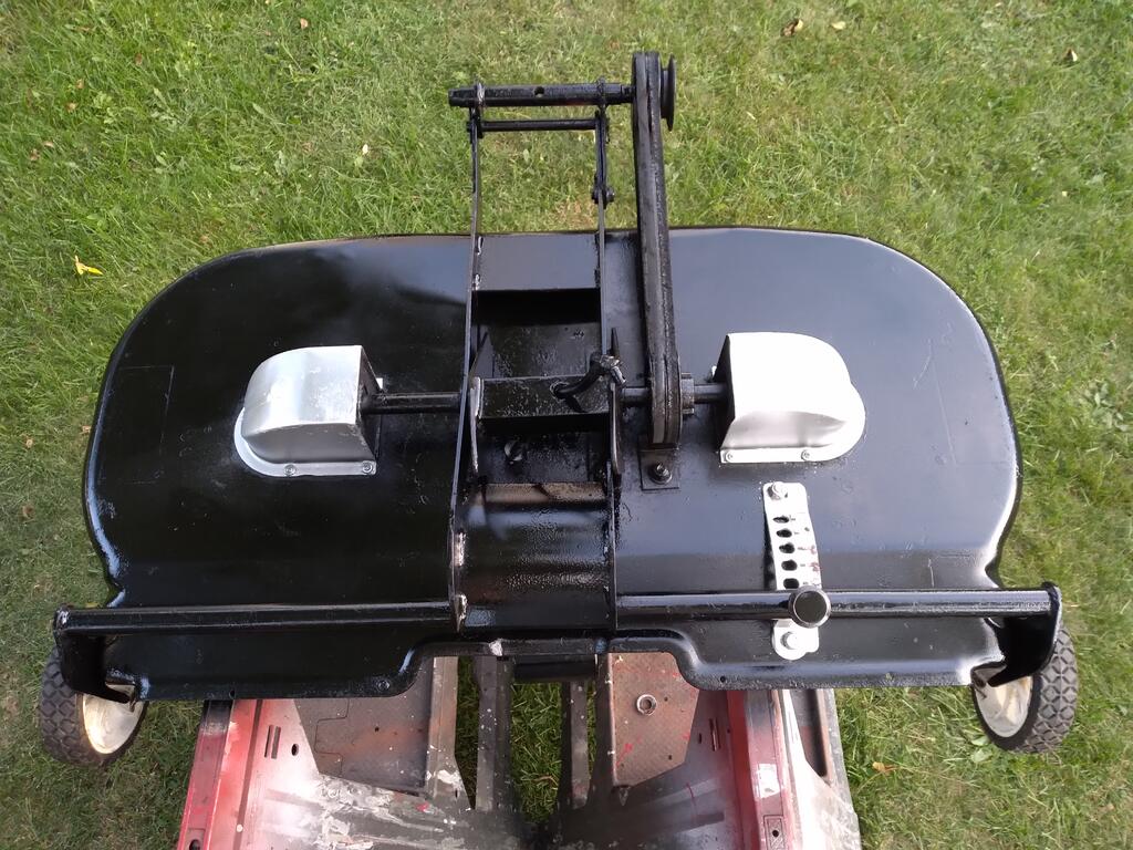

D_Mac 9,339 #12637 Posted August 31, 2021 Gave my deck to my cousin a while back to have it patched. Needed a large patch welded on the front. Seems they all rot out in that very same spot as I have 3 decks all with holes in the same place. I tested a little red paint on it but decided to paint it black and silver to match the custom decals @Vinylguymade up for me. Tomorrow I will put the deck decals on and try it out on the 1075. 9 4 1 Share this post Link to post Share on other sites

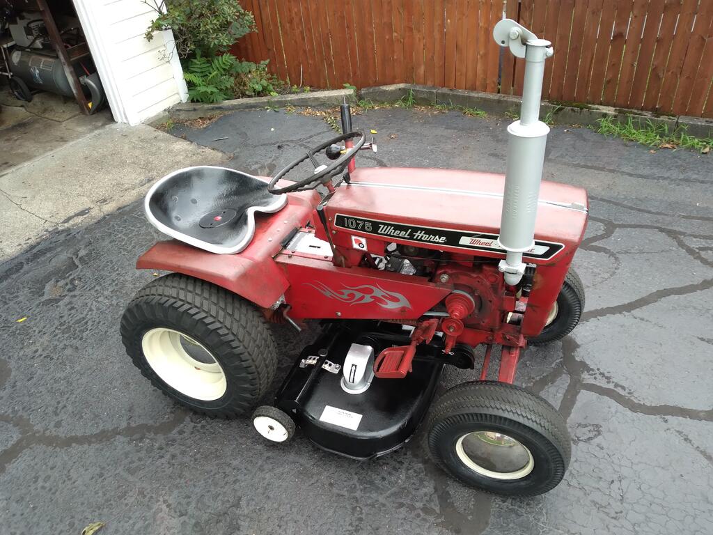

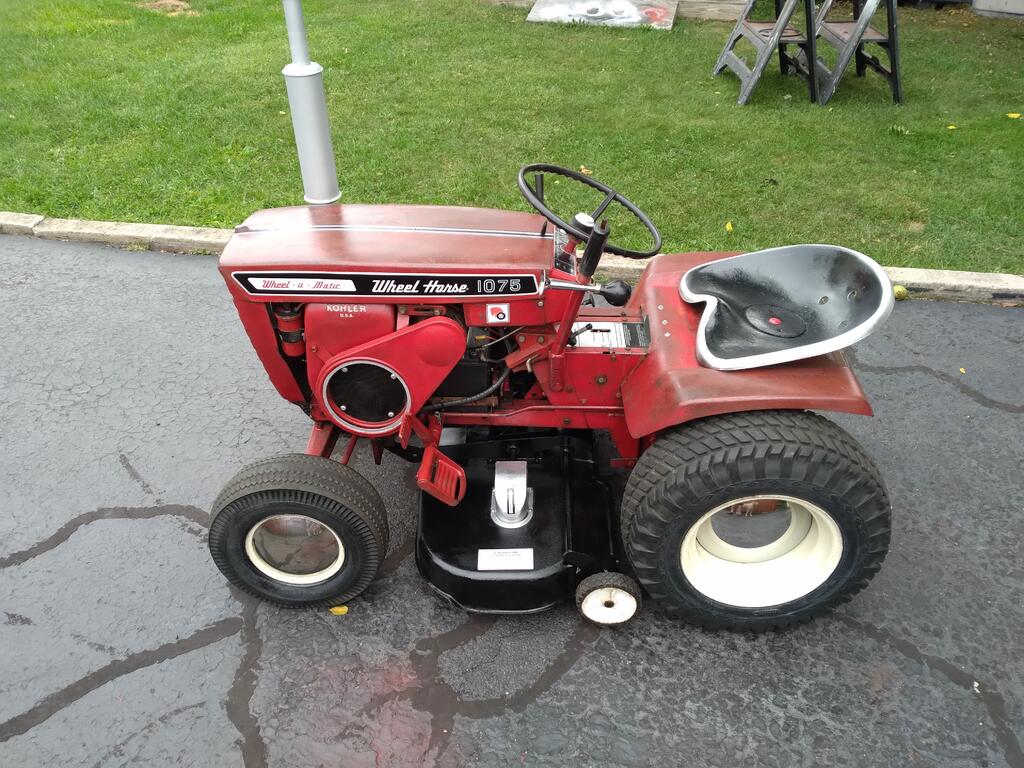

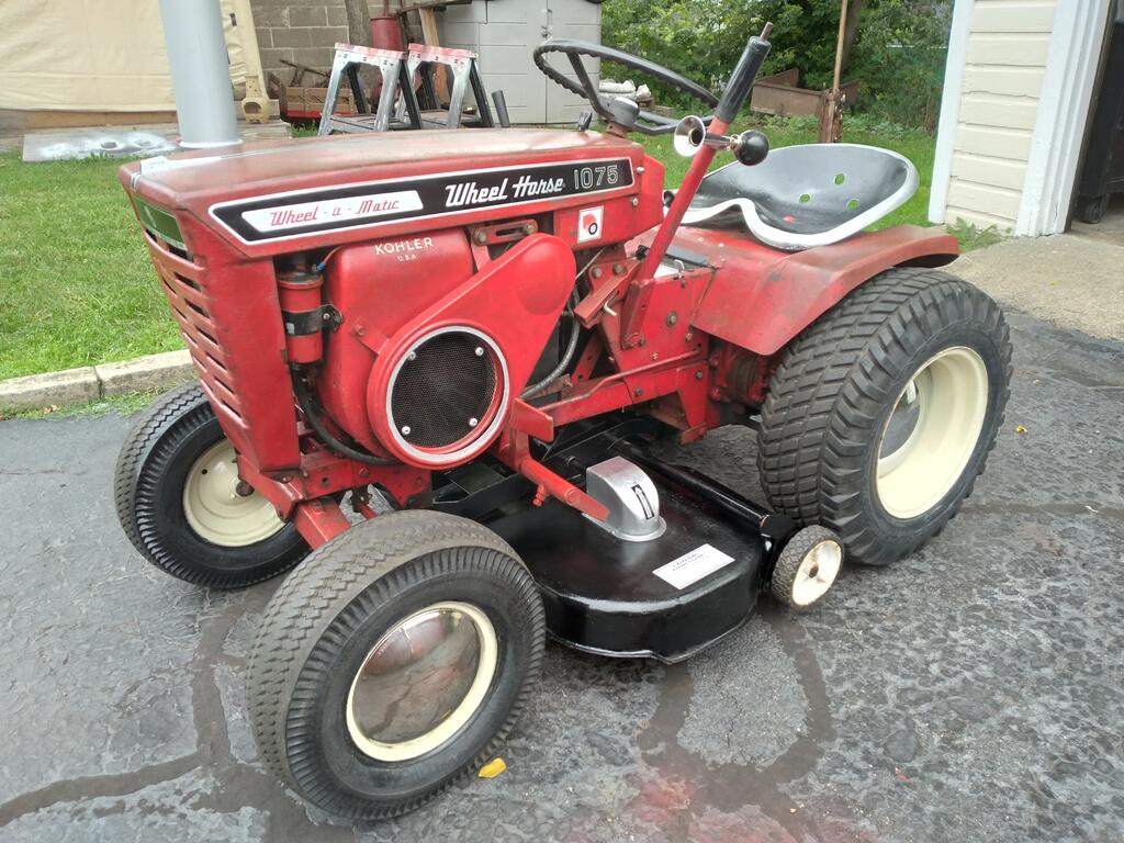

D_Mac 9,339 #12639 Posted September 1, 2021 Well I said I would finish it up and try it on today ..... well here it is. My Big Block, Short Frame, Tall Stack,, Custom Decals, Baby Moon, Mowing Machine. I kinda like how it turned out. 6 11 2 Share this post Link to post Share on other sites
squonk 48,231 #12640 Posted September 1, 2021 Now all you need is a yard to go with it! 4 Share this post Link to post Share on other sites

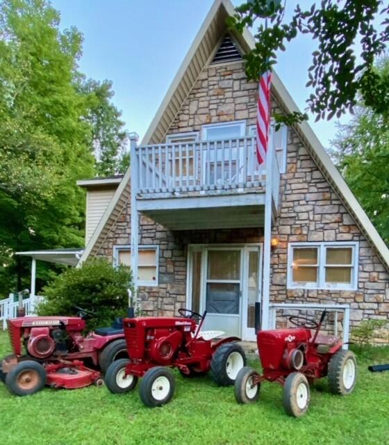

Greentored 3,221 #12641 Posted September 1, 2021 Thought i'd just barge in here out of nowhere and say hi Been awhile folks, but I'm still kickin! Its been one crazy summer for sure, and due to the cost of materials, not much getting done at the ol A frame. Lawn duty 1277 continues to keep track of the grass, Hoss has been dragging things all over and playing a bit, and ol smoky the 701 is running great- a stiff fuel pump diaphragm was causing the dying and shes good to go now, at least til I have the time to do a nice restore. Had em all out last week and snapped a pic. 5 11 Share this post Link to post Share on other sites
D_Mac 9,339 #12642 Posted September 1, 2021 59 minutes ago, squonk said: Now all you need is a yard to go with it! I would be happy with less of a yard. Funny how much I hate yard work but LOVE tractors. 2 Share this post Link to post Share on other sites
WheelHorse520H 710 #12643 Posted September 1, 2021 Nice deck there @D_Mac cool color choice. @bigcreek looks like you belt might be missing something! 1 Share this post Link to post Share on other sites

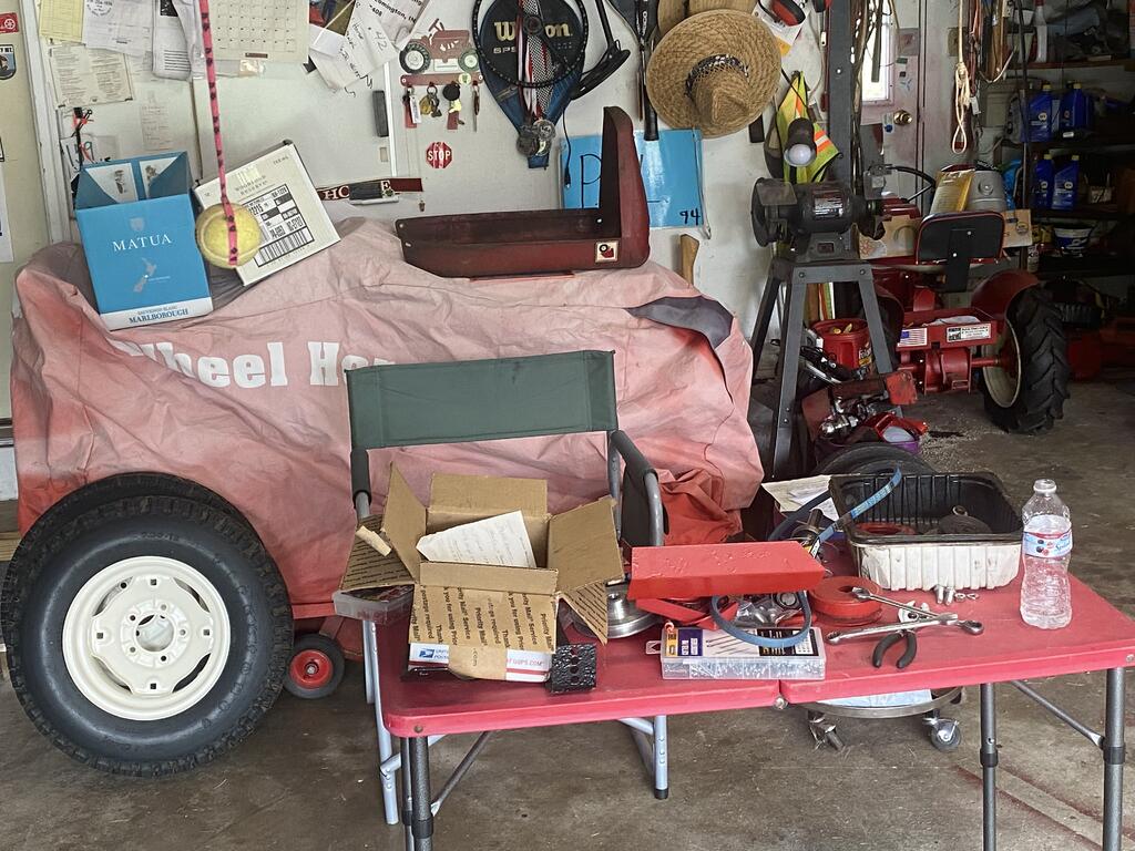

8ntruck 9,355 #12646 Posted September 2, 2021 The electric fuel pump I ordered for my C 195 showed up on Monday. Took a little time to get it mounted. I don't like the fittings I used on the pump. I'll clean that up later, it should work the way it is now. Also went through the carb. Had a slug of carbogies in it. Checking the engine mounting bolts, I discovered that 2 were missing and the other 2 were loose. Decided to replace all of the mounting bolts, as one of the loose bolts was worn from rattling around. 3 Share this post Link to post Share on other sites
WheelHorse520H 710 #12647 Posted September 2, 2021 7 hours ago, 8ntruck said: Checking the engine mounting bolts, I discovered that 2 were missing and the other 2 were loose. Decided to replace all of the mounting bolts, as one of the loose bolts was worn from rattling around. Good thing you found that before the engine fell off. Then you’d really have a problem. I recommend using the split lock washers as well as regular washers to prevent this from reoccurring. Just my 1 Share this post Link to post Share on other sites
ebinmaine 80,990 #12648 Posted September 2, 2021 9 minutes ago, WheelHorse520H said: Good thing you found that before the engine fell off. Then you’d really have a problem. I recommend using the split lock washers as well as regular washers to prevent this from reoccurring. Just my Wheel Horse makes it. Kohler shakes it. We've all read that before and understand how much some of these tractors vibrate. For that reason, and also because of our rough terrain here in the yard I switched over a few years ago to using Nyloc nuts on nearly every bolt we install on these tractors. 5 1 Share this post Link to post Share on other sites

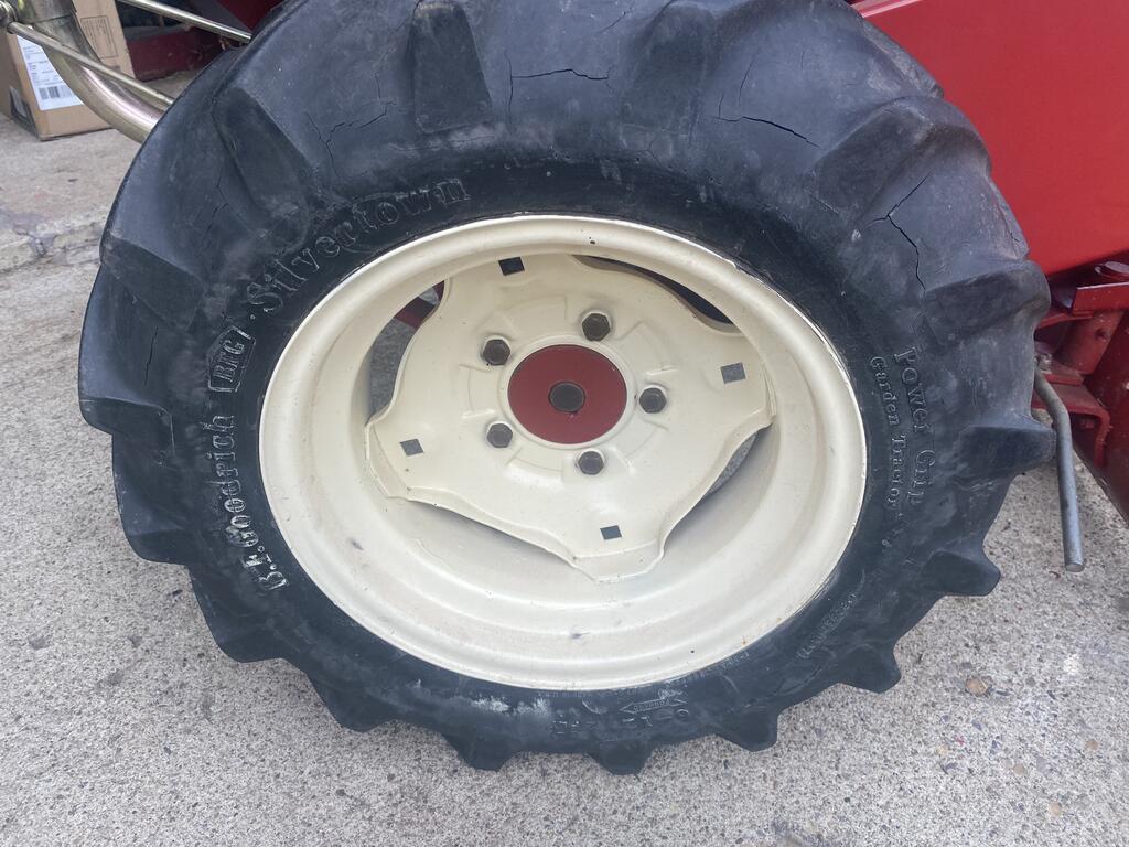

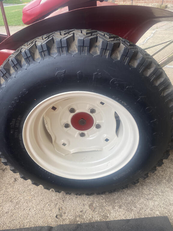

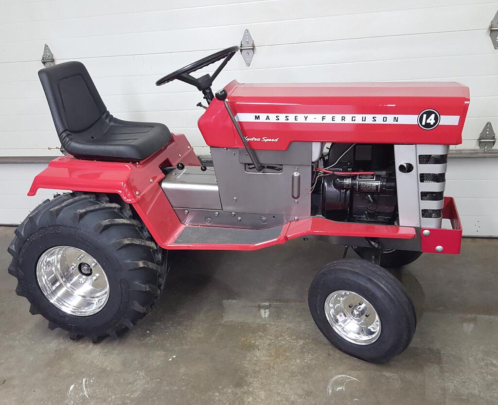

Gregor 4,848 #12649 Posted September 2, 2021 This makes me think of a not so funny story. I took 12 tractors to our local Antique Show Days this past Saturday. The tractor "organizer" announced there would be a tractor parade at 1 PM. He asked if I wanted to run some tractors. So myself, a friend, my son, and grandson all drove a tractor in the parade. ( about 1 1/2 miles) This is the tractor my grandson drove. (not a Wheel Horse I know, but at least it's red) After the show I brought all the tractors home and parked them all in the garage. Sitting here Sunday morning, drinking my coffee, just kind-a looking over the tractors. The right front wheel on the Massey didn't look quite right. I investigated. 2 of the socket head cap screws were gone. 1 was almost out, the 4th was still tight. If this had fallen off on my grandson, he would have bawled right then and there, even though it wasn't his fault in any way. The bolts in the wheels now are 1/2" longer, with blue locktite, and nylok nuts on the back side of the hub. I have read that you have to constantly check the bolts and nuts holding on aluminum rims. I guess I forgot the word constantly. Disaster narrowly avoided. 7 Share this post Link to post Share on other sites
lynnmor 9,051 #12650 Posted September 2, 2021 1 hour ago, Gregor said: 2 of the socket head cap screws were gone. 1 was almost out, the 4th was still tight. The bolts in the wheels now are 1/2" longer, with blue locktite, and nylok nuts on the back side of the hub. I have read that you have to constantly check the bolts and nuts holding on aluminum rims. I guess I forgot the word constantly. Disaster narrowly avoided. My thought is that the SHCS have too little contact with the aluminum. Cone shaped heads or flange bolts might be better. You will never see the small heads used on automobiles. 1 Share this post Link to post Share on other sites
