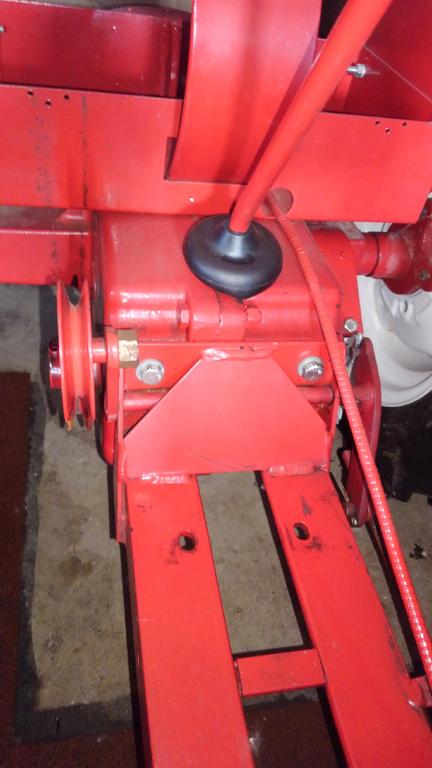

Tgtack 779 #877 Posted July 4, 2018 1 hour ago, Aldon said: Almost too hot to work in the garage. Mid 90’s. But like @Sparky, I managed a few hours with the granddaughters working at repairing the hack job frame repair some prior owner did to the 551 I picked up at the show. Managed to get the welds removed. Will work in an appropriate repair while we wait on axle seals to arrive. @Aldon @Aldon I have been told that this is a factory modification to the frame to prevent cracking of the transaxle frame mount. This is on my 551. Even if not factory, a good solution to your problem. 1 1 Share this post Link to post Share on other sites

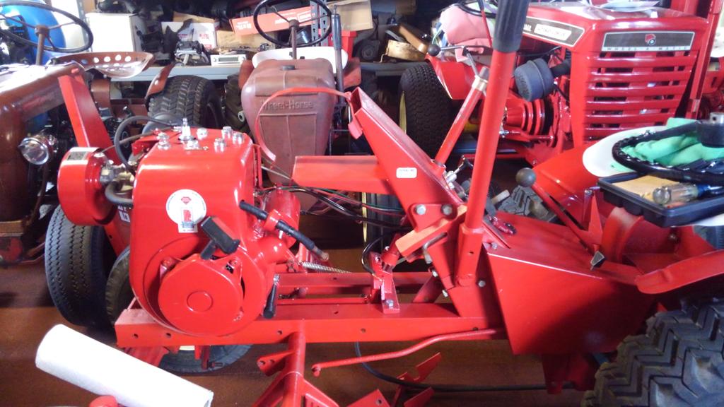

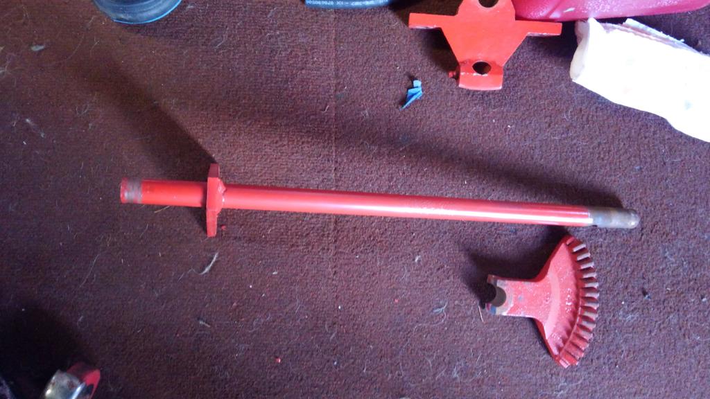

Tgtack 779 #878 Posted July 4, 2018 Working in the garage fixing the issues on my 654. Friday afternoon at the big show, the steering fan gear broke where it was pinned to the shaft. Installing the replacement steering shaft today. The replacement pinned gear/shaft was tight, but I had my friend weld the gear to the shaft with nickel rod like the 65 and up shafts. Also patching the fuel tank that had a hold punched in it from a weld that was not ground off at the factory, and a small section of seam that was not soldered very well and was seeping fuel. 5 Share this post Link to post Share on other sites

Tgtack 779 #880 Posted July 4, 2018 (edited) 31 minutes ago, Aldon said: Absolutely. As partial repayment of the support you offer everyone else. I’ll try and get the measurements for you in next day or so. Also, you may want to reach out to @953 nut as I know he ended up with a 551 frame that similarly was hack welded by a previous owner from me at the show. I don’t recall the shape of the backplate but he might be willing to cut that free and send to you. @gwest_ca @Aldon, I think you might be able to use the frame section found on the later model short wheelbase tractors, just flipped. It would need to be trimmed a bit at the top. Look at the picture I posted of mine, it will give you an idea of the size and orientation. Edited July 4, 2018 by Tgtack 1 Share this post Link to post Share on other sites
953 nut 69,267 #881 Posted July 4, 2018 2 hours ago, Aldon said: Absolutely. As partial repayment of the support you offer everyone else. I’ll try and get the measurements for you in next day or so. Also, you may want to reach out to @953 nut as I know he ended up with a 551 frame that similarly was hack welded by a previous owner from me at the show. I don’t recall the shape of the backplate but he might be willing to cut that free and send to you. I will take some pictures and PM @gwest_ca with the dimensions, If he wants the plate I could cut if off and send it to him, considering how much he does for us that would be the least I can do. 1 Share this post Link to post Share on other sites

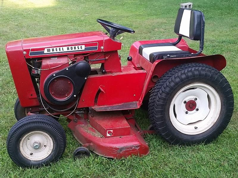

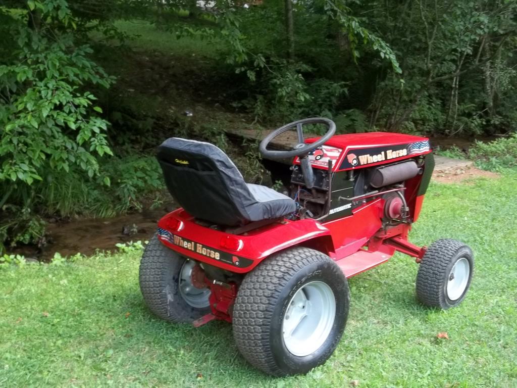

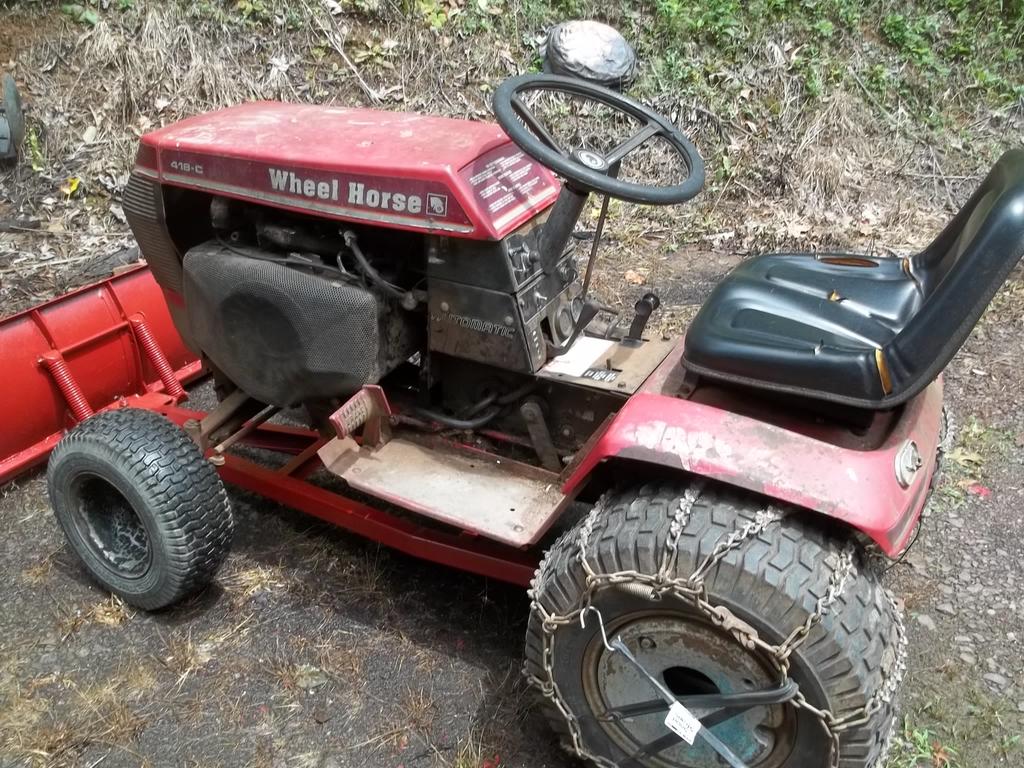

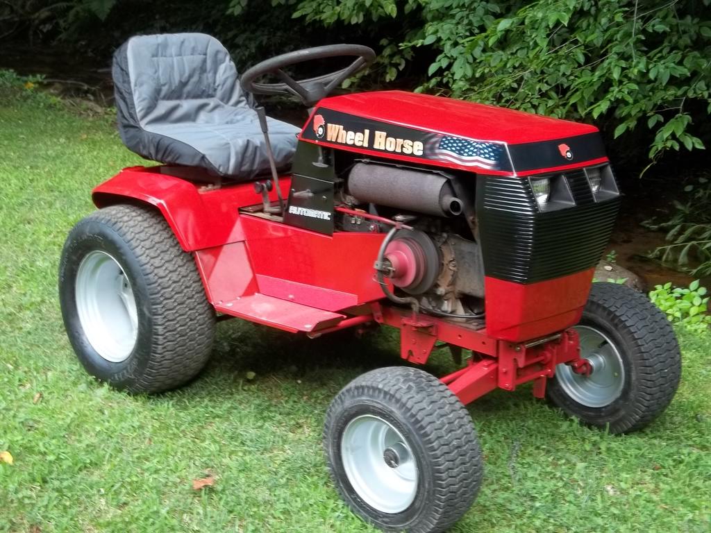

953 nut 69,267 #882 Posted July 4, 2018 My cosmetically challenged 418-C runs great and is a great worker, but it needed some help in the looks department. I pulled the sheet metal and did a quick paint job and added a set of @Vinylguy patriotic decals, love it. Found some RED skateboard grip strip for the running boards. 7 10 Share this post Link to post Share on other sites

gwest_ca-(File Mod) 12,488 #886 Posted July 5, 2018 12 hours ago, 953 nut said: I will take some pictures and PM @gwest_ca with the dimensions, If he wants the plate I could cut if off and send it to him, considering how much he does for us that would be the least I can do. Thanks for the offers everyone. I have had the metal put away for the repair for a few years now. The location of the holes and plate had me guessing so was watching for an opportunity to get that info. The posted photos were a good reminder. Garry 1 Share this post Link to post Share on other sites

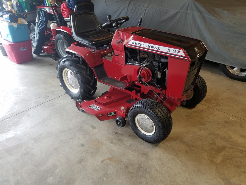

bds1984 1,519 #887 Posted July 5, 2018 New front shoes on my C165. I like the looks of the 18x8.50-8 turf tires much better than the 16x6.50-8 ags. She looks more like the C195 I had before. 5 Share this post Link to post Share on other sites

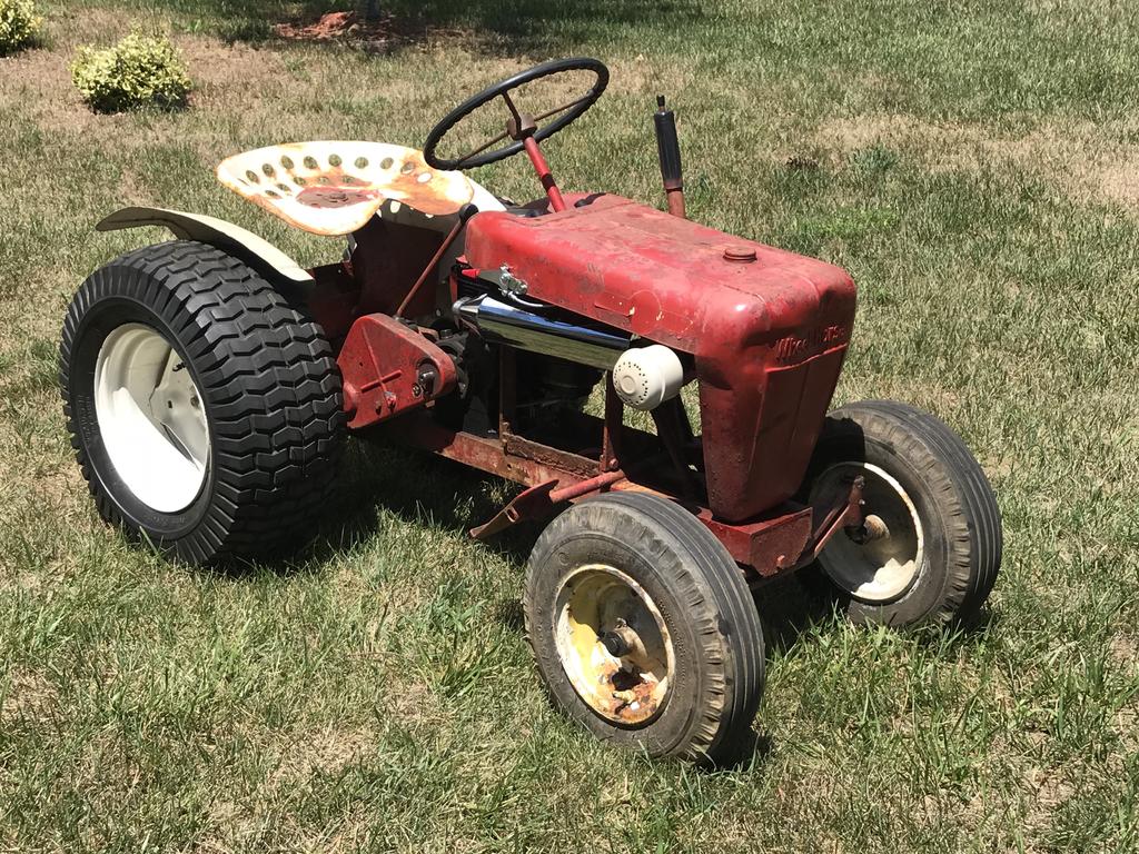

Aldon 4,832 #888 Posted July 7, 2018 Got frame strengthened and motor swapped out. Hood is banged up and a prior owner drilled a bunch of holes along the bottom edge for some reason. So I don’t feel too bad mounting the old school style throttle to the side. Won’t win a beauty pageant but the motor is fresh rebuilt and this thing should be a reliable grandchild magnet for at least a decade:-) My grandaughters helped me. Disappeared after we pulled the hubs. No worries. They have some sweat equity in it and have the wheel horse bug now:-) Alrhough they like the restores C160 better....Which means I’ll end up stripping down this round hood likely next summer and making it pretty. 5 5 Share this post Link to post Share on other sites

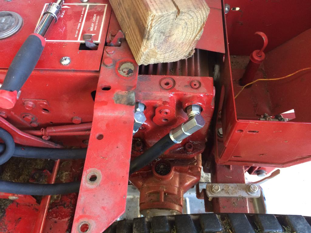

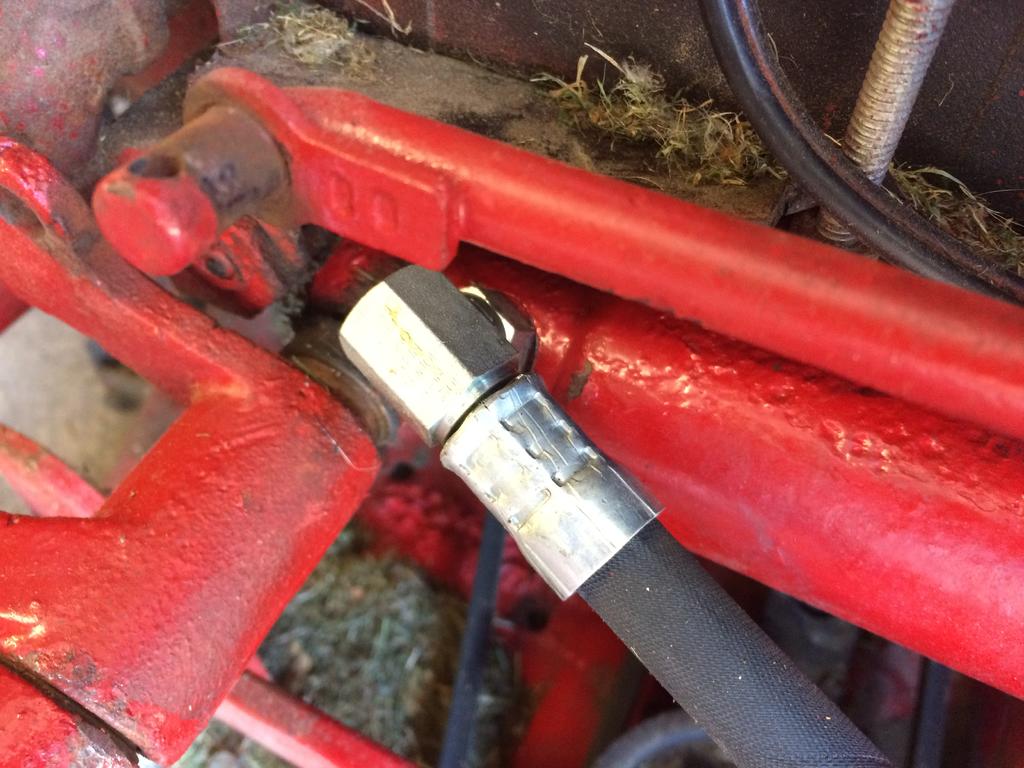

squonk 48,118 #889 Posted July 8, 2018 New hoses on the C-160 6 Share this post Link to post Share on other sites

nnero 14 #893 Posted July 10, 2018 On 7/4/2018 at 6:36 PM, 953 nut said: My cosmetically challenged 418-C runs great and is a great worker, but it needed some help in the looks department. I pulled the sheet metal and did a quick paint job and added a set of @Vinylguy patriotic decals, love it. Found some RED skateboard grip strip for the running boards. Great job! Where did you get that seat cover? Looks like a cableas logo? Thanks 3 1 Share this post Link to post Share on other sites
953 nut 69,267 #894 Posted July 10, 2018 (edited) 4 hours ago, nnero said: Where did you get that seat cover? Looks like a cableas logo? I bought it at Tractor Supply. The logo is Cub Cadet bur it is a nice cover and the price was reasonable. Edited July 10, 2018 by 953 nut 1 1 Share this post Link to post Share on other sites
nnero 14 #895 Posted July 10, 2018 Haha ok. It does look good though! 1 Share this post Link to post Share on other sites
chip61 666 #896 Posted July 10, 2018 It does look good-I need a couple of them. I'll have to check Tractor Supply here. Share this post Link to post Share on other sites

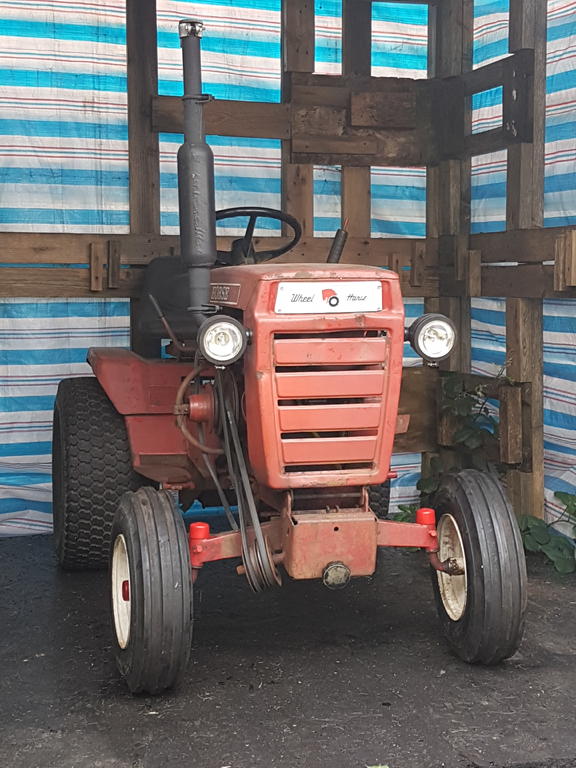

Ian_Courts 77 #897 Posted July 11, 2018 (edited) Fitted older style spindles (end bolt type) and fitted narrower (4 1/2") front wheels fitted with new Deestone D401 tri-ribs. Spindle caps and hub covers courtesy of @GlenPettit Edited July 12, 2018 by Ian_Courts 9 1 Share this post Link to post Share on other sites

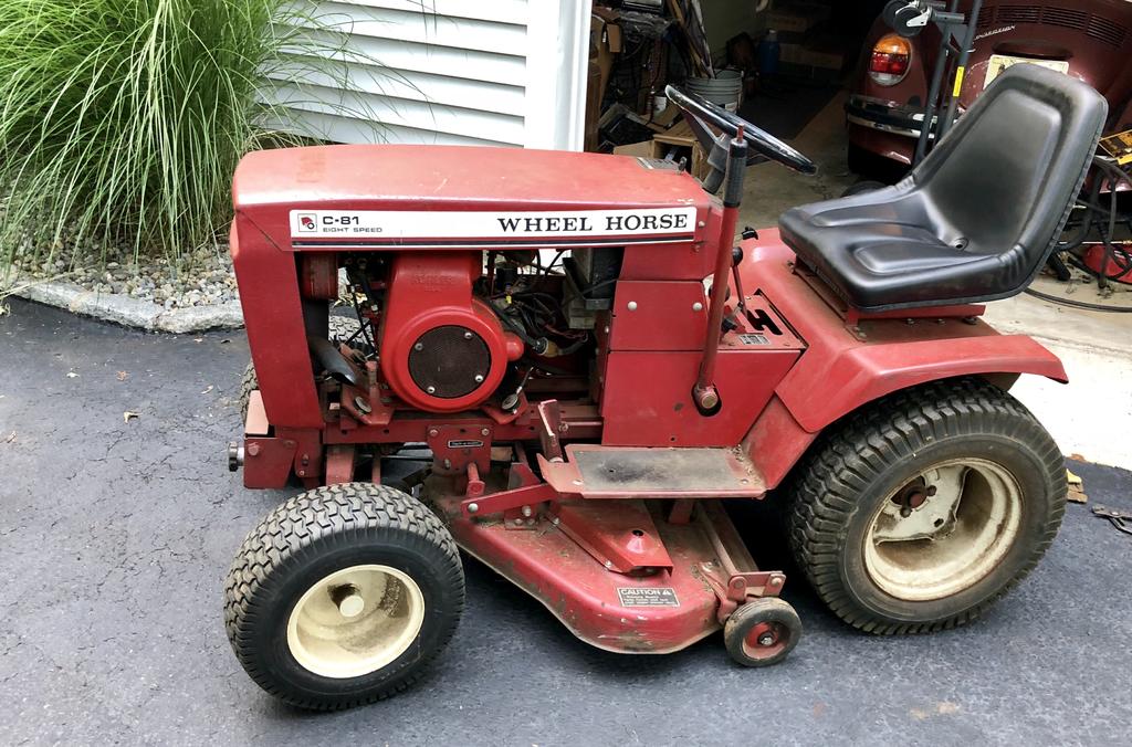

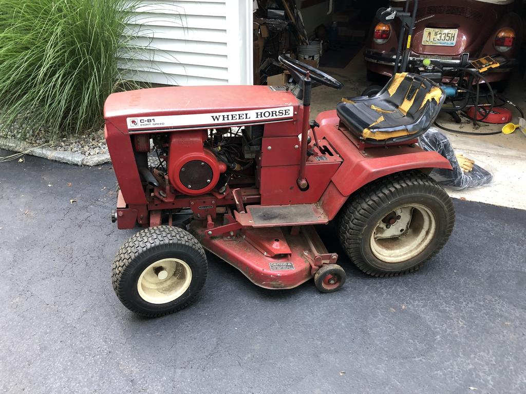

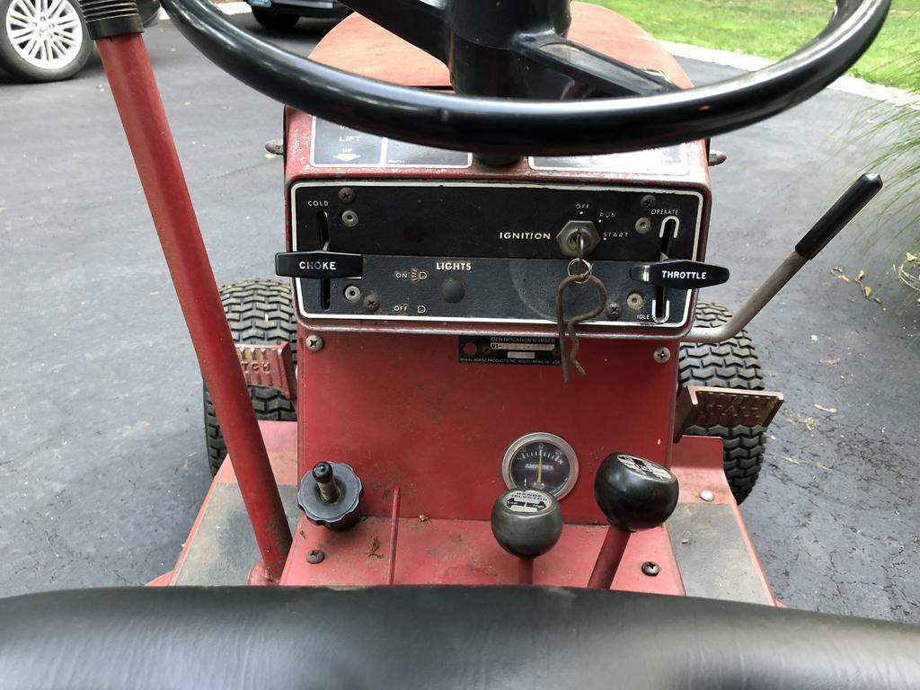

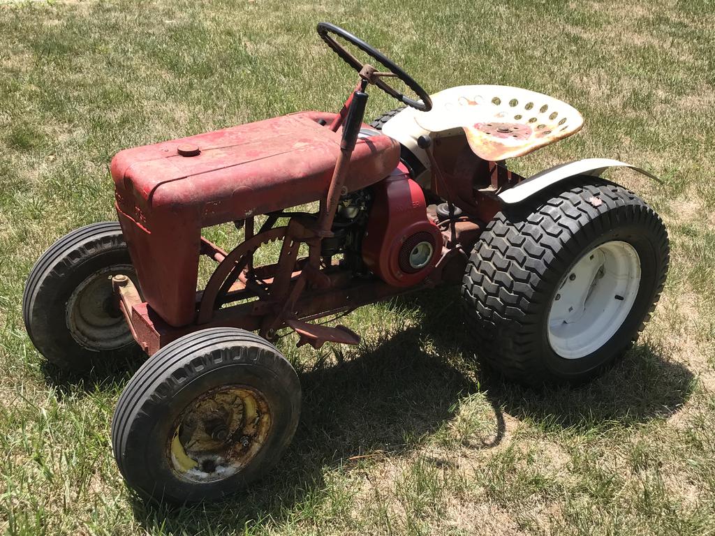

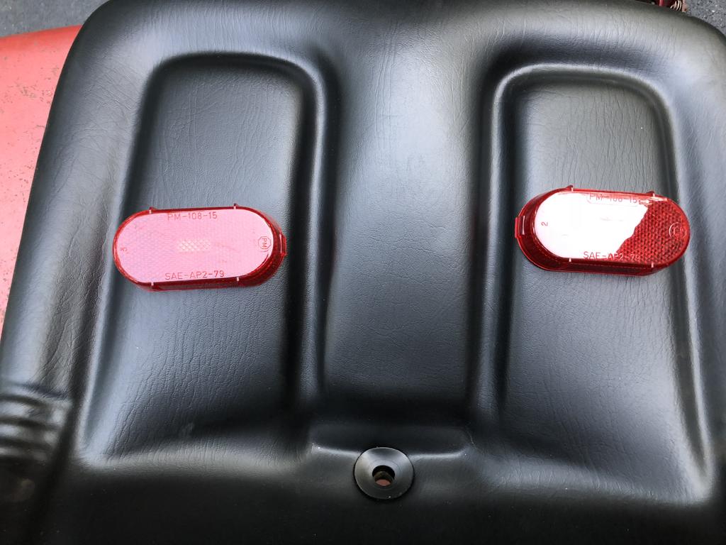

Ritter 38 #899 Posted July 15, 2018 (edited) Hi all. May not be the most attractive on the lot, but certainly has an incredible back story. Thanks to fellow contributors, I finally replaced the 40 year old seat, got a much awaited throttle lever and added some ‘faux’ tail lights for effect. Hopefully soon, I’ll find an affordable and newer Horse with some more Umph than 8 HP and a wider deck. This guy I have deserves summers off! Edited July 15, 2018 by Ritter 4 Share this post Link to post Share on other sites
