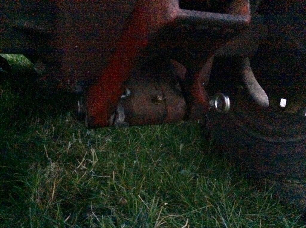

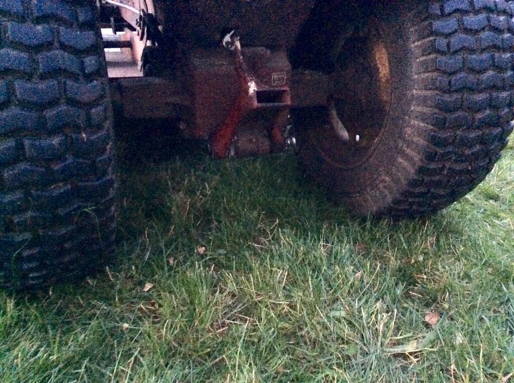

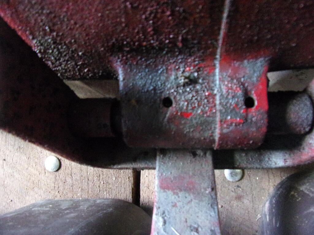

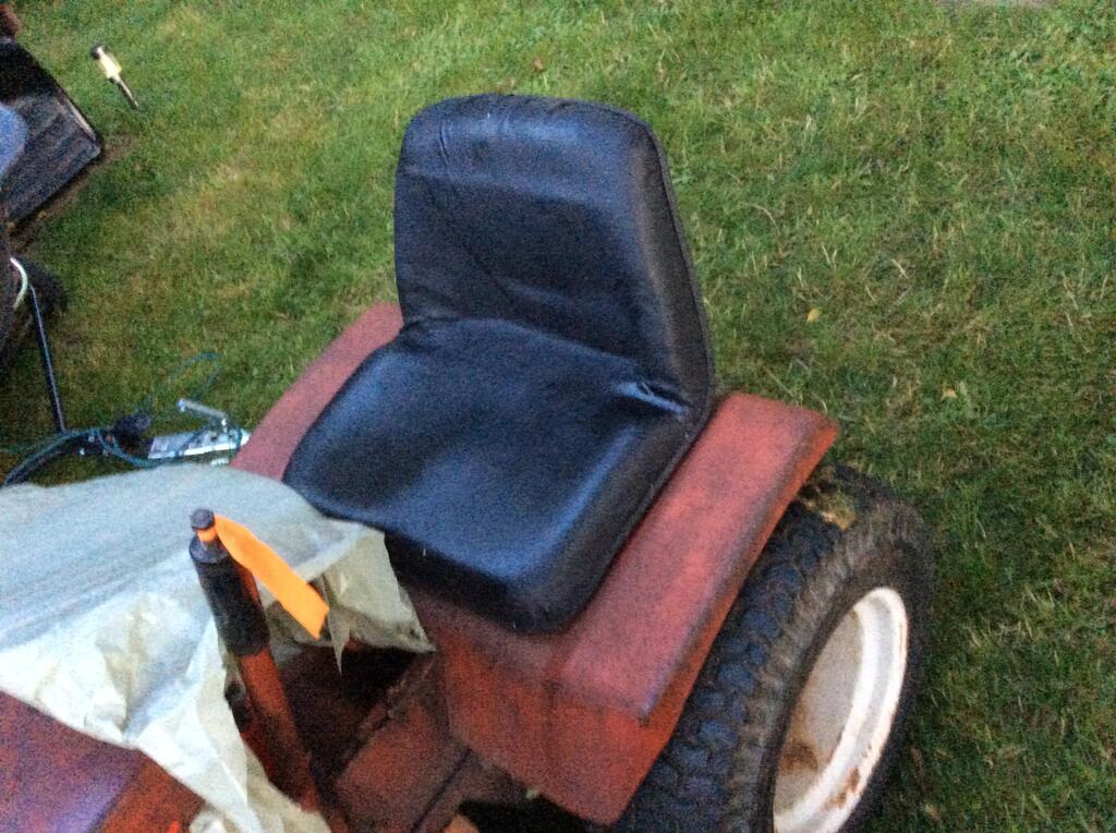

Tractorhead 9,218 #6152 Posted August 17, 2020 While i have heard and read so many times, that the mounting Bolt for Attachements in the rear of the Gearbox is hardly rusted in a short timeline, i decide to mount a greasenipple to prevent that. so i be able to grease it regulary. i love things they can be simply maintained. when the Attachement is lifted, i can simply grease the nipple and reduce wear and rust. after that i mounted the reworked Seat and mow the Front and Backyard with it. Boy that‘s real comfy. Ok, it Wasn’t perfect, but it is a blast to take a seattime with it. Close before i finished, delivery company arrives and bring my new Muffler i had allready ordered, so i changed also the Muffler to the new One, but it was too late, to do a testride with it. don‘t know how loud it is. After that Action was taken i must flee, while Moskitos tend to eat me. felt 100.000 Stitches, and no repellant works. Actually we had felt zillions of that Beasts on a squaremeter. 1 1 Share this post Link to post Share on other sites
Ed Kennell 47,828 #6153 Posted August 17, 2020 10 minutes ago, Tractorhead said: While i have heard and read so many times, that the mounting Bolt for Attachements in the rear of the Gearbox is hardly rusted in a short timeline, i decide to mount a greasenipple to prevent that. After that Action was taken i must flee, while Moskitos tend to eat me. felt 100.000 Stitches, and no repellant works. Actually we had felt zillions of that Beasts on a squaremeter. My first step in removing a stuck pin is to drill a hole in each half of the case into the pin. I then fill the holes with penetrant and let it soak for months. After the pin is removed I tap the holes and install grease fittings. Those SKEETERS can be dangerous. Some can carry a virus that can be transferred to humans through their bite. My wife's sister is allergic to insect bites and is deathly afraid of mosquitos. 2 1 Share this post Link to post Share on other sites
Tractorhead 9,218 #6154 Posted August 17, 2020 Don‘t know why we had this year that much of that Beasts. Normally we just have a few, but this year it is definitely a plague. Think i ain‘t doing wrong with the grease nipple mount, Even the grease come out on both sides, that give me a good feeling. 👍 2 Share this post Link to post Share on other sites

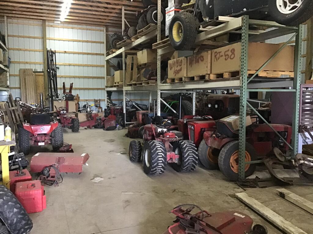

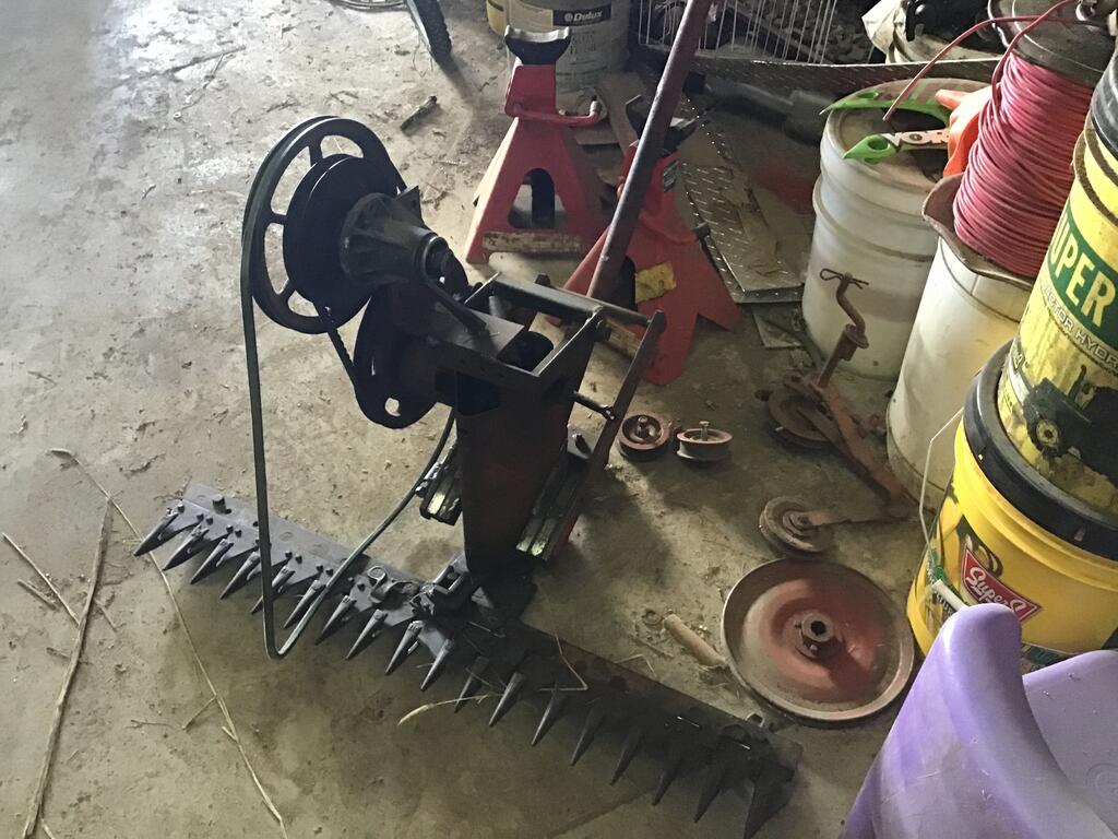

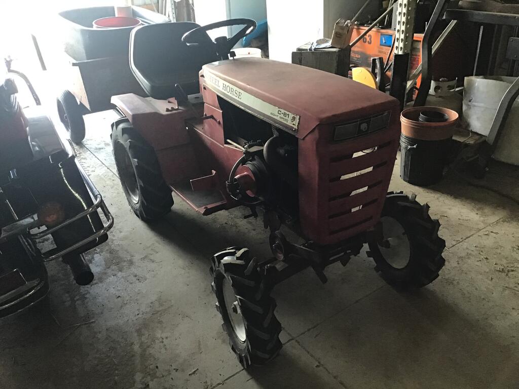

Pullstart 71,527 #6157 Posted August 18, 2020 Organize, make a mess, repeat. ‘Cept I’m better at the mess, not so better at organize. Sorting and compiling all the projects. It’s exciting yet saddening, there is so much to do it seems. The engine in Poppy the 552 needs to go to Uncle Jim’s. I think I might get the sickle bar put back to DB parts only and scrap the Jari bar... reassemble on Steve and send it down the road ( @bottjernat1 ) without the engine possibly. I think Rylee wants the front ag tires and I’ll toss some turfs on the rear. 8 Share this post Link to post Share on other sites
elcamino/wheelhorse 9,363 #6158 Posted August 18, 2020 @pullstart looks like you need to quit buying for a while and start fixing. 1 1 5 Share this post Link to post Share on other sites
Redneckdavis 308 #6159 Posted August 18, 2020 He who dies with the most toys, wins 4 1 Share this post Link to post Share on other sites
Pullstart 71,527 #6160 Posted August 19, 2020 6 hours ago, elcamino/wheelhorse said: @pullstart looks like you need to quit buying for a while and start fixing. I keep telling myself that, then another “good deal” pops up! Share this post Link to post Share on other sites

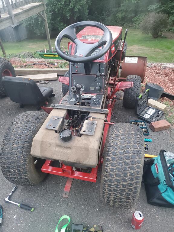

Jhook 849 #6161 Posted August 19, 2020 Found that my gas leak was from the fuel line rubbing on the steering gear. Replaced the entire line and fuel filter. Discovered a cracked shifter boot so thats on order. Whats the procedure on replacing that? This thing is so enjoyable to work on. 1 phillips bit and a half inch socket and the whole machines apart 1 Share this post Link to post Share on other sites
Pullstart 71,527 #6162 Posted August 19, 2020 4 minutes ago, Jhook said: Found that my gas leak was from the fuel line rubbing on the steering gear. Replaced the entire line and fuel filter. Discovered a cracked shifter boot so thats on order. Whats the procedure on replacing that? This thing is so enjoyable to work on. 1 phillips bit and a half inch socket and the whole machines apart good deal! If you unscrew that shift knob and it looks like you’ve got enough tins off, the boot slides right off the shifter 1 1 Share this post Link to post Share on other sites

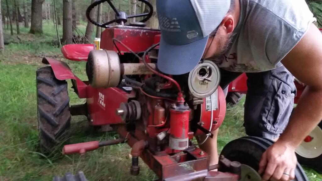

WHX?? 58,347 #6166 Posted August 19, 2020 Finally got ticked off at the 753... the one Kev like to putt on and give mouth to mouth resuscitation to... and got it back in the shop. Thought I had the lack of bang juice problem licked with a good carb cleaning which it needed anyway. Put her to work last weekend and she quit again so now can be only two things sediment bowl plugged or fuel pump. Yup fuel pump intermittent no worky so pulled it off to find it's a pulse style with gunk in it. Apart and In the Berryman's she goes with a pm to @buckrancher to see about a diaphragm. Sorry no pics of the pump but do have this one! 4 1 3 Share this post Link to post Share on other sites
AMC RULES 37,260 #6167 Posted August 19, 2020 OK, now it all makes sense! 4 Share this post Link to post Share on other sites
Tractorhead 9,218 #6168 Posted August 19, 2020 Aaahhh Jim, what are you doing, i spit the coffee over the iPad while see that Pict.. 😂😂😂😂 Paramedic Engine Fix... 😂😂😂 2 Share this post Link to post Share on other sites

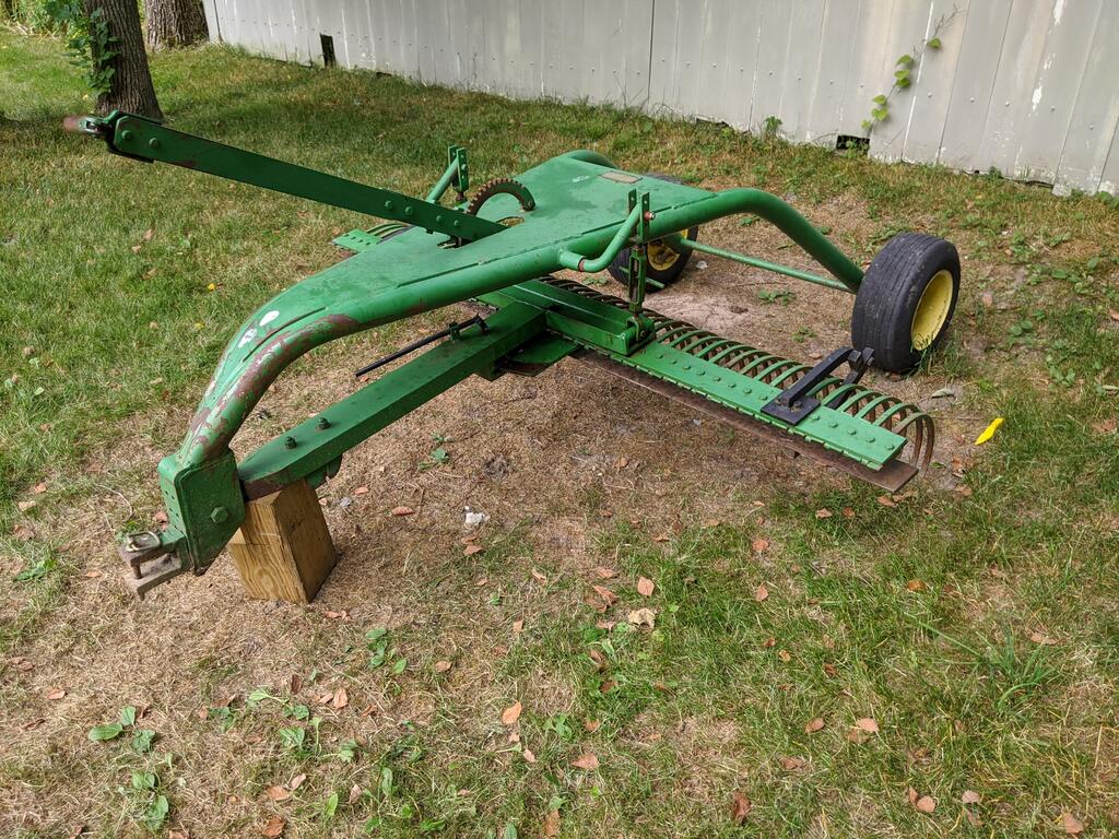

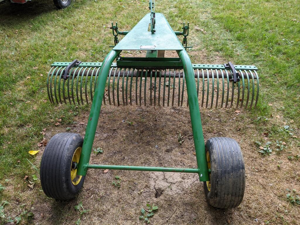

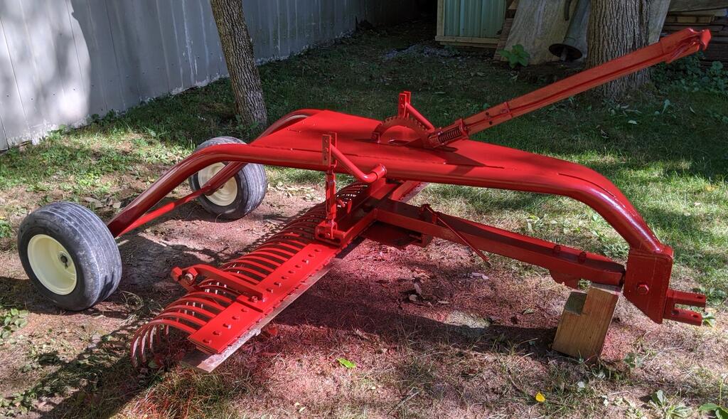

rjg854 13,423 #6169 Posted August 19, 2020 I'm going to change this up a bit.... What have I done for my I bought a York rake a while ago It's 6 foot wide and weighs about 400 lbs, it really does the job. BUT It's a god awful color I couldn't take it anymore. So.... What'd ya think I like it a whole lot better 2 10 3 Share this post Link to post Share on other sites
Tractorhead 9,218 #6170 Posted August 19, 2020 Looks much better 👍 1 1 Share this post Link to post Share on other sites
Pullstart 71,527 #6171 Posted August 19, 2020 1 hour ago, Tractorhead said: Aaahhh Jim, what are you doing, i spit the coffee over the iPad while see that Pict.. 😂😂😂😂 Paramedic Engine Fix... 😂😂😂 that’s me.. trying to unplug his carb! 1 Share this post Link to post Share on other sites

WHX?? 58,347 #6173 Posted August 19, 2020 (edited) Wonder how good those rakes would work for clearing off field trash on the plow field Randy @rjg854 ? 2 hours ago, AMC RULES said: OK, now it all makes sense! Don't you know about the poor man's carb cleaning Madge? When I get the correct parts will do a quick instructional on rebuilding fuel pumps for the novice. Edited August 19, 2020 by WHX24 1 Share this post Link to post Share on other sites
953 nut 70,383 #6174 Posted August 19, 2020 13 minutes ago, WHX24 said: Wonder how good those rakes would work for clearing off field trash on the plow field Once the tines get loaded up they just tend to roll over the trash until you get to the end of the row and dump them. They o a great job, just need to be dumped when loaded up. 1 1 Share this post Link to post Share on other sites
rjg854 13,423 #6175 Posted August 19, 2020 5 minutes ago, WHX24 said: Wonder how good those rakes would work for clearing off field trash on the plow field Randy @rjg854 ? I'M sure it would work for that purpose. They are used for stone or dirt. Just depends on how deep you want to set the tines. If you want to just use it as a rake you'd set the tines so they just barely touch the surface. Swing the angle of the blade one way or the other and get some seat time We use them to grade lawns, stone or whatever 1 Share this post Link to post Share on other sites
