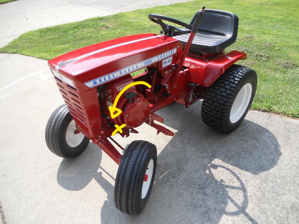

AMC RULES 37,260 #2776 Posted July 27, 2019 So, why not clock the recoil one bolt hole to the left... locating the handle down low, where the X is? Wouldn't it be less strain Bob, to just start it from a standing position in front of the tractor instead? 2 Share this post Link to post Share on other sites
Racinbob 13,213 #2777 Posted July 27, 2019 That's an option Craig. No real reason but I've never cared for pulling the rope from the front. Hopefully I'll get her finished up this coming week and I may find that it's fine as is. All my Kohler small blocks through the years have started with just a hint of rotation so hopefully this one will be the same. Share this post Link to post Share on other sites
squonk 48,212 #2778 Posted July 27, 2019 Leave it in gear and start it from the front. Hop on as it's buzzin by! 1 4 Share this post Link to post Share on other sites

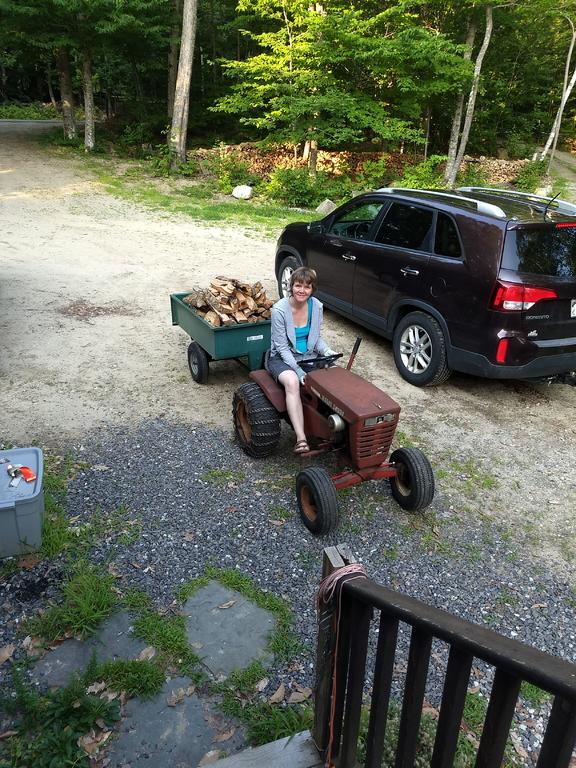

ebinmaine 80,909 #2780 Posted July 27, 2019 Trina n her mom spent some time dodging rain drops and moving wood this afternoon. She moved 4 loads with mumma and another 2 herself. The basement is well stocked for fall now. 7 3 Share this post Link to post Share on other sites

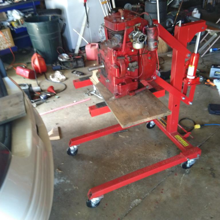

ohiofarmer 3,509 #2782 Posted July 28, 2019 (edited) Bought an engine for the raider10, which was my main working tractor. Now running the c141 with a 12 horse, but the Raider10 has a better deck for the ditches. Pumped about the engine. It's a starter/generator set up. I love this modified harbor freight high position motorcycle lift. Add the wheels and perfect for jobs that require a strong back. Rated for 1100, but I keep it at 750. Lifts to 30 inches and lifts quickly compared to most others. I have had a Gold Wing on it for a rebuild, so don't put down Hft Edited July 28, 2019 by ohiofarmer 7 Share this post Link to post Share on other sites

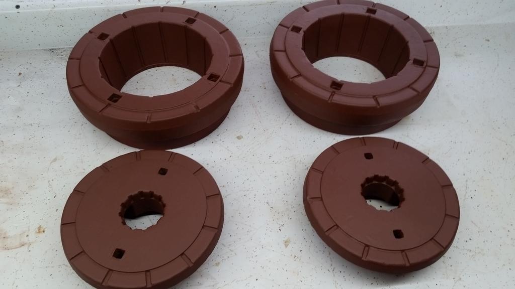

rjg854 13,403 #2783 Posted July 28, 2019 I've been tinkering with a couple of bugs in that 877 I bought at the Big Show. I'm pretty sure they are all taken care of, now. All that's left now is to get the wheels cleaned up and painted. I wire wheeled the weights and primed them, just not sure yet what color to paint them. 5 2 Share this post Link to post Share on other sites
AMC RULES 37,260 #2784 Posted July 28, 2019 Gonna do up a set antique white one of these days. 2 Share this post Link to post Share on other sites
rjg854 13,403 #2785 Posted July 28, 2019 I'm leaning that way myself. I've got some red ones, and a set of fronts that are black and don't care to much for them. So maybe when I paint the wheels, I'll do the weights. I can always change them if I don't like it. 2 Share this post Link to post Share on other sites
ebinmaine 80,909 #2786 Posted July 28, 2019 1 hour ago, AMC RULES said: Gonna do up a set antique white one of these days. 1 hour ago, rjg854 said: I'm leaning that way myself Been thinking the same thing. The set of bolens weights that rides around on the Cinnamon Horse needs a repaint something awful. Share this post Link to post Share on other sites

ohiofarmer 3,509 #2788 Posted July 29, 2019 (edited) 6 hours ago, AMC RULES said: Gonna do up a set antique white one of these days. I painted a bunch lAst summer Rust-Oleum linen white is close to most of the wheels, but a couple of sets matched their almond color. The inside of the wheels is where I looked for the factory colors So I think paint them how it suits you Take a rear axle off an MTD or something and set it on end. Then paint the wheels by spinning it. Great results almost a guarantee. I just left the tires on mine and set the wheels on top 🤗 🤣 Edited July 29, 2019 by ohiofarmer 2 Share this post Link to post Share on other sites

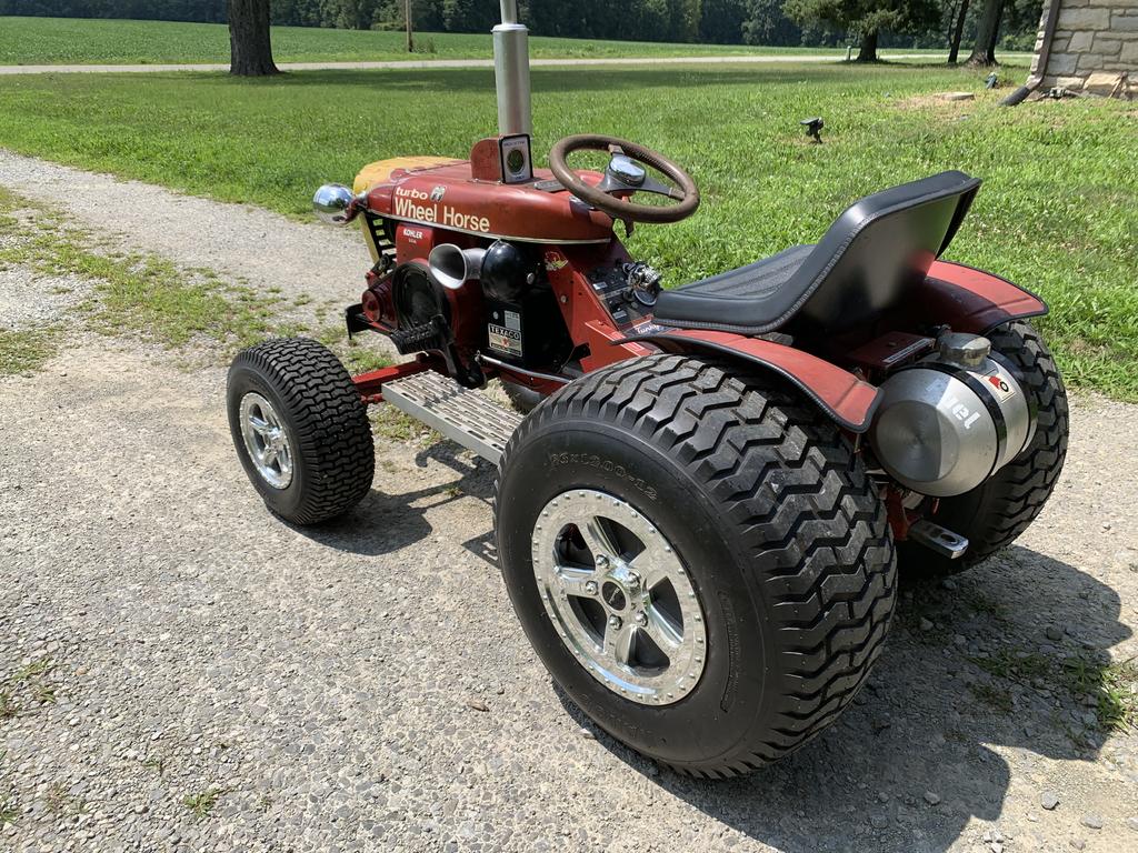

Bear G 690 #2789 Posted July 29, 2019 (edited) Got my show cruiser back together and ready to do some cruisin’... I put the horn on it that I got from David Brown at the Portage, Wisc Show. I'm ready to race @prondzy and honk at his dad when I cross the finish line in 1st place.. lol Edited July 29, 2019 by Bear G 7 3 5 Share this post Link to post Share on other sites
Pullstart 71,359 #2790 Posted July 29, 2019 6 hours ago, Bear G said: Got my show cruiser back together and ready to do some cruisin’... I put the horn on it that I got from David Brown at the Portage, Wisc Show. I'm ready to race @prondzy and honk at his dad when I cross the finish line in 1st place.. lol Looks Dandy, Bear! And we all know that @Shynon loves the horn! And trains! Ahh how I don’t miss a train! Or mosquitoes! 1 2 Share this post Link to post Share on other sites

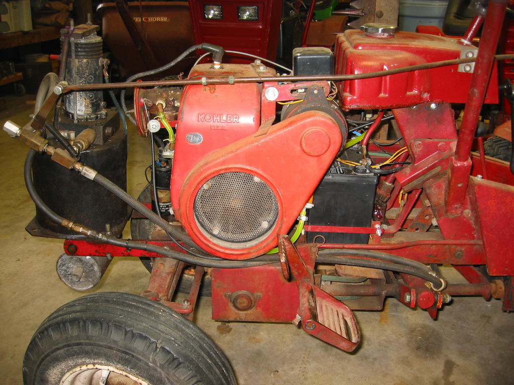

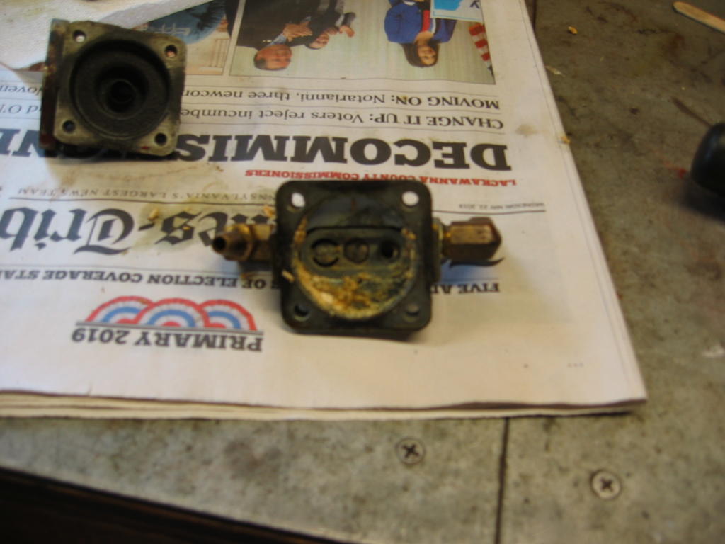

pfrederi 21,217 #2791 Posted July 29, 2019 (edited) Got the 753 (8 spd) running today. She hadn't been started in 2 years. 12 yr old battery was toast. Jumped her and she would run on carb cleaner but wasn't getting gas. Replaced fuel lines and took fuel pump apart filled with yellow crumbs. Cleaned it out and with a new battery she is ready to work...except it just started to rain... Edited July 29, 2019 by pfrederi 7 Share this post Link to post Share on other sites

peter lena 10,088 #2793 Posted July 29, 2019 BEAR G , what are you running for power on that rig ? pete Share this post Link to post Share on other sites

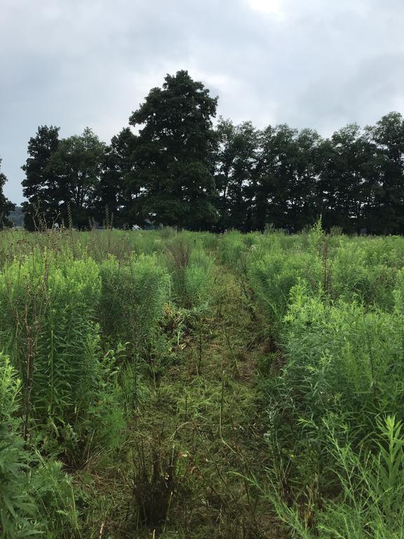

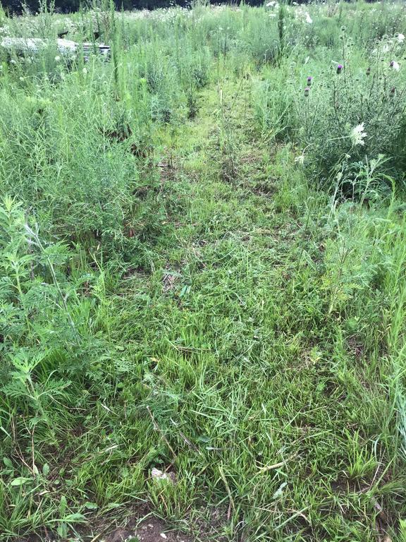

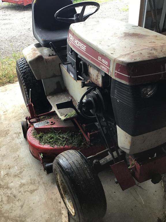

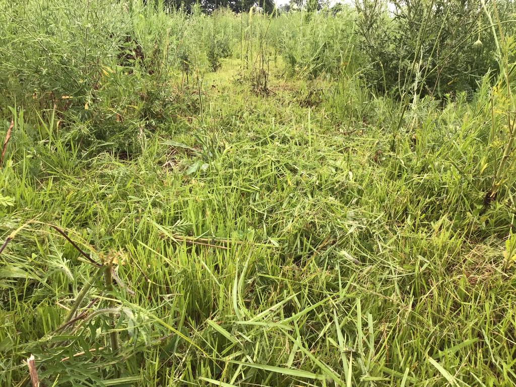

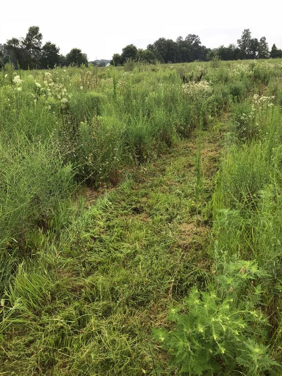

Pullstart 71,359 #2794 Posted July 29, 2019 My day pretty much was shot today from this, that and two other things coming up, so I haven’t touched the table base oroject. Being that the day’s pretty much over, why start on it now? The fuel pump rebuild kit for the Briggs twin came this weekend, so I headed to the GT-1600 with my toes and fingers crossed with hope to get it running. Good news... it cuts in the tall field grass VERY well! I even was able to come up on some turkey and other feathered fowl. Bad news... I have little to no extra power, more smoke than I hoped for, and only one warm cylinder. I should check compression, but my guess is that a rod is broken. All in all, I still wrangled some seat time, feel like I made a good purchase but not a great one, saw some new life on my property and the grass got watered for a while! Not a terrible day, in my book. Yes @Ed Kennell @WVHillbilly520H, the path happens to pass right under my tree stand and hope to gain some more “hanging weight” in the barn this fall! “Grunt, bleat, grunt” 8 Share this post Link to post Share on other sites
Bear G 690 #2795 Posted July 30, 2019 6 hours ago, peter lena said: BEAR G , what are you running for power on that rig ? pete Just 8hp Kohler. Pulley ‘d up though. 1 Share this post Link to post Share on other sites

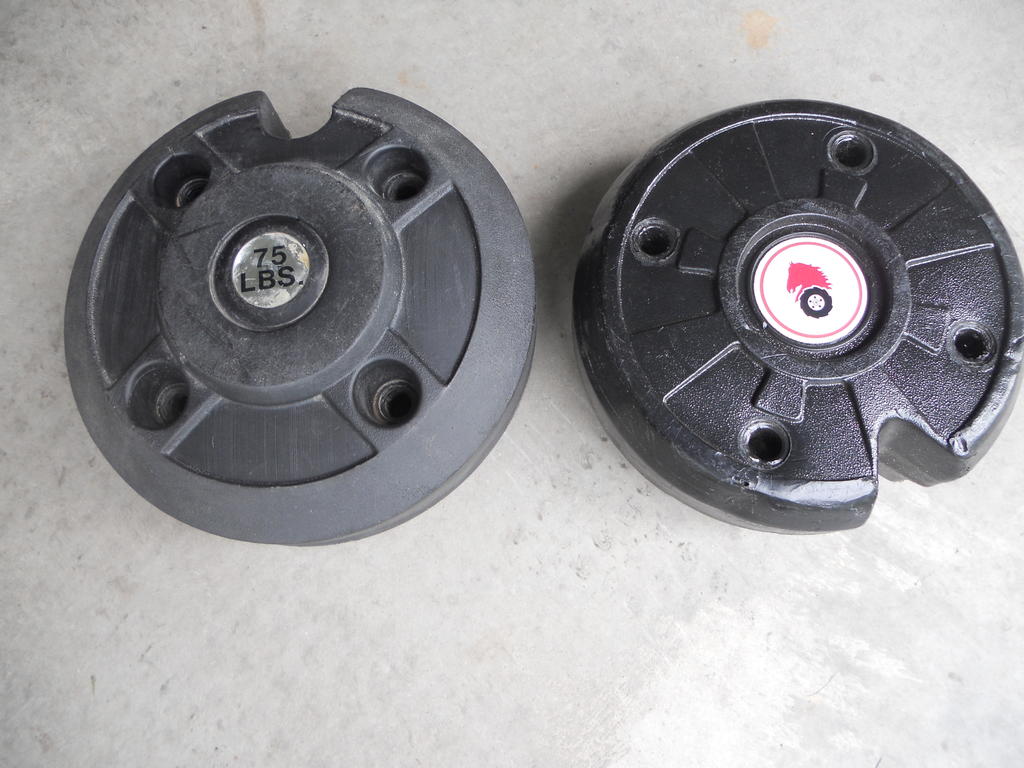

Racinbob 13,213 #2797 Posted July 31, 2019 I've been sorta looking for another set of wheel weights and actually wanted the type that protrudes outside of the wheel. The reason being is that I'll also run them in the summer on my main mowing tractor, the 2005 Classic. I really push the limits mowing sideways on the hills and it will give me a little more margin for error. Mowing up the hills that are just too steep hasn't been a problem but the extra weight sure won't hurt. I found a set of 75 pounders down in Bremen and picked them up yesterday. Pictured next to a set I got from Scott a few years ago and you can see the size difference for the additional weight. I also like the fact that the carriage bolts and nuts won't be protruding outside the weight. I think I done good getting 150# of weights for 50 smackers. Gotta get the proper decals on them though. 3 1 Share this post Link to post Share on other sites

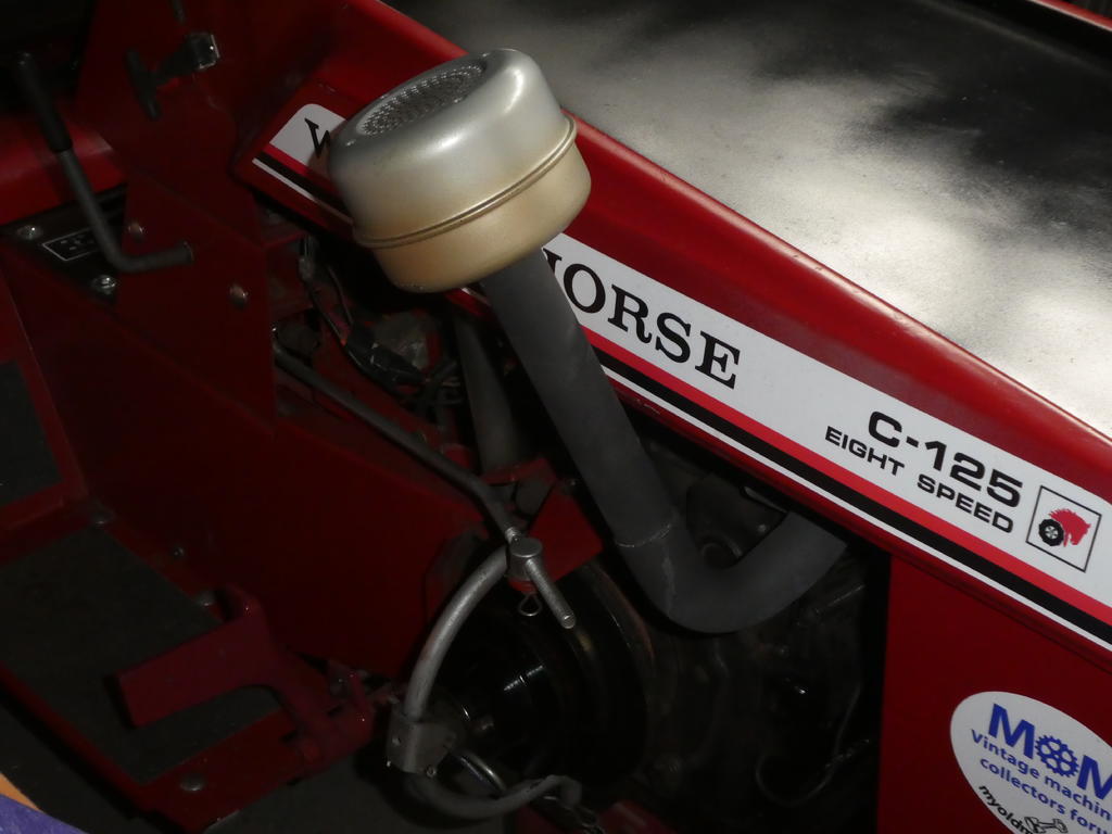

Stormin 9,988 #2800 Posted July 31, 2019 (edited) Had a bit of a mishap when mowing alongside the pond, outside our abode last week. There's a big willow tree that I pass under and I push the hanging strands to one side as I do so. These are practically touching the ground and this time I didn't quite get things right. Some strands tangled round the stack and snapped off the silencer/muffler. Just above the clamp. Went to a local tractor, quad, garden machinery outfit to see what they had. Only thing kind of suitable was a silencer/muffler for B&S 10 - 12hp engines. Had to order it and I picked it up today. It was made to screw into the head, but as can be imagined, the stub in the Kohler head was not going to budge. A little bit of measuring told me the existing pipe O.D. just above the bend, was slightly bigger than the new silencers. So I cut the pipe just below the join and off to the farm workshop to borrow the ocy/acet and heat the end of the bent pipe up. Getting it red hot allowed me to screw the threaded end of the new silencer into it. Worked a treat and no welding was needed, as the fit was good and tight. Fitted to the engine and we're back in business. OH! The willow has had a bit of a trim as well. Edited July 31, 2019 by Stormin 1 2 Share this post Link to post Share on other sites
