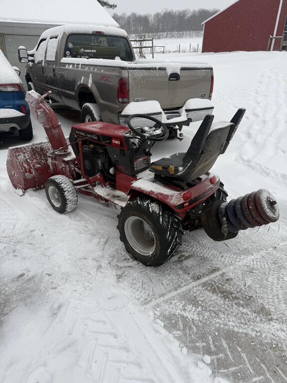

Desko 686 #25327 Posted January 26 Made a make shift weight bar and used some old weights that were kicking around so I could get around with the 44” blower. Didn’t have a problem going anywhere but definitely had to watch backing up. Probably going to seek out some wheel weights this year though. 8 1 Share this post Link to post Share on other sites

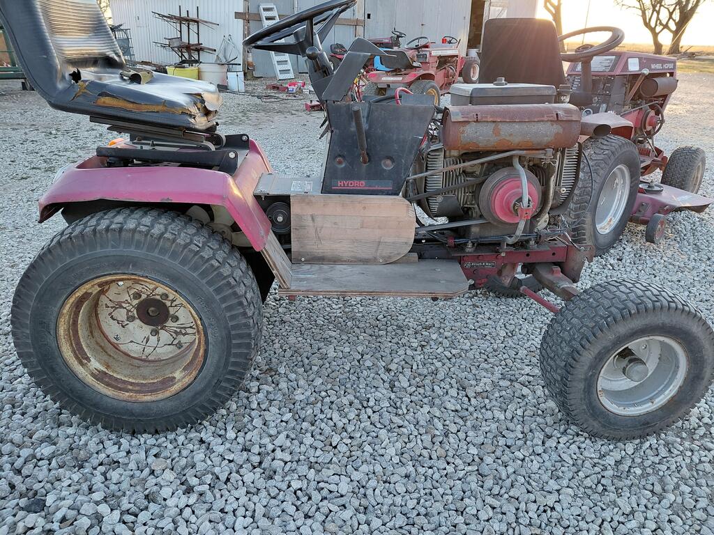

Easton Rich 1,260 #25328 Posted January 26 Here are the pictures of the new one if you haven't seen my wacko thread yet. I know some of you dont think its real yet, but I don't lie. 5 Share this post Link to post Share on other sites

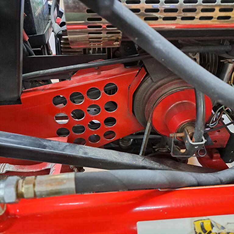

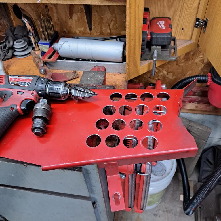

WHX?? 58,052 #25332 Posted January 27 (edited) Ventilation for a belt guard ala @cleat with a Greenlee punch. Bit different pattern Cleat but should work. Coulda had the spacing a little closer. Deburred with a step bit. Speaking of step bits... @Pullstart was here... Edited January 27 by WHX?? 7 6 3 Share this post Link to post Share on other sites

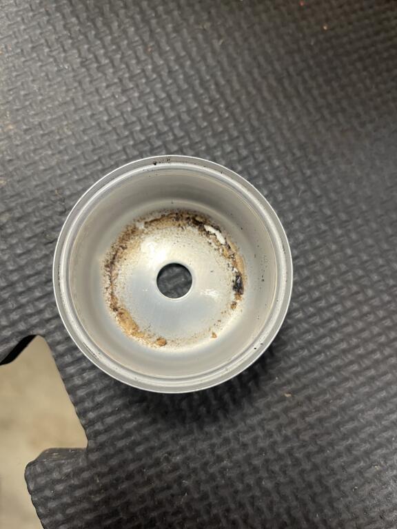

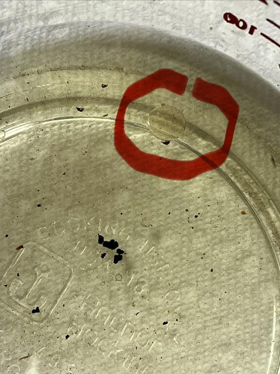

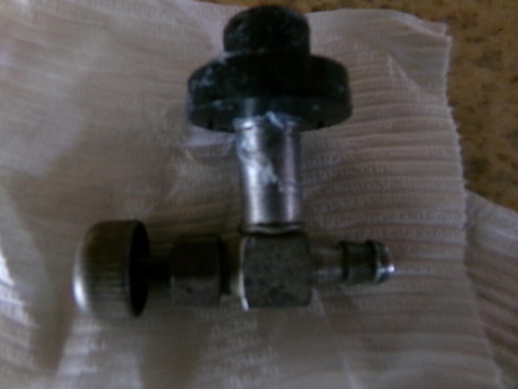

Ed Kennell 47,254 #25333 Posted January 28 The 520H had been acting like it was starving for fuel during the tail end of the last storm clean up. I actually had to leave the warm cab and brave the cold to finish with the 312H. I had installed an epump last fall and she had been running fine till now. Time to find the problem before the next storm that is coming this Sat. I pulled the line off near the carb and turned on the epump and got barely a dribble. Nice thing about the epumps..you don't have to crank the engine to check for good fuel supply. So, I went to the other end and pulled the line on the fuel tank petcock....not even a dribble. from the tank. The petcock was clogged with dirt. A good cleaning of the petcock and flushing the tank and back together and running like a happy ONAN should. When installing this I like to coat it with vaseline then just start the valve in the grommet before pushing the grommet into the tank then push the valve barb into the grommet. 8 4 Share this post Link to post Share on other sites
Shed 377 #25334 Posted January 28 Has anybody ever looked into Guinness book of records to see if this is the longest running active form on one single topic? Today I was just looking through pictures of summer horses tired of snow and thought of this 4 2 Share this post Link to post Share on other sites
Lane Ranger 12,094 #25335 Posted January 28 (edited) 3 hours ago, Ed Kennell said: The 520H had been acting like it was starving for fuel during the tail end of the last storm clean up. I actually had to leave the warm cab and brave the cold to finish with the 312H. I had installed an epump last fall and she had been running fine till now. Time to find the problem before the next storm that is coming this Sat. I pulled the line off near the carb and turned on the epump and got barely a dribble. Nice thing about the epumps..you don't have to crank the engine to check for good fuel supply. So, I went to the other end and pulled the line on the fuel tank petcock....not even a dribble. from the tank. The petcock was clogged with dirt. A good cleaning of the petcock and flushing the tank and back together and running like a happy ONAN should. When installing this I like to coat it with vaseline then just start the valve in the grommet before pushing the grommet into the tank then push the valve barb into the grommet. Ed: Interestingly I have found that debris does settle on top of this valve on several of the TORO model Wheel Horse tractors we have. Seems like gasoline, dirt, dust, leaves, etc sometimes collect in these rear tanks enough that they can block this spot. Cleaning the tank of all gasoline probably a good idea every four or five years. Edited January 28 by Lane Ranger 4 Share this post Link to post Share on other sites
kpinnc 18,939 #25336 Posted January 28 1 hour ago, Lane Ranger said: Seems like gasoline, dirt, dust, leaves, etc sometimes collect in these rear tanks enough that they can block this spot. Especially true of tanks with a fuel level sender. They tend to drop rust... 4 Share this post Link to post Share on other sites
Bill D 3,139 #25337 Posted January 29 3 hours ago, Ed Kennell said: The 520H had been acting like it was starving for fuel during the tail end of the last storm clean up. I actually had to leave the warm cab and brave the cold to finish with the 312H. I had installed an epump last fall and she had been running fine till now. Time to find the problem before the next storm that is coming this Sat. I pulled the line off near the carb and turned on the epump and got barely a dribble. Nice thing about the epumps..you don't have to crank the engine to check for good fuel supply. So, I went to the other end and pulled the line on the fuel tank petcock....not even a dribble. from the tank. The petcock was clogged with dirt. A good cleaning of the petcock and flushing the tank and back together and running like a happy ONAN should. When installing this I like to coat it with vaseline then just start the valve in the grommet before pushing the grommet into the tank then push the valve barb into the grommet. I always use the shut off valves with the built-in strainer screen. Is that what you're using? 2 Share this post Link to post Share on other sites
WHX?? 58,052 #25338 Posted January 29 5 hours ago, Ed Kennell said: got barely a dribble. Work on a 520 Ed Dog entailed taking out the gas tank. Full tank so drain it into a gas can and barely dribbled out. Took a day to let it run out. Pulled the rusty gas cock to check & replace an aged grommet and found @Bill D 's plugged strainer. I have been known to take off the strainer Bill figuring the inline filter will do it's job. Maybe not a good idea but the replacement valves have no screen. 4 Share this post Link to post Share on other sites
Ed Kennell 47,254 #25339 Posted January 29 4 hours ago, Bill D said: I always use the shut off valves with the built-in strainer screen. Is that what you're using? Every valve I have pulled had a partially clogged and collapsed screen so I always remove the screens so any dirt can pass thru the valve to the inline filter that I can easily replace. I have thought of replacing the valve and grommet with a 1/4"NPT bulkhead fitting that would have a much larger opening that would allow the dirt to exit the tank to the filter. May have drill and tap the tank boss to accept the bulkhead fitting. I have an inline filter near the tank and near the carb. with the epump in between the two filters. The plastic tanks are not as bad as the metal tanks, but they still get dirt from the funnels and cans used during filling. 8 1 Share this post Link to post Share on other sites
peter lena 10,047 #25340 Posted January 29 @WHX?? like that , do any wire rerouting to enhance that heat flow ,cooked connections will probably show you the way . looking right at it ? notice the relation of the pto outer swing mount , clip corner hole ?, to lower frame mount HITCH PIN CLIP ? similar hole , get a medium pull extension spring , hook ends and connect the 2 related areas ? no more pto linkage noise . buzzing ! also lubricate the upper/ lower pin clip rust areas , lets the spring easily take over buzzing noise , have that on my 3 horses for years . very easy to do , no more pto buzzing , pete 1 1 Share this post Link to post Share on other sites

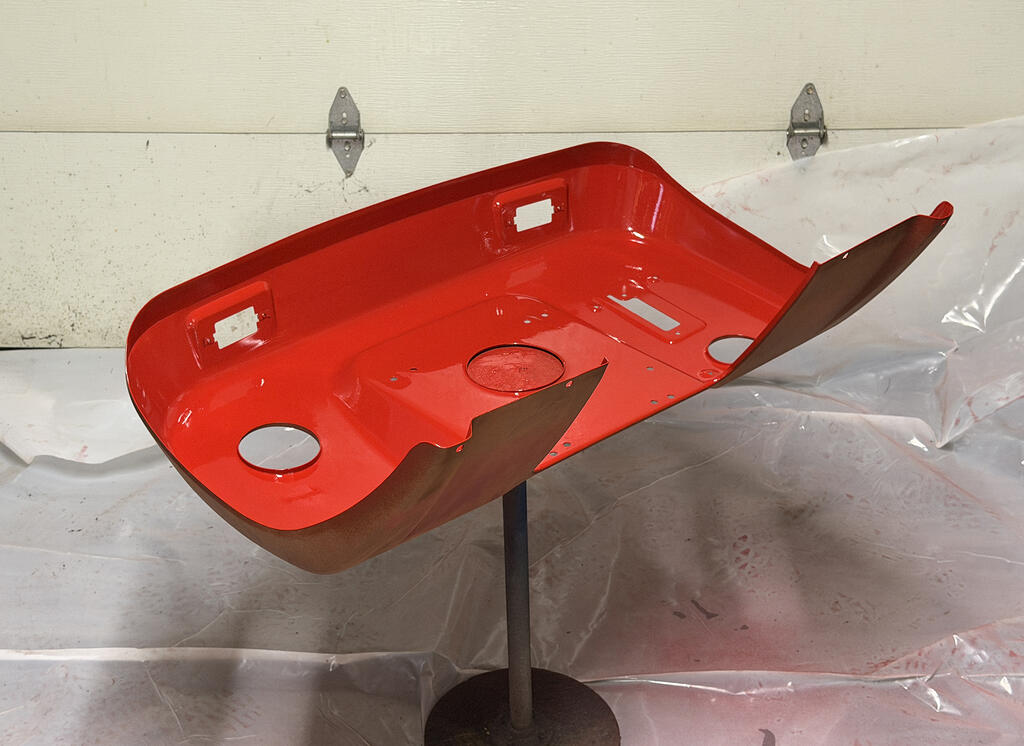

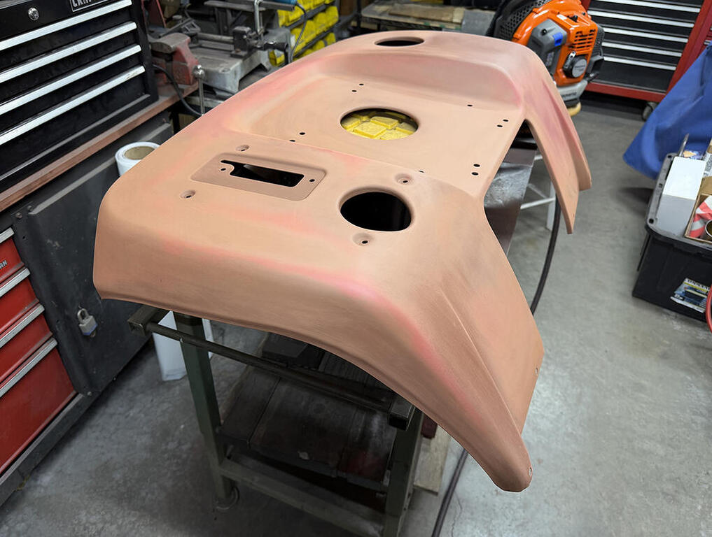

Blue Chips 854 #25341 Posted January 31 Finally getting back to some work on my 522xi. About a week or so ago I feathered, primed, and sanded all of the rusty and flaky spots on the fender, and then re-primed and re-sanded it. Here it is in progress: I spent most of the past few days trying to learn the basics of Blender software (any Blender users here?), which has a considerable learning curve that makes my brain hurt a bit, so I needed to take a break today. This afternoon I painted the underside of the fender. I'll let it cure for a few days before flipping it over and painting the top. I hope to put it back together and get the snowblower installed in time for spring. 6 3 1 Share this post Link to post Share on other sites

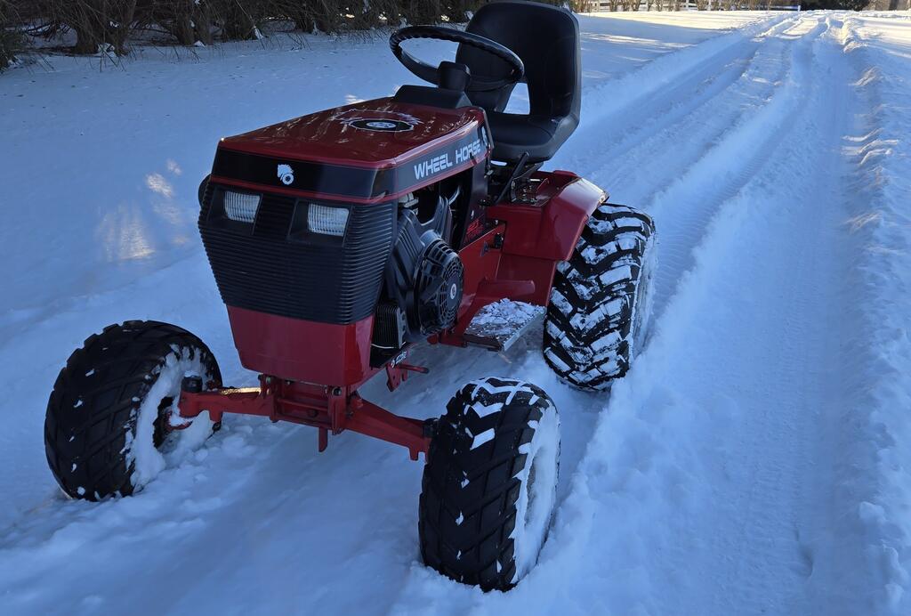

kpinnc 18,939 #25343 Posted February 1 Drove around in the snow. It'll be gone by Wednesday, so I had to play a little. 3 13 Share this post Link to post Share on other sites

kpinnc 18,939 #25349 Posted February 2 17 hours ago, Bill D said: First time in snow? For this tractor, yes sir! 1 Share this post Link to post Share on other sites
