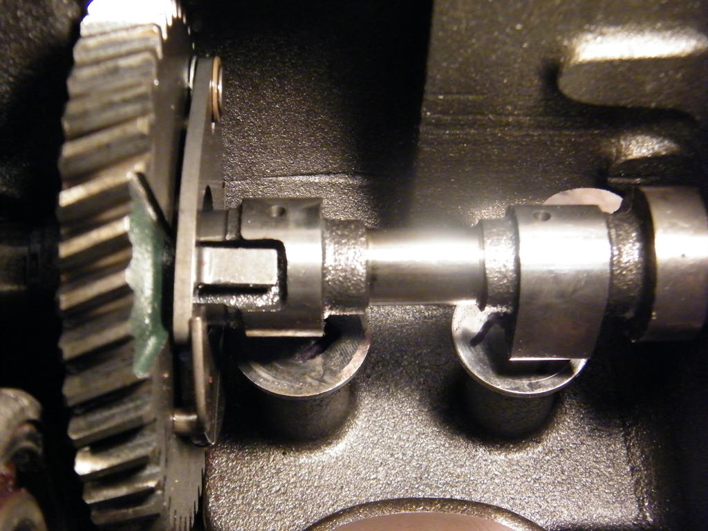

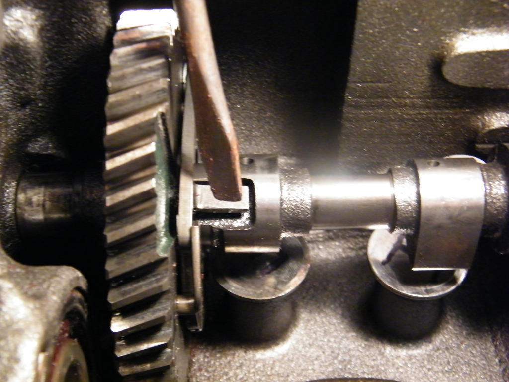

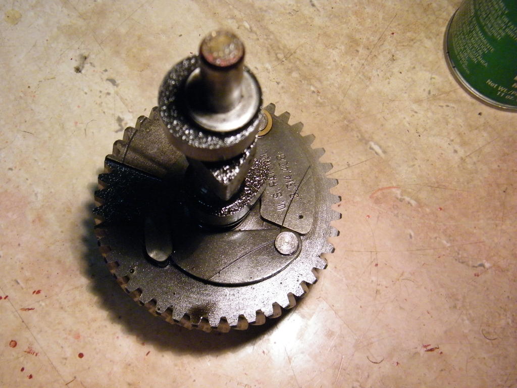

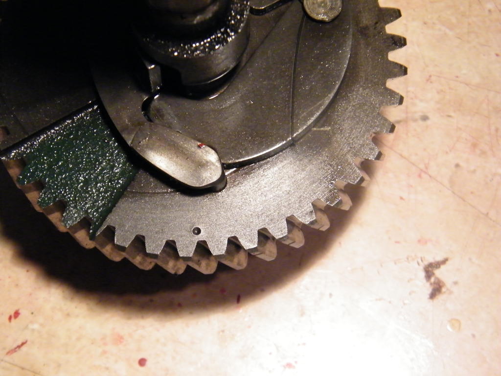

stevasaurus 23,857 #20 Posted January 15, 2018 Not the valves. I wonder if the spring broke on your ACR on the cam shaft. It would make more noise going slow then at fast idle. Your exhaust valve rides on that part. Also, maybe check if something is stuck around the flywheel and the flywheel cover. Certain things like to get in there if an engine sets for a long time. 1 2 1 Share this post Link to post Share on other sites
