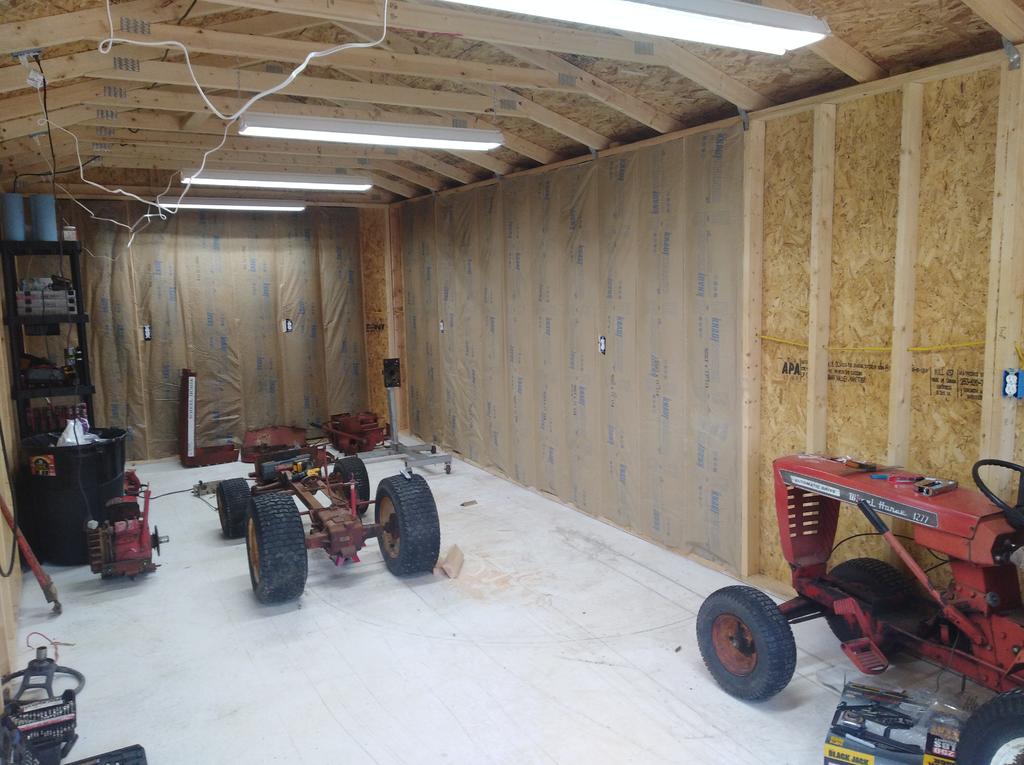

Sarge 3,473 #77 Posted January 19, 2018 Shop is looking great - leds will save your eyes over time , you'll appreciate that on long days in the shed, trust me on that. I'm dying to see that 1277 get restored - it really looks like a great candidate. Can't wait to tear into mine, money input is going to hurt but the old war horse sure deserves it... Sarge 1 Share this post Link to post Share on other sites

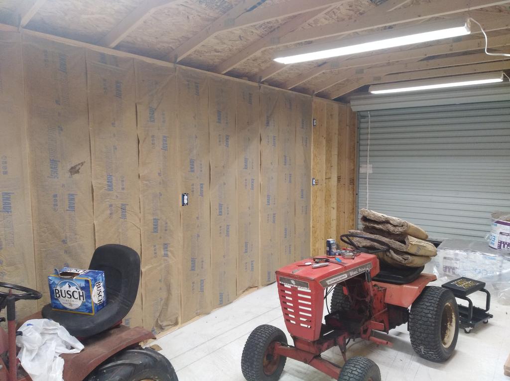

PeacemakerJack 11,080 #81 Posted January 20, 2018 2 hours ago, Professor1990 said: Over here at the shop doing some more insulating, it's slowly coming along This looks great professor! You can only imagine how slow it would be coming if you had built in shelving already in place and miscellaneous parts/tools everywhere...that’s what mine was like. I spent more time moving stuff around then I did actually installing insulation. I can’t wait to see some pics posted with the outside air temp and the working shop temp. If you don’t already have one, you need to put a basic thermometer in the shop. Looking good all around and I too can’t wait to see that 1277 restored when the time comes...for the time being, it is a totally sweet shop “decoration”! 2 Share this post Link to post Share on other sites
cleat 9,389 #82 Posted January 20, 2018 The first winter I heated my shop only the ceiling was insulated. Actually heated pretty easily. I guess most heat goes up. Yours is looking great. Cleat 2 Share this post Link to post Share on other sites

ClassicTractorProfessor 5,455 #84 Posted January 21, 2018 12 hours ago, Sarge said: That shop is going to be nice and I'm sure you'll get a lot more use out of it than just storage - great investment. Do you plan to cover the interior walls once the insulation is done ? Sarge Yes the shop will eventually be completely finished with drywall when it is all said and done. May try to insulate the ceiling in another week or so...have to see how much extra money I have left out of my next paycheck. Just doing what I have done so far has already seemed to make a difference. Haven't had any super cold days since I started (and I hope those are over with for a while) but the last couple nights it's been cool enough outside that a guy wants a light jacket, but been working in the shop with my little propane heater on low in a t-shirt. Pretty much got all the insulation in the walls, only thing left is all the little small pieces in the corners and around the doors and window...should finish that up tomorrow, had intentions of finishing it all this afternoon after work, but my company pickup had other ideas when it decided to lose the idler and shred the serpentine belt, leaving me on the side of the road for 2.5 hrs But plan on having that done tomorrow, and will have some more pictures for you guys, and maybe even another video tour 3 Share this post Link to post Share on other sites

Sarge 3,473 #86 Posted January 21, 2018 Just a thought... Hunt around on the farm sale sites, FB sale posts and stuff like that for some metal siding, sometimes you can get it free or close to free. Drywall loves to collect moisture in an outside building like that and will eventually rot out and fall apart. It all depends on how well you do the vapor barrier as with any interior side of an outside wall. Metal siding has one big benefit - it won't burn and if you ever plan to use a grinder or welder in there - something to think about. I've seen too many people lose a garage or shed from sparks getting caught in the paper surface of drywall, smolder unseen for hours and then burn the thing to the ground later after they leave. My rule when doing any hot work is a 30 minute period before leaving - and a close inspection for anything smoldering before I turn out the lights. Twice I've caught stuff very faintly smoldering from grinder or welder sparks in places you'd never think of - it's scary to think what would have happened if I hadn't stuck around for awhile. All the safety requirements I have to deal with at work are a pain in the butt, but they make sense more than you'd think - especially at home. First thing I'd install once the inside walls are done is a good fire extinguisher mounted just inside the door - it's not good to have to use one or the expense, but if you don't have the result is far worse. Just something to think about - most people don't think much about this type of thing but after a hard lesson or two - it stays in mind a lot better, lol. Sarge 3 2 1 Share this post Link to post Share on other sites

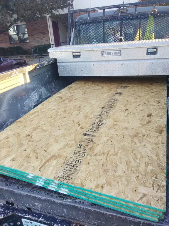

ClassicTractorProfessor 5,455 #91 Posted October 21, 2018 Going to start covering the walls tomorrow...had planned on starting today...but within 10 minutes of getting to the shop a friend of mine showed up in desperate need of a new front wheel bearing on his F150...nowhere near enough to finish but gotta do a little at a time as the budget allows 1 1 Share this post Link to post Share on other sites

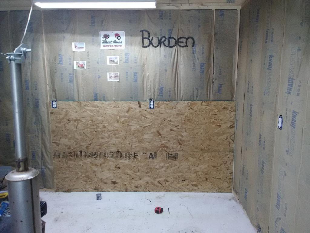

ClassicTractorProfessor 5,455 #93 Posted October 21, 2018 Got one sheet up and then the dumb battery in my drill died...still on the fence about whether to go with OSB all the way to the ceiling on this back wall or pegboard from that point up over the top of the workbench Share this post Link to post Share on other sites
ebinmaine 81,000 #94 Posted October 21, 2018 26 minutes ago, Professor1990 said: pegboard My vote ^^^^^ 1 Share this post Link to post Share on other sites
Mows4three 833 #95 Posted October 21, 2018 (edited) I'm in agreement with Eric for the space over the bench. White painted pegboard. Paint both sides. It will take on moisture and swell in an environment where it isn't constantly heated in the cold months. Found that out at our cabin in the utility room. Painting the backside prevents it from swelling. Cheers! Dave Edited October 21, 2018 by Mows4three Spelling 1 Share this post Link to post Share on other sites

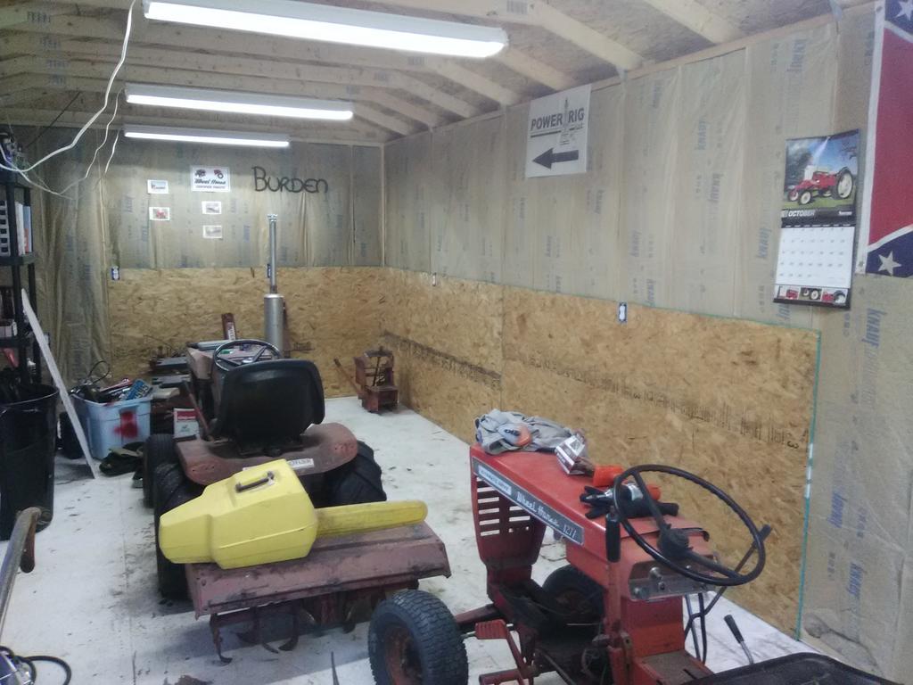

ClassicTractorProfessor 5,455 #96 Posted October 21, 2018 Got three of the five sheets I bought up today....forgot one small detail at the lumber yard yesterday...SCREWS ...so guess I'm at a standstill until probably next weekend. I am leaning more towards the pegboard, though some shelves above the bench would be handy as well. I'll let y'all know when I decide 1 Share this post Link to post Share on other sites

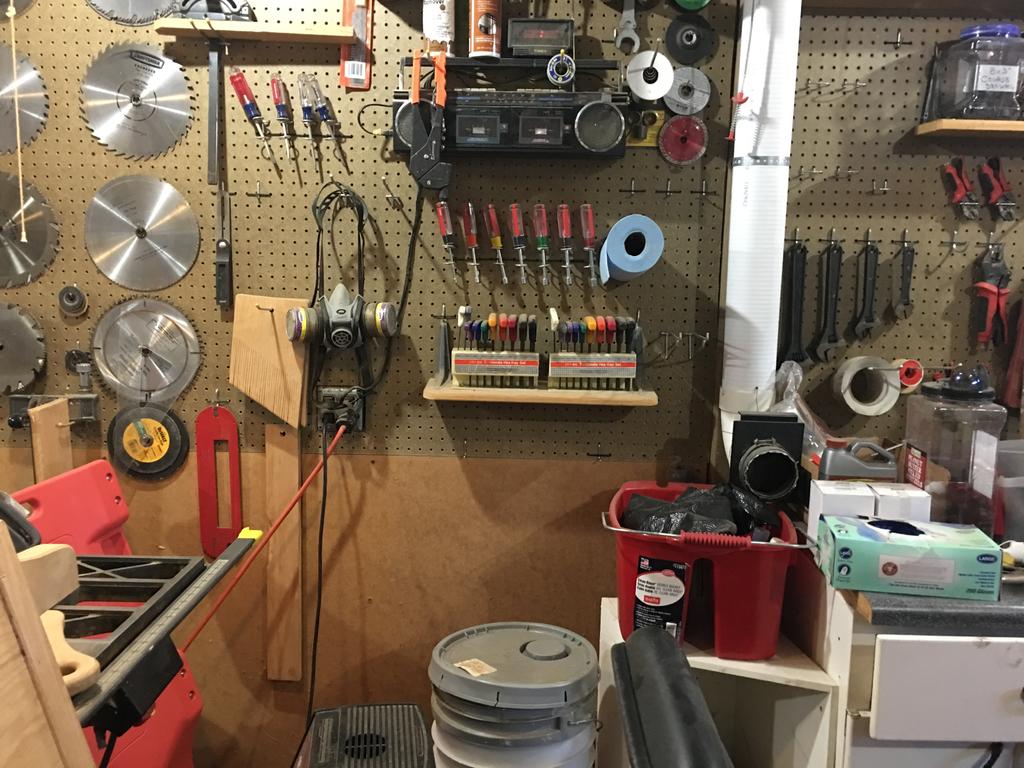

ebinmaine 81,000 #97 Posted October 21, 2018 8 minutes ago, Professor1990 said: more towards the pegboard, though some shelves above the bench would be handy I have two 4-foot by 8-foot pieces of pegboard in my cellar workshop and I have shelves in my outdoor Workshop. Handy for different reasons. Perhaps you could do both? 1 Share this post Link to post Share on other sites

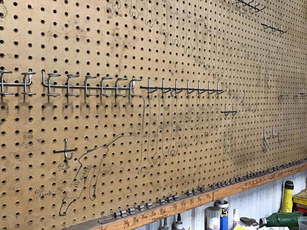

Pullstart 71,452 #98 Posted October 22, 2018 I vote some pegboard too. Maybe some 1/4” furring strips behind, or a 2x4 on bottom to trim it out. We bought from my in-laws and they aren’t totally out yet, but if he takes the pegboard, I’ll probably duplicate the idea. “A place for everything and everything in it’s place” will most likely play out easier if it’s visual that something’s missing. 1 Share this post Link to post Share on other sites
