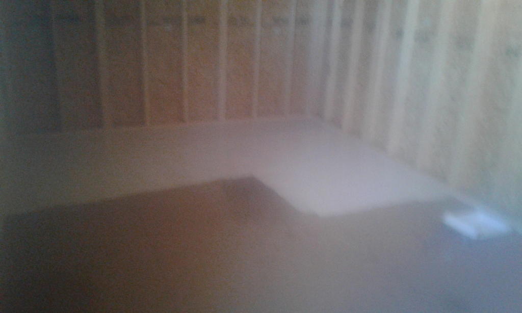

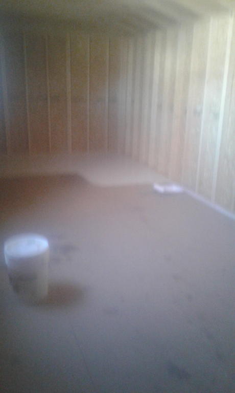

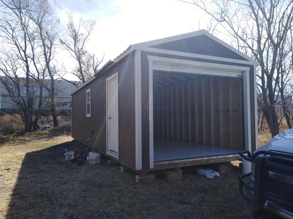

ClassicTractorProfessor 5,455 #1 Posted November 21, 2017 As y'all know I recently bought a 12x32 portable garage. Figured I would start a thread for my progress in getting it finished and set up to work in. Today's project is painting the floor. One reason for this is to protect the floor from water and oil spills, other reason for this is light...the painted floor will make it look larger and make it easier to see while working on things. this is how it came delivered 15 3 1 Share this post Link to post Share on other sites

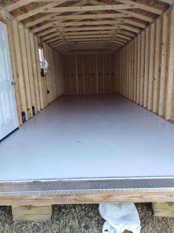

ClassicTractorProfessor 5,455 #6 Posted November 22, 2017 got one coat of paint on the floor today...going to put another on Thursday...didnt get a picture of the whole thing painted...too windy to open the overhead door. Will get more pics when I can 3 Share this post Link to post Share on other sites

ClassicTractorProfessor 5,455 #10 Posted November 22, 2017 11 hours ago, Ed Kennell said: I can't see an seams....is the floor plywood? What paint are you using? 10 hours ago, ztnoo said: Yeah......I want to know too........along with what is the flooring material, and its thickness. ??? At least 3/4", I would hope...... the floor actually had two layers...there is one layer of OSB directly on top of the floor joists, then a layer of material similar to MDF for the top layer. Floor joists are 2x6 on 12" centers so definitely heavy duty enough. As far as paint goes...its just a cheap flat white latex our local lumber yard sells. Not the most durable thing in the world, but for the cost ($30 for 5 gallons) I can make it work 2 Share this post Link to post Share on other sites

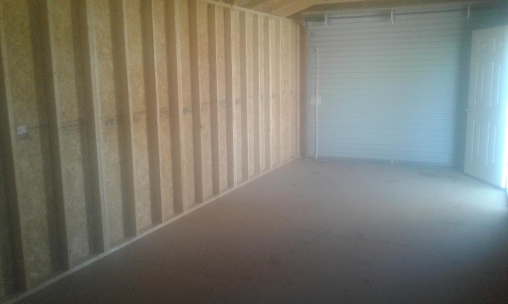

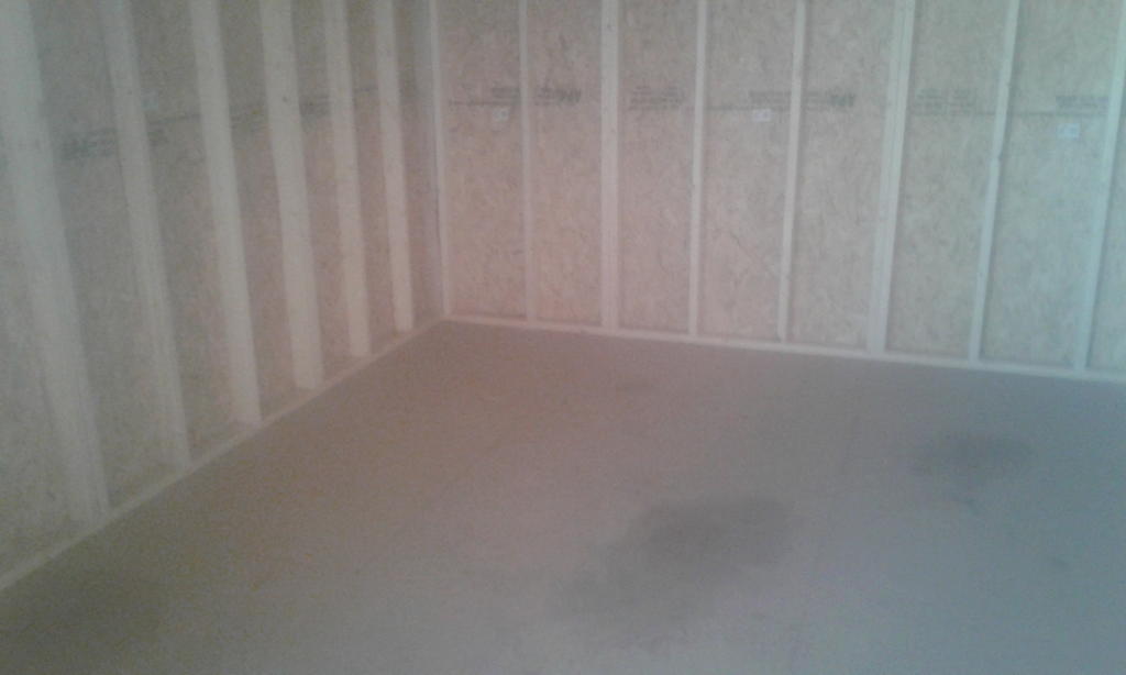

ClassicTractorProfessor 5,455 #11 Posted November 23, 2017 Got a second coat of paint on the floor this morning...and got a new phone that takes better quality pictures...so got a couple better ones of the whole shop. Think I'm gonna put one more coat on the floor this afternoon and call it good 3 Share this post Link to post Share on other sites

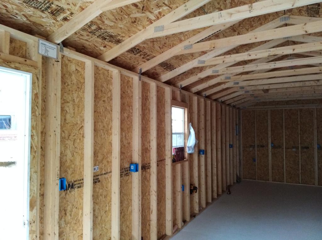

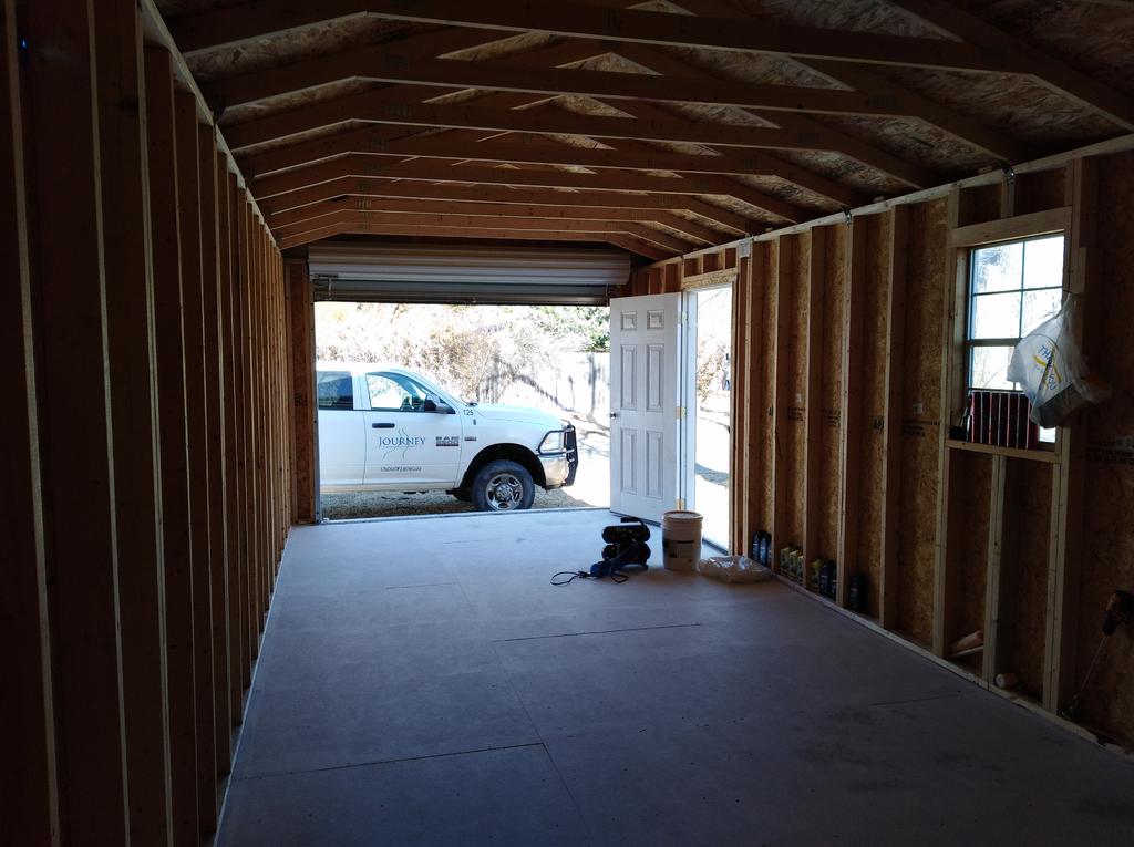

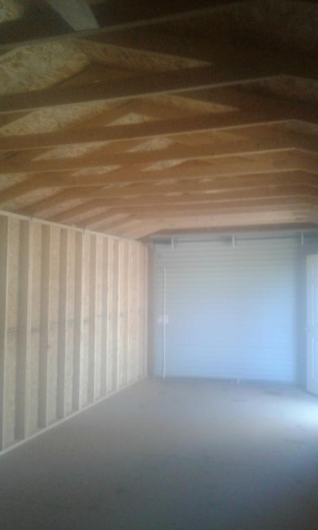

ztnoo 2,302 #12 Posted November 23, 2017 Those trusses are set unlike any I've ever seen or building I have be involved constructing. The flat bottom chord (ceiling joist) would normally be set on the top of the double plate, but in this case there is no double plate, only a single top plate. I've never seen anything constructed where the truss tail was sitting on and attached to the wall plate. It gives a little more head room, but that's a detail I wouldn't care to replicate. Also, I note every other truss has no direct bearing stud under it. If the wall had a double plate, that wouldn't be an issue. I guess those hurricane ties are the main mechanical attachment. Wonder if they are attached on alternate trusses on the outside of the frame like they are on the inside of the wall frame? That's very odd to me, and I was around residential and light commercial construction for about 45 years......... I'm not intentionally meaning to be critical, just noticing some details which I would not copy if I were building the structure. If it suits your needs and gives you good service life, I guess that's the most important thing for you. Share this post Link to post Share on other sites
AMC RULES 37,260 #13 Posted November 23, 2017 Well, it's not like it's going to be carrying any significant snow load in Oklahoma. That's for sure. Share this post Link to post Share on other sites
953 nut 69,917 #14 Posted November 23, 2017 1 hour ago, ztnoo said: residential and light commercial construction That is a factory built shed and they support political campaigns so they don't have to follow building codes. 3 2 Share this post Link to post Share on other sites
ClassicTractorProfessor 5,455 #15 Posted November 23, 2017 A better picture of how they are fastened...I thought it was weird too...but have never saw a building like this that was built with a double top plate...a friend of mine who built houses for over 50 years looked it over and he thought it was weird but didn't see any problems with the way it was built Share this post Link to post Share on other sites
ztnoo 2,302 #16 Posted November 23, 2017 (edited) 33 minutes ago, AMC RULES said: Well, it's not like it's going to be carrying any significant snow load in Oklahoma. Likely not. Just tornados, which they have bunches of in "Tornado Alley". 5 minutes ago, Professor1990 said: A better picture of how they are fastened...I thought it was weird too...but have never saw a building like this that was built with a double top plate...a friend of mine who built houses for over 50 years looked it over and he thought it was weird but didn't see any problems with the way it was built Well at least you are aware of the odd details then. I wonder it those long screws are the only mechanical fastener on the truss tails with no stud bearing under them? Can you reach over the top plate and feel a hurricane tie going to the frame exterior??? Edited November 23, 2017 by ztnoo Share this post Link to post Share on other sites
ClassicTractorProfessor 5,455 #17 Posted November 23, 2017 Just finished up the third and final coat of paint...checked while I was out there the only method of fastening every other truss is with the single big screw. And snow shouldn't be a problem here, although we have been known to have a freak storm dump 48" on us at once. We do have tornadoes here, but straight line winds would be my biggest concern...it's nothing to have sustained winds of 50-60 mph here...had one of those days last weekend and it held together just fine. Now my RV was another story, woke up at 4 am thinking I was gonna blow over the wind was so strong Share this post Link to post Share on other sites
Ed Kennell 47,688 #18 Posted November 23, 2017 Looks good Bryce. I really like that roll up door. It won't block the lighting like my big 10X18 foot overhead. Is that a manual or electric operator? I'm sure it will serve you well. While we are discussing the framing, I don't see the need for the double wall studs at the siding joints and I would probably have put the roof trusses on 16" centers to align with the wall studs and put in a plywood hurricane tie connecting each wall stud to each roof joist. This also eliminates any question on the need for a double top plate on the walls. And that's my two scents or cents, or sense.... 2 Share this post Link to post Share on other sites
ClassicTractorProfessor 5,455 #19 Posted November 23, 2017 Thanks Ed...the door is just your standard manual roll up door. If I had built the building myself I would have done just like you suggested...I've looked at several of these buildings before purchasing this one, and every one of them had the double studs at the joints not sure what their reasoning behind it is Share this post Link to post Share on other sites

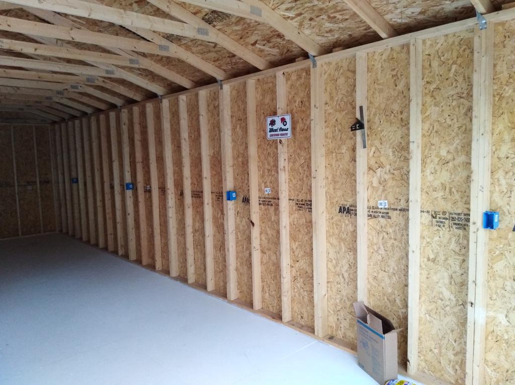

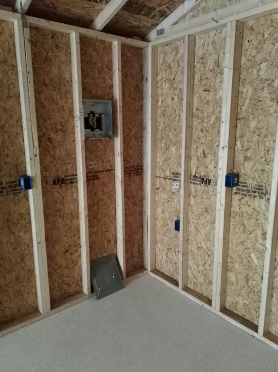

ClassicTractorProfessor 5,455 #23 Posted November 24, 2017 Started on some of the electrical today. Got panel in place and all boxes on the walls set...Started running wire but messed up my drill bit...nails hidden inside the studs are kinda hard on bits lol...oh well tomorrow is another day 3 Share this post Link to post Share on other sites
Digger 66 3,530 #24 Posted November 25, 2017 (edited) 10 hours ago, Professor1990 said: You can never have enough outlets ^^^^ Very wise decision to install plenty of them . When I was helping my dad build his 24 X 24 garage as a teenager , I wondered why he had +/- 25 outlets installed . I soon found out ...... I don't see one high enough to plug a clock into though ???? Edited November 25, 2017 by Digger 66 2 Share this post Link to post Share on other sites
