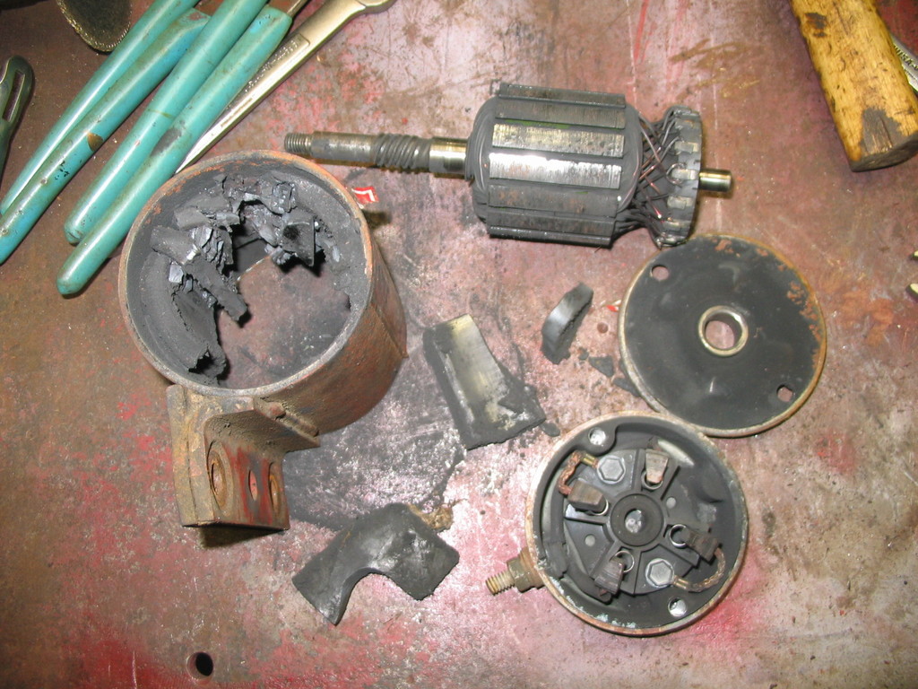

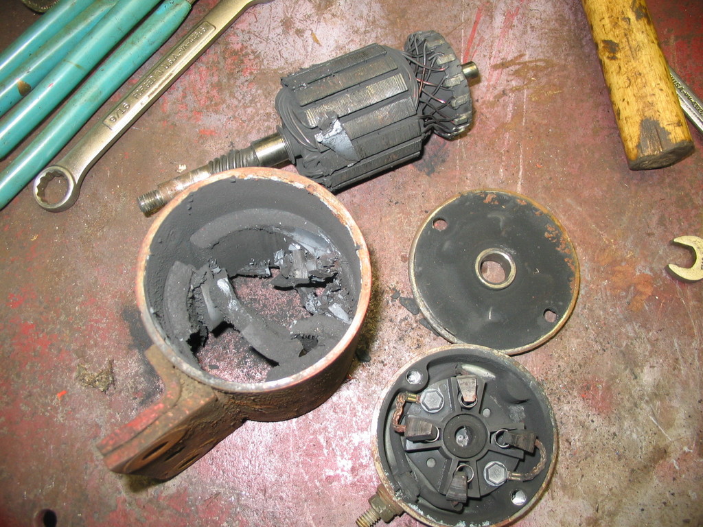

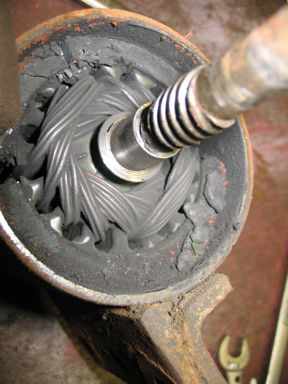

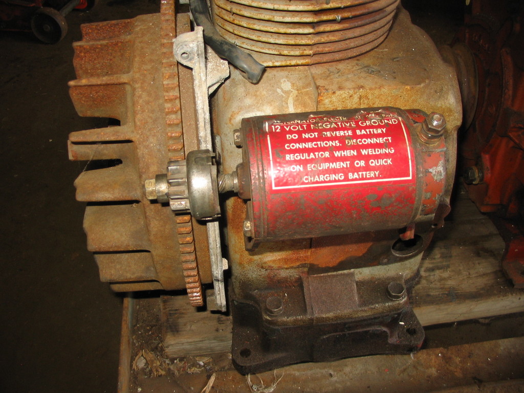

daveoman1966 3,884 #1 Posted August 5, 2017 A friend says "Dave, my starter quit"... so I gave him a replacement, thinking I could rebuild his dead one. Well, I gotta tell ya.... it is beyond DEAD. Here is every reason why to NEVER HIT WITH A HAMMER..... The armature in this would NOT turn at all...stuck tight and he wondered why it didn't work. So... TO EVERYONE..... DON'T HAMMER IT.... If it quits, take it off and fix it....or buy a replacemment 7 Share this post Link to post Share on other sites
pfrederi 20,899 #2 Posted August 5, 2017 Looks like he used a BFH 6 Share this post Link to post Share on other sites
AMC RULES 37,259 #3 Posted August 5, 2017 Two of 'em. 2 Share this post Link to post Share on other sites
953 nut 67,509 #4 Posted August 5, 2017 , the other day I was in an auto parts store and overheard this age old advice being given! Got to the parking lot in time to hear the loud smack and the cursing that followed when it didn't start. I have also seen this bad advice given on this site, but it is promptly rebuked as a rule. 5 Share this post Link to post Share on other sites
Big_Red_Fred 1,548 #5 Posted August 5, 2017 That took a can of Spinach ! Popeye 1 Share this post Link to post Share on other sites
Sarge 3,473 #6 Posted August 6, 2017 A tap with a block of wood will jar a corroded set of brushes enough to make it work - if it doesn't you're at the point of taking it off and either fixing it or replacing it . Steel headed hammers and their operators have no idea how brittle those magnets are - until they learn how much that error is going to cost them . I've seen that with the huge starters on diesel trucks - none of which are fun to remove/repair/replace and core charges can hit north of $800 in a hurry if you bust the field magnets . Had one guy do it twice , to the same Kenworth - only to find out later it was a $20 relay that was the issue ....boy, was he mad , lol... Sarge 5 Share this post Link to post Share on other sites
6bg6ga 272 #7 Posted August 6, 2017 Hammers and starters don't get along. Anyone using hammer probably needs to have their head examined. If it don't start hitting it can case a great deal of damage. The thought that a hammer hit can some how cause brushes to make contact is probably along the line of a miracle. It ain't going to happen. Simply remove and repair it. 1 Share this post Link to post Share on other sites
Big_Red_Fred 1,548 #8 Posted August 6, 2017 10-4 on the KW's, i watched the younger Mechanic's many times, they'd say shut up old man, i know my job, id laugh, say ok Super Boy, an hour later when they broke their last 12 point socket, hey Pap, can i use your socket, id smile & say you know it all, call Snap on, ahhhh no 2 Share this post Link to post Share on other sites

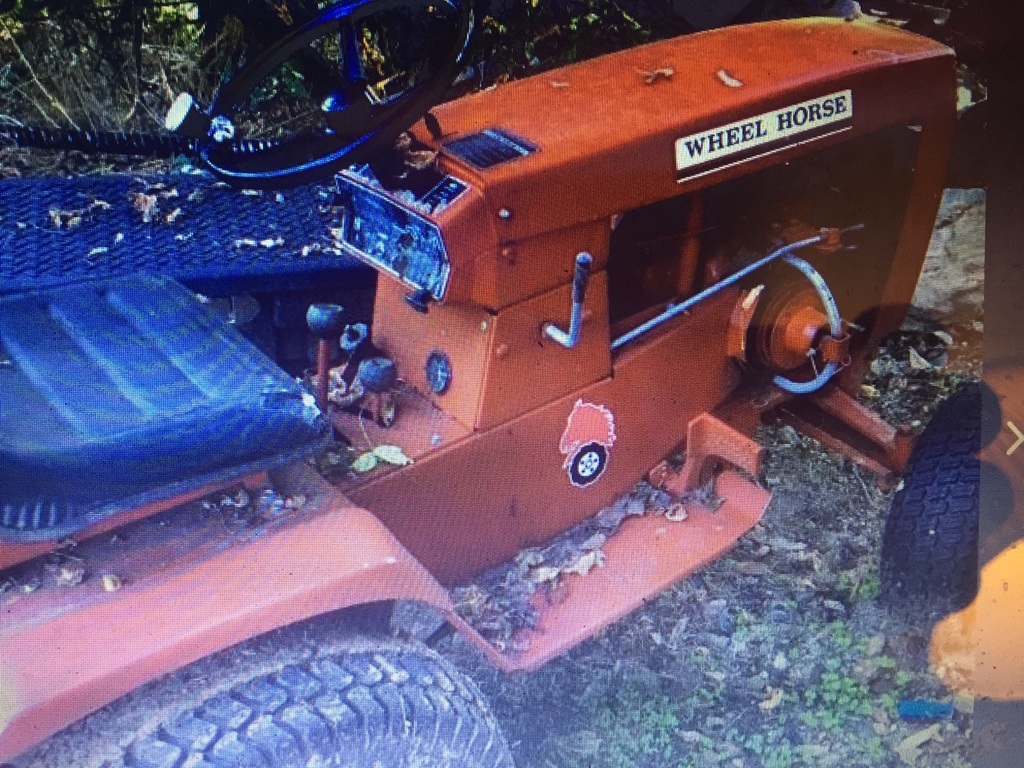

BOB ELLISON 2,983 #9 Posted August 6, 2017 I've got a c160 it's my parts tractor and I tried to start it but the starter wouldn't do anything. I removed the starter and one of the magnets has a broken piece . I suspected the PO hit it .it's not even fixable with out another case. I did hit starters on cars when i was young for not starting . But I was young and I knew it all. 4 Share this post Link to post Share on other sites
Sarge 3,473 #10 Posted August 6, 2017 The first time I walked out and had a hammer in my hand , neighbor in the driver's seat holding the key switch my old man saw that and gave one warning - you hit that starter with a steel hammer - I'll use it on you next ....I've never done it since but use a block of wood . If it doesn't go with a tap to get it to the shop to repair it , well , it gets fixed as it sits or pull-started if possible . If you ever take those magnets out and drop one on the floor - it makes a lot of little pieces...don't ask how I know that one , lol . I keep old mower starters around just to rob their magnets to repair ones that someone has smacked - it's tricky to get the glue broken loose but it can be done . Sarge 2 Share this post Link to post Share on other sites

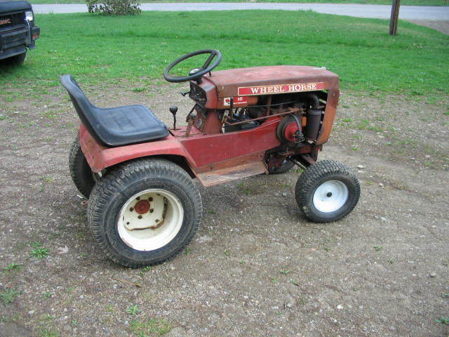

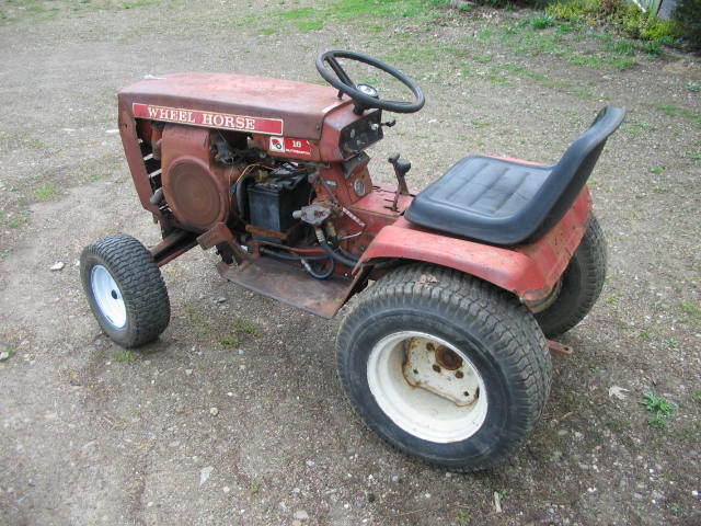

Big_Red_Fred 1,548 #11 Posted August 6, 2017 @BOB ELLISON is this no name a C160 ? Eric J thinks so by the hood and dash I found it in some ones back yard, he wanted 800, gave a offer, still waiting, it dont run Share this post Link to post Share on other sites
daveoman1966 3,884 #12 Posted August 6, 2017 (edited) That is not a C-160. Morel likely a C-161, if it has a 16hp engine that is. A c-160 looks like this> Edited August 6, 2017 by daveoman1966 3 Share this post Link to post Share on other sites
Big_Red_Fred 1,548 #13 Posted August 6, 2017 @daveoman1966 Thanks Dave, without any badge, i get lost, i should of snaped the serial number, i'm gonna call him today, 3 implements go with it, Share this post Link to post Share on other sites
ericj 1,580 #14 Posted August 6, 2017 If I said that was a C160, I'm sorry, It looks more like a C161 I'd say that it is a 77, 78, 79, C161 the model and serial # plate should be on the lift handle side of tractor facing the motor, kinda on the edge of the sheet metal eric j 1 Share this post Link to post Share on other sites
rmaynard 17,436 #15 Posted August 6, 2017 C-161 would be 1978 or 1979. C-160 ran through 1977. You can easily tell by design of the dash tower (hood stand). 1 Share this post Link to post Share on other sites
Big_Red_Fred 1,548 #16 Posted August 6, 2017 @ericj My mistake eric, you did tell me its a 161, old age & over worked, Sorry Buddy Share this post Link to post Share on other sites

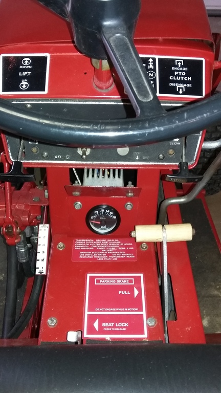

BOB ELLISON 2,983 #17 Posted August 6, 2017 @Big_Red_Fred this is a C160 hydro. the regulator sticks out the dash tower. 3 Share this post Link to post Share on other sites
Big_Red_Fred 1,548 #18 Posted August 6, 2017 10-4 Bob, now i got you all, Thanks, Share this post Link to post Share on other sites

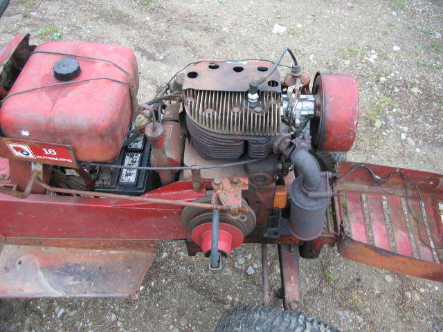

Sarge 3,473 #19 Posted August 7, 2017 '73 no-name 16 Auto had the hydro control between your legs , '74 and later it was moved back to the side of the dash stand . The first one in the pic is an 8spd hi/low version manual transmission . Sarge Share this post Link to post Share on other sites
