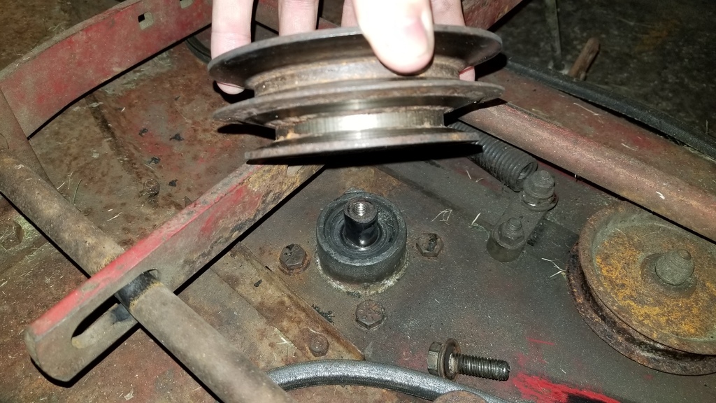

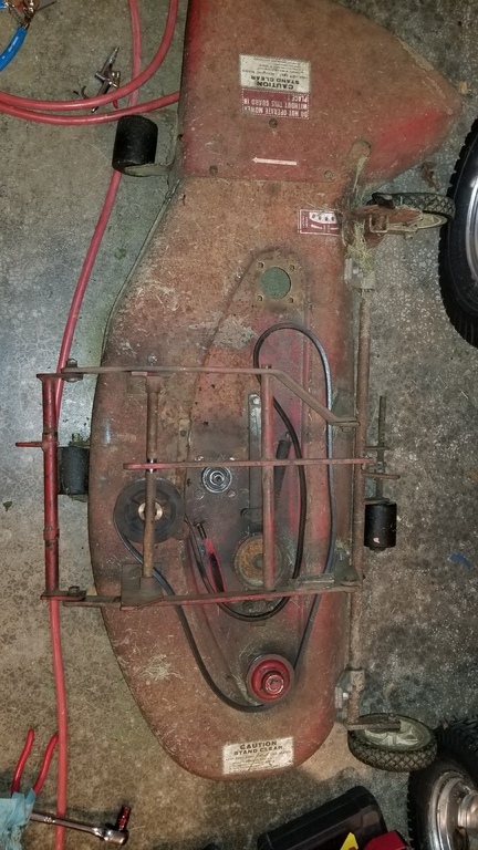

ACMan, here are the pictures I have on hand, can get some better ones after work if you are interested in seeing them.

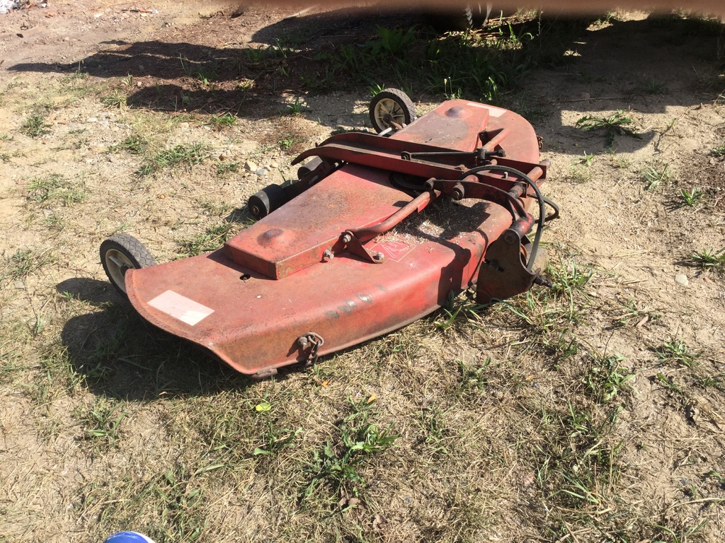

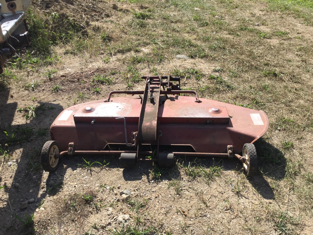

Here is an overview of the deck. It is not the unit that came with the mower, and by looking through manuals I am guessing it is a late 60's to early 70's model. If you recognize it, please let me know :)
Here is a side view of the center pulley in question. It is a double pulley with 2 sizes, I believe it's a Toro 106847. Not a lot of luck finding any for sale in my brief searching.

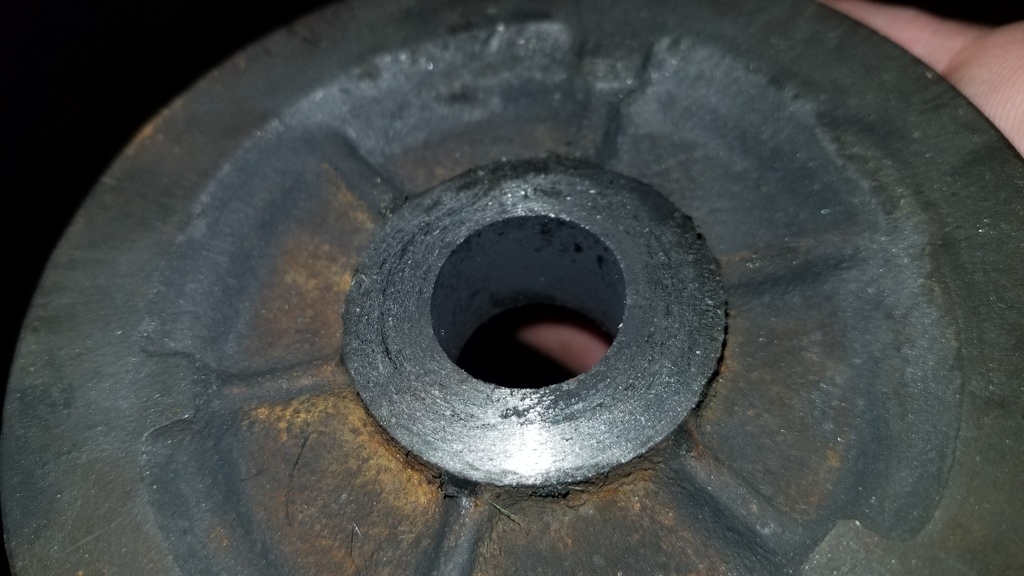

Here is the worn section of the pulley, and what I believe used to be a double "D" shape to fit on the mower shaft pictured above.
If you have some replacement parts that would be great! But I may also be interested in a whole deck you happen to have options.
Thanks.

ACman
All three of mine have a different attachment point as far as spindles and pulleys being the same I haven't got a clue . This ones off a1276 I know it mows but has a hole in the side .
The other two have the rounded belt guards like yours . One of them is on my 1057 . Its  super quiet and has one rust hole . The one on a Commando 8 . I don't see any holes in that one but haven't herd it run .

Ed Kennell
I'll check my DD pulleys tomorrow.
I have considered boring out the center and welding in two DD washers, but never actually tried it.

Ed Kennell

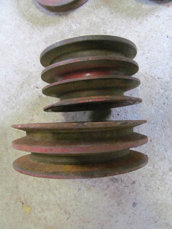

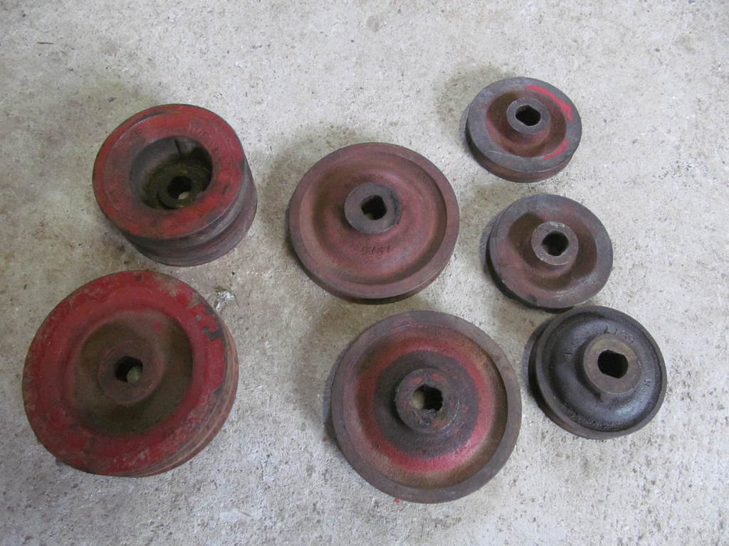

OK, here are the DD pulleys I have.
Send me a PM if you are interested in any.
IMG_7993.JPG.918eefc67871141020bcb94703da595d.JPGIMG_7994.JPG.a990dae405611a6e15b3b566b2739965.JPG
  The deck shown here is actually the one I prefer. The side drive takes a shorter and cheaper drive belt, the pulleys are probably cast iron, and the spindles are steel and easy to remove. I think I see a grease nipple to the discharge side of the pulley and there is a little pipe under the deck that takes the grease to the spindle.  I certainly could use another deck like this on a tractor that came without one. In all probability, the blades are double D with the DD hole in the center and two holes to the side that fit on drive pins. These blades can still be bought in the aftermarket
 Whatever you do, do not throw that deck away. It looks like a good candidate for a rebuild. On Edit:  I see that the belt guards are sealed over the top of the spindles. so i am certain that they grease from the side
Edited by ohiofarmer
  • Like 3
Ed Kennell
:text-yeahthat:      That is the deck I have on my Raider 12 and it has the cast DD pulleys and the greasable   spindles.     The shells are well built and deep so there is very little blow out of grass.    This is one of my best decks.   My only complaint was the single roller in front  allowed scalping when making turns on hilly lawns, so I added a anti scalp roller on each front corner.    BTW, the deck is designed for the older side drive swing arm. but works equally well on the current front mule drive system.
Edited by Ed Kennell

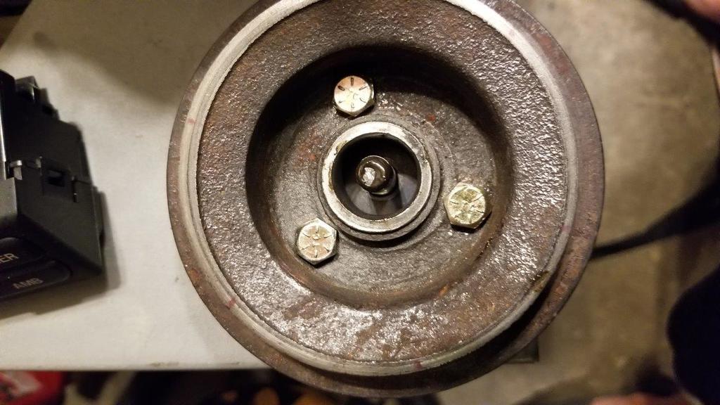

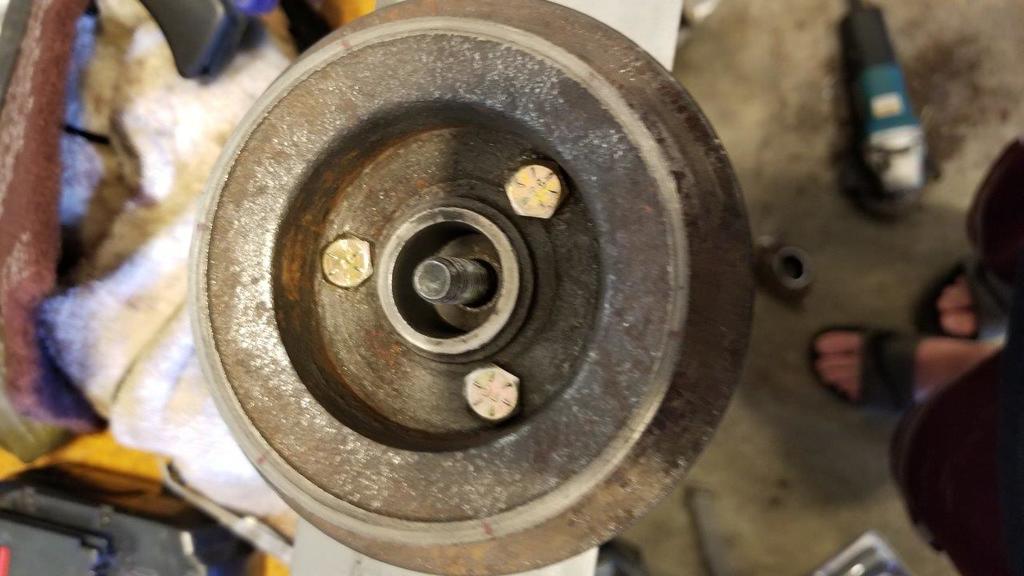

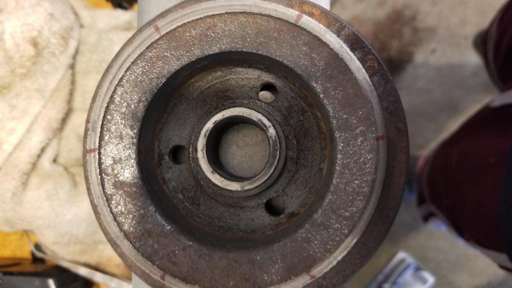

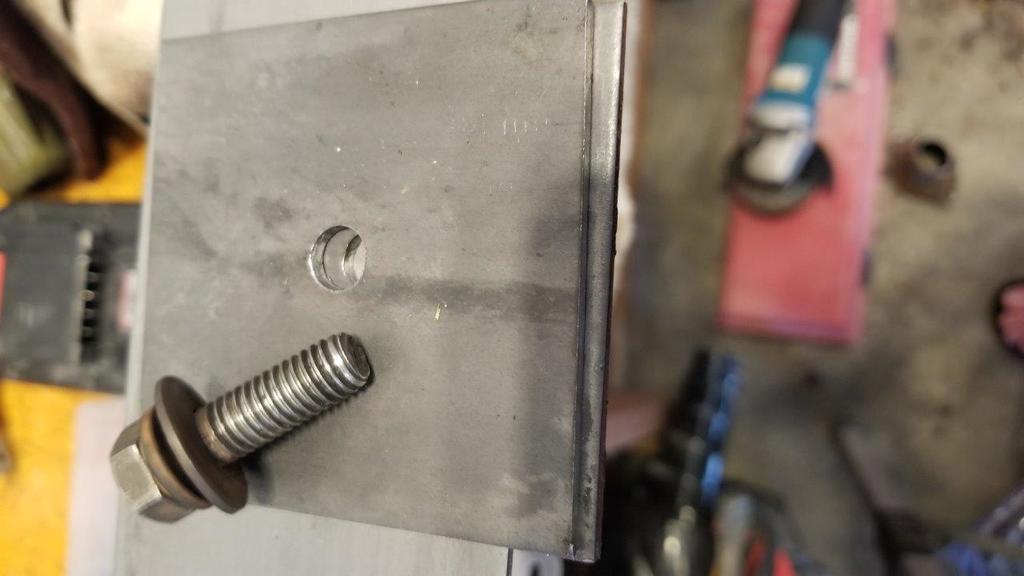

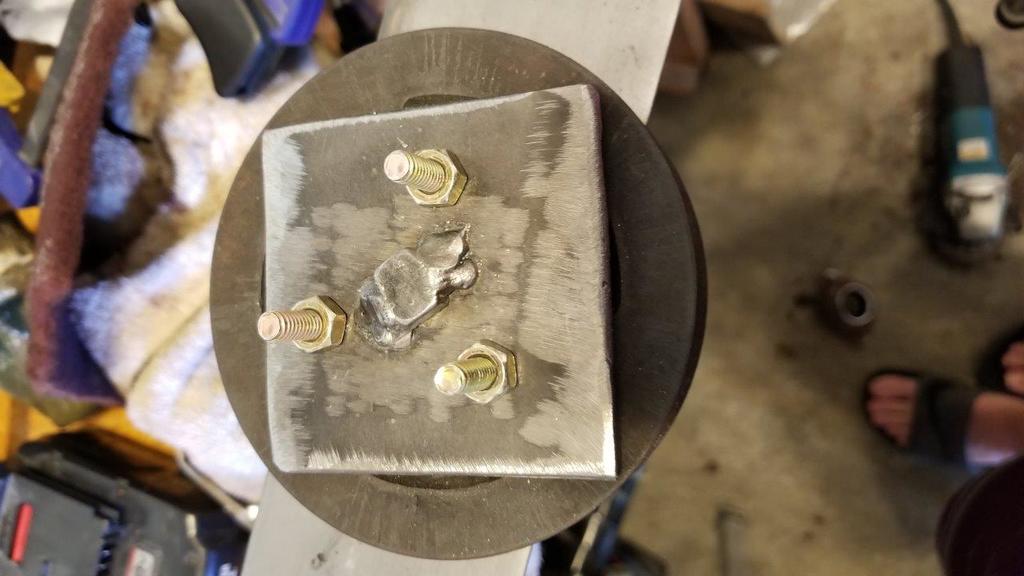

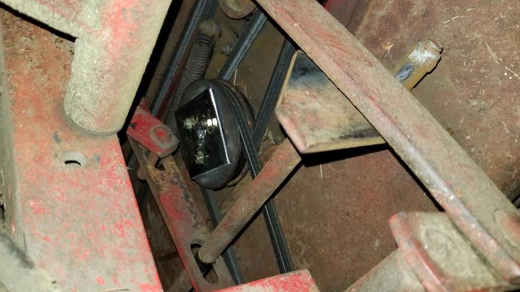

Hey guys,
Just thought I would give a little update on the damaged pulley situation. I mentioned that I was going to work on a temporary fix to try and save the rounded out pulley. I have completed that fix, and have successfully completed a full mow with the modifications. In case anyone is interested, here is what I did.
First I took the damaged pulley and drilled 3 holes all the way through centering the hole in the groove on the pulley. This allows for the heads of some bolts I will add to press flatly against the pulley surface.
I then used the existing spindle bolt, and drilled a hole through 2 3/16" steel plates that I made. The corners of the steel plates touch the edges of the pulley outside diameter. I took the 2 plates shown below, and welded them together for a little extra rigidity.
I then welded the spindle bolt to the steel plates, and drilled some holes to match the holes that I drilled into the pulley. This allowed me to put 3 bolts and nuts through the pulley and secure it to the steel plate and screw combo I made. I made sure the spindle bolt was as centered as possible to the center hole in the pulley. Finished assembly shown below.
I finally had to cut the excess bolt off of the new fixture and install back onto the mower deck. Here is the final assembly shown below.
I don't know how long this will last, or if it is the best solution for this type of problem, but it has worked for me so far, and was a worthwhile attempt at saving the pulley since I could not find a new one. Thanks for all of the previous help as well!

Ed Kennell
Looks good....keep us posted on the long term results.   So you have basically made a pulley with a center stud that screws on to the spindle.
My only concern is the stud is now transferring all the torque from the pulley to the spindle and is probably the weak link.
I know WH at some point ended the DD system and went to a keyed pulley/spindle. And after that, they eliminated the keys and relied only on the center bolt to create enough  friction between the pulley and spindle faces to lock the two together.   Your fix is not too far from that.
ACman
I see there's a deck for sale near you but it's a rear dish charge but your ingenuity with basic tools you might have found a solution :handgestures-thumbupright:!
If that does'nt work ...could you leave the center bolt out weld two tabs of metal on your plate to fit the flats of the spindle. Weld tabs to bottom of spindle too along with your three bolts . Slide pulley over and bolt the spindle back on . If that makes any sense  :blink: ?
  • Like 1
Hoffertot
I take it you mean to basically make a plate bolted on the top and bottom of the spindle like i have but with the double D shape cut into them correct? If so, I would assume it would work especially having steel on steel instead of cast iron. Although you would lose surface area, so you may risk rounding out again and potentially damaging the spindle shaft.
If this rig ends up breaking and I still haven't come up with another solution yet, I'll have to look into something like this :)
Thanks
Also, what are you using to check what's for sale in my area?
ACman
@Hoffertot your same design with the one plate on to but with two pieces of metal welded  to the bottom of your plate . These pieces would fit through your rounded out hole riding on the flats of the double d spindle . It would be tricky to get a good tight fit , heck fill the sides (between the pulley and your two pieces of metal) with JB weld . Then bolt your pulley back on . I'll send a pm with link to deck but I always search using "wheel horse" and another with one word "wheelhorse" . I also always search forsale "all" as people put things under antiques , collectibles and such .
