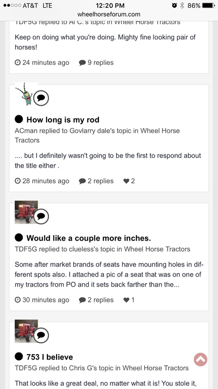

19richie66 17,936 #6 Posted July 19, 2017 Well imagine checking the "new content" posts and seeing these two come up in this order 11 Share this post Link to post Share on other sites

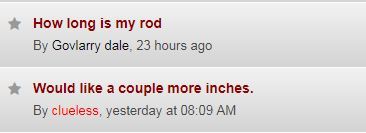

CasualObserver 3,416 #9 Posted July 20, 2017 just had to put these two posts back side by side 7 Share this post Link to post Share on other sites

tunahead72 2,662 #13 Posted July 20, 2017 5 hours ago, CasualObserver said: just had to put these two posts back side by side How about this one Jason? http://www.wheelhorseforum.com/topic/27060-how-do-you-measure-your-deck/ And what Jim just said is so true! 2 Share this post Link to post Share on other sites

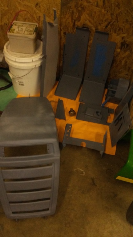

Govlarry dale 34 #16 Posted July 20, 2017 Thanks sarge....buy unfortunately thats my problem now just finding a good machine shop. I have a guy that done a lot motor cycle work for me but he wont do small engine work. So if anyone know of one around Kalamazoo Mi. Let me know.... And pictures well i dis just get started but heres one....thanks 7 Share this post Link to post Share on other sites
