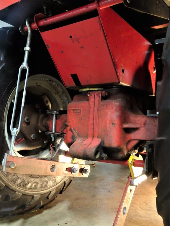

giddyap 1,574 #65 Posted December 22, 2020 After my post #46 failure and before I proceed, will this set-up pass Physics 101? Share this post Link to post Share on other sites
DennisThornton 4,773 #66 Posted December 22, 2020 44 minutes ago, giddyap said: After my post #46 failure and before I proceed, will this set-up pass Physics 101? I'll have to keep an eye on this. 1 Share this post Link to post Share on other sites
ebinmaine 76,978 #67 Posted December 22, 2020 58 minutes ago, giddyap said: After my post #46 failure and before I proceed, will this set-up pass Physics 101? I'm no engineer but I'm going to go ahead and throw out an answer. Please feel free to correct me if I'm not stating this quite right... I'd say that if you're going to hang the weight in between the turnbuckle and the three-quarter rod that holds the plow, you alleviated the lever and fulcrum situation and spread the weight more accordingly between the two points. HOWEVER! The fact that there's a fair amount of weight hanging off the top where thin sheet metal is doing all the support does not exactly make me feel warm and fuzzy. The physically thickest and logically strongest place on the back of the transmission is going to be where the hitch pin should go through at the bottom corner. The tab that goes forward on the stock type hitch could be reinforced or weight spread side to side with a cross bar so as to avoid cracking of the case. The biggest heaviest hitches that I've seen utilize the 2" square where the plow is mounted and also the rear hitch pin area. On my own tractor I have a hitch that bolts four and aft and I fabbed up a couple of plow mounts that couple to it on the front of the two inch square. 1 Share this post Link to post Share on other sites

giddyap 1,574 #70 Posted December 22, 2020 2 hours ago, ebinmaine said: weight hanging off the top where thin sheet metal is doing all the support does not exactly make me feel warm and fuzzy. I agree, so I will add support and run a 1/2" bar thru the box to hang the flat white bar replacing the turnbuckles. BTW this addition as described is possible on this C-81, 8 speed because I removed the wrap around gas tank and added the box from an older model to support the seat pan that pivots up and back . 1 1 Share this post Link to post Share on other sites

Handy Don 15,725 #72 Posted December 22, 2020 (edited) 2 hours ago, ebinmaine said: I'm no engineer but I'm going to go ahead and throw out an answer. Please feel free to correct me if I'm not stating this quite right... I'd say that if you're going to hang the weight in between the turnbuckle and the three-quarter rod that holds the plow, you alleviated the lever and fulcrum situation and spread the weight more accordingly between the two points. HOWEVER! The fact that there's a fair amount of weight hanging off the top where thin sheet metal is doing all the support does not exactly make me feel warm and fuzzy. The physically thickest and logically strongest place on the back of the transmission is going to be where the hitch pin should go through at the bottom corner. The tab that goes forward on the stock type hitch could be reinforced or weight spread side to side with a cross bar so as to avoid cracking of the case. The biggest heaviest hitches that I've seen utilize the 2" square where the plow is mounted and also the rear hitch pin area. On my own tractor I have a hitch that bolts four and aft and I fabbed up a couple of plow mounts that couple to it on the front of the two inch square. I agree with the concern about the the upper bar being attached to the tractor by relatively thin sheet metal. Take a look at how Lowell designed the hitch he sells at wheelhorsepartsandmore.com He uses a combination of the axle housing section of the transaxle and the drawbar hitch. He makes sure the weight is distributed--onto the axle castings using the bolt on clamps, and onto that lower hitch by welding the support arms going to the drawbar pin directly to the 2" receiver hitch tube. Another idea is a thread that showed a member who bolted an extension to his plow frame and put weights on that extension--again, putting the load onto the axle casing portions of the transaxle. No doubt what you have in your latest image can work. The question is how much weight will you want it to support? Edited December 22, 2020 by Handy Don 1 Share this post Link to post Share on other sites

elcamino/wheelhorse 9,363 #74 Posted December 22, 2020 @giddyap I like your current design , give it a try. I don't know how much weight you are going to hang on it , but in my ole redneck brain I think it will work. 1 Share this post Link to post Share on other sites
giddyap 1,574 #75 Posted December 22, 2020 12 minutes ago, Handy Don said: your latest image can work. The question is how much weight will you want it to support? I think this will support enough weight to help plowing snow 2 minutes ago, ebinmaine said: @Lee1977 maybe? An extension to the plow frame would be a fulcrum and lever (I think) Share this post Link to post Share on other sites
