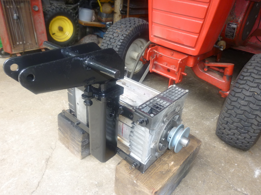

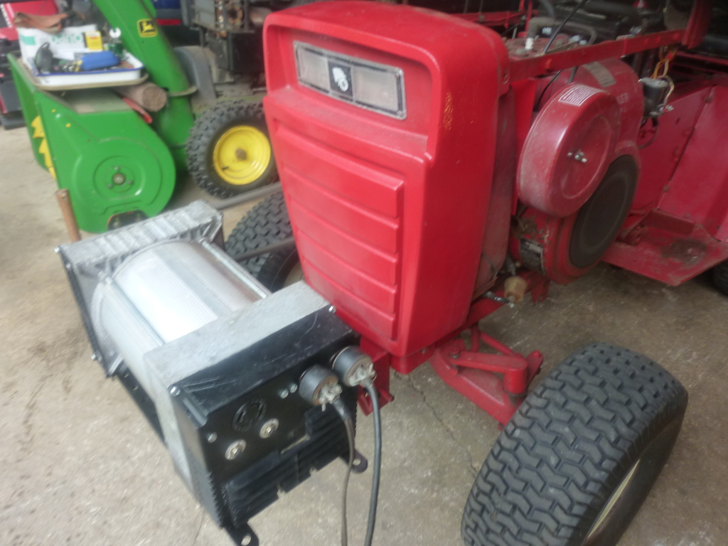

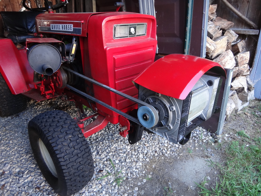

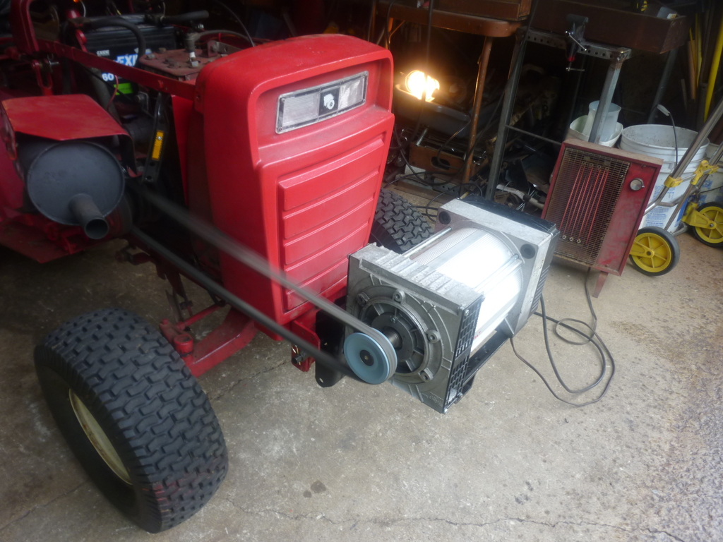

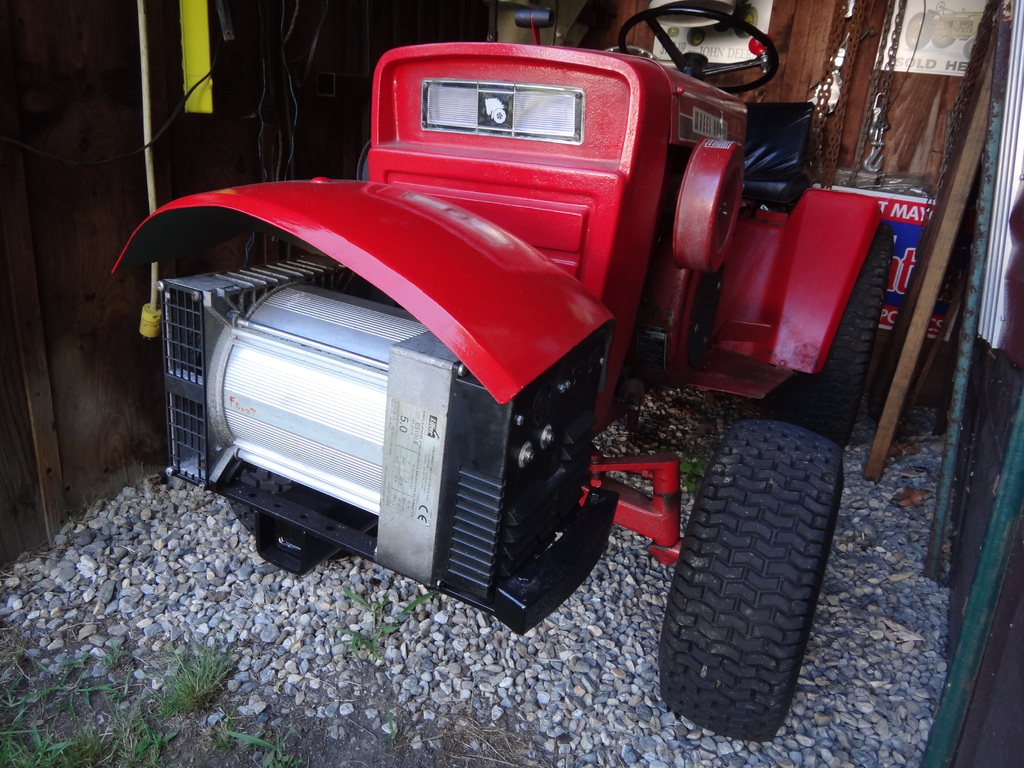

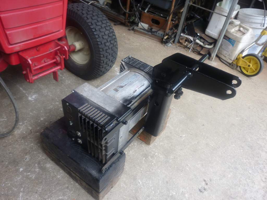

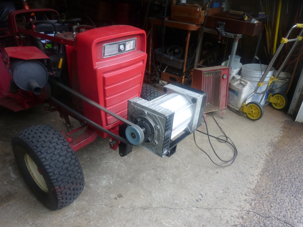

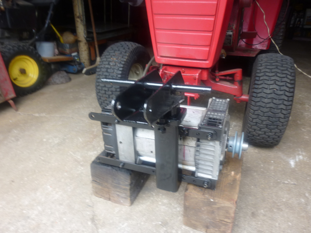

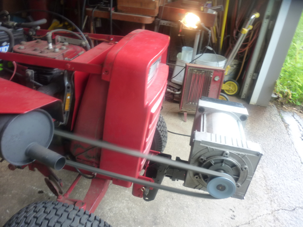

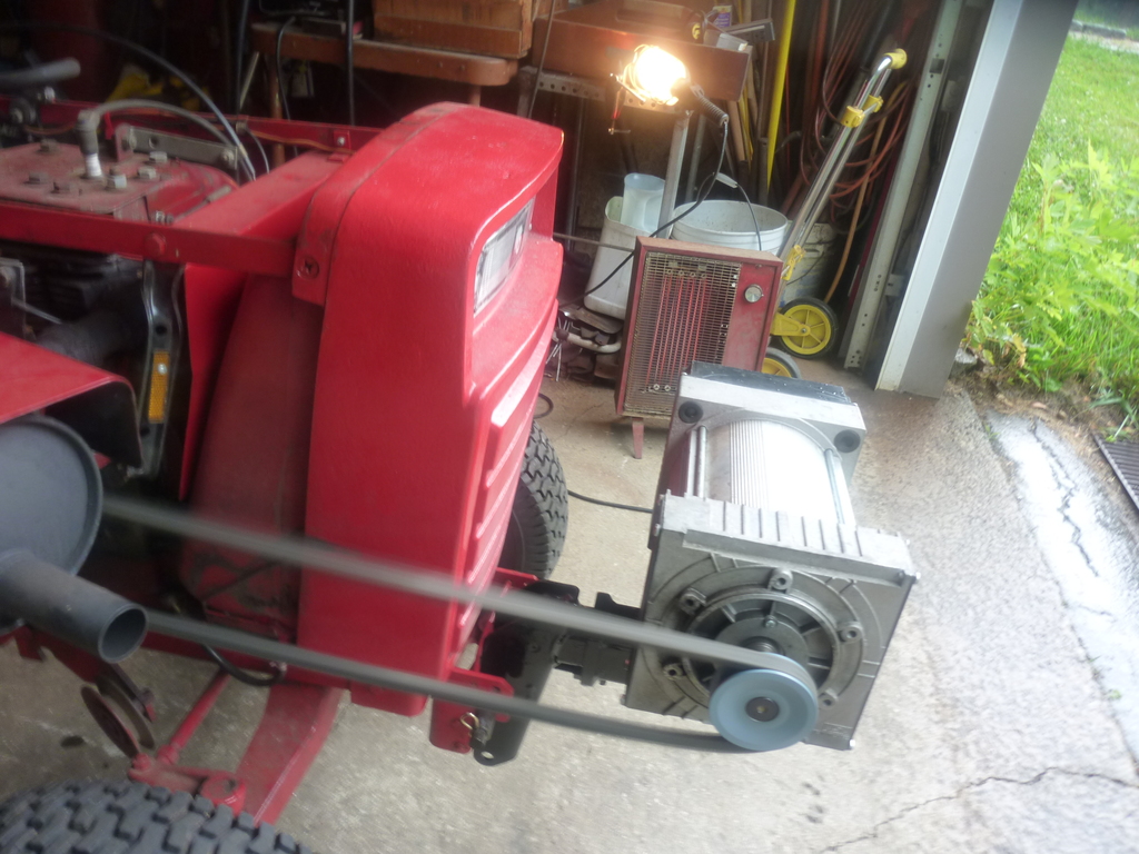

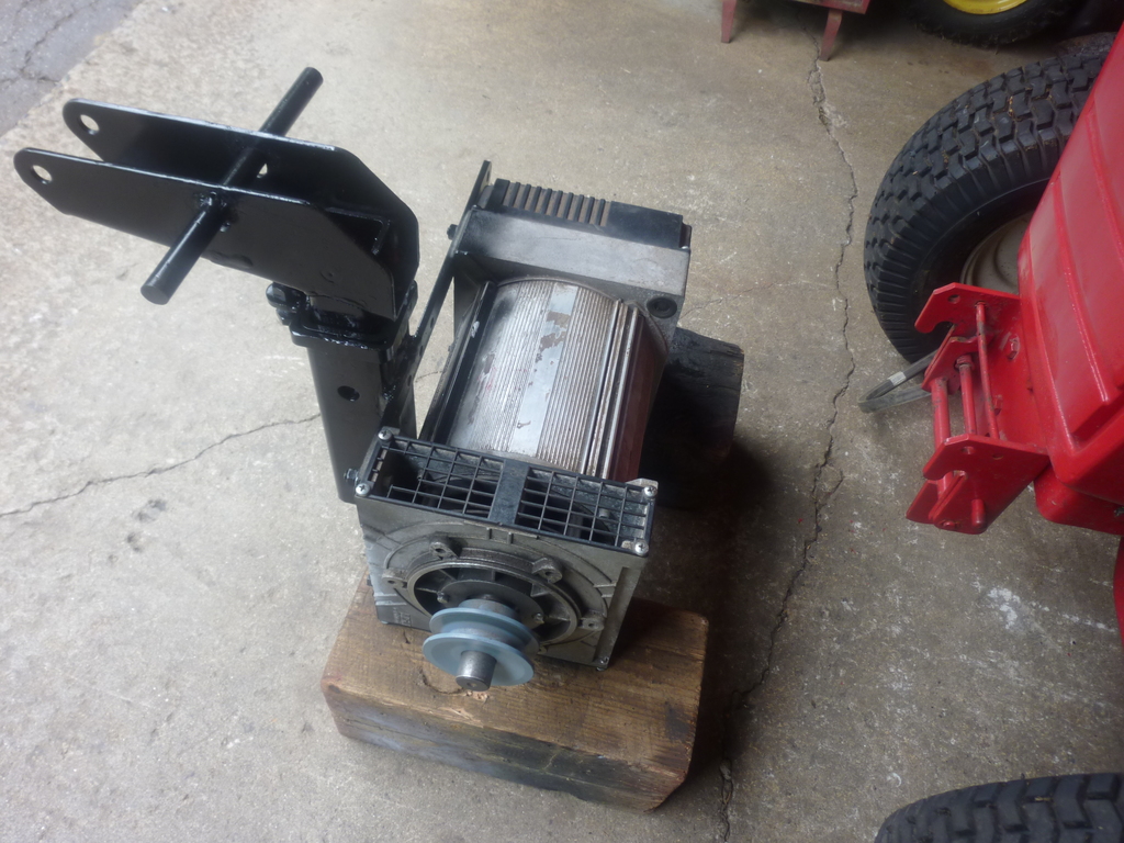

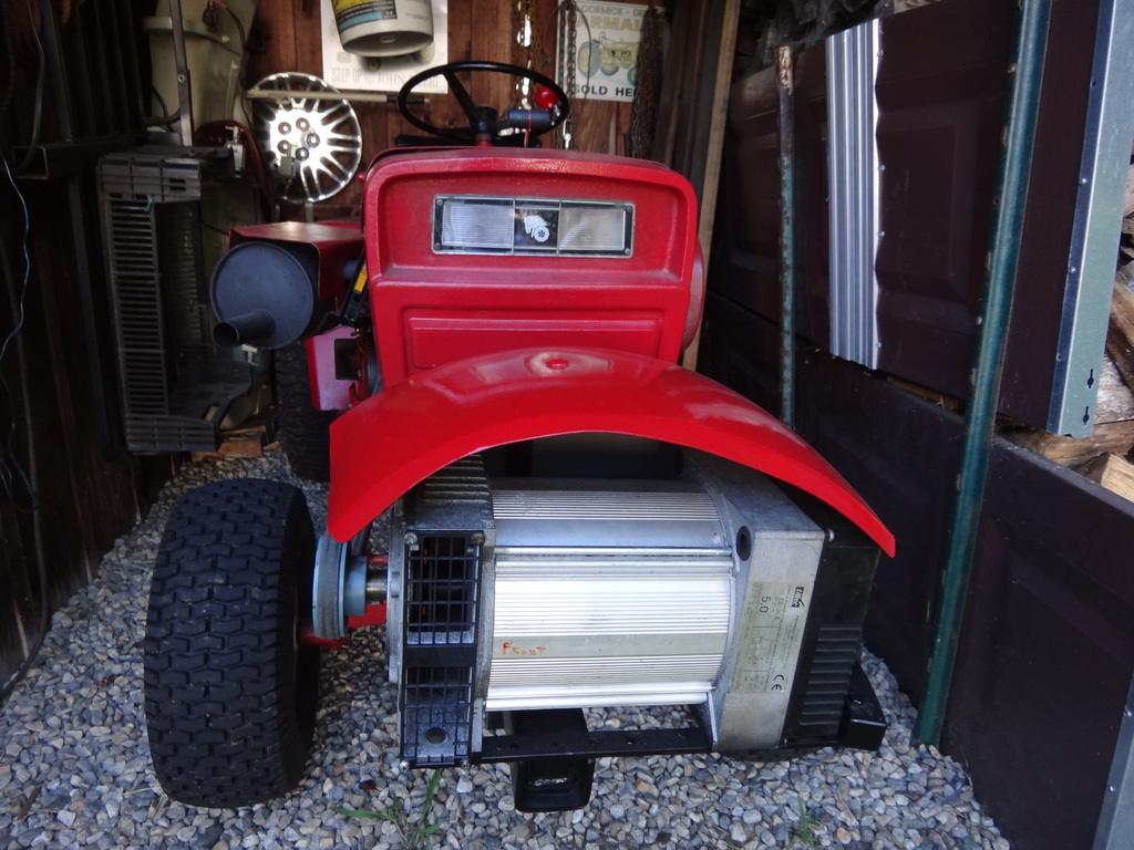

Rob R 989 #14 Posted June 27, 2017 How about a Harbor Freight Gen Set for Portable power and outages...... 9 Share this post Link to post Share on other sites
19richie66 17,936 #15 Posted June 28, 2017 I would like to see more of this tractor Share this post Link to post Share on other sites
Sarge 3,473 #16 Posted June 29, 2017 Is that the 10kw head ? I've been considering getting one just to have it for outages and occasionally running my welder when doing portable jobs - just been hesitant due to it's price range and reliability being unknown ..? Northern Tool and others sell a similar one for around $900 , rated at like 40a @220v , which is what I need to run the tig/stick Miller and other tools . That ditch mower is a cool idea - using a 2 stroke solves a lot of issues for those kind of slopes for sure . Friend of mine mows a cemetary next to a highway near me , slopes are almost 1:1 and his favorite tool is an old aluminum Eclipse push mower - does a great job . Sarge Share this post Link to post Share on other sites

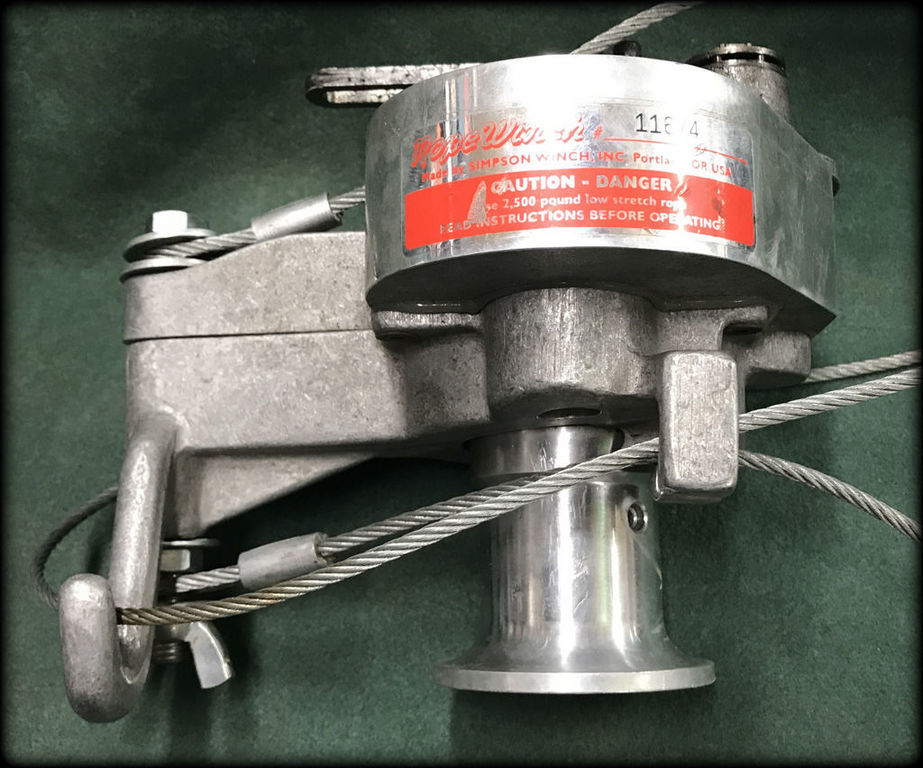

jebeli 21 #17 Posted July 4, 2017 I would like to see a capstan winch that runs off the pto. It could mount in front or in the back. I would use this for dragging logs, loading trailers and getting unstuck from the mud. 3 Share this post Link to post Share on other sites
wallfish 20,622 #18 Posted July 4, 2017 14 minutes ago, jebeli said: I would like to see a capstan winch that runs off the pto. It could mount in front or in the back. I would use this for dragging logs, loading trailers and getting unstuck from the mud. Maybe adapt a chainsaw winch to the front and run it off a belt. 3 Share this post Link to post Share on other sites

gwest_ca-(File Mod) 12,489 #20 Posted December 15, 2020 Good illustration of a drive belt under tension with a load. Demonstrates why idler pulleys are always on the slack side of a belt. 2 Share this post Link to post Share on other sites
DennisThornton 4,773 #21 Posted December 15, 2020 4 hours ago, ebinmaine said: Found this thread whilst poking about lookin for something else. Thought maybe it needed to popped up to the forefront. Any new ideas? I've always wanted a BIG air compressor! I could drive one off my NH PTO but how about a WH front mounted like the generator? 16-18 HP should crank out some CFMs. Just mount a purchased compressor or what about converting an engine to a compressor. 1 Share this post Link to post Share on other sites
