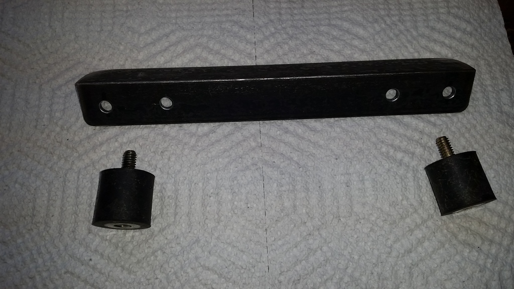

WHX?? 58,347 #1 Posted May 9, 2017 (edited) So here is a bracket I am making for a project. Gotta be the easiest I have ever made. Anybody care to guess what it is for? There is one guy here who knows what it's for so he is excluded from this contest and if he spills the beans no adult beverages for him for the whole '17 tractor show season! Contest winner gets the usual famous autographed pic of @squonk looking like a vagrant at the bus stop. By the way this is not an original design, I stole it from the aforementioned member who is in grave danger of having a very dry tractor show season. Also by the way most of us horse heads have needed this as it is ALWAYs missing, broken, busted or rotted out on a new to me tractor. If there is one it is usually affixed to tractor with baling wire, coat hanger or some other type of PO nonsense. I have been know to go years with out one but this is a special project. Starts out with these three simple pieces. A short length of 1 or 3/4 inch angle & two rubber isolation mounts. These mounts are pretty common and can be had just about anywhere online. I had a few on the shelf from bike builds where they are used quite a bit. They are 1/4-20 threads and can be had male/male, female/male, female/female. Round the corners of the angle off as much or little as desired. Sharp edges are to be avoided as well as lawsuits for a bad design and avoidance of workman's comps claims. Edited May 9, 2017 by WHX11 speeling 4 Share this post Link to post Share on other sites

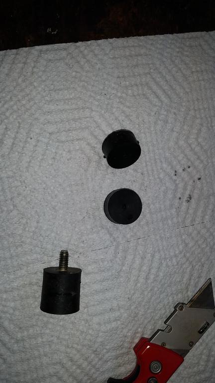

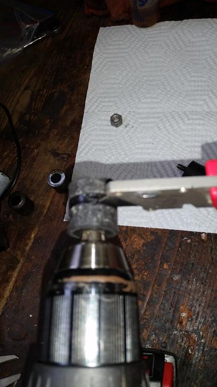

WHX?? 58,347 #2 Posted May 9, 2017 (edited) The iso mounts get cut in about half or whatever length you need. Chuck them up in your cordless and use a sharp utility knife to cut them. A couple of drops of motor oil and they will trim through slicker than cat scat on linoleum. Keep both halves to make another one. Again be careful with the knife, safety first cause I ain't sending my personal nurse over to poultice you. Tune in tomorrow for the next episode... Watching paint to dry! Edited May 9, 2017 by WHX11 5 Share this post Link to post Share on other sites

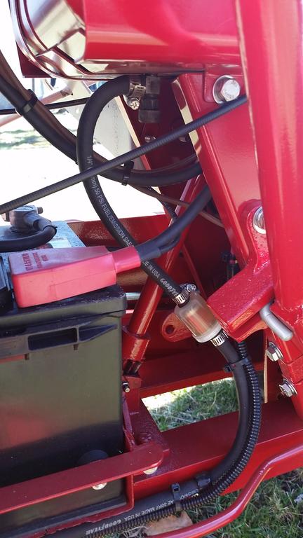

WHX?? 58,347 #19 Posted May 10, 2017 This is on Dan's 1076 and I took this pic to plagurize his wiring & gas line routing but then spied the show battery hold in! I'll get some better pics up when my paint is dry. Will also put up some tips on how to weld new studs on that tray that always seem to be gone. I had made one out of flat steel like orginal but liked his better and took it off and put it on the 1257.... I told you fellas they are often missing! Trading tip here Dan Take a short piece of 3/8" gas line or tubeing and cut it to slip on the bottom end of the lift lever stop for a nice cushion. @Achto 9 Share this post Link to post Share on other sites
