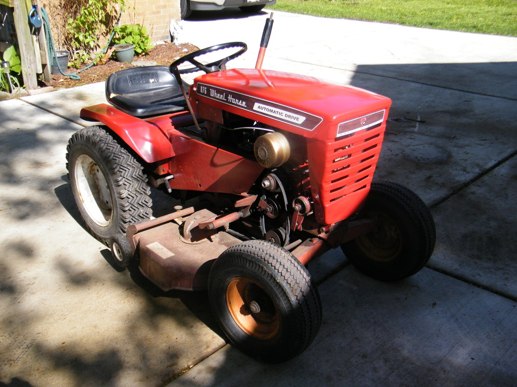

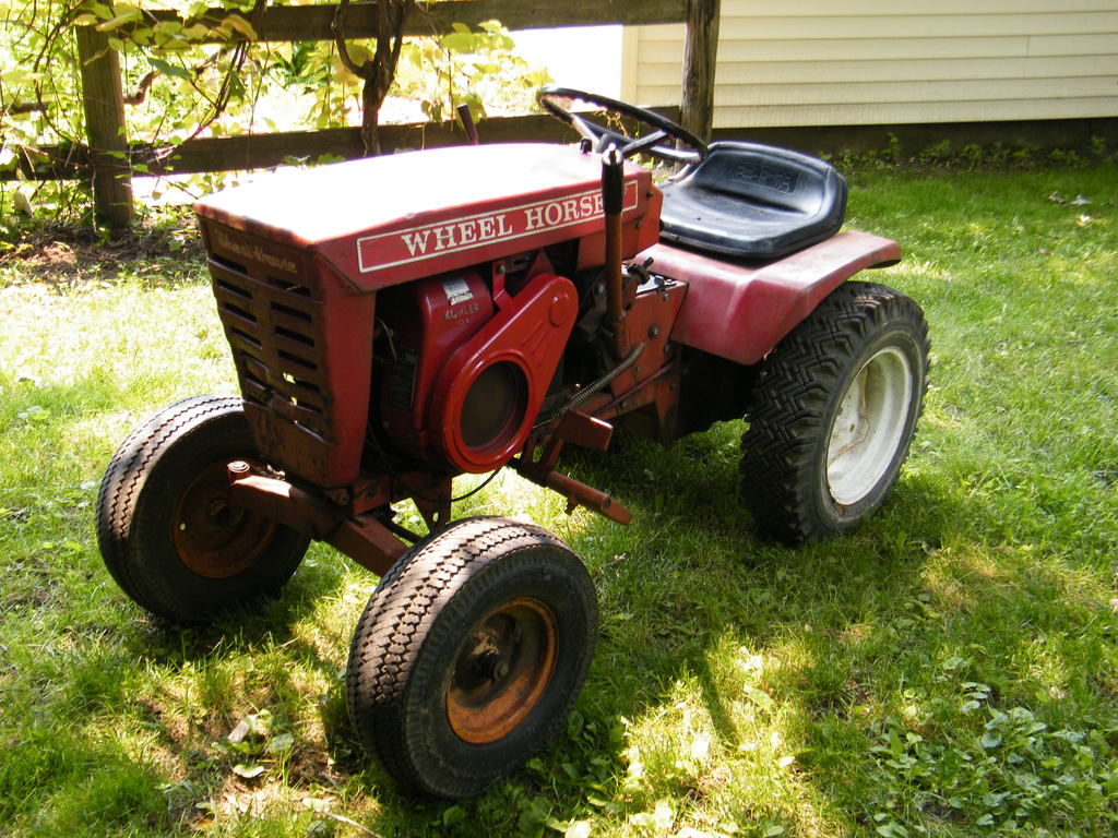

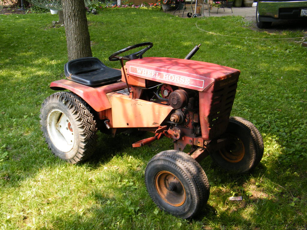

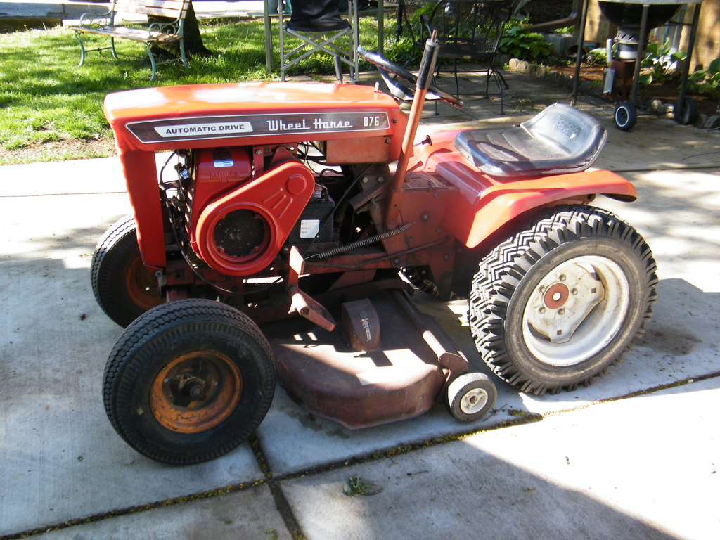

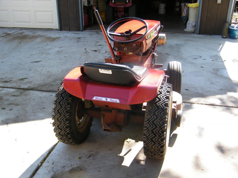

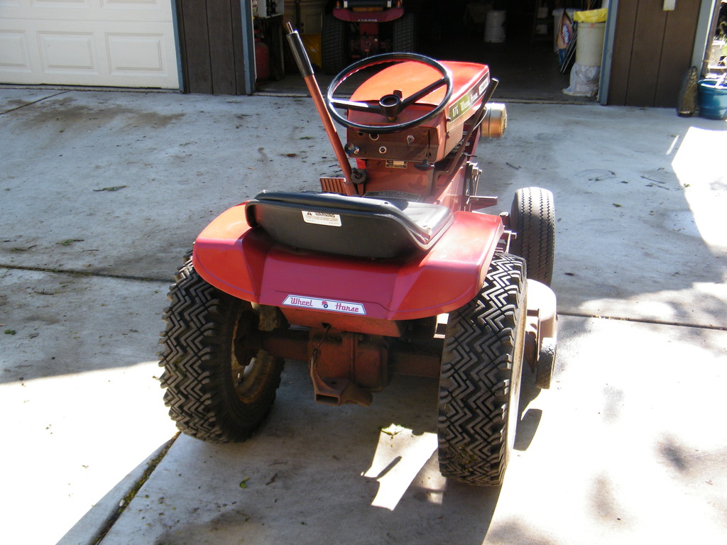

stevasaurus 23,884 #13 Posted May 6, 2017 I am going to check and change the oil. I was thinking some gas could have gotten in the crank case. I now have a few hours on this newly rebuilt engine that it should be changed anyway. Thanks Slim. Mike, I just bought this horse from SmokinJoe two falls ago. I have not put an inline filter on this horse yet. This is something I was going to do with the 1st oil change. One will be inline before the carburetor goes back on. BTW, I got my new stickers for this horse from Terry on Wednesday and I put them on the 876 yesterday. Here is a shot. It is a 5' paint job. I have to paint the rims yet also. BEFORE:: AFTER:: 6 Share this post Link to post Share on other sites

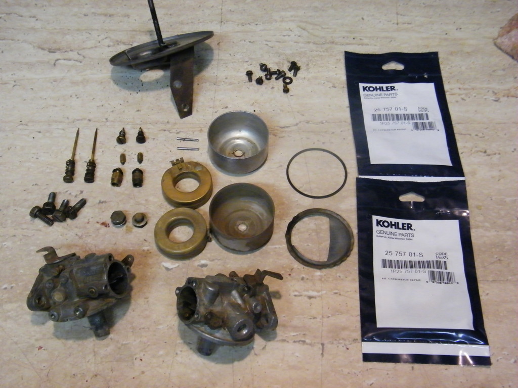

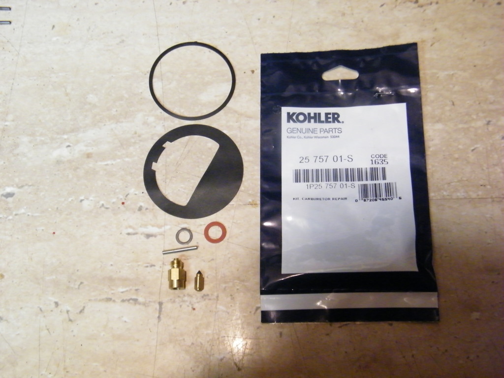

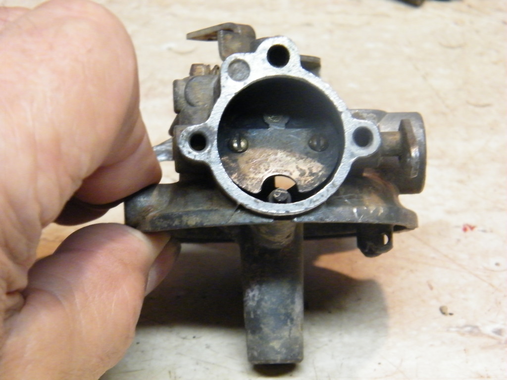

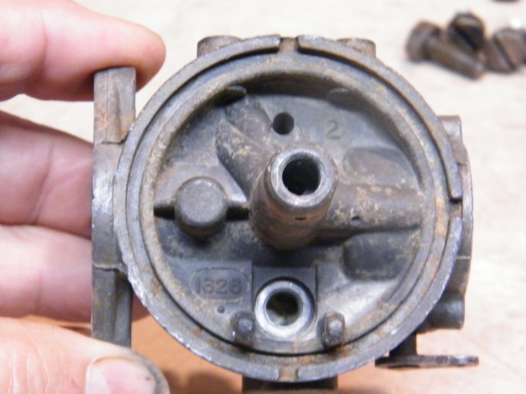

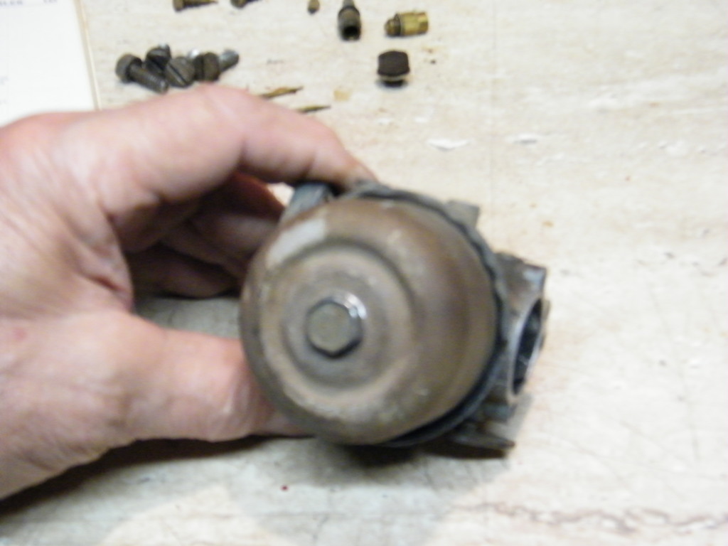

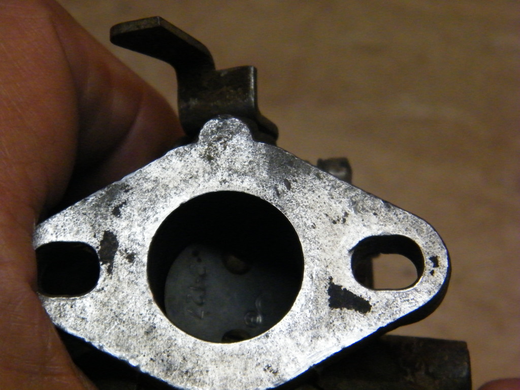

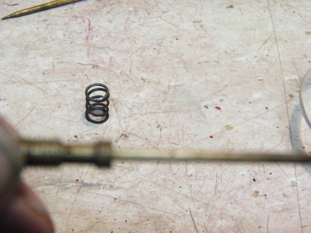

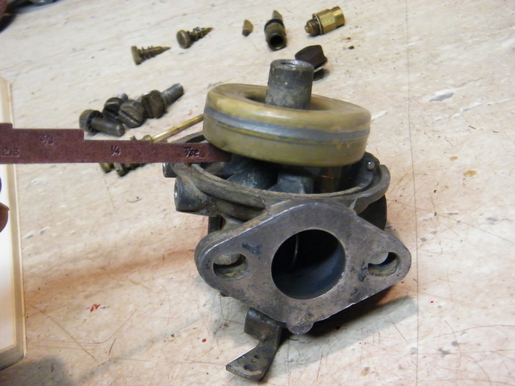

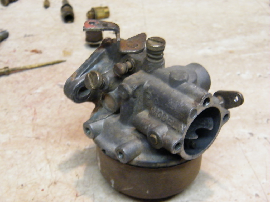

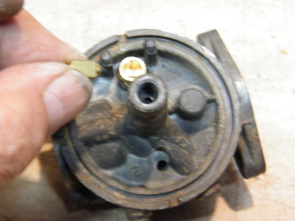

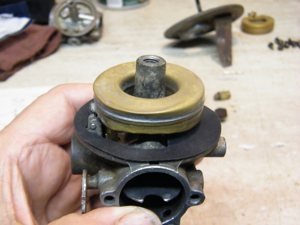

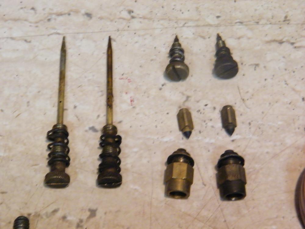

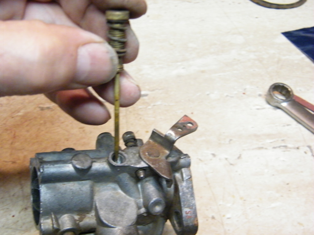

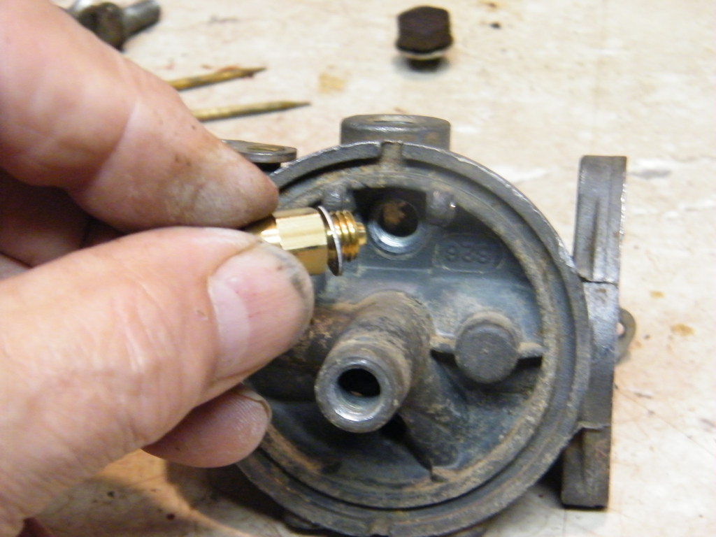

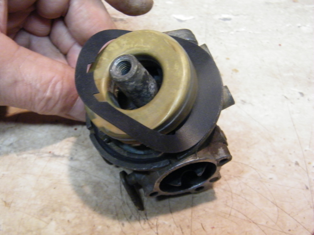

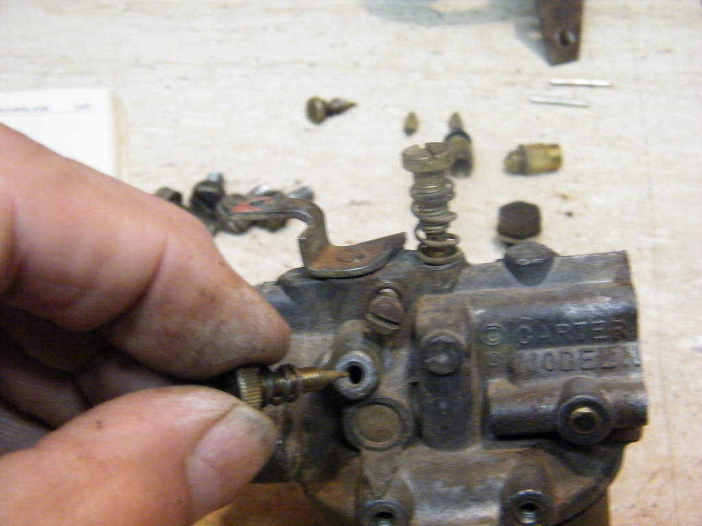

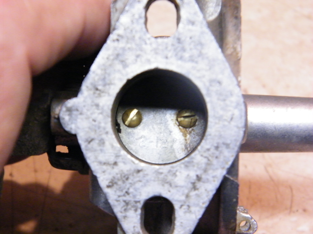

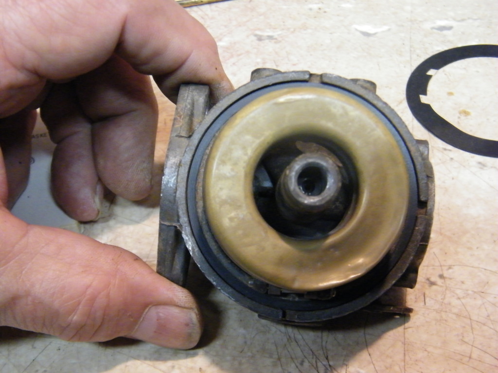

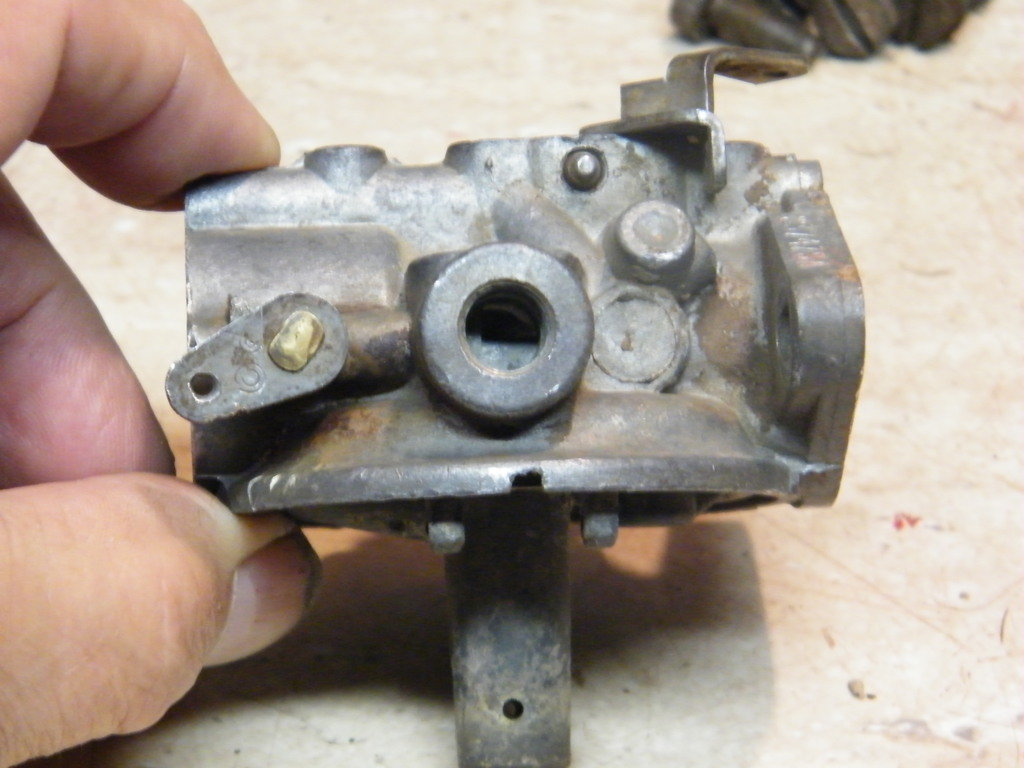

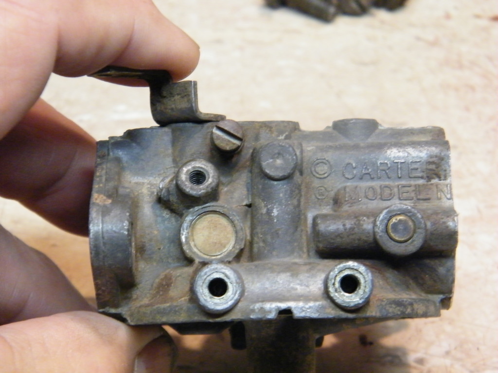

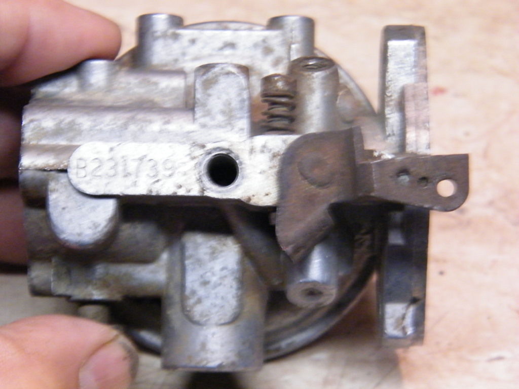

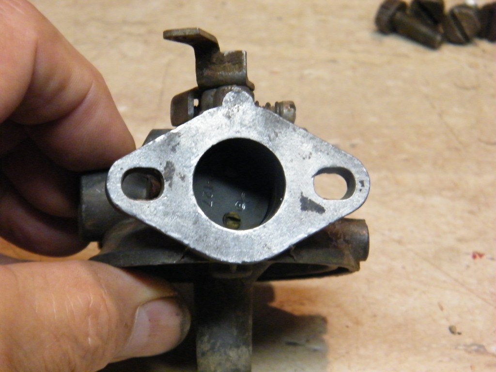

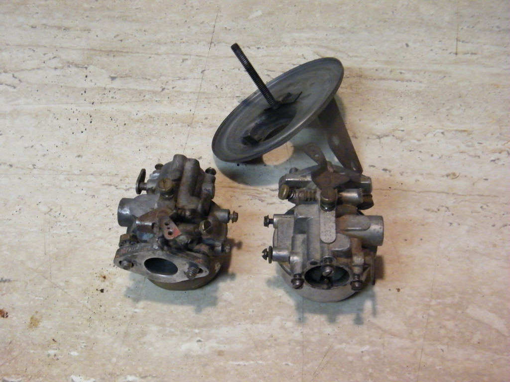

stevasaurus 23,884 #15 Posted May 9, 2017 Well gentlemen, rebuilding that carburetor solved the problem. She runs like brand new now and even with a load. I did change the oil also...we do think it had some gas in it. I've rebuilt single, double and 4 barrel carburetors before, but these Carter "N"s are way to easy to not do one yourself. Here are the pictures. Actually, I had bought a spare K181 8hp from @Shynon last year for parts, and it turns out to be a good thing I did. It also had a Carter "N" on it that looked pretty dirty, so I decided to rebuild both of them. That is why in the 1st picture, you are seeing double. Yep, that is all the parts in one of these carburetors. Here are some pictures of all the sides of this carb so it is easy to identify. The fuel idle screw (long one), the low idle screw (top right), the needle sut off valve and the brass fitting the shut off goes into. There are some holes in the long screw that you should poke a wire through along with some carb clean to make sure they are open. If you have a throttle that is hunting, one of these holes clogged could be the reason. Here is what comes in the kit. The needle shut off and brass fitting, the gasket for this brass fitting, the bar that holds the float in the carb, the gasket for the little bolt that holds the bowl on the carb, and the 2 gaskets that go between the carb and the bowl. The kits are Kohler and cost about $13 apiece on E-Bay. Here are the instructions, according to Mr. Chilton, Put in the brass piece that holds the seat...and the seat. Next is the float and check the measurement. Place the round gasket in the carb groove. Next is the bowl gasket baffle. Place bowl on and place and tighten holding bolt. Last, place the main fuel adjusting needle...gently turn in until it bottoms out...then back out 2 turns. Now the idle fuel adjusting needle...again, bottom out and then back out 1 1/4 turns. There you have it...mount on horse...start her up, and when warm do the final adjustments. Mine wanted to hunt when I 1st started it...turning out the main fuel adjusting needle about another 1/2 turn fixed that. 2 good carburetors. 5 1 Share this post Link to post Share on other sites

stevasaurus 23,884 #19 Posted May 9, 2017 I had a bottle of Carb Cleaner Gas Treatment that I soaked everything in. Used a wire tooth brush, rinsed with water and blew out with air hose. They are clean. 3 Share this post Link to post Share on other sites
buckrancher 2,697 #20 Posted May 10, 2017 The one thing I would add is that the long needle is hollow and there is a small hole in the tapered end not just the holes in the side you should blow air up thru the body of the needle as I have found these clogged between the tapered end and the side holes Brian 1 Share this post Link to post Share on other sites
stevasaurus 23,884 #21 Posted May 10, 2017 Brian is absolutely correct. I tried to show that, but my camera could not focus it without blurring. Thanks Brian. 1 Share this post Link to post Share on other sites
rmaynard 17,642 #22 Posted August 24, 2022 On 5/9/2017 at 9:55 PM, buckrancher said: The one thing I would add is that the long needle is hollow and there is a small hole in the tapered end not just the holes in the side you should blow air up thru the body of the needle as I have found these clogged between the tapered end and the side holes While sitting here recovering from Covid, I decided to continue with rebuilding some old Carter carburetors that have been sitting around for years. I know that this is an old thread, but what Brian said above is probably the most important, and most missed part of cleaning or rebuilding a Carter carburetor. 3 1 Share this post Link to post Share on other sites
