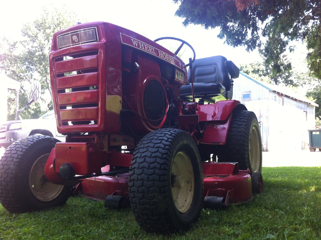

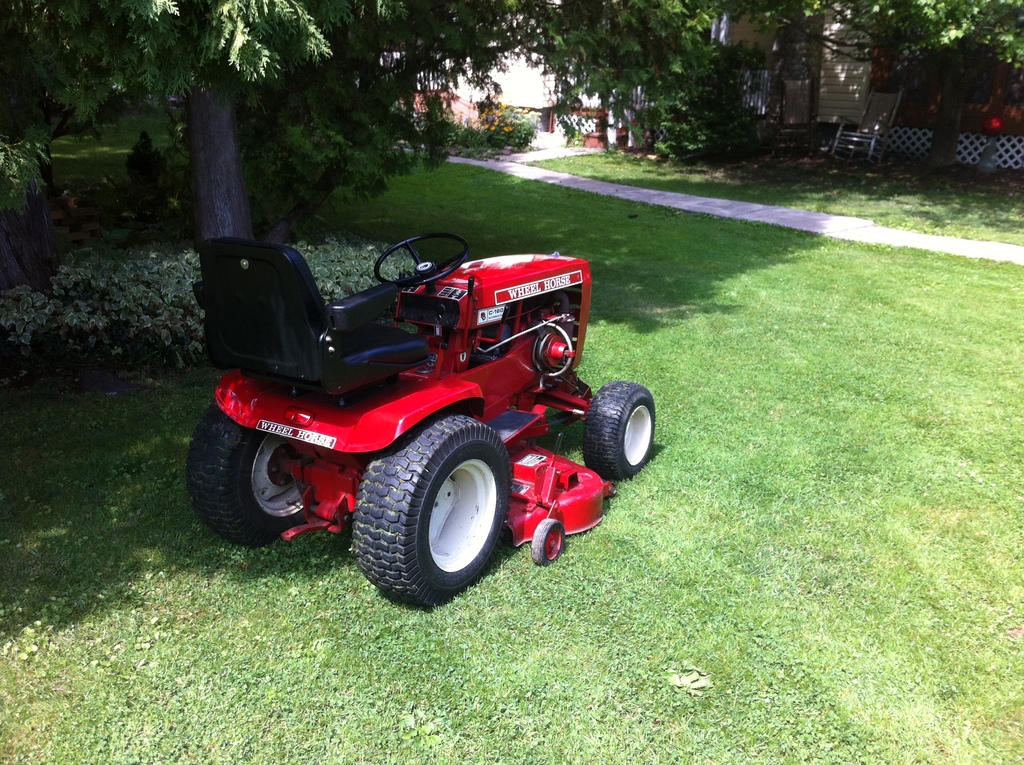

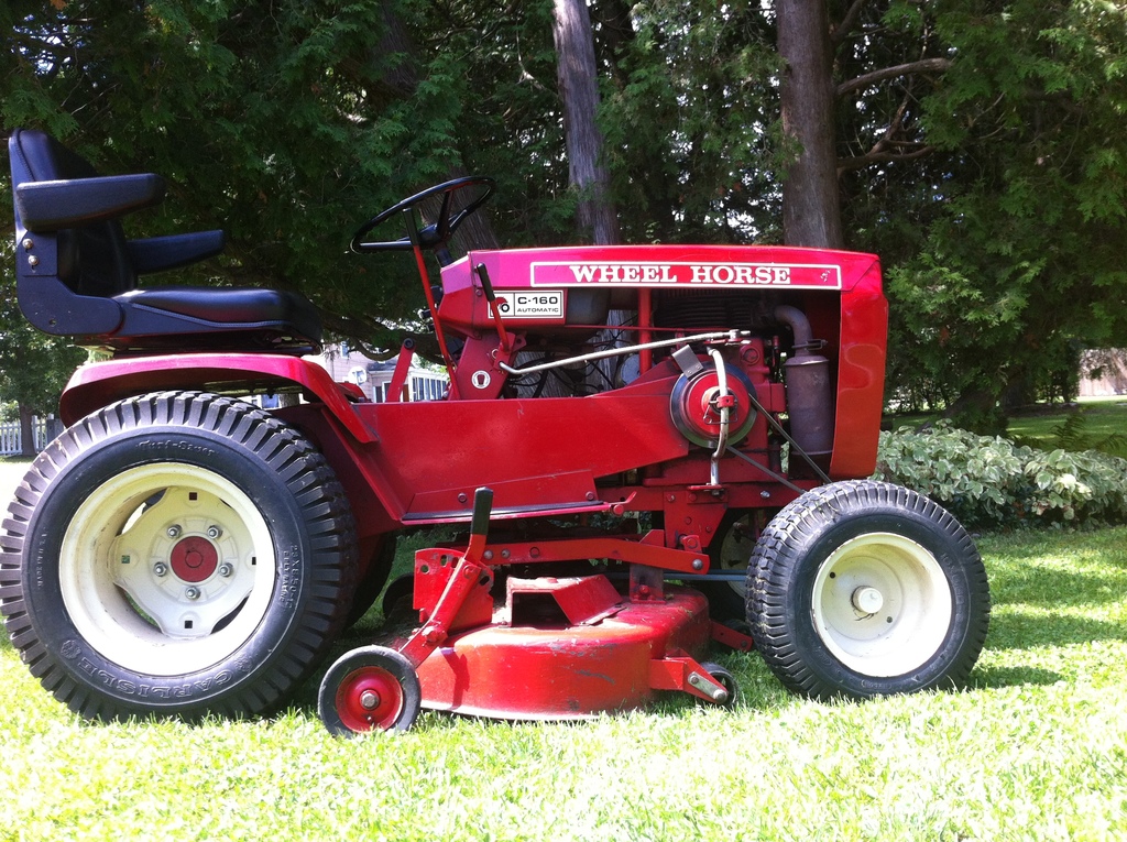

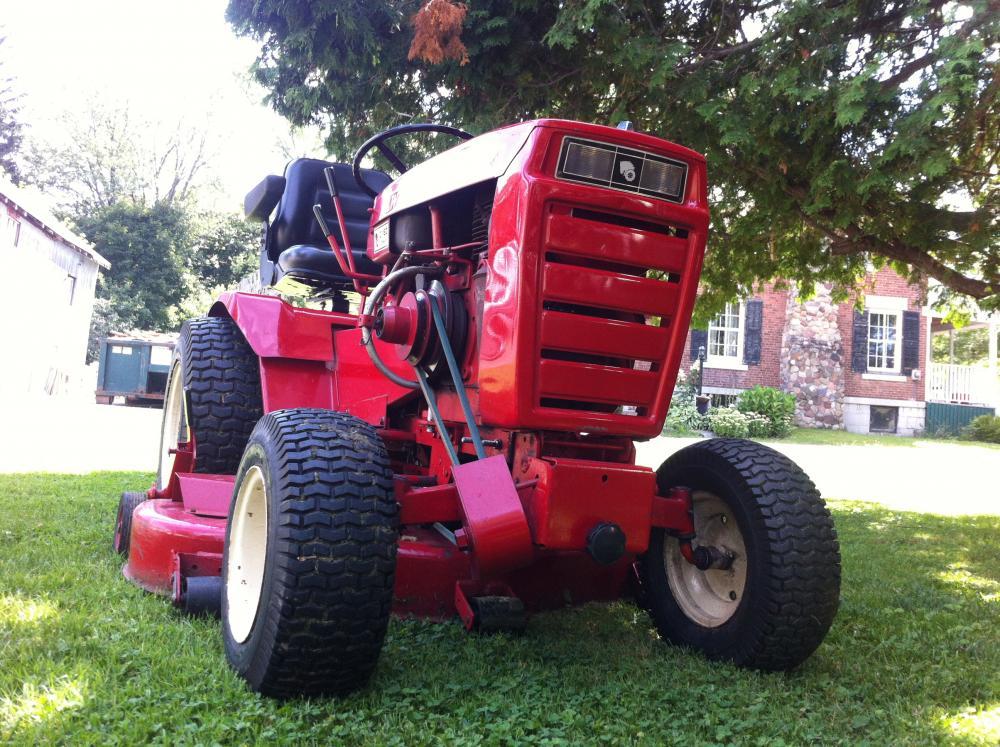

It should look like this, this is my C-120 Auto, the 160 should look basically the same, don't think they had an hour meter, just an ammeter...5906786526201_beastdeck001.thumb.JPG.362bad32852f7da7358b47c5802b5b8d.JPG590678a6c19c4_beastdeck002.thumb.JPG.1e4032a806a2ff21266e0e52272bc8b7.JPG
Almost forgot, :text-welcomeconfetti::rs:
Should be more pics in the picture gallery too...
  • Like 6

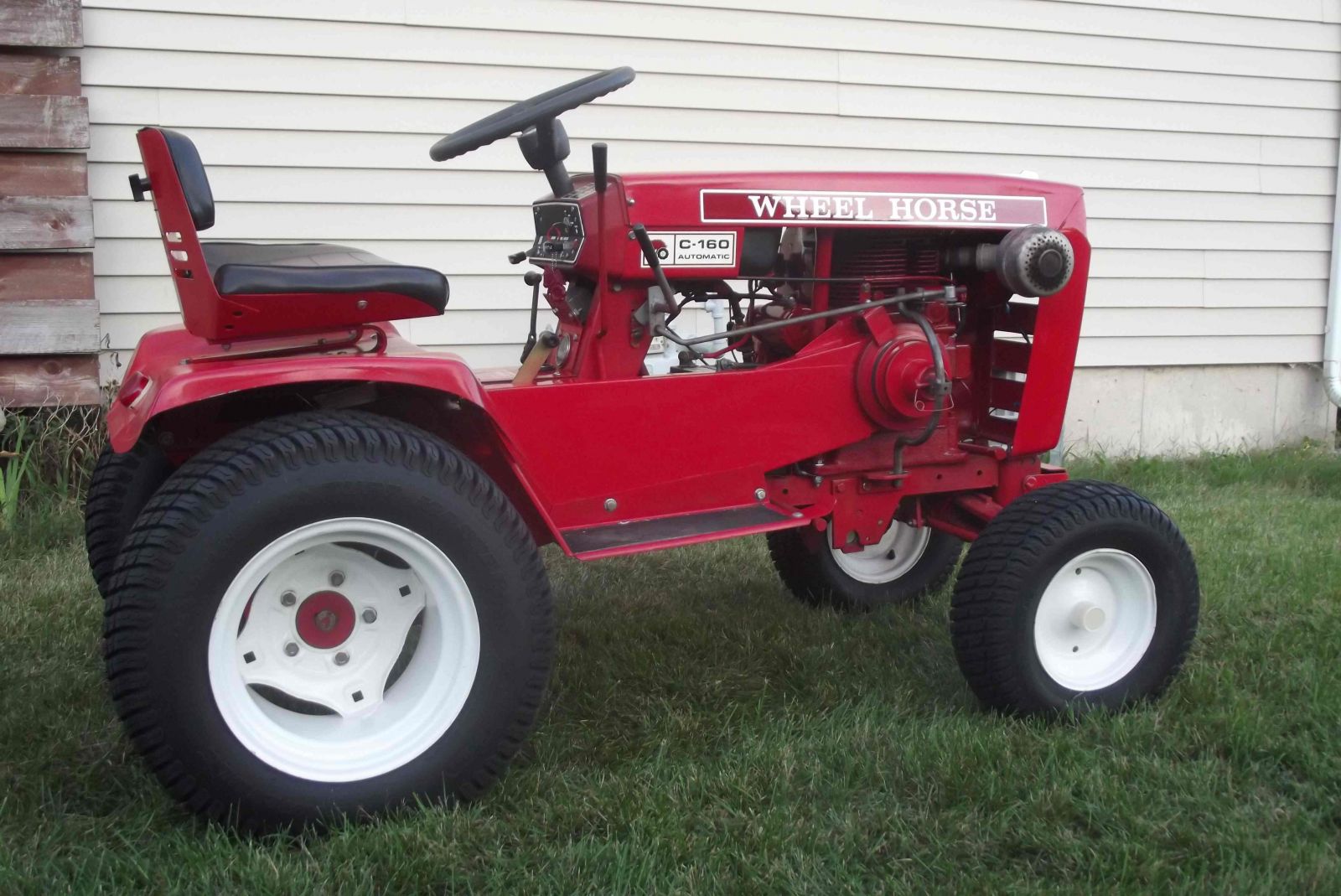

nylyon
Congratulations, the C-160 is a great machine. This one is a 1974, the seat and fenders open to the back, After 1975 the fenders are bolted down.

953 nut
:WRS:          Depending on the year the seat will change.
1975 C 160

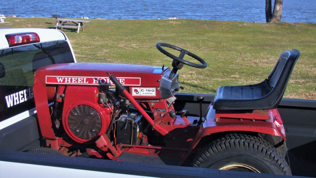

AMC RULES
A 1977 model here.
71-16K801 1977 C Series Garden Tractor C-160 8-Speed Kohler K341S-71128A 16 Wheel Horse 103907

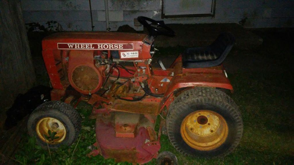

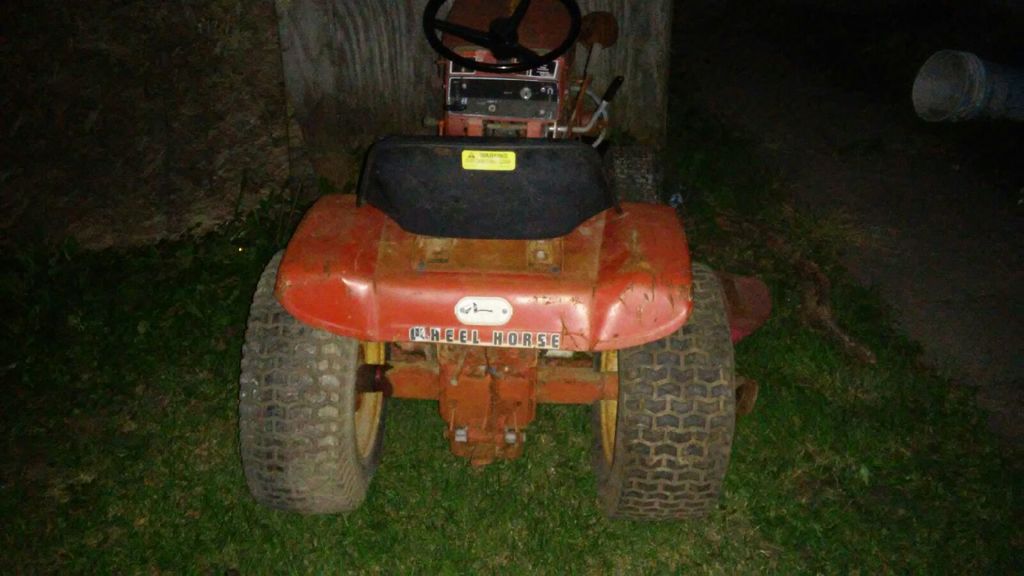

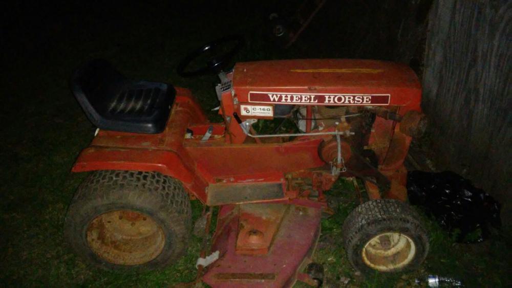

 Ok guys, my buddy sent me some pictures. They're not great but any info and input would be great! Thanks!
  • Like 8
608KEB
It's a 76 or 77. In 74 and 75 they came with a hour meter. I'm not sure about a hour meter standard on post 76 C-160's. The 74 n 75's the rear fender flips up. The post 76 the seat flips up, but not the rear fender. I would grab it quick. Good condition  C-160's are few and far. The rear decal is incorrect.

squonk
My 76 has both ammeter and hour meter and the fender pan does flip.

608KEB
Maybe some the 1975 parts carried in 1976. Not sure about that.

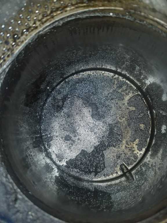

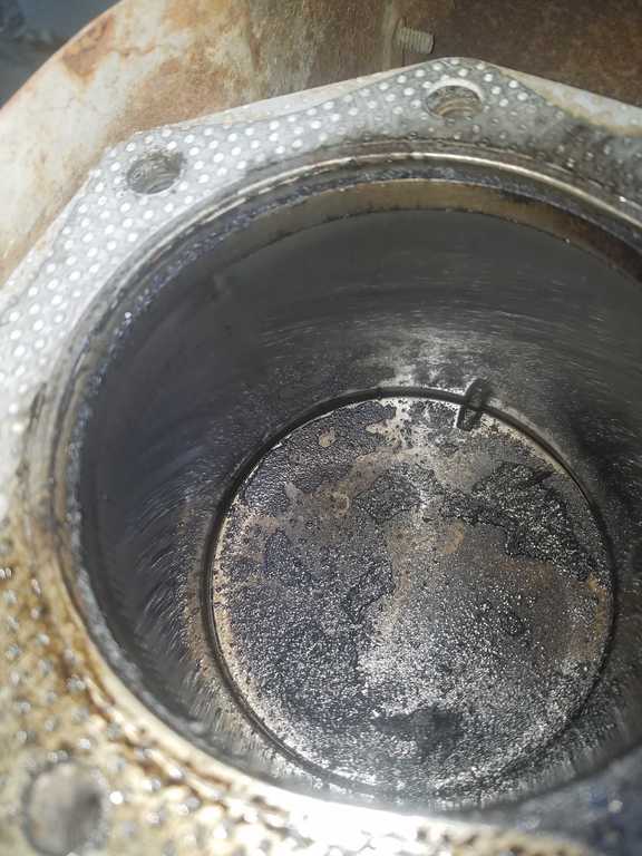

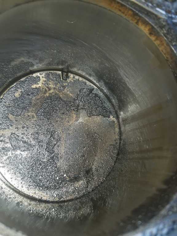

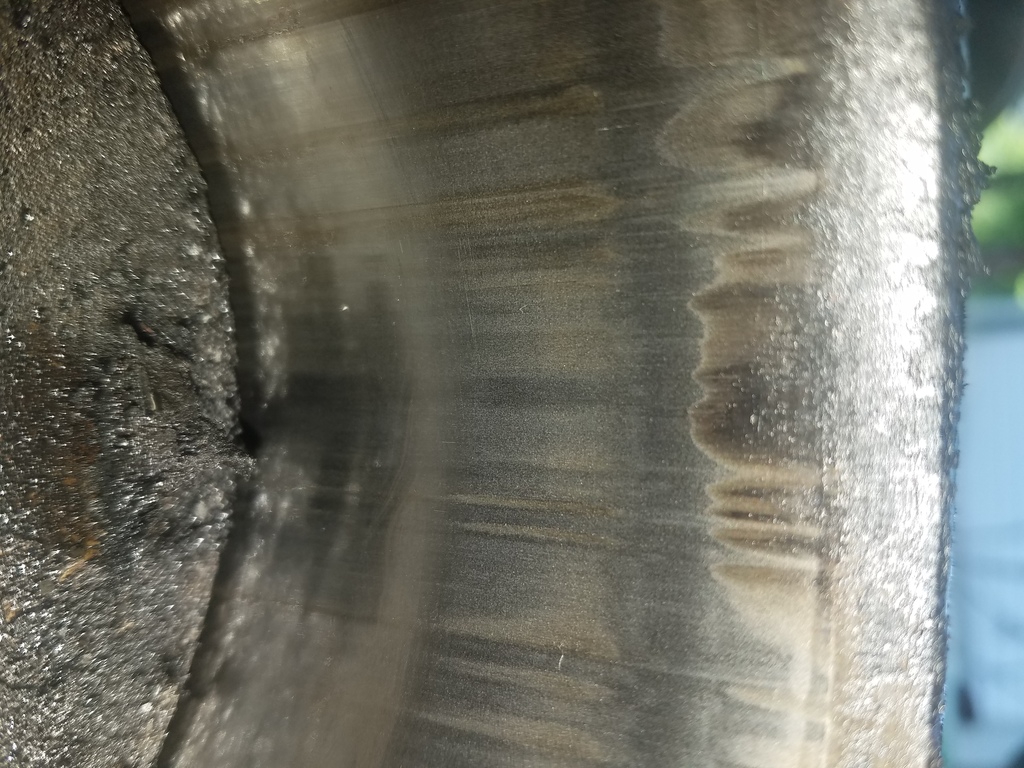

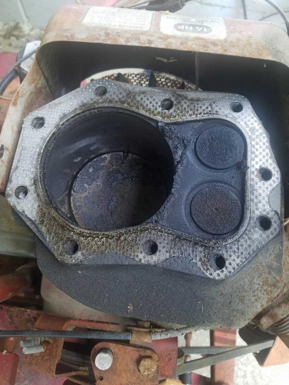

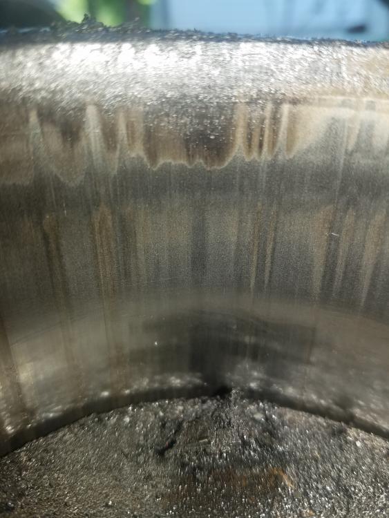

Well work has been crazy lately so I'm just now getting the head off the check the cylinder and valves. Let's just say that I'm in for more than I had hoped lol. Haven't mic'd the bore or piston yet but it looks like someone put the wrong piston in...

Racinbob
 'Officially' the 76's didn't have hood ornaments or flip back fenders but if they had the flip fenders and hoods with the ornament holes left over they used them on the 76's. That happened often and has made for some interesting variations not to mention driving us all nuts. :wacko:
Best to take it to a shop that can bore the block and ask them to measure it. before doing that you will want to check the crank too. Buy some green plastigage at an auto parts store and re install the rod cap with the green stuff to see how the crank looks. They are generally good but you need to know.
Emmy's Dad
Ya, called the local shop and they said between $75 and $90 depending on how far they need to go. Wasn't happy to find it but I can't exactly complain having paid nothing for it lol. Looks to me like someone had it bored over and then tried to use O/S rings on a Std. piston. I'll definitely be pulling the engine and checking the crank bc I have to basically strip the block for them to bore it. 20170522_105415.thumb.jpg.f2d9418d72442e2ebe25ea24406501d9.jpgWell work has been crazy lately so I'm just now getting the head off the check the cylinder and valves. Let's just say that I'm in for more than I had hoped lol. Haven't mic'd the bore or piston yet but it looks like someone put the wrong piston in...
