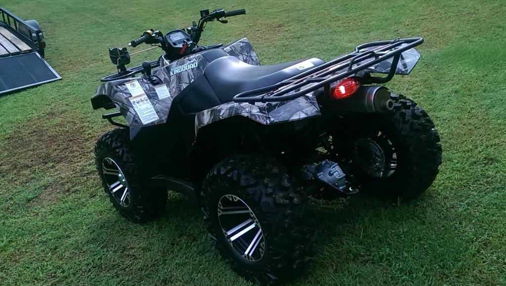

WVHillbilly520H

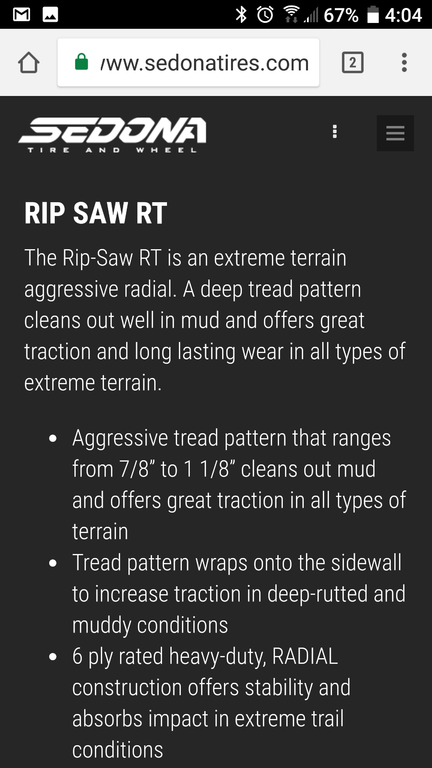

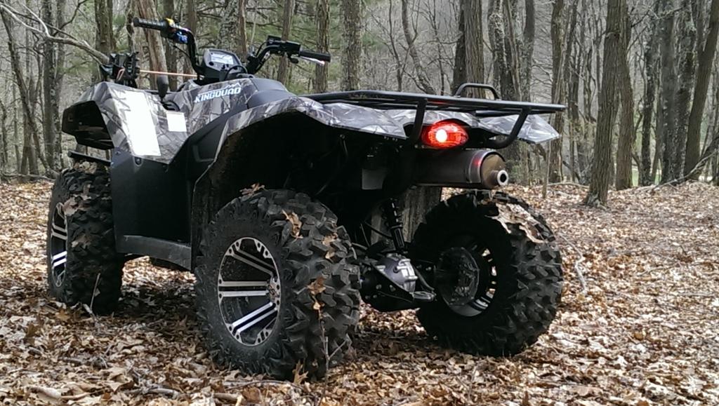

@littleredrider, check out these mudders on my ATV.
Edited by WVHillbilly520H

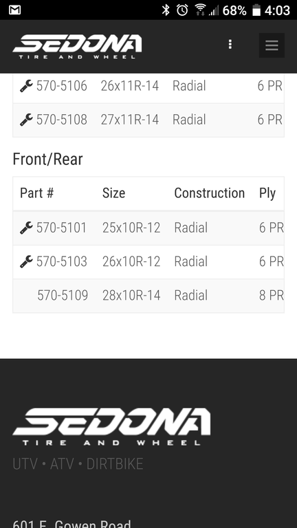

littleredrider
Ive seen those and definitely look aggressive. I had pitbull growlers on my old one, and they were the best all around tire I've ever owned hands down. Snow, mud, dirt, hard pack, any terrain they did excellent. They would throw mud 20' at least into the air. Course having almost a 100 horses helps lol....Only downfall of ATV tires is IIRC, nobody makes a 23-ish" tall tire that is wide. I  got mine pretty cheap, and so far I like them. Hoping on a wider wheel it will bring the height down....
WVHillbilly520H
Sedona Rip-Saw RT.

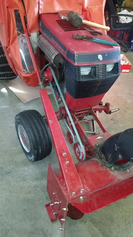

WVHillbilly520H

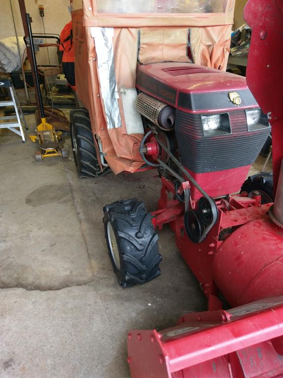

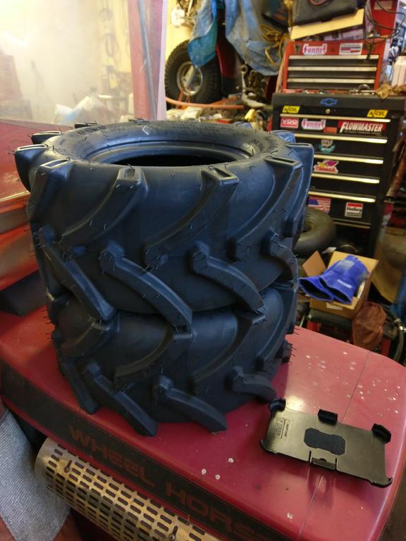

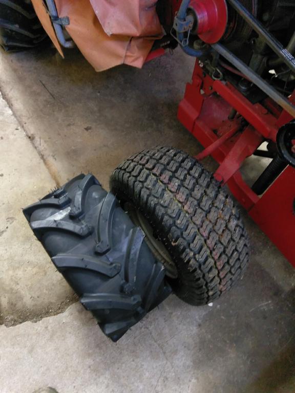

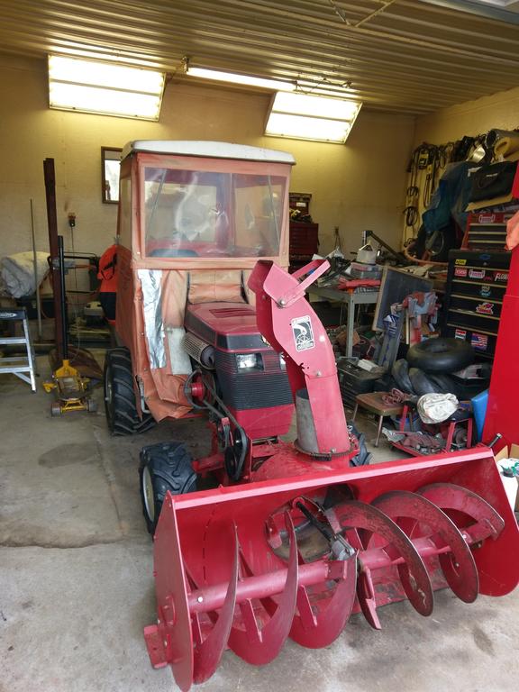

New matching pair for the front...OTR LAWN TRAC R1S 16x7.50-8...
  • Excellent 4
dells68
Looks like they are going to get a good try out tomorrow Jeff!  Good luck.  I’m just kind of jealous of that cab.  I brought my GT 14 home tonight with front blade, but I’ll just have to wrap up good!☃️☃️☃️☃️
  • Like 2
  • Thanks 1
WVHillbilly520H
I don't mind "plowing" without a cab but blowing almost requires a cab when the wind is swirling around.

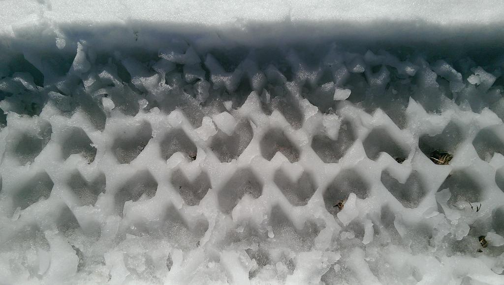

Today that 9" of powdery snow was quite slick but with these OTRs just never really lost their grip without chains pushing the big deuce around, and as far as steering not necessarily any better than the turfs I had on it last year but they definitely look cool, now the 520 with plow and Nanco AGs just didn't have the same grip I should have had chains on it but I have another pair of 23x10.50s OTRs ready to mount up on it as soon as I get a chance and we'll see how it does then.

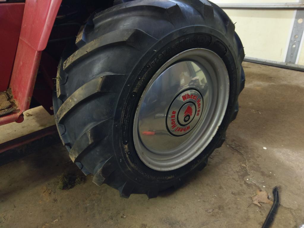

WVHillbilly520H
Got the Nanco AGs (they will be going on the 315-8 in WV) swapped out for a new pair of the OTRs on "Good Friday 520" today along with getting them filled with methanol (I got charged for 15 gallons so 7+ ea tire) and bolted both sets of iron weights back on as well so mother nature bring on some more snow so I can tell you all the differences.
  • Excellent 2
WHX??

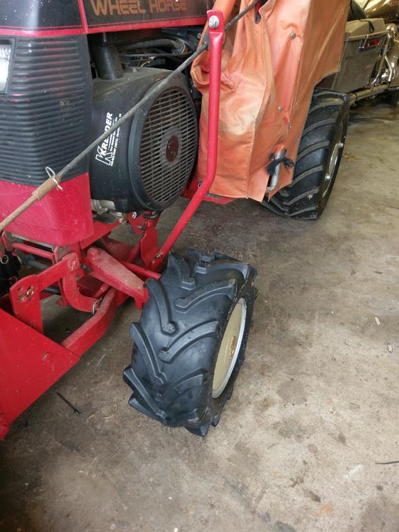

Sry Billy...went the other way on this one.....
  • Like 2
WVHillbilly520H
Variety is the spice of life, and truth be told without 4wd the front AGs are really just a show piece, I believe they will do better in a furrow than steering a 350# 2stage, those ribs look good on there.

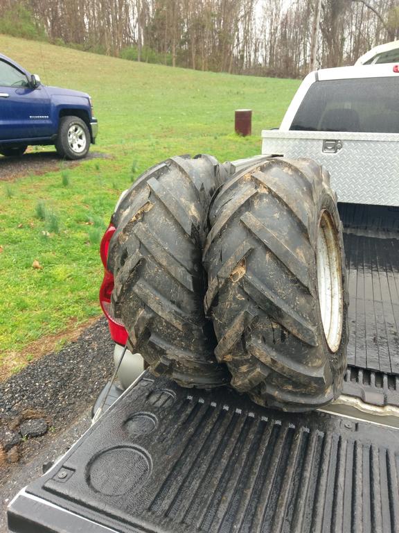

WVHillbilly520H

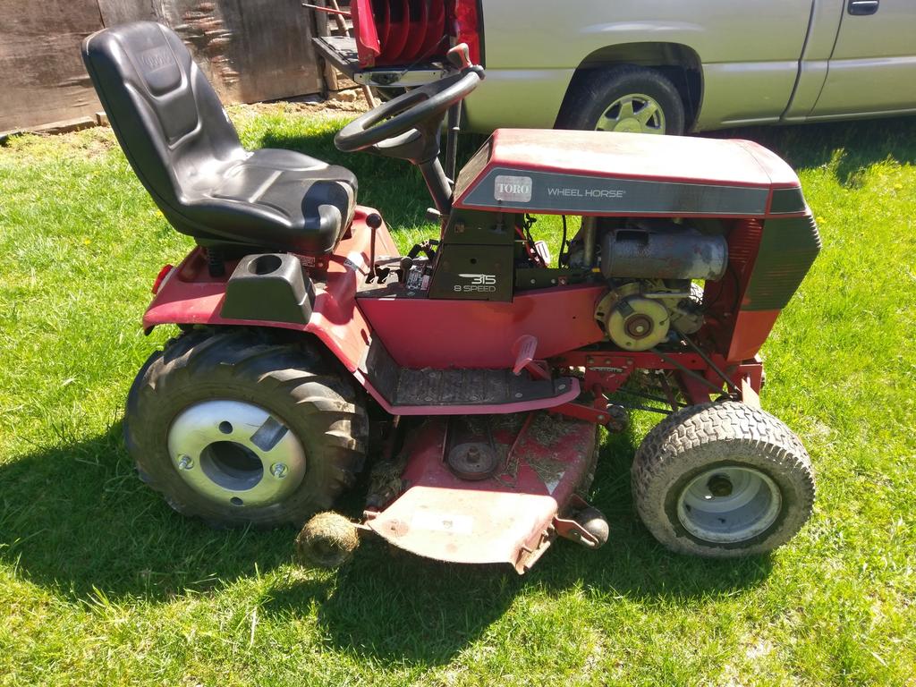

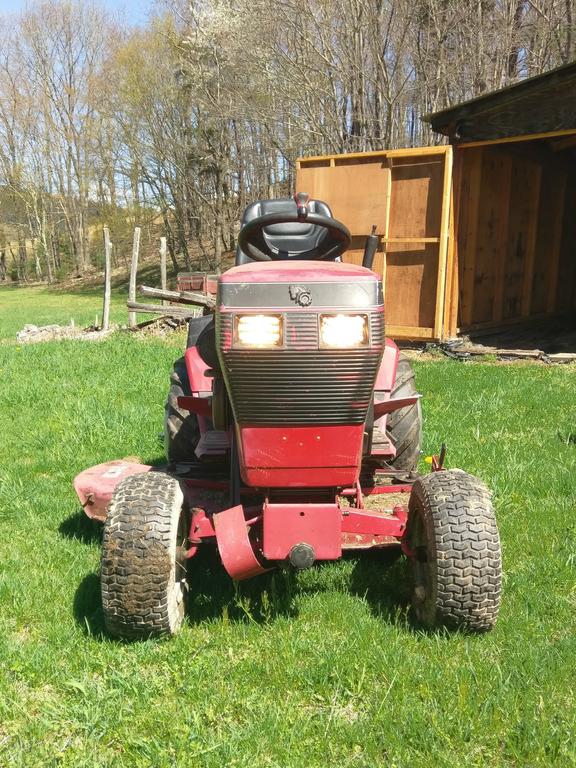

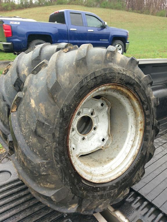

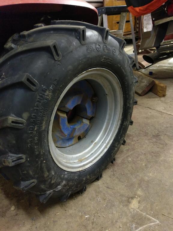

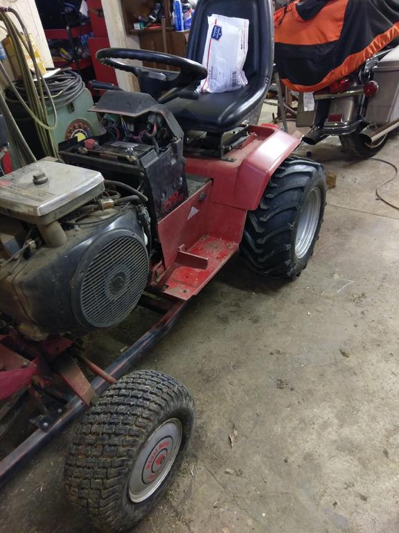

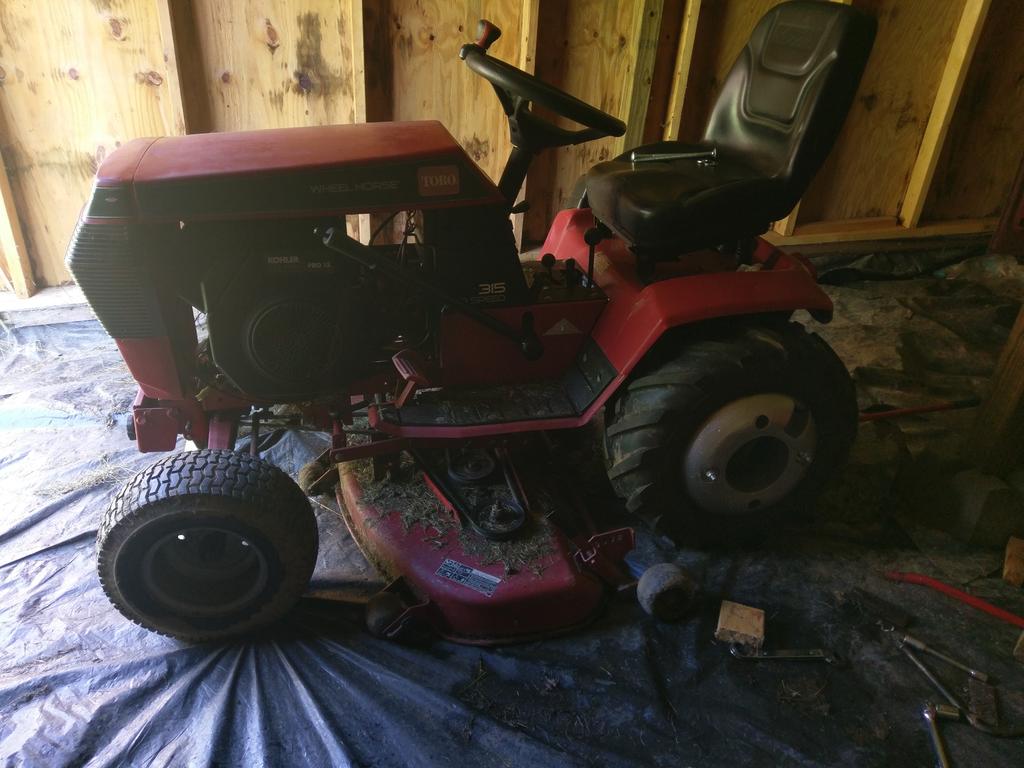

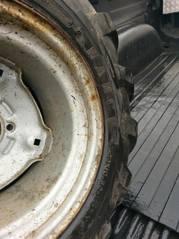

Today I got around to changeing out the rear tires on the 315-8 I bought last summer...it originally came with Carlisle "chevron pattern" turfs size 23x9.50-12, I kept the Nanco AGs (23x10.50-12) from the 95 520 I just swapped in December I'll get them fluid filled too before I return them to duty. They do look more at home on these 7" wide wheels vs the 8.5" 520 wheels (last pic).
  • Like 2
  • Excellent 1
PeacemakerJack
:text-goodpost:you know me Jeff...always a sucker for AG tires.  Those look great on there.  It is so interesting to me how the different rim width really changes the way that an AG tire looks.  Just because a tire fits...doesn’t mean that it looks right.  Nice use of those Nancos :rolleyes:
  • Like 1
  • Thanks 1
WVHillbilly520H
Yep on the 520 wheels the Nancos were sidewall "bulgy" (for lack of a better word) and on the narrow rims sidewalls flat even with tread. Sometimes cheaper isn't better and just because it says "23x10.50-12" doesn't really mean it's that size...i do believe the Hi-Run AGs from TSC are closer to stated width than these NANCO (Deestones) brand.

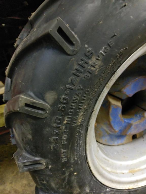

WVHillbilly520H

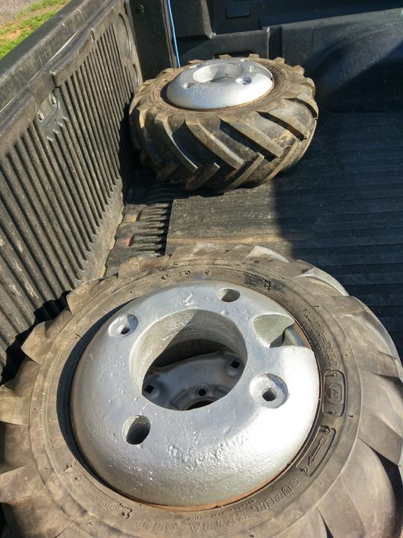

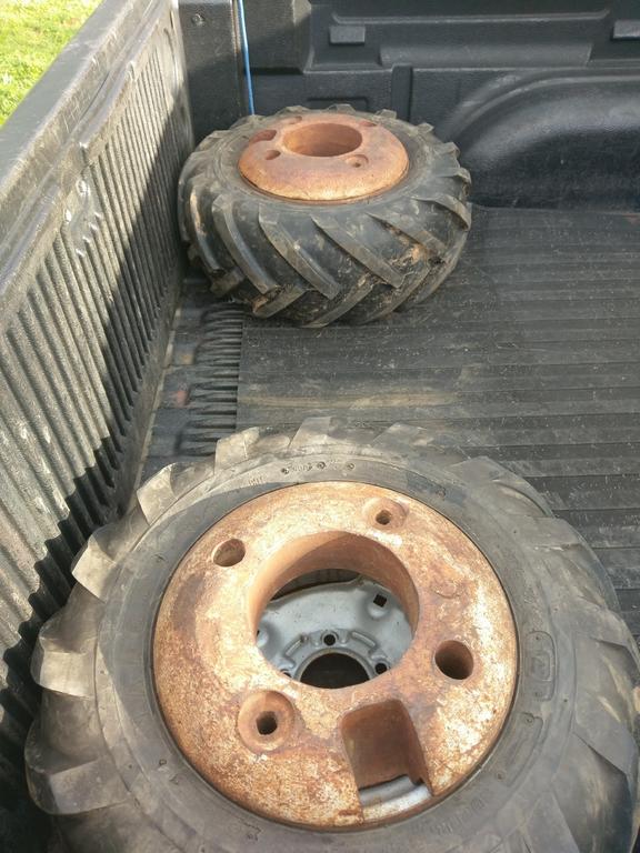

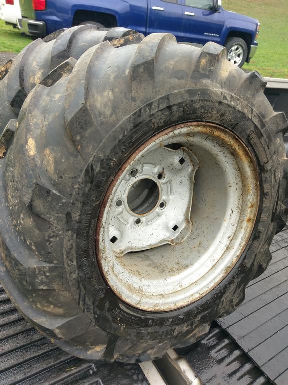

Got them "fluid-filled" today (methanol) and some 65# mushroom iron weights laid in the rims till they make it back to the 315-8 in WV Saturday.
  • Like 2
  • Excellent 1
WVHillbilly520H

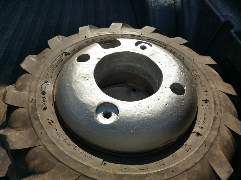

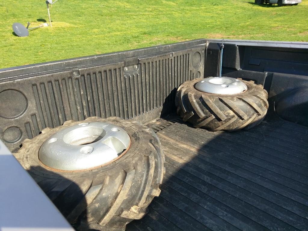

I spiffed the "mushrooms" up a bit since it was rather nice out today.
  • Like 3
PeacemakerJack
Looking Good Jeff...can’t wait to see those in place where they belong :auto-layrubber:
  • Like 1
  • Thanks 1
Herder
NICE set of weights & tires, sure to make any tractor look gnarly.

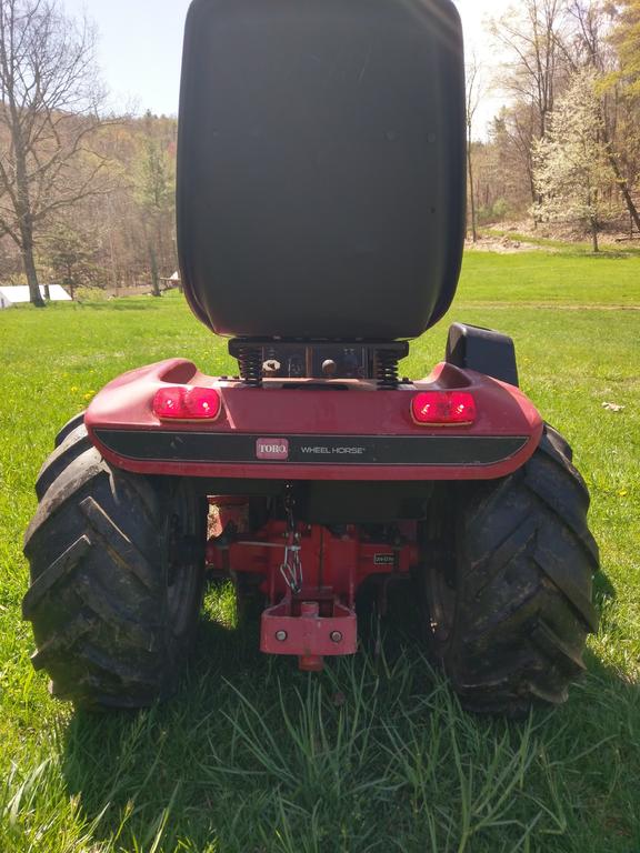

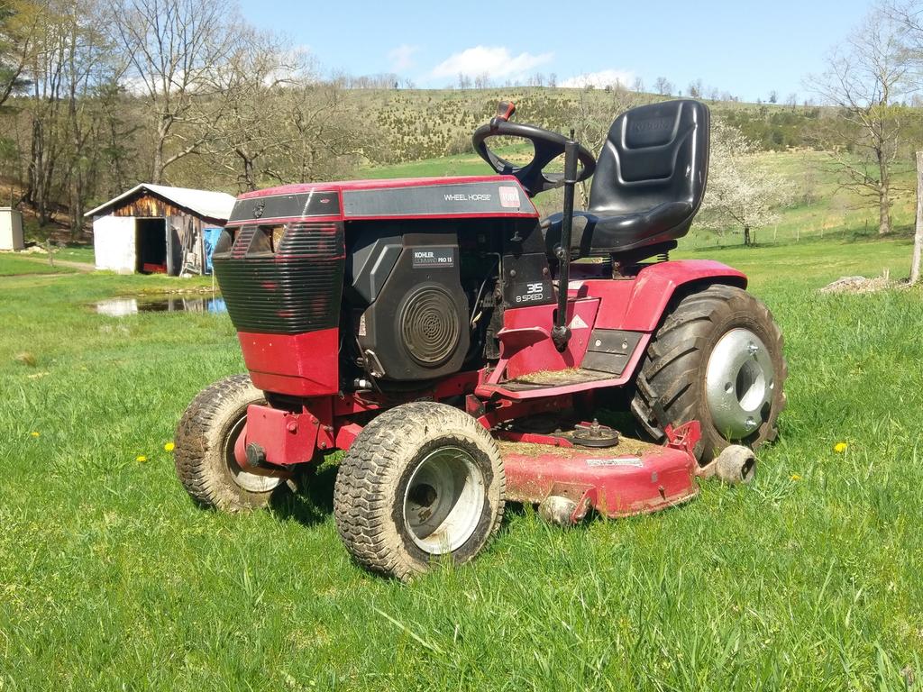

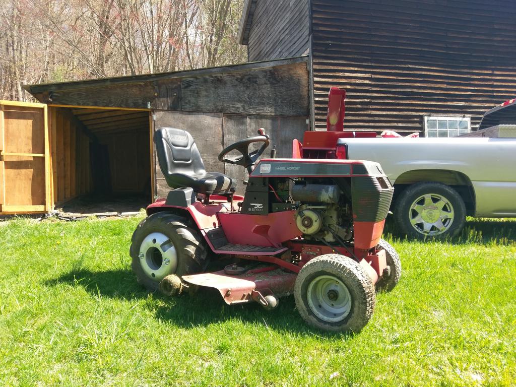

@PeacemakerJack, @WHX22, @Herder here's the tires and weights all mounted up and ready for work.
