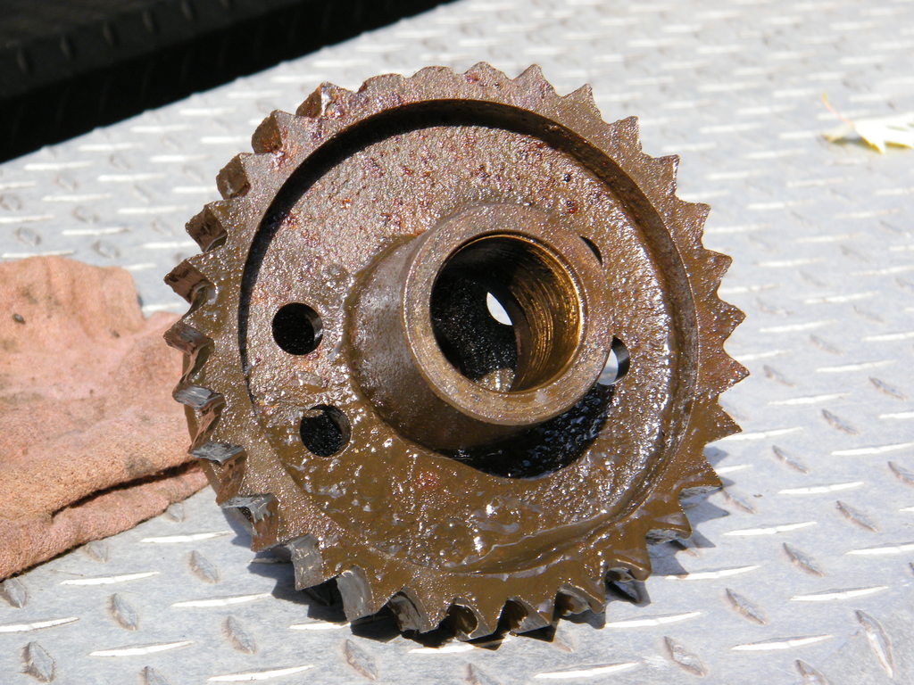

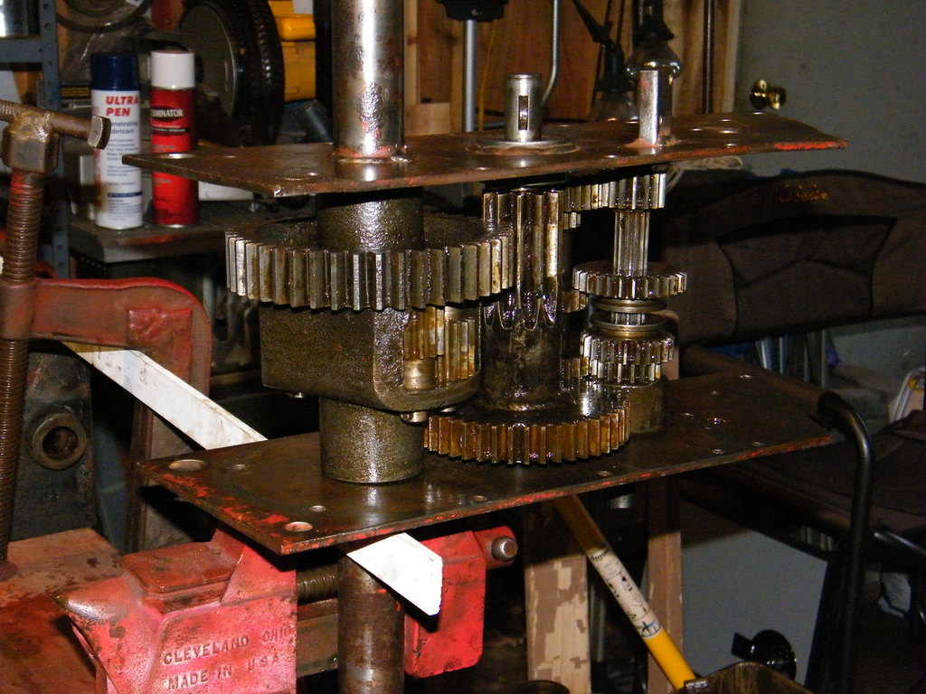

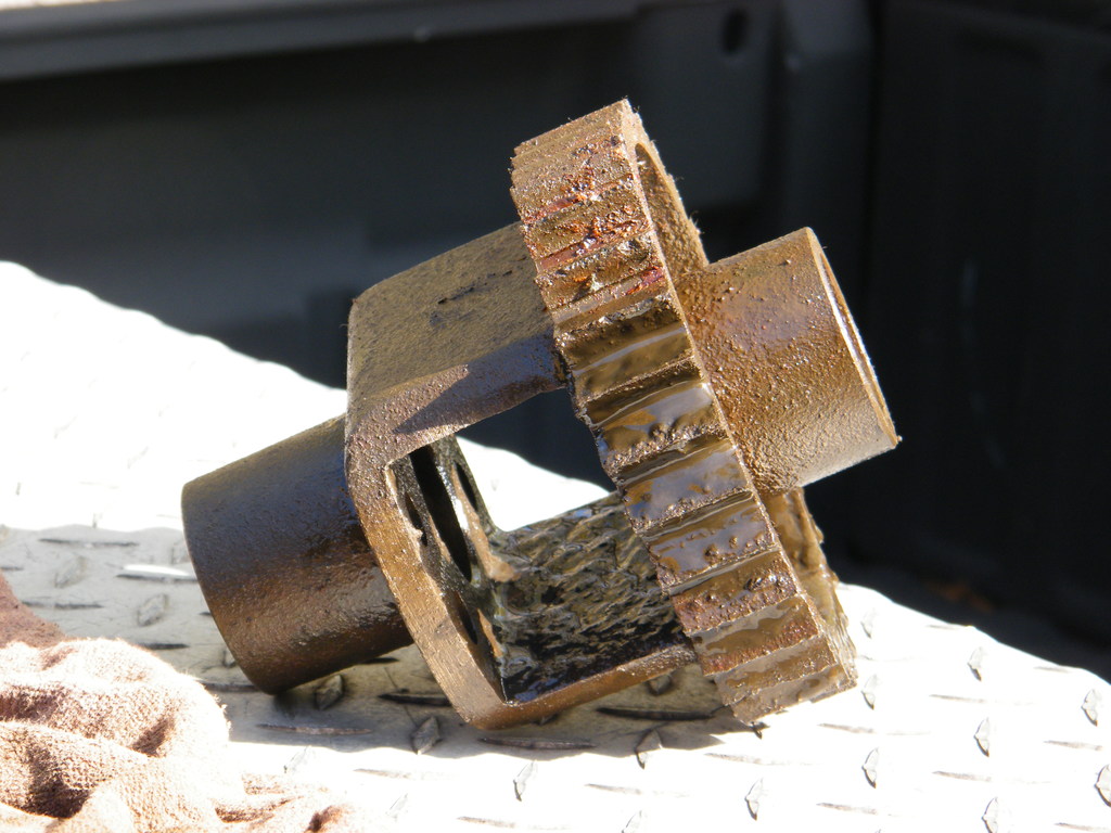

Here is a pic of the pair that has the 11 teeth on the mushroom gear and the correct bull gear.  You can see the difference in the bull gears with the one you have.
Here is a couple of pics of the older style bull gear.  Notice the teeth and the number of.
The needle bearing is newer.  If you are going to try to use the older style, you are going to want the ball bearing plate.  Do you have the older style bull gear??
  • Like 1
RJcollector
I have the bull gear like the 1st pic and the incorrect 8 tooth mushroom gear. My older style bull gear looks worse than yours in the 2nd pic. :text-lol:
  • Like 1
stevasaurus
actually, those pictures are from a couple of transmissions that @Jake Kuhn had that I was fixing for him.  :)  He may have the parts you need.  :)
