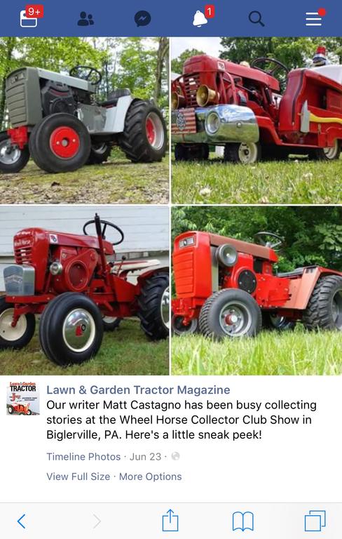

19richie66 17,950 #452 Posted August 8, 2018 (edited) Can it be? Edited August 8, 2018 by 19richie66 Oops, forgot picture 😂 1 Share this post Link to post Share on other sites
Aldon 4,834 #454 Posted August 8, 2018 Nice! I just subscribed. Hopefully in time should they print this soon. 1 1 Share this post Link to post Share on other sites
WHX?? 58,347 #455 Posted August 8, 2018 There is another well known here that may grace the inside of LAGT ...mums the word for now tho.. 1 1 Share this post Link to post Share on other sites

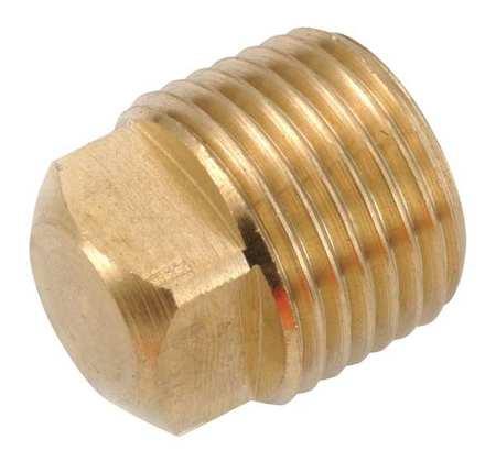

RandyLittrell 3,946 #456 Posted August 9, 2018 On 5/12/2018 at 4:45 PM, 19richie66 said: Well she’s a little farther along today. Waiting on some muscle to help me set the engine in it. @19richie66, why don't you tell us how you filled in the two holes in the dash stand? I think I know how I would do it in cast iron but I would like to know how you did it. Randy 4 Share this post Link to post Share on other sites
19richie66 17,950 #457 Posted August 9, 2018 @RandyLittrell i used JB Weld metal epoxy and two brass pipe plugs. I took a file and cleaned/ruffed up the inside of the holes, then flapped wheeled the outside to get all the paint off. Applied the the epoxy to the threaded part of the plug and the hole. I held the plug where I wanted it till it set up. Once they had set up, I took a cutoff wheel and cut the square head off and drilled another small hole through the middle of the plug. This let the second coat of epoxy flow through the plug and made it solid front and back. After it dried for a day or so, I filed, sanded and primed. Pretty simple actually. Any other questions, ask away. Hope this helped. 5 Share this post Link to post Share on other sites
RandyLittrell 3,946 #458 Posted August 10, 2018 Thanks for showing us that. I had something more complicated in mind, but that's why I don't always get things done!! Randy 2 Share this post Link to post Share on other sites
19richie66 17,950 #459 Posted August 10, 2018 No problem Randy. 1 Share this post Link to post Share on other sites

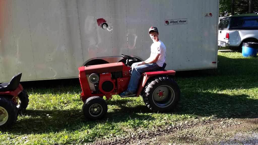

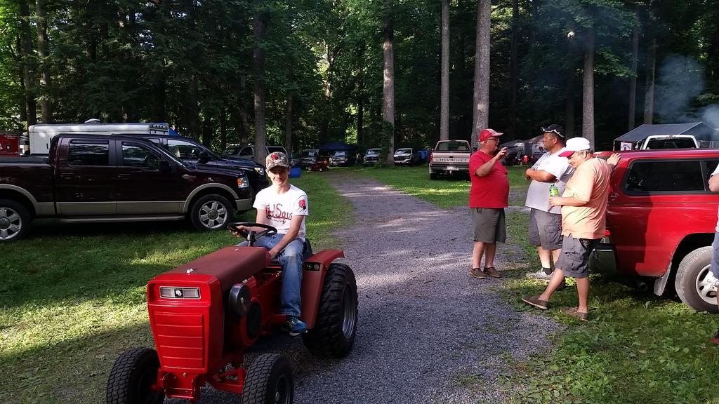

19richie66 17,950 #460 Posted April 8, 2020 Just found this video of Caleb @PeacemakerJack. I think this was your handywork. Had a great time there for sure. Can’t wait to get back. 1 5 Share this post Link to post Share on other sites
PeacemakerJack 11,089 #461 Posted April 8, 2020 Yes...I took that while driving dad’s 875. You can see the IH Cub stack in and out of the shot. I’m so glad the Caleb and I had the opportunity to make that run with Jim and Dan. Lots of great memories from that trip👍🏻 2 4 Share this post Link to post Share on other sites
WHX?? 58,347 #462 Posted April 8, 2020 (edited) Yes he did put a few miles on it! Prolly enough to wear nubbies off....... Hey how come I got no seat time!!! Edited April 8, 2020 by WHX24 1 4 Share this post Link to post Share on other sites
19richie66 17,950 #463 Posted April 8, 2020 Should have strong armed him @WHX24 Jim 4 Share this post Link to post Share on other sites
WHX?? 58,347 #464 Posted April 8, 2020 Next time I will pull rank @Coulter Caleb! 6 Share this post Link to post Share on other sites
