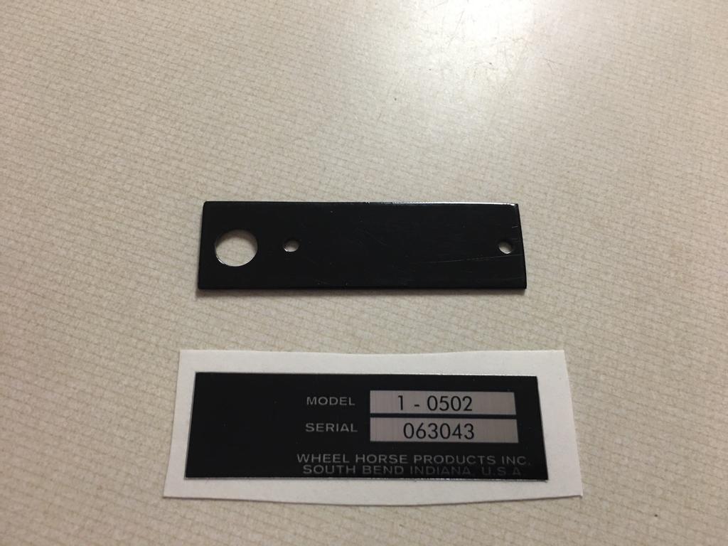

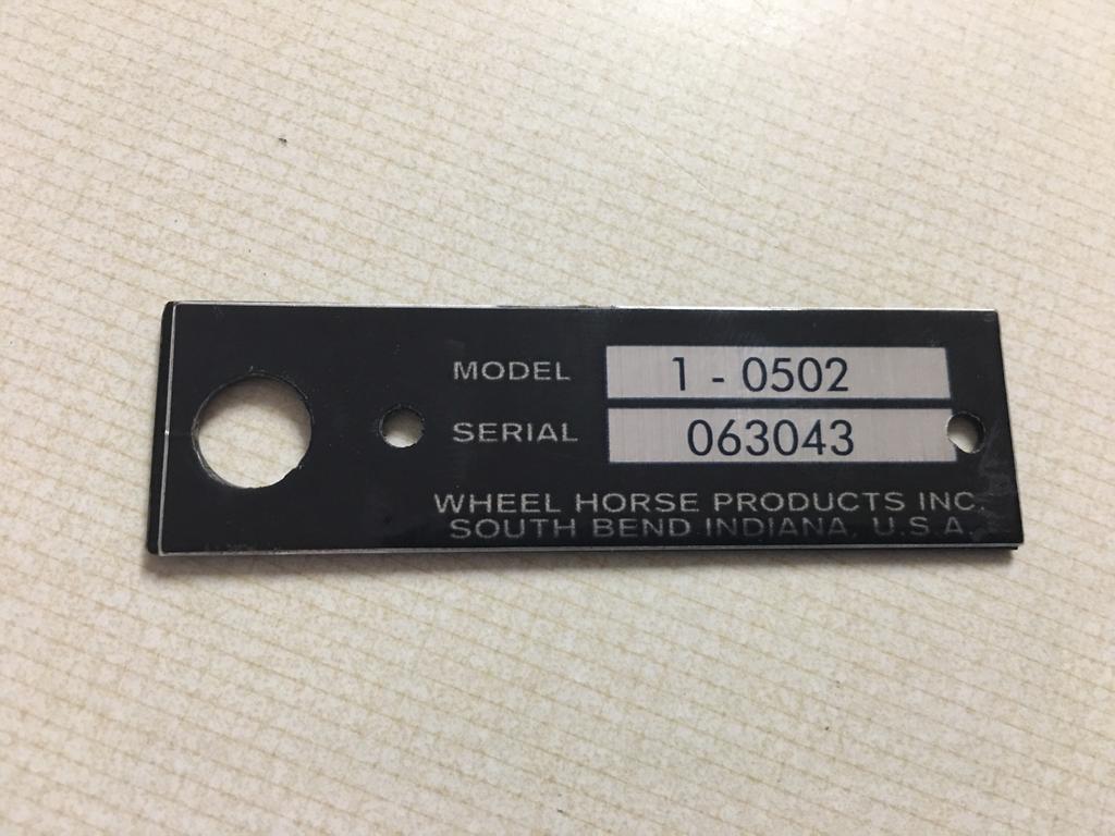

19richie66 17,749 #231 Posted March 3, 2018 Well since my serial number was non existent and you could just barely read the model number, I figured I would make a new one. You wheel horse gurus will notice the serial number is all wrong. Well since my Dad got me into this hobby, I used his birthday for my serial number. I ordered a new tag decal from Terry and made a new tag from 1/16” steel plate. My son had it powdercoated at work and this is what it came out like. Terry’s decals are top notch. Can’t say it enough. 4 5 Share this post Link to post Share on other sites

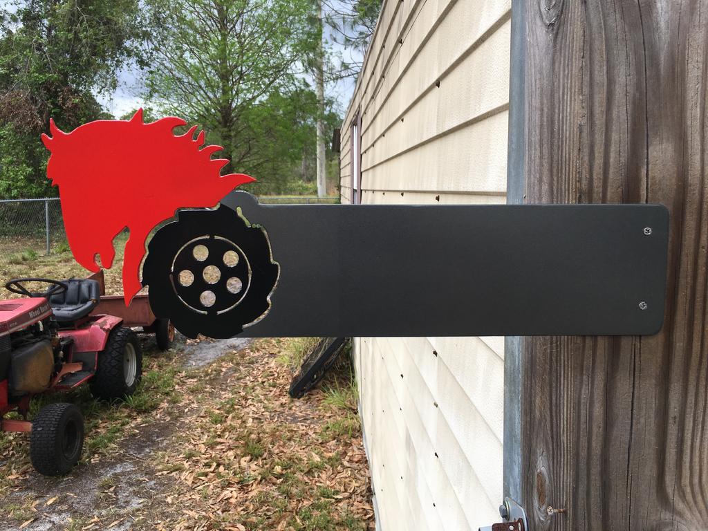

19richie66 17,749 #237 Posted March 12, 2018 Testing out Skittles’new colors on the mash pole sign. I think she’s gonna look good. 👍 3 7 Share this post Link to post Share on other sites
PeacemakerJack 10,803 #238 Posted March 12, 2018 Agreed! 1 Share this post Link to post Share on other sites
953 nut 61,909 #239 Posted March 12, 2018 21 minutes ago, 19richie66 said: mash pole sign. I think she’s gonna look good. It looks great!!!!!! 1 1 Share this post Link to post Share on other sites
Racinbob 12,195 #240 Posted March 12, 2018 Outstanding Richie 1 Share this post Link to post Share on other sites
JPWH 6,539 #241 Posted March 12, 2018 I like the colors. The sign looks awesome! 1 Share this post Link to post Share on other sites
elcamino/wheelhorse 9,362 #242 Posted March 12, 2018 Ritchie That sign looks great , Now I need to think about colors for my sign. 1 Share this post Link to post Share on other sites
19richie66 17,749 #243 Posted March 12, 2018 I thought you said you wanted it rusty 2 Share this post Link to post Share on other sites

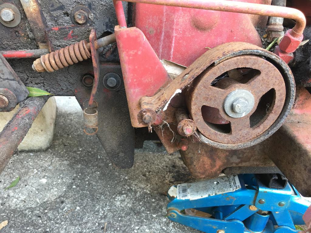

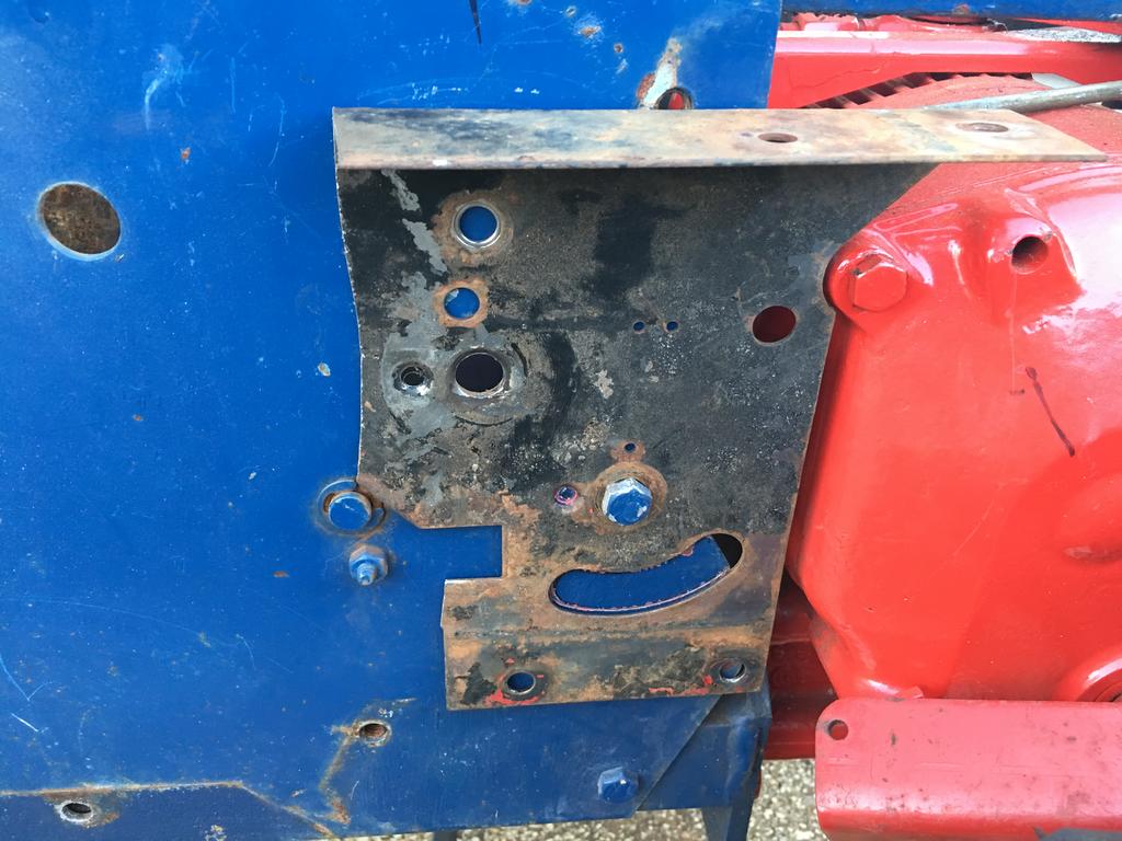

19richie66 17,749 #250 Posted March 14, 2018 (edited) So I have this parts 418-A I have been sitting on till I got the chance to start working on skittles again. So today I got out and started stripping all the brake linkage and motion control assembly off it. I started eyeing it up and it looked so similar in dimensions to the 418. I figured lets see what fits and doesn’t fit. I took a saw and cut out the side plate for the tunnel, ground some threaded nuts off the back and laid it up next to the side panel on skittles. It is unbelievable that 2 tractors, different models and transaxles, 15 years later the parts would fit in the same holes. I had to drill out one hole for the bushing but the brake cam, motion assy and the control rod from the hydro cam to the lever all bolted right in. Have to cut the “happy” slot in the side panel but most everything else is a direct fit. Will have to straighten and thread the brake pedal rod and use a clevis on it instead of the 90* bend and cotter pin. Ran out of daylight. Edited March 14, 2018 by 19richie66 2 4 Share this post Link to post Share on other sites
