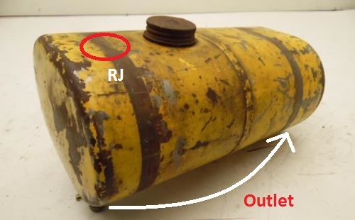

wallfish 19,562 #6 Posted February 19, 2017 The tank outlet should be at the other end of the tank but I would be more concerned with the cut up hood, cut up belt guard and the front rims. No one will ever notice the tank. 2 Share this post Link to post Share on other sites

wallfish 19,562 #9 Posted February 19, 2017 (edited) 2 hours ago, Cglisson01 said: The hood is minor, I'm pretty good at metal fabrication, so that is no big deal. I have a set of front rims not in picture. And a new belt guard is on its way. So now I'm trying to figure out the gas tank issue so I can correct that if need be. Perfect, that stuff is usually the more difficult things to get right. Tank should be a larger oval shaped Kohler tank (3 Qt. ?). If it's the correct size tank you can just move the outlet to the other side or move the fill neck and solder in place. That's the easiest way for a skilled metal guy unless you can find a real one. Correct RJ-58 tanks are very difficult to find because of the location of both the fill neck and outlet plus they can go for $100+. The RJ tank has the fill neck closer to the edge than the majority of tanks you can find, like the Suburban style tanks plus the outlet location again. That's possibly the tank you may have now. Try posting a wanted ad in the classified section, maybe someone has a correct tank. Since it seems you are going the way of a factory correct restore, here are some things noticed from your pic Tank straps should be spot welded to the hood, no holes Correct front rims will not have any holes for weights. RJ did not have foot rests. Tool box and fenders were an option so either way is correct Steering wheel looks welded on and should just use a roll pin The throttle lever is not correct Clinton engine should be a B1290 and I think they used a different recoil. (forgot the correct spec#) Hope this helps Edited February 19, 2017 by wallfish 1 Share this post Link to post Share on other sites

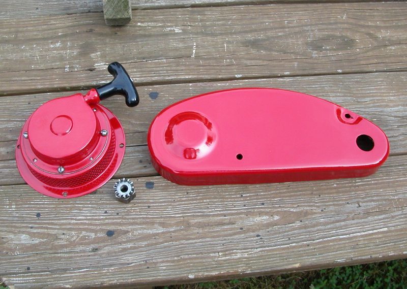

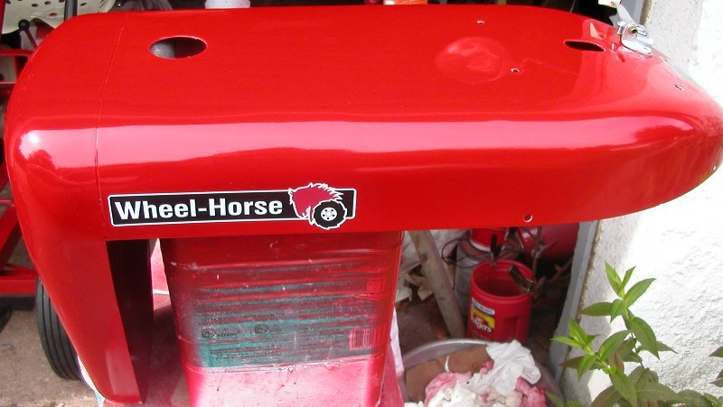

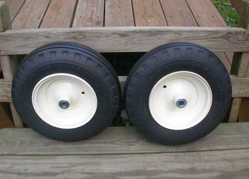

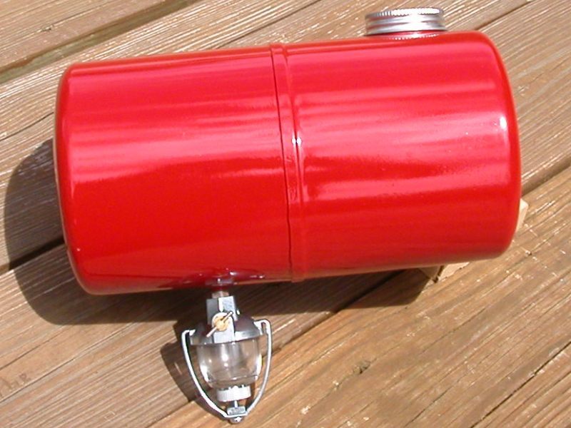

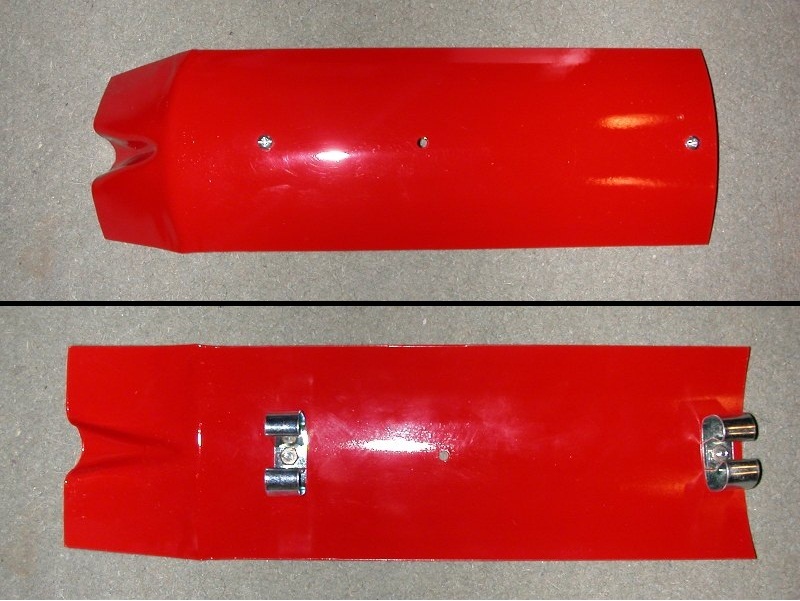

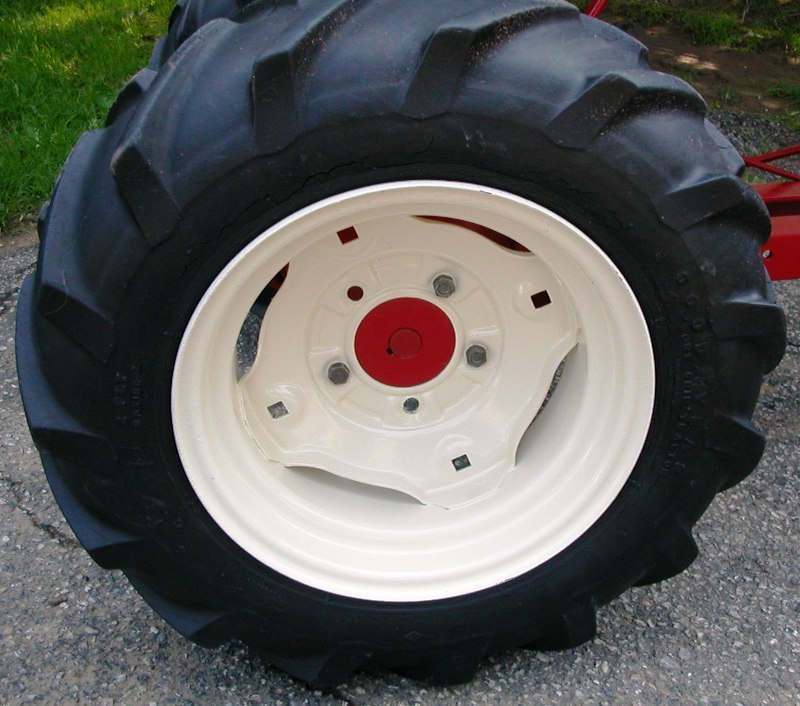

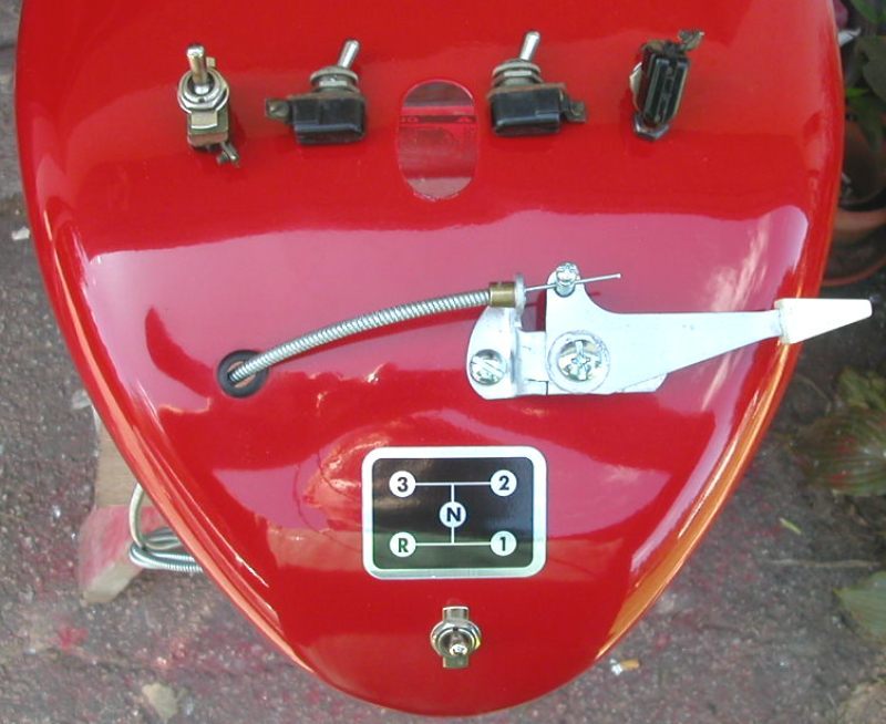

MikesRJ 562 #14 Posted February 19, 2017 (edited) @Cglisson01, Here's the write-up: http://www.mywheelhorse.com/modules.php?name=Docs2&do=show_doc&id=2 And a few pics to get your juices flowing: Edited February 19, 2017 by MikesRJ 5 1 Share this post Link to post Share on other sites
Cglisson01 39 #15 Posted February 19, 2017 49 minutes ago, MikesRJ said: @Cglisson01, Here's the write-up: http://www.mywheelhorse.com/modules.php?name=Docs2&do=show_doc&id=2 And a few pics to get your juices flowing: Thanks for the pictures mike. They will definitely give me something to go by on comparing mine. You wouldn't happen to know the length of the gas tank would you? My tank looks like it might be longer compared to the one in your picture. 1 hour ago, wallfish said: In most cases they really don't because they are so often changed. WH used calcium chloride to fill the front tires for weight so that rotted the majority of the early tractor rims. The rims are no big deal unless going for that complete factory restore. I just thought since you were down to the details about the tank, might as well put the other stuff out there too. Some people want it 100% exactly perfect, others don't care at all but most people fall somewhere in between those 2 . Even if you don't go to that extreme, it's still nice to have the info. @MikesRJ did a full blown factory correct RJ-58 restore and did a nice write up on many steps he took along the way. Plenty of good documented info for any RJ restore. I really do appreciate the detailed info. Half the fun of restoring a old tractor is learning about them to. I try to challenge myself to restore one as close to original as I can. 3 Share this post Link to post Share on other sites

MikesRJ 562 #17 Posted February 19, 2017 @Cglisson01, If memory serves, about 12-13" long. Also note the position of the filter/bowl compared to the filler cap. A rather important detail on the RJ. If your tank is longer it is probably one from a later model and from a much higher HP rating. 1 Share this post Link to post Share on other sites
Cglisson01 39 #18 Posted February 20, 2017 (edited) I went out this morning and measured the tank and took a couple pictures. The tank measures about 11.5 inches long so it might be close to original size and all I would have to do is move the valve. And also, what size tire should I buy for the front rims? Thanks, Chris Edited February 20, 2017 by Cglisson01 1 Share this post Link to post Share on other sites
MikesRJ 562 #19 Posted February 20, 2017 (edited) @Cglisson01, The fronts are 4.00 x 8, the rears are 6 x 12. Here's the link to the owners manual: http://www.mywheelhorse.com/graphics/file/Tractors/TR_1958_RJ-58.pdf Trans Manual: http://www.mywheelhorse.com/graphics/file/Transmissions/Transmission_Uni-drive_1958_-_1982.pdf Engine Manual: http://www.mywheelhorse.com/graphics/file/Engines/Kohler_K90_OM&IPL.pdf http://www.mywheelhorse.com/graphics/file/Engines/Kohler_K90-K91_ServiceEngines_ENS-924.pdf Minus the filter bowl (missing in this pic), this is what the tank should look like installed. I will have to look around. I may have another correct tank someplace. Edited February 20, 2017 by MikesRJ 2 Share this post Link to post Share on other sites
