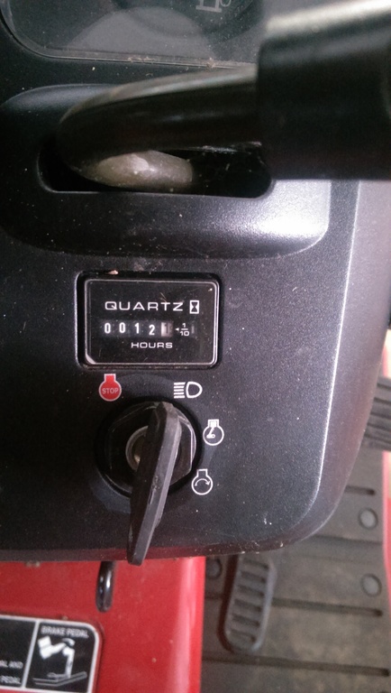

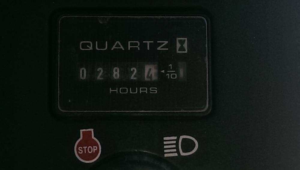

Regarding the 520xi, are you sure that it is 2,889 hours or 288.9 hours? There is a .10th hour digit on the meter. Also the hour meter only registers with the engine running. It is in series with the oil pressure sensor. A puff of smoke at startup is common for the Kohler Command twin. Hydro noise is also common in the cold.

Thanks!  I am pretty sure it was 2889, unless the tenths place wasn't white, then its possible that it was 288.9.  it the tenths a white position?  all the digits I saw were black.

If the original hour meter, it should be a Quartz meter with L to R  the hours (4 places) are white on black and the fifth place is black on white.

This is what the hour meters look like on the Xi series see pics...and as far as the 268h it's a really good "lawn" tractor (the forebearer of the Xi series "lawn and garden" tractors from the classics like the 520h) it has a vertical shaft engine vs the horizontal shaft and attachments/implements are rare/hard to find as well as the Xi series vs the classics(520h) if you had the money the package deal is well worth it vs buying it separately, then flipping what you don't want/need, I have 3 520H's all have under 800hrs (1 bought new), 1 520Xi and it does turn tighter than the other 3 (but limited attachments) and a 523Dxi (diesel) with a bad engine, I'm still kinda partial to my classics but only had the Xi's for a limited time, and a foot pedal motion control conversion kit can be had for the 520H like the Xi's, and Forest Road hit the high points there, Jeff.

I believe the timer is in series w oil monitor. Essentially if the key is on the timer is on. My 314 had 250 hours last year. I left the key on and all of a sudden I'm over 300. Do that a few times a year over 10 years and 3000 hours is easy.

On the XI machines, the hour meter should be in series with the oil pressure switch. (It should also be this way on the later model Onan powered tractors). This means that the hour meter will only run if the tractor is running and has sufficient oil pressure.
However, I have a 522xi that the hour meter will spin any time the key is on because the oil pressure switch had failed in the "have pressure" or closed position.
If I would venture a guess, if you turned the key on without starting the engine there is no oil pressure warning light showing (which there should be).

I called the owner to verify the oil light and leave on without running  for a short while.  Is doing that now and will get back.
2889 hours is like running it 96 times a year at 2 hours each time for 15 years.  Not very reasonable.

Well, the seller ran the test for me...got power to the oil light, let key sit on for 3 hrs (not sure why that long), and it did not move the meter. In the end, after all dialogue, I'm going to keep the gt225 and find a bigger deck.  If you all are interested, search buffalo, ny craigslist for "two wheel horse"  He actually has 5 for sale and many extras and parts as I listed.  He will be in Florida for the next week. I have his number if you have a hard time contacting him.  He really wants everything to just be gone.
