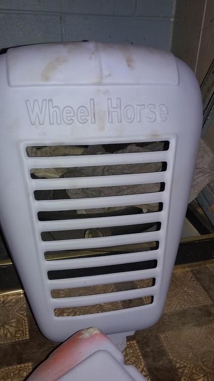

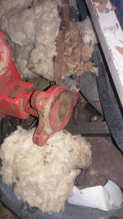

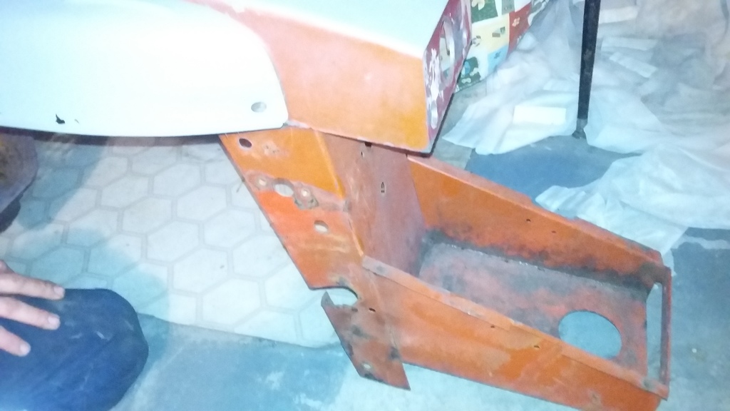

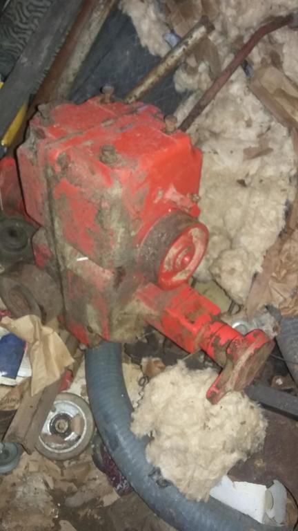

BOB ELLISON 2,981 #1 Posted January 25, 2017 I have a opportunity to but a basket case that I don't know what it is. All my research tells me it's a 701 or 702. It has all the parts but no id tags. Common with older horse's. But I did get some pictures. I believe he said it was a 7hp kohler and 3 speed trans. He's not sure if the seat is correct but it has little half finders. I need to know if it's worth it to me has plow,deck is rough. My concern is he also has a 1054 with a great looking deck that is also a basket case that I'm buying tomorrow and it has a 12hp kohler and a hydrolic pump . I know its not the 10 hp. I don't mind the 12hp it has the starter/generator so It will look ok. Just not stock for 1054. I hope someone can identify it through the pictures. 1 Share this post Link to post Share on other sites
kthack657 328 #2 Posted January 25, 2017 (edited) not a 701 although it looks to have a 701 gas can. The 701 has a solid grill with no slats, like the nut roasters, other indicators would be the 701 has a double belt guard and a double pully on the starter generator and engine. The Seatpan is also square, and could be red or white, the one in the picture is from an early 60's tractor. Good luck with whatever it is but looks like a mutt Edited January 25, 2017 by kthack657 3 Share this post Link to post Share on other sites
ClassicTractorProfessor 5,434 #3 Posted January 25, 2017 2 minutes ago, kthack657 said: not a 701, the 701 has a solid grill with no slats, like the nut roasters, other indicators would be the 701 has a double belt guard and a double pully on the starter generator and engine. The Seatpan is also square, and could be red or white, the one in the picture is from an earlier tractor. Good luck with whatever it is Just a possibility here, but the hood could've been changed over at some point to the newer style. I have a 701 I'm putting back together that has the later style hood on it. But I agree the seat is from an earlier tractor 1 Share this post Link to post Share on other sites
Elkskin's mower junkyard 1,117 #4 Posted January 25, 2017 50 minutes ago, BOB ELLISON said: I have a opportunity to but a basket case that I don't know what it is. All my research tells me it's a 701 or 702. It has all the parts but no id tags. Common with older horse's. But I did get some pictures. I believe he said it was a 7hp kohler and 3 speed trans. He's not sure if the seat is correct but it has little half finders. I need to know if it's worth it to me has plow,deck is rough. My concern is he also has a 1054 with a great looking deck that is also a basket case that I'm buying tomorrow and it has a 12hp kohler and a hydrolic pump . I know its not the 10 hp. I don't mind the 12hp it has the starter/generator so It will look ok. Just not stock for 1054. I hope someone can identify it through the pictures. looking where lift handle goes and the tank its a 753 or something else more pics would be easier to id 2 Share this post Link to post Share on other sites
BOB ELLISON 2,981 #5 Posted January 25, 2017 This is what I got from a post here from @953 nut he has a post about the changes throughout the year's of wheel horse's. All models remained the same from 1961 to 1962 with all having the front mounted engine. The models were called the 502, 552, and the 702 the hood was a major appearance change. In 1961 they had an aluminum gas tank and a unique hood shape with a slotted grill 1 Share this post Link to post Share on other sites
Elkskin's mower junkyard 1,117 #6 Posted January 25, 2017 1 minute ago, BOB ELLISON said: This is what I got from a post here from @953 nut he has a post about the changes throughout the year's of wheel horse's. All models remained the same from 1961 to 1962 with all having the front mounted engine. The models were called the 502, 552, and the 702 the hood was a major appearance change. In 1961 they had an aluminum gas tank and a unique hood shape with a slotted grill well looking at the lift handle area in 63 they started bolting in. and that gas tank is a 2 peice tank which came out in late 62 early 63. need more pics to be able to id. front axle changed in 63. so did frame in front 1 Share this post Link to post Share on other sites
BOB ELLISON 2,981 #7 Posted January 25, 2017 Just now, craftsmanmowerfreak said: well looking at the lift handle area in 63 they started bolting in. and that gas tank is a 2 peice tank which came out in late 62 early 63. need more pics to be able to id. front axle changed in 63. so did frame in front Sorry craftsmanmowerfreak but that's all I could get . He had all the parts under a bench in his basement. 1 minute ago, BOB ELLISON said: Sorry craftsmanmowerfreak but that's all I could get . He had all the parts under a bench in his basement. Actually it is a 1 piece tank the red was not cleaned off before he painted the primer on it 1 Share this post Link to post Share on other sites
Elkskin's mower junkyard 1,117 #8 Posted January 25, 2017 3 minutes ago, BOB ELLISON said: Sorry craftsmanmowerfreak but that's all I could get . He had all the parts under a bench in his basement. ok but if he dont want much for it go get it. i am loving my 701. and we got a 753 i am working on here and there too 1 Share this post Link to post Share on other sites
BOB ELLISON 2,981 #9 Posted January 25, 2017 He wants $200.00 for it with plow and deck and all the parts are there for the tractor. But he's not sure if engine runs but he said it turns over. That's the scary part. 1 Share this post Link to post Share on other sites
Elkskin's mower junkyard 1,117 #10 Posted January 25, 2017 13 minutes ago, BOB ELLISON said: He wants $200.00 for it with plow and deck and all the parts are there for the tractor. But he's not sure if engine runs but he said it turns over. That's the scary part. 200 is fair price. heck the hoods alone can go up to 100 bucks so do the plows and decks 100 each depending condition. check engine for compression if it has compression it will run. if the crank free spins with no resistance then its blown up. still good buy either way 4 Share this post Link to post Share on other sites

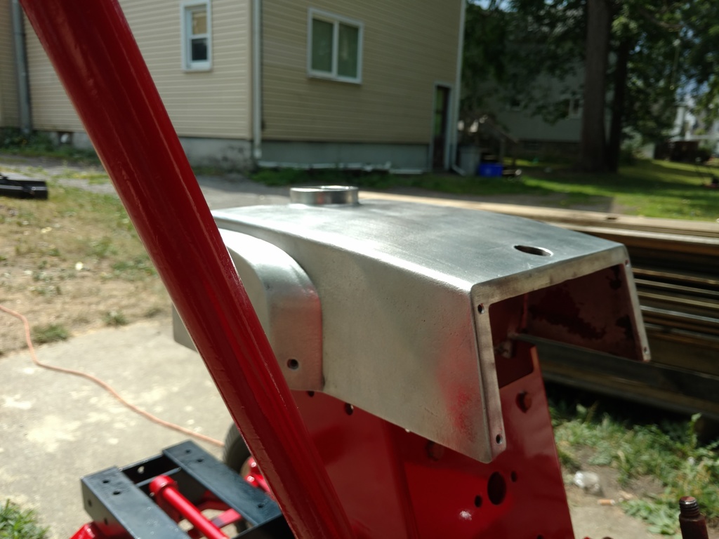

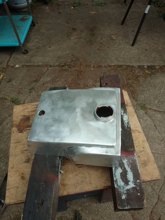

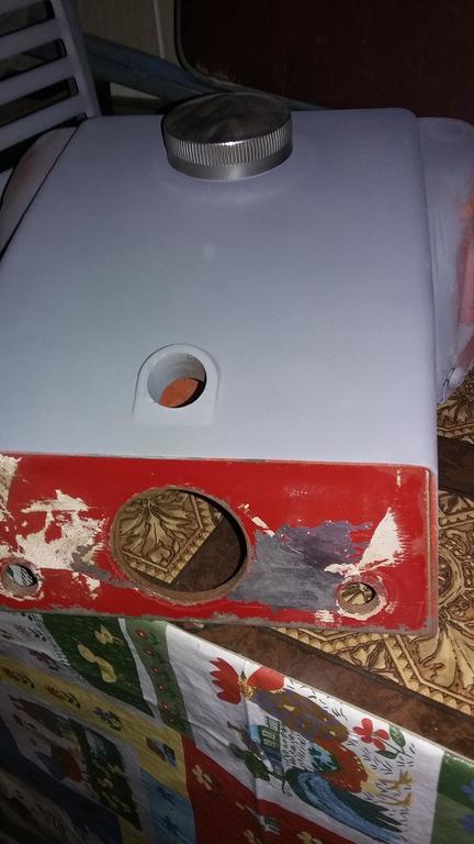

Chris G 3,363 #11 Posted January 25, 2017 (edited) I see the front axle in the second pic. That appears to be a 702 axle. The tanks on my 702's are like the photos below. The face plate that holds amp gauge, choke cable and throttle cable is a separate piece that screws on. And the hood tower appears to be a 63 to me. The hood definitely looks like a 702. Also if that's the gas tank sticking up in front of the hood on the first picture with the divets in it. I would say that would probably be a two piece like a 63 tanks. But hope this helps and I would say 200 is definitely worth the parts. So I'd go for it even if it's a mix and match. Extra parts on hand is always good for a horse trade or future projects!!! Edited January 25, 2017 by Chris G 3 Share this post Link to post Share on other sites
Elkskin's mower junkyard 1,117 #12 Posted January 25, 2017 5 minutes ago, Chris G said: I see the front axle in the second pic. That appears to be a 702 axle. The tanks on my 702's are like the photos below. The face plate that holds amp gauge, choke cable and throttle cable is a separate piece that screws on. And the hood tower appears to be a 63 to me. The hood definitely looks like a 702. Also if that's the gas tank sticking up in front of the hood on the first picture with the divets in it. I would say that would probably be a two piece like a 63 tanks. But hope this helps and I would say 200 is definitely worth the parts. So I'd go for it even if it's a mix and match. Extra parts on hand is always good for a horse trade or future projects!!! hoods are same for 62 and 63. in 64 they were longer for the 854 2 Share this post Link to post Share on other sites
Aldon 4,828 #13 Posted January 25, 2017 1 hour ago, BOB ELLISON said: He wants $200.00 for it with plow and deck and all the parts are there for the tractor. But he's not sure if engine runs but he said it turns over. That's the scary part. the parts alone are worth exponentially more than asking price abeit pabkage deal. I see meny of these questions whch should be non-questions. 200dollars. Anything beyond a few parts is gravy or icing o the cake. Either buy it or let the forum know where to do so. 3 Share this post Link to post Share on other sites

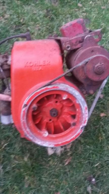

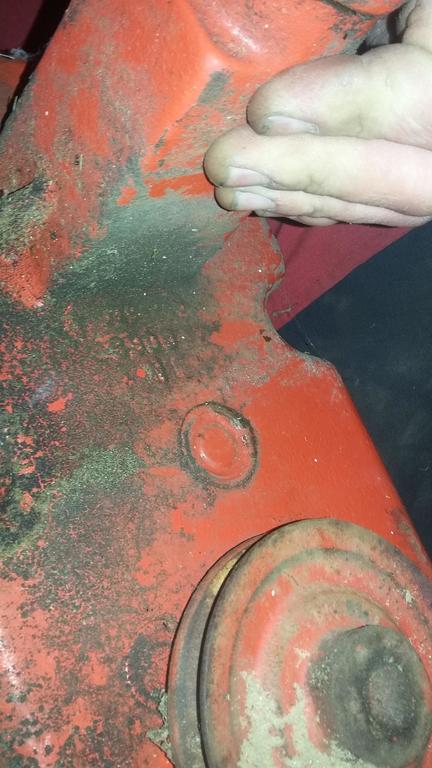

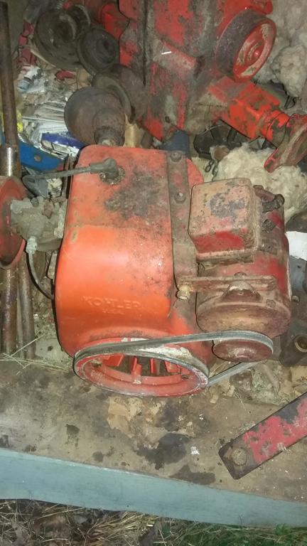

BOB ELLISON 2,981 #18 Posted January 26, 2017 Well guys @craftsmanmowerfreak , @kthack657and @Chris G here is some more pictures that I took today. Sorry some are a little blurred. Looking at the engine i don't know what hp it is. 3 lug hubs . Need help . Share this post Link to post Share on other sites
Elkskin's mower junkyard 1,117 #19 Posted January 26, 2017 in 64 they had 5 lug hubs. unless someone put them on dads 754 lol. but looking at it may very well be a 753 need front axle shot to be sure engine tells me its a 62 and after setup. is it a k161 or k181. should be a k161 Share this post Link to post Share on other sites
clueless 3,318 #20 Posted January 26, 2017 701, 702, 753. it doesn't matter, parts are worth more than that. What matters is it does not deserve the fate that has been bestowed upon it, go get it!! Chris, saving one horse at a time. Share this post Link to post Share on other sites
Chris G 3,363 #21 Posted January 27, 2017 Well the rearend is correct to a 702 by the looks and as long as the Kohler is a k161. I would say that was probably 702 as well. Either way well worth saving and worth the asking price. But looks to be mainly 702 parts with a couple 63 parts in there. Share this post Link to post Share on other sites

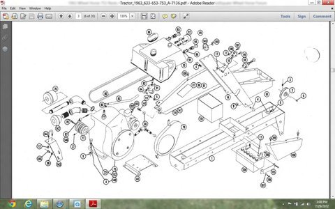

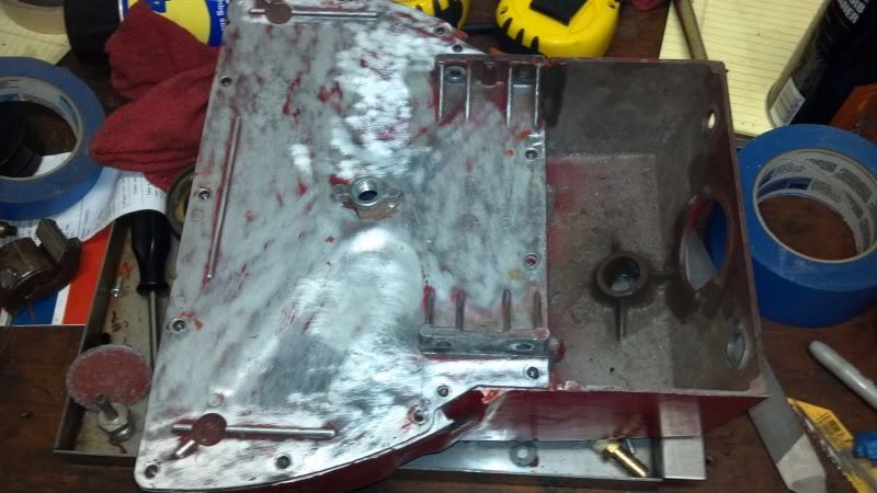

Chris G 3,363 #22 Posted January 27, 2017 Here's a pic from manual for 633,653 and 753. I'm pretty sure hood tower and fuel tank is from a 63. And here's a pic of the bottom of a two piece tank. Share this post Link to post Share on other sites
