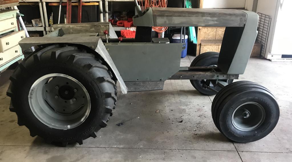

In order to squeeze the Predator into it however the hood will have to be modified. Although I hope to retain enough of the look that it will still look GT14 like.

How hard would it be to make a copy of that back fender that was wide enough to cover the tire? Nothin' different, just wider.

Mine will have muffler but hope it retains some of the rumble.
Fabricating a wider fender is plausible but it would be really difficult without a metal brake.
19richie66
Hmm, can't see the video. I have thought about a wider fender for mine but they are arched in two different ways. Without an english wheel it would be difficult. It would be hard to cut two fenders in half and widen them. It would be cool though!

I was thinking that if you put a spacer between the axle housing and upper fender to raise it up enough and make a new longer front panel which would end up a bit further forward it would get the job done and look stock to the untrained eye. Don't know that covering the width of the tire is that important.

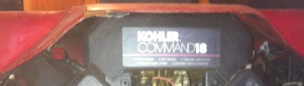

 I had to do the same when installing the Kohler commander in the GT
  • Like 3

ztnoo
Very, very impressive Aldon!!!

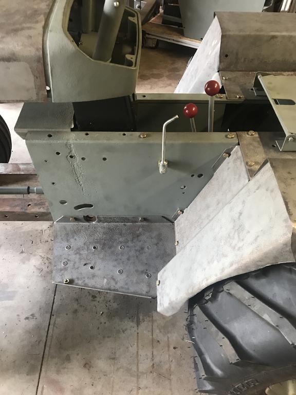

I was wondering where the second hydraulic control valve was going to be located.......now it looks like I know.
Also, what are those corrosion streaks and pitting on the left side frame "C" section panel??? Corrosion from a previously leaky battery?
Edited by ztnoo
Aldon
@19richie66 fabbed up the independent hydraulic control valve handle so kudos to him for the assist.
@ztnoo I don't know root cause for the corrosion but the parts cow i pulled it off of sat uncovered in field for a long time. I have a better option that will be used on the actual build. Once I've determined all the necessary modifications, holes, cuts etcetera.

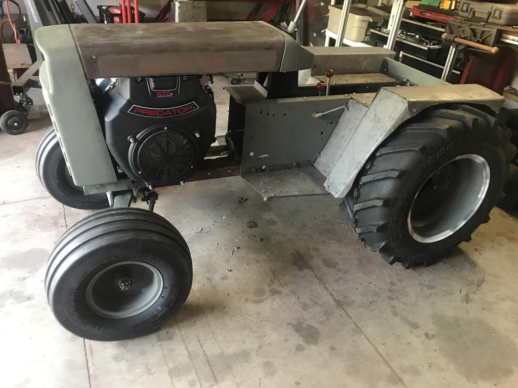

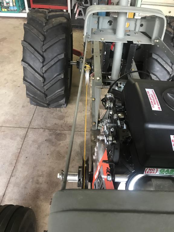

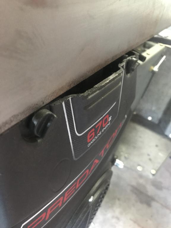

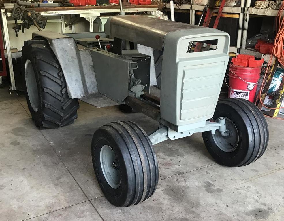

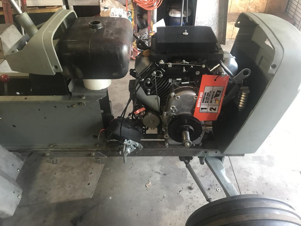

Engine mounting plate came today. Unfortunately it did not pan out as planned. Forged forward and mounted engine directly to frame. It turns out I may very well be able to keep the original GT14 look for the hood. I had to do MAJOR surgery on the predator shroud. I'll have to seal it off to keep debris out and allow it to cool properly but i like that the hood stays stock. I tried positioning it towards the back but could not gain enough room to allow for use of GT14 gas tank. So I went with plan B. Moved engine into the nose and will go with a Bseries style tank where the battery would ordinarily go. I will fab up a heat deflector similar rob gt14 set up to protect the Bseries tank. Then I tore it back down to start the process of installing the clutch and brake assembly off the donor. 2 steps forward and 1-2 steps back. Slow going but progress is happening. The whole roll of tape under tank is for rough spacing. First pic the engine is solidly mounted.
IMG_1284.JPG.bc28dd9e6e4b1a482225217a263eecc9.JPGIMG_1280.JPG.1ae08b703184b278abe389fdf04d9e3e.JPGIMG_1285.JPG.2ffeeb6f3d129a3185bc3bcf7d705341.JPGIMG_1287.JPG.56ee067fda3c99a0e5e6f15c2a440473.JPGIMG_1288.JPG.992523393dcfadd4d1bab88e6e935ef9.JPG
Edited by Aldon
  • Like 1
  • Excellent 4
ztnoo
6 minutes ago, Aldon said:
misprint surgery
I'm intrigued and perplexed by your terminology, Dr. Trimble.
Perhaps you could clarify?
Also.....where is the battery going to be located with the plan you are currently undertaking?
  • Confused 1
Aldon
That is supposed to be MAJOR. Dang auto correct crap program. As for battery, it will likely go under the Gas tank. There is more room under there since I won't be using the hydraulic lift for now. The gear reduction impedes too much. I can still make it work but doubt I'd use this for mowing so not worth the trouble to engineer a work around at this time.
  • Excellent 2
fast88pu
Put battery where original tank goes
