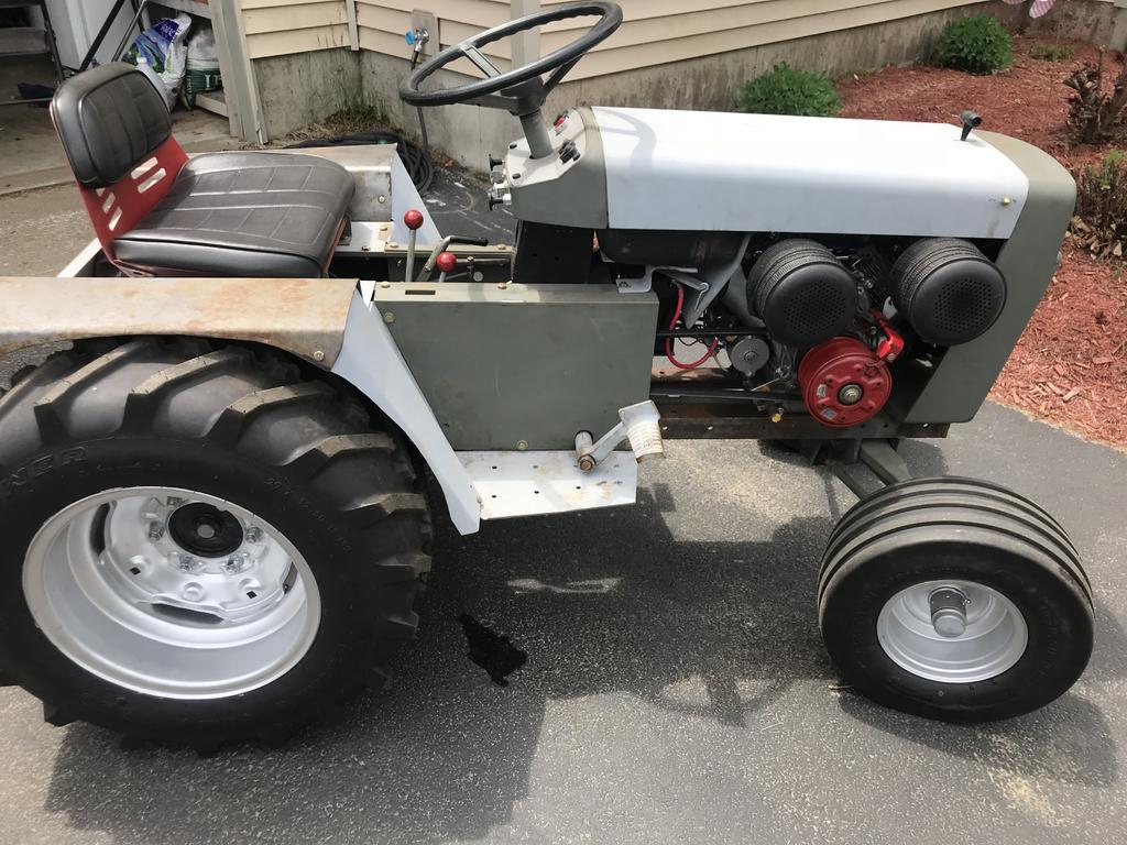

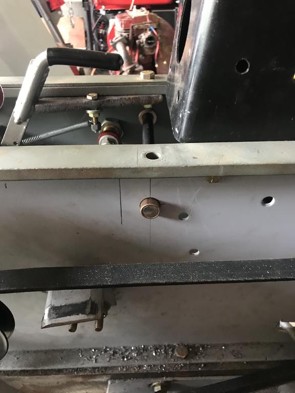

Finally had a spare moment to actually work on this thing today.
have not touched it since Fall other than to fab a belt support post for where belt exits the drive pulley.
I had done some research and planning for the belt drive system and ordered new belt in november 2017.
The OEM Wheel Horse Belt that was same length as the aftermarket belt I had which was close to working but not perfect. Took me hours to cross reference multiple docs. But I sourced it.
My OCD tendencies would not let me proceed with the project until I was closer to perfect.
So today I spent a couple hours and installed.
It ran well but the brake and the clutch friction stop weren’t ideal.
today it ran like a scalded cat and brake works well. I’m pretty pleased. I can now move forward and maybe get some paint on this thing before show.

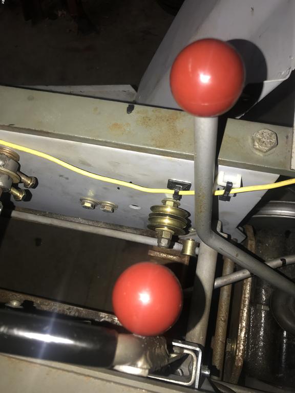

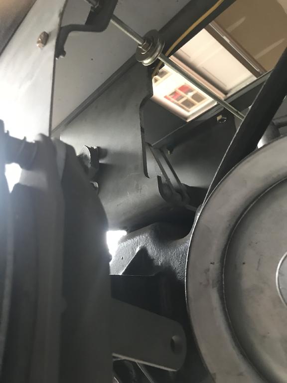

Aldon

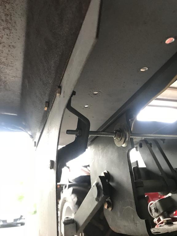

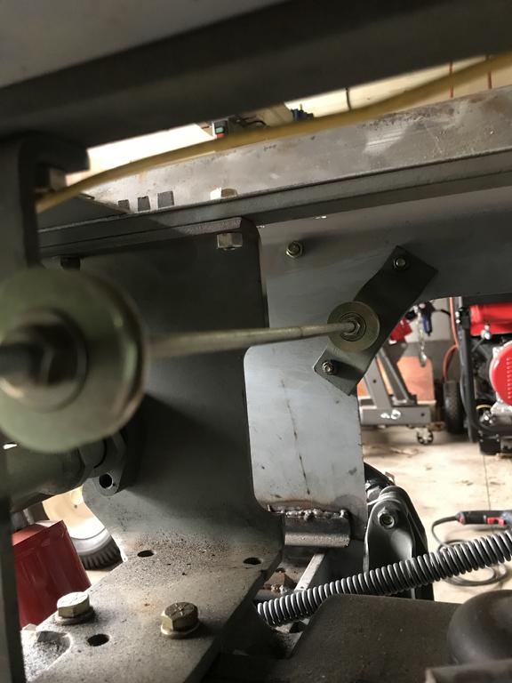

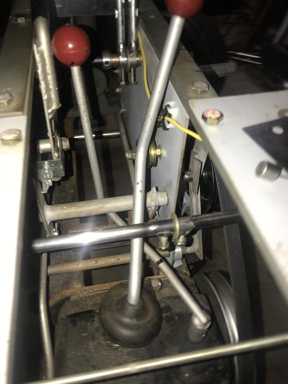

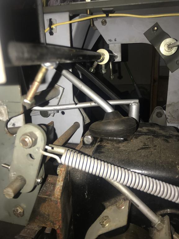

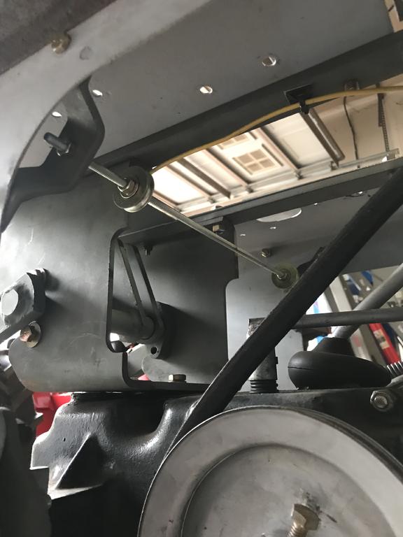

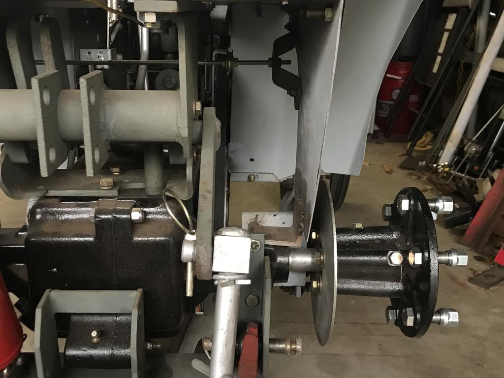

Decided I’d rather finish the turning brakes and add hydraulics before I do complete tear down and paint.
I made some headway this afternoon.
It’s a bit difficult to see but the calipers are mechanical and the engagement lever is normally low and when pulled in upward direction will brake.
I fabbed up brackets, threaded rod and pulleys to route the brake cable today.
7251F15C-2F04-4BE1-9E5D-CE58323BAB97.jpeg.ebd88fe4f732559fe2691ee6a5609afc.jpegBE6AEB7F-27DD-4598-B83A-6C5C5E518BD2.jpeg.e978303571efdd8762f15bb176666c9d.jpeg60AB6074-EC64-4254-9323-C1BF9F917B39.jpeg.5d0c5192406f1999056a2f14c4dc7057.jpegB0BC8526-BCFA-481B-8CF9-69B47C9691EC.jpeg.ebc56aff0968e6f343fde81c35c5e5a7.jpeg
  • Excellent 6
19richie66
Looking good brother!
DennisThornton
Details!  More pictures please!  Perhaps I missed the sourcing of the brake parts?
This is going to be interesting!
Nice work Aldon!
Aldon
Thanks. @DennisThornton
Pretty sure i detailed the basic brake parts I started with.
The calipers are mechanical Cub calipers which I modified. The discs themselves I made from eBay blank steel discs.
There are dozens of ways to skin the proverbial cat. If I were to do again, I’d likely go hydraulic. But once I get these mocked up and built, they should be bullit proof.

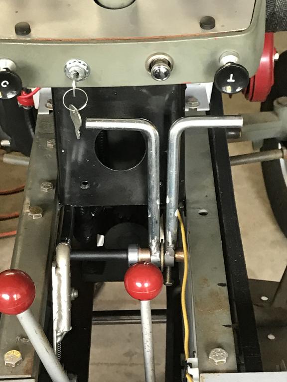

Aldon

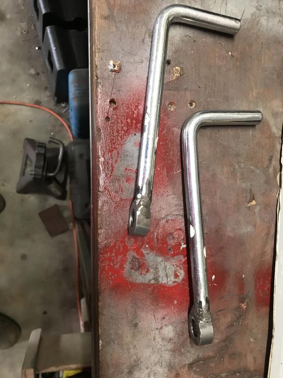

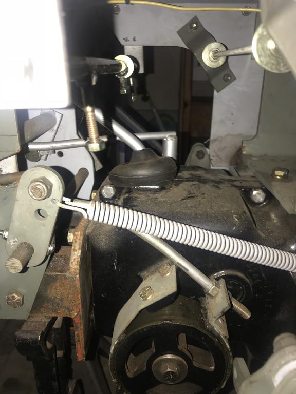

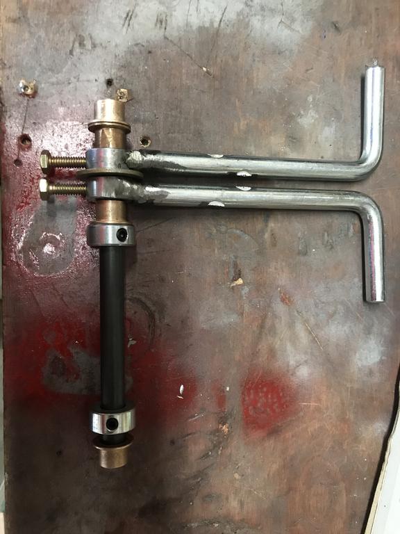

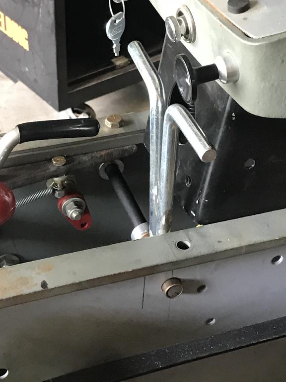

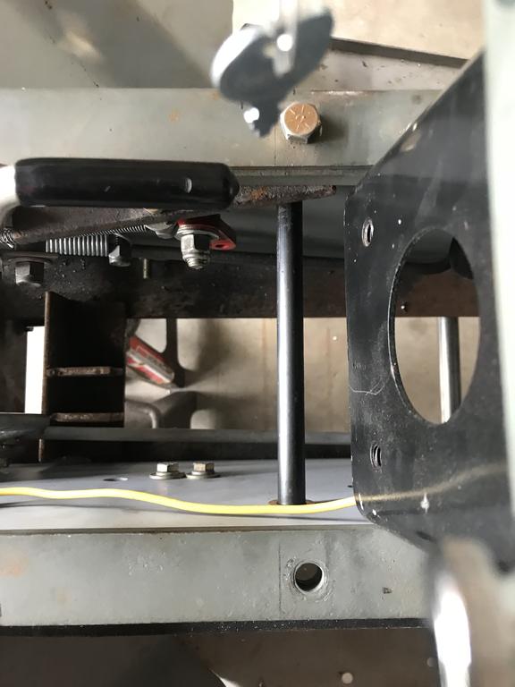

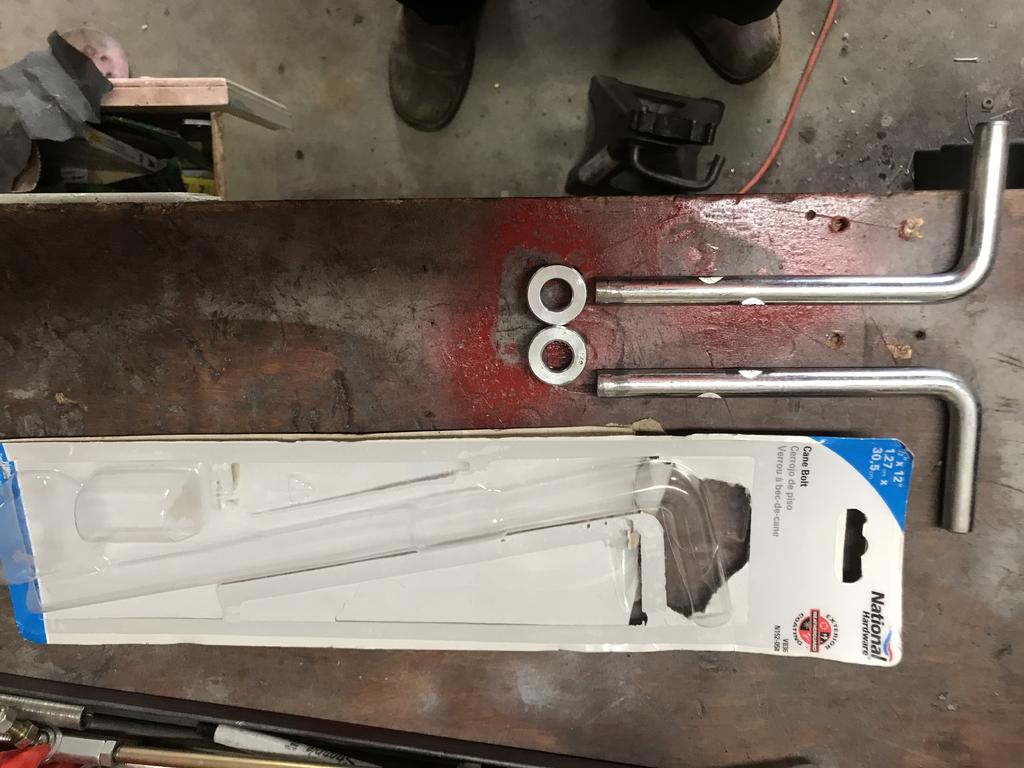

So I’m still toiling away today and may update more later but I took a brake to eat early dinner.
I made significant progress towards mocking up the turning brake hand controls. Had to run Intersil town to get the materials and then I needed to weld and realized that I had changed the 220 plug to allow me to backfeed my Generator this winter/late spring. Had to make a short adapter. So significant non wrenching time but made the most of the rest of day.
First I had to determine the right location for the support shaft, then fab up custom handles and so forth. Only had rough idea of what I wanted to do. Designed on the fly....
B2B5EA06-6604-4B76-9298-DA12B2BDFCCB.jpeg.c0f0af41d42ab24b696a858941173002.jpeg4DB60D03-EFD7-47BE-B0A4-E25C26857874.jpeg.b16eaf07b3c4e2602f095dac5b8095a3.jpeg83A0B473-7FD3-4D1A-9F54-A542EC30B921.jpeg.da49c4f06cf6c1d1447cfcd07b6e3a9b.jpeg77BAC6E3-754D-4544-9C72-6E40A0E03B8D.jpeg.3d8492c63aafc66621a6c758d2e59a5c.jpeg48876D33-1770-4BC9-84F0-F0073997C6EC.jpeg.9fd56b054631b6bbbdeb33f21eb0ff8a.jpegB9AACC20-ADD7-499D-8D37-CEBFC530E584.jpeg.8c86037113495672c9a94c82831c3b31.jpeg2AD5FFD9-A65D-4CE7-B042-8589AAE83579.jpeg.3cde5613373970cfa65a4a74c71c39c0.jpeg497A53A1-901E-45D2-9E1B-B54F9D76974B.jpeg.0eea5359dd03d9a399d013d403437dc6.jpeg
19richie66
Looks good my friend.

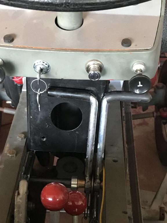

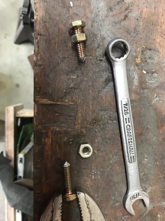

Aldon
Wish I welded more than once every year. Welds look like absolute crap when I start. Then about the time I am wrapping up the last weld looks almost amateurish is instead of like a blind man did it. Oh well. It functions and will be under the seat and fenders:-)
i have the fab work done for the turning brakes now. Need to drop by the hardware store and get mini turn buckles or some other hardware that allows me to adjust tension of the steel cable.
I doubt it will be obvious but I took some pics.
To engage the Brake, I will pull the handle back towards the driver slightly. Left handle Left tire receives brake etc.

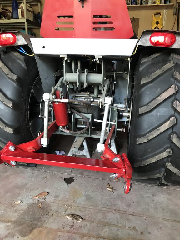

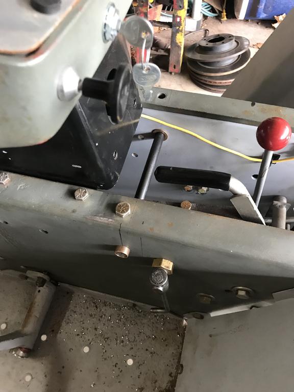

Well I was scheduled to fly out west for business after church. Would have been a grueling long day had it actually gone as planned.
Instead, I got to airport this afternoon and my flight was cancelled. 4 hours early. Crazy!
Chicago is a difficult place to travel through at least it has been for me.
good news though for me as I was able to tackle the turning brakes again. And since I was supposedly flying all afternoon, I was able to work uninterrupted. Yea!!!
I took pics but other than the rubber grips on the handles, not really easy to see the work I did as it’s under the fenders.
I will likely improve on it a bit when I tear down for paint eventually.
next project is the jack shaft for the independent hydraulic pump.
DD6D44BB-F2D8-40F6-8283-610AE087B45F.jpeg.faf842592bb60722ad12c46eb57dbd21.jpeg50F749DE-EC37-4D48-8DD2-C2FC5C74A1B8.jpeg.3a7a841355a4ff913b04454b23939e0d.jpeg
  • Excellent 4
19richie66
I like that crossbar setup on the 3 point
Aldon
Good eye Ritchie.
That is actually a reproduction of the wheel horse 3 point brace that was used for GT14 tiller set up.
Thanks to @DTOM for doing it for me. He works crazy hours but he managed to get it done for me.
It came out great!
